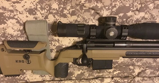

I got the area 419 bolt knob not sure if it’s what your looking for but it was a. Huge improvement for me

So I found out today my nucleus has a 25# spring.
All nucleus actions feb 19 and after have the 25# in them.
I’m tempted to buy a 19# spring.
I’m tempted to try and make my own bolt knob.

I got the egg from ARC and I like it a lot more. The old bolt knob hurt my palm when closing the bolt on stiffer reloads. As already established with the difficult to turn bolt release, I have pussy hands. The egg is much more comfortable on my pussy hands. This is much closer to what the RPR and savages have.
I like that.
I’m gonna try and and make my own but it’s nice to know I have a good option if I fail.
I went ahead and ordered the 25 pound spring today and an egg bolt knob (just to make the cost of shipping somewhat worth my while). I've got a match pretty much the first week I'll have my rifle together (great idea, right?) and I want that end all, be all solution if it starts light striking. I really don't think the bolt lift will be that bad. My mindset is just run it with conviction and treat it like any other short throw bolt. Once I get some time to do so, I may see what lighter springs will do, but I just want it to run when it should.

I’ll have the 19# spring and egg knob today.
I don’t find the 25# bolt lift objectionable, I mainly just want to see if the 19# works and if it does I’ll have an even nicer bolt lift.
