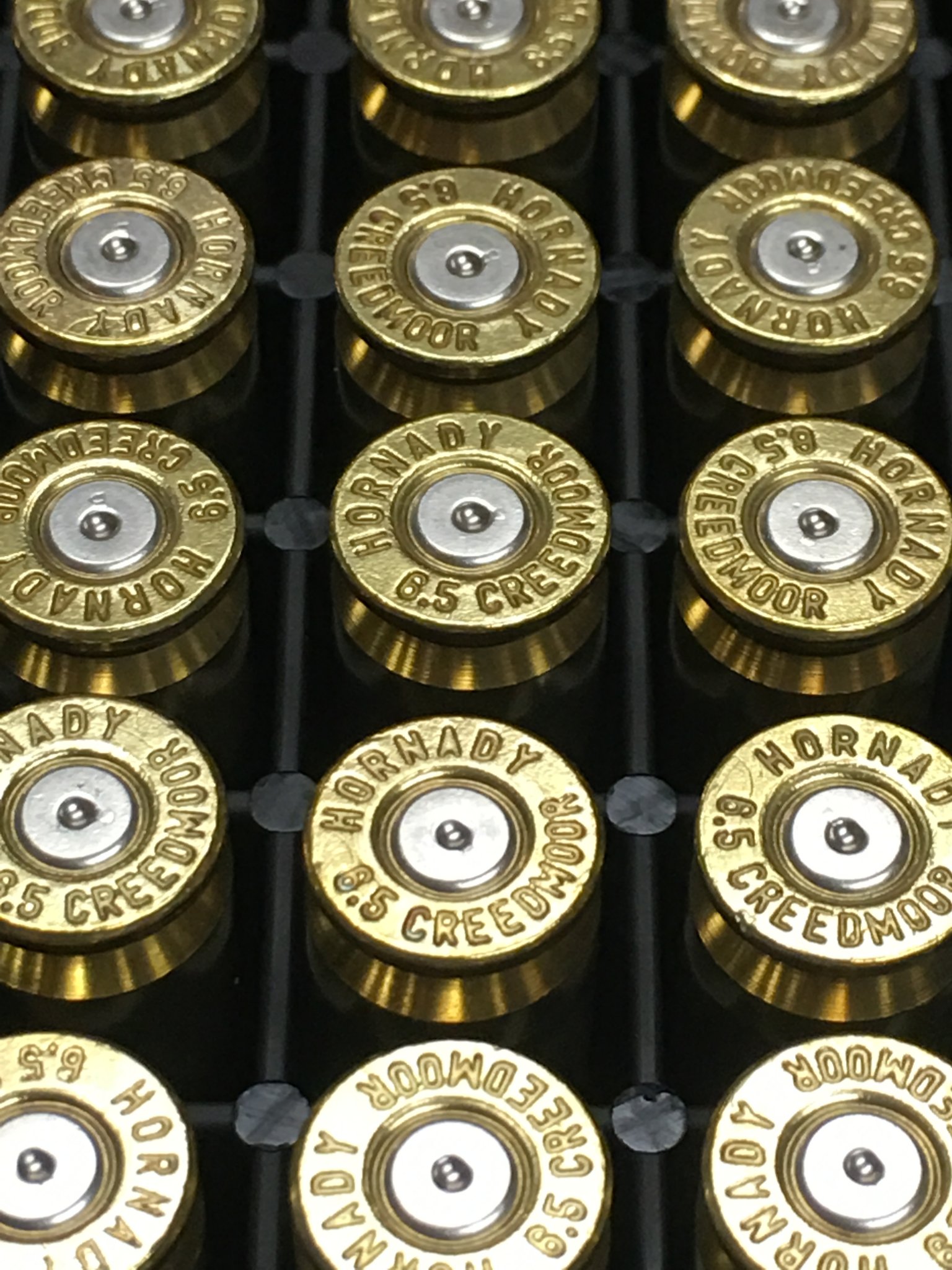

I'm having an opposite effect and getting cratering with Lapua srp; cci 450; h4350 (all charge weights); TT Diamond. I'm going to try new brass and a new box of primers to compare. I've read some things about the fp hole being slightly larger on remy 700 bolts which can cause this, so maybe that is all it is. There doesn't seem to be any signs of excessive pressure, I've measured case heads against factory Hornady and the are the same. The factory loads aren't cratering however.
View media item 901
The nuke uses a small firing pin. The light firing pin spring may be exasperating the cratering. I’d be curious if it goes away with the 25lb spring.
I’ve got pretty much the same issue as you but I’m running rem 7.5 primers vs. 450s. It craters 95% regardless of charge weight.

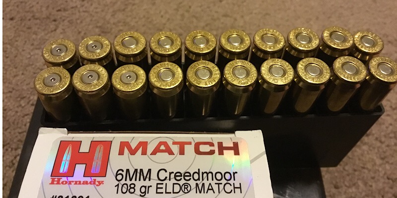

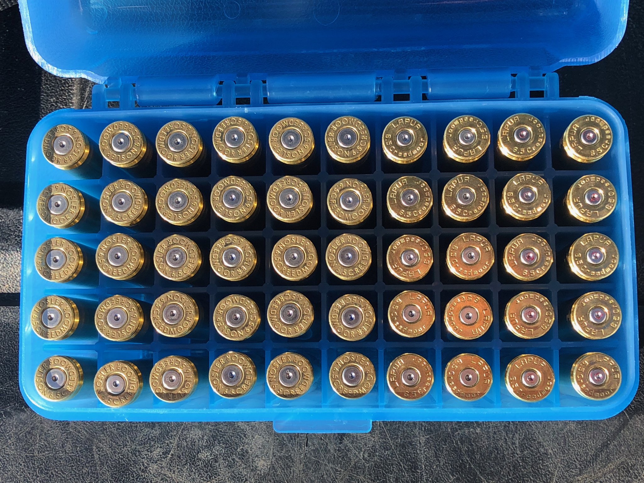

My nucleus has cratering too.
This is with factory ammo.
These are my reloads. Recipe is 6mm Creed Lapua SR brass using a cci 450, 41.25 grr of 4350 behind a 105 Berger VLD or a 108 eld.
I don’t care though. I get cratering with my savage and RPR. I don’t consider it an issue until a primer pops.

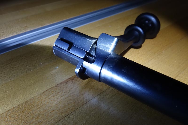

No trigger in my long action at the moment, it's just a bare action. But the bolt by itself with no trigger has 0.255" of firing pin travel, I'd expect a little additional FP travel once a trigger is installed since it will probably have some overcocking.

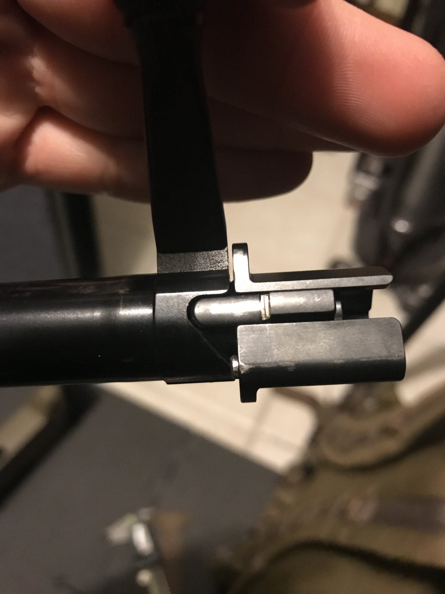

Your 0.086" cocked / bolt open dimension makes me think your firing pin shroud might be 1 turn too far out from the bolt body... with the threads being 20 TPI one turn is 0.050". Both my long and short actions are right at 0.045" firing pin tail to firing pin shroud with the bolt handle in the open position. What's the measurement on your action with the bolt handle open and also with the bolt closed but the firing pin cocked?
On my assembled short action with the CG Mod 22 that 0.045" dimension with the bolt handle open drops to 0.024" with the bolt closed and the firing pin cocked because the CG Mod 22 has some overcocking that yields additional firing pin travel when closing the bolt. Can you take a picture showing the gap between the firing pin shroud and the back of the bolt body with the bolt handle in both the open and closed positions?
Yes I can and I have tried to tighten the shroud twice now after seeing your post I bottom out before I can make another revolution to get the detent back in bot I’m at .065” bolt open and/or out of the action
.086” is cocked with the bolt in the closed position
If you didn’t have exactly the same measurement between the two actions I would say your firing pin may have come unscrewed from the cocking piece only because that happened to me earlier on I only found out when I used the little disassembly bolt and washer to take the bolt apart and noticed it spinning but maybe changes have been made mine is a preorder action from some of the first batches I believe
Yeah, that gap is quite a bit more than my two bolts and certainly not helping your firing pin travel, but if you can't get another full rotation out of it I'm not sure what to do. Does the shroud bottom out on the back of the bolt before you can get another full rotation out of it, or does it stop rotating before all the gap is gone like something else is stopping it from threading in the rest of the way?

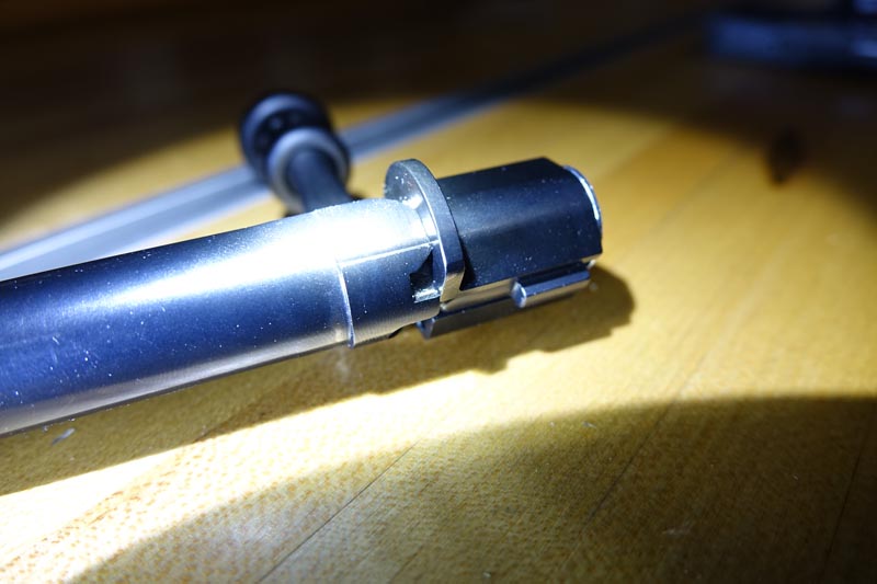

For reference, here's one of mine... note how much less the gap is.
Firing pin cocked / bolt open position (same condition as your picture above)
Firing pin dropped / bolt closed position. The gap increases 0.010" in this position as the shroud "unscrews" relative to the bolt body as the bolt body rotates 72 degrees from the bolt open position to the bolt closed position.

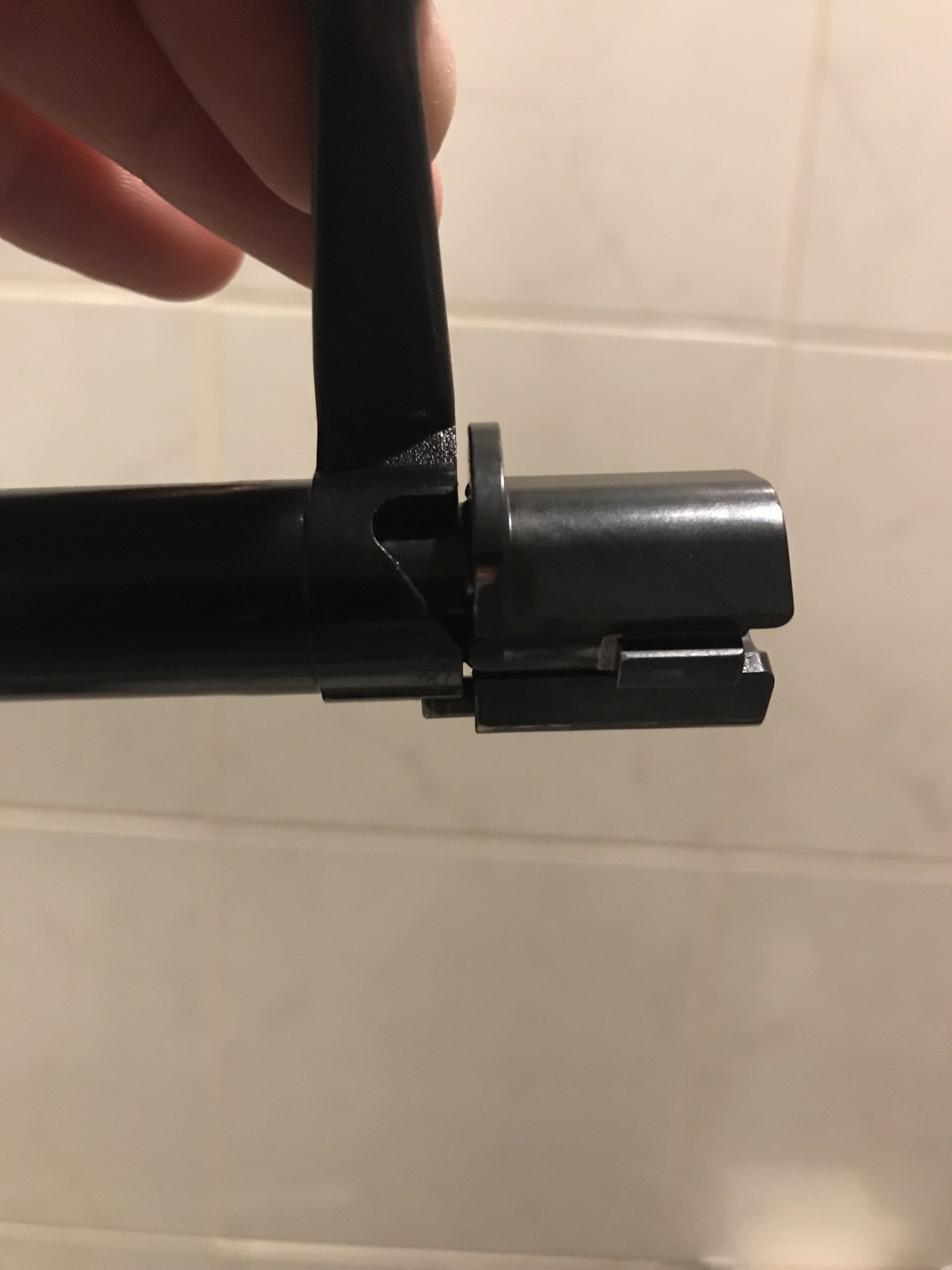

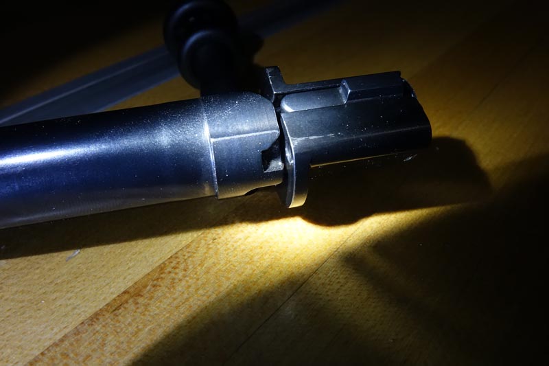

You bring up an interesting point first of all there is .035 gap there in that picture so if one rotation=.050” I don’t have enough but it does shoulder right up there is nothing stopping it other than it runs into the bolt body before I can get back around but the interesting part to me is being a left handed action the body is tightening into the shroud when I close my bolt handle opposite yours which explains why I lose travel upon closing where you gain travel when closing , but none the less I have less travel overall I have an unmodified cocking piece in my parts collection I will have to install it tomorow and see what it gave me I dont remember how much material I took off
Photo with firing pin in the fired position
Good point on the RH vs LH action differences, if ARC used RH threads between the bolt body and firing pin shroud for the left hand actions the shroud to bolt gap on your LH action will decrease 0.010" when you close the bolt.
Based on my limited sample of 2 Nucleus actions, my hunch is you should have approximately 0.250-0.255" of firing pin travel with only the cocking ramps on the back of the bolt body from the bolt closed to bolt open positions. Anything significantly less than that would lead me to believe the shroud is unscrewed further out from where it should be-- and if you can't get that extra revolution tighter out of it before it bottoms out there's the possibility your bolt and shroud have thread timing error stacking going on (or a little too much material on the flange of the firing pin shroud facing bolt body) preventing you from getting it that extra turn tighter and picking up additional firing pin travel.
I suppose that's one advantage to a bayonet-style bolt and firing pin shroud interface like an AI or Bighorn TL3, there's no worries about thread timing messing with the relationship of the firing pin shroud to the bolt body like a threaded interface-- provided the bayonet lugs on the firing pin shroud are in the correct place and the receiving grooves in the bolt body are in the correct place. There also won't be any change in distance between the two components as the bolt rotates relative to the firing pin shroud as you close and open the bolt.
Be interesting to have people post the bolt open vs bolt closed firing pin tail to shroud dimensions with the bolt out of the action and also in the action with the trigger in place and see if there's a trend between actions not having light strike problems and actions having light strike problems.

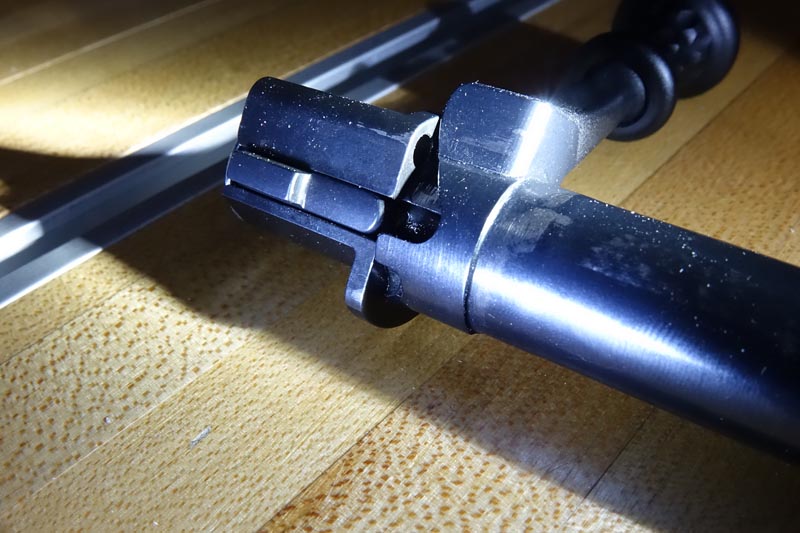

I looked at all three of my Nukes, but couldn't exactly see what you all are talking about as far as how far you need to screw it in. I will have to go back through the comments and figure out what you are talking about there.

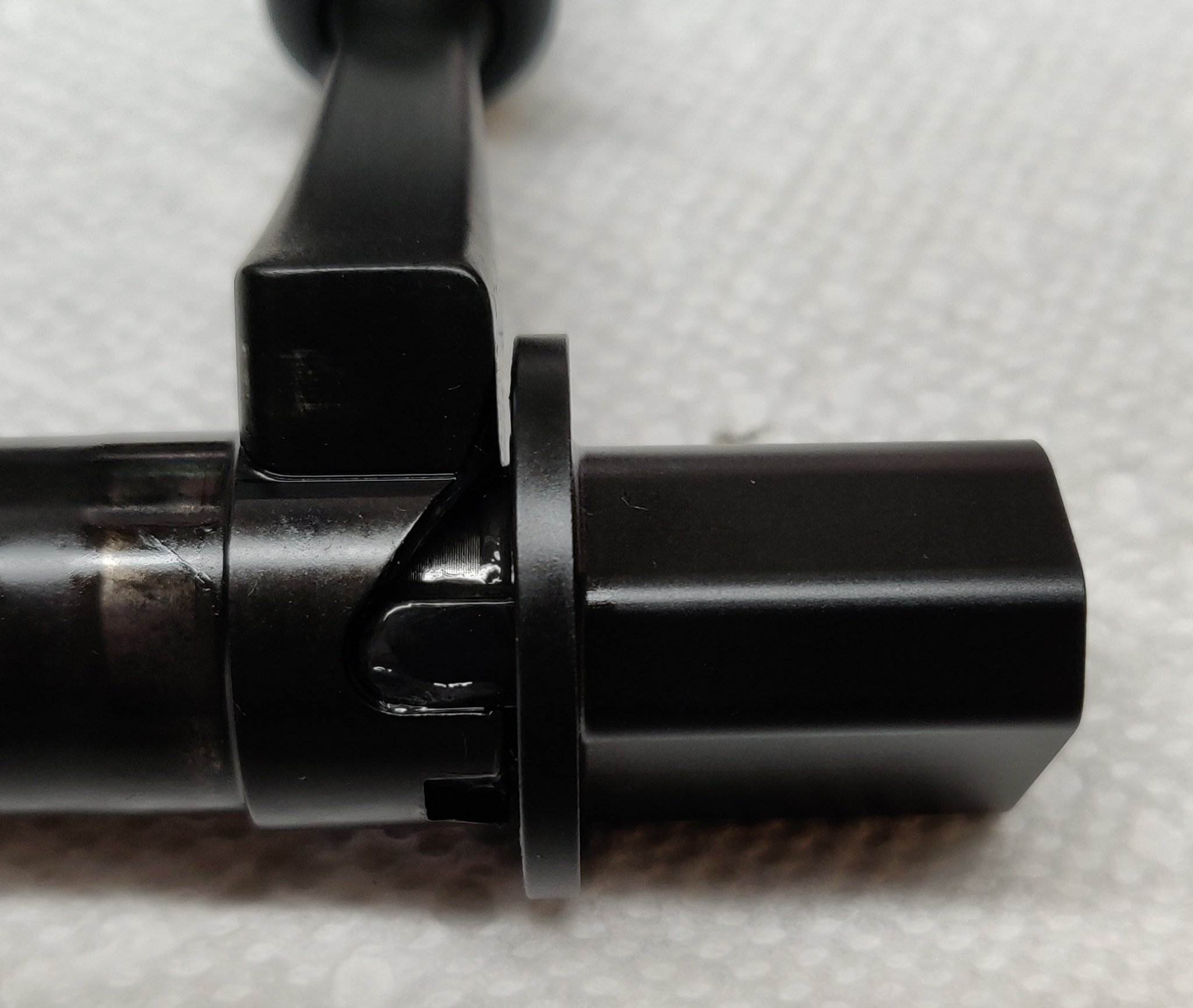

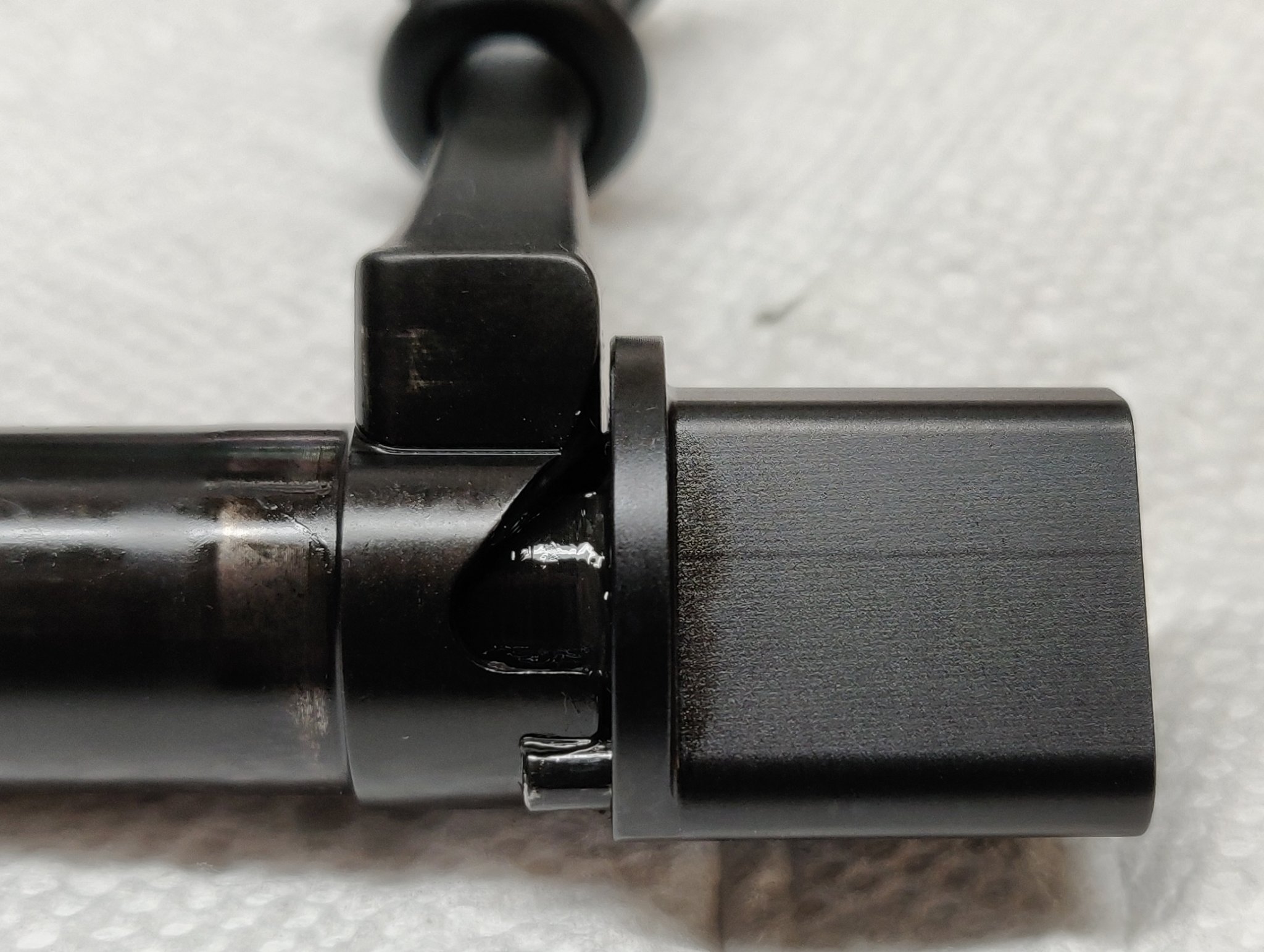

When you have the screw/washer in the back of the bolt to compress the FP spring for disassembly/reassembly, we're talking about where the shrouds ends up when screwed all the way in until it stops.
In this first pic the shroud is screwed all the way in until it bottoms out on the bolt sleeve. Notice the slot for the plunger pin, and that there's no hole in the shroud there for said plunger pin.
Now in this pic I have backed the shroud off to align the plunger pin hole with the plunger pin slot in the bolt sleeve. Notice the gap between the shroud and sleeve - that's the 0.035" gape that's been mentioned a few times now. When I put the plunger pin back in and release the disassembly screw in this position I end up with the shorter firing pin travel number.
This pic shows how the cocking piece lug is just past the matching ramp slot in the bolt sleeve when the shroud is screwed all the way down until it stops. Also notice the plunger pin hole in the shroud. In this position the plunger pin will fully extend and thus lock the bolt preventing it from being able to rotate as the pin gets wedged up against the block of the bolt handle.
This last pic shows the shroud just backed off a little bit to allow the cocking piece lug to align with the cocking ramp slot in the bolt sleeve. Also note that the plunger pin hole in the shroud is now over the bold handle so it can't fully extend if assembled in this position. If I put the plunger pin back in and remove the disassembly screw while in this position and then muscle the shroud around to be properly oriented (here it's 180 degrees out) I somehow gain 0.036" of firing pin travel even though the gap between the shroud and bolt sleeve ends up being the same at 0.035".
View media item 901
Range update. Stripped the bolt and ran it through ultra sonic. Shot new lapua brass with new box of 450’s and some starline with 41’s. Same deal. No light strikes and everything went off. I’m gonna chalk up the cratering as a nuance in mine and hopefully doesn’t start doing the light strikes. I found a great node with sd of 3.1 and es of 10 no other signs of pressure. I have a local match in April so that should be a good test.

All, as far as the issue with screwing in the shroud, eventually that issue should be gone, because ARC told me that they planned to go to a tool less design. I saw it on the Mausingfield and the Archimedes. They are consolidating production for what they can across models is what I understand. Doesn't help us now.
One thing to note here before anyone goes screaming to ARC about the shroud to bolt body gap causing light strikes... the gap between the firing pin shroud and the back of the bolt *can* vary between bolts-- but unless the shroud is so far back the firing pin can't protrude through the bolt face 0.035" before the cocking piece bottoms out in the shroud and/or the shroud is so far back the locking plunger can't engage the notch in the back of the bolt body, the gap amount between the bolt and shroud in the assembled condition really doesn't matter and shouldn’t be used as an indicator of a problem.
The forward motion of firing pin and attached cocking piece is limited by the shroud so the firing pin doesn't launch across the shop when you remove it from the bolt body-- but only when it's removed from the bolt. The forward movement of the firing pin and cocking piece when installed in the bolt is limited by the castle nut and washer on the front of the firing pin which controls firing pin protrusion.
The amount of rearward movement of the firing pin and cocking piece during bolt cycling is a function of the cocking ramps on the back of the bolt body and also the trigger sear in the closed & cocked position.
The shroud keeps the firing pin, cocking piece, and spring retained when you remove it from the bolt; so the shroud itself can limit the forward movement of the firing pin-- but normally only when removed from the bolt. If the shroud was unscrewed too far from the bolt body when assembling the bolt, the firing pin would not be able to move forward far enough to protrude from the bolt face and ignite the primer as the cocking piece and FP forward motion would be stopped by the cocking piece bottoming out in the shroud. Having the shroud unscrewed too far may also prevent the shroud locking plunger from engaging the notch in the back of the bolt-- so as long as either of those conditions aren’t happening it doesn’t matter if the gap between the back of the bolt and the firing pin shroud is 0.020" or 0.070" when assembled.
The real question here is why both of my actions have around 0.253" of firing pin travel without the influence of the trigger & sear from the bolt open to bolt closed positions (with the FP protrusion set at 0.035") while other people are reporting their actions only have about 0.195-0.205" of FP travel in the same conditions. That “lost” 0.050" of FP travel is robbing the energy needed to ignite the primers reliably. Measuring the FP travel from the back of the shroud to the tail of the firing pin will show a 0.010” difference between LH and RH actions, but that measured 0.010” difference is only because the shroud moves 0.010” relative to the bolt body over 72 degrees of bolt rotation-- and that 0.010” shroud movement between bolt closed and bolt open is opposite in an LH action compared to an RH action. The *total* amount of FP travel from bolt closed to bolt open should be the same between RH and LH actions as that’s controlled by the FP protrusion setting, cocking ramps and cocking piece. Without seeing a "problem" action in person I can only guess as to possible causes limiting the firing pin travel between bolt open and bolt closed...
1. incorrect / too shallow cocking ramp cuts on back of bolt body. However, if the cocking ramps were cut too shallow that could limit the forward FP movement during firing as the cam surfaces on the cocking piece would hit the bottom of the ramps and stop the firing pin before the firing pin protrudes from the bolt face.
2. back/flat portion of bolt body cut too short which would limit FP cocking on bolt opening since that would effectively shorten the cocking ramps. However, this would only limit the amount of FP cocking on bolt open-- with a trigger installed, an action with this issue would probably have a *lot* of overcocking on close from the sear. This condition should still produce adequate FP travel from cocked to fired... unless the sear on your trigger is way too short or you significantly shortened the sear engagement surface on the cocking piece to reduce the amount of overcocking / “bump” on close.
3. trigger pins located too far forward / trigger sear too short / a combination of both. While this would limit FP travel from cocked to fired, it would limit FP travel *only* with the trigger in the system... the bolt itself should still have approximately 0.250" FP travel from the bolt open to bolt closed positions with the bolt removed from the rifle. For example say the trigger sear was 0.075" too far forward; you should see and feel that 0.075" of FP drop during bolt close before the cocking piece engages the sear and catches the firing pin.
4. Firing pin too long or back of cocking piece too short (the surface of the cocking piece that the firing pin tightens against.) If either of these were the case, even if the FP protrusion was correctly set to 0.035", the firing pin being too long or the back of the cocking piece being too short would place the cocking piece further to the rear away from the cocking ramps and sear, so the total amount of FP travel both with and without the trigger would be reduced since the cocking piece would be held further back from the cocking ramps and also from the sear.
Those are a few ideas I had while looking at my actions... and they're all just ideas without being able to look at and measure a "problem" action in person.

I went from 20 % ignition to 98% ignition by installing a 19 lb spring while still using a Timney trigger. 78% increase of ignition rate with 3 lbs increased force. 25 lb spring increased preload to 9 lb over stock spring should make this 100% ignition regardless of sear friction or sear length of the Timney.
In the case of my rifle I have the following going against me. I live and shoot on the gulf coast and the salt air forces a need for preservative function of oil. read this as thick ass oil! I also have a personal salinity and acidity of perspiration that is horrid and rusts stainless barrels with only a touch. 98% humidity never helps with this along with 80 degree weather in December. We sweat in the south!
I have to lube everything, I do use dry lube where possible" Coated firing pin and bolt" but the original spring removed has a slight dusting of rust during its stay in my parts cabinet. This was not oiled as per ARC instructions. I have a dry Lock graphite based bube on the new 19 lb spring. The 98% success rate was with the dry lubed spring. Something also was noticed that the firing pin was covered with oil after lubing the outside of the bolt for smoother cycling. I would suggest that using a 25 lb spring would be best due to the following. Oil will get to the firing pin and over time will thicken and lower firing pin speed and force. The heavier spring should help to decrease velocity ES due to more consistent primer strikes. This will be compared to previous firings across 2 chronographs and the results posted. Also this rifle is shooting a 7mm-300 wsm wildcat and these shots are for fire forming brass and load development. This can make for a softer strike especially if there is excessive headspace. Mine only gained .0015" and was a snug bolt close on fired cased before bumping the shoulder back .0015". Also I use CCI-BR2 primers that are a harder cup for the firing pin to indent, but much more forgiving for cratering and piercing.
I did a test with a borrowed Bix and Andy with a low .036" sear to reduce the drag and the sear was longer than the Timney and gave a longer power stroke with less sear friction. This combo worked 100%, and if you follow Teds suggestions as to correct the light strikes along with a trigger that has similar sear length and clearance the problems should go away barring lube finding its way to the firing pin. If you want better odds, get the 19 lb spring with the above procedures worked well, but might need regular bolt teardown and cleaning."Every time you shoot it". The 25 lb should work with all triggers and sparing lubrication unless your action has something else going on that is not what the rest of us are having issue with.
