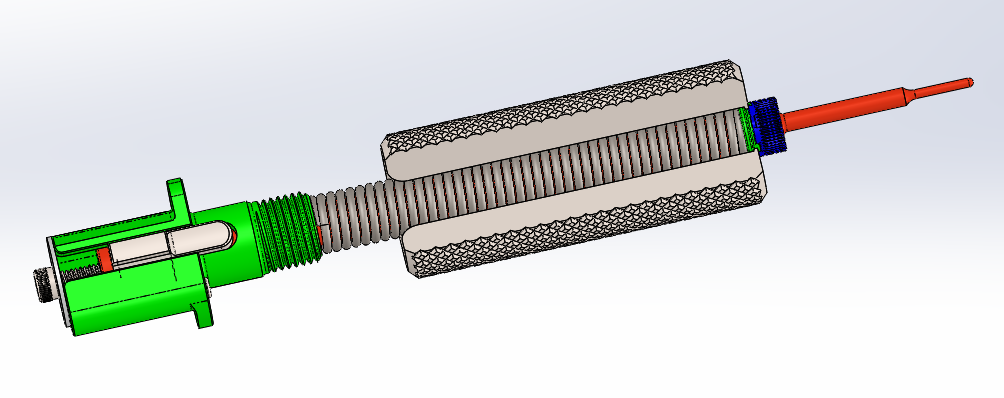

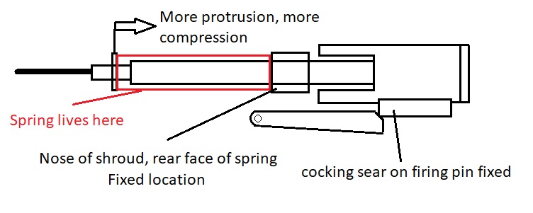

I was playing with my bolt today, and I think the Nucleus may be different from other actions where you adjust firing pin protrusion but essentially unscrewing the cocking piece. The cocking piece and firing pin on the Nuclus are fixed, and you adjust the front end of the FP to change protrusion. Unless I'm missing something, I believe you gain in both FP protrusion and cocked spring compression by adjusting the hex washer/nut further down.
Here's a lovely MS Paint depiction. The only thing I can think of that would change this is if there is a relationship between the FP and bolt shroud that I'm missing. At any rate, maxed out I have ~0.045" protrusion, which I believe should work out. I had it set for about 0.025" last outing, and combined with some cold grease was giving me several duds. I'll see how this new arrangement works.

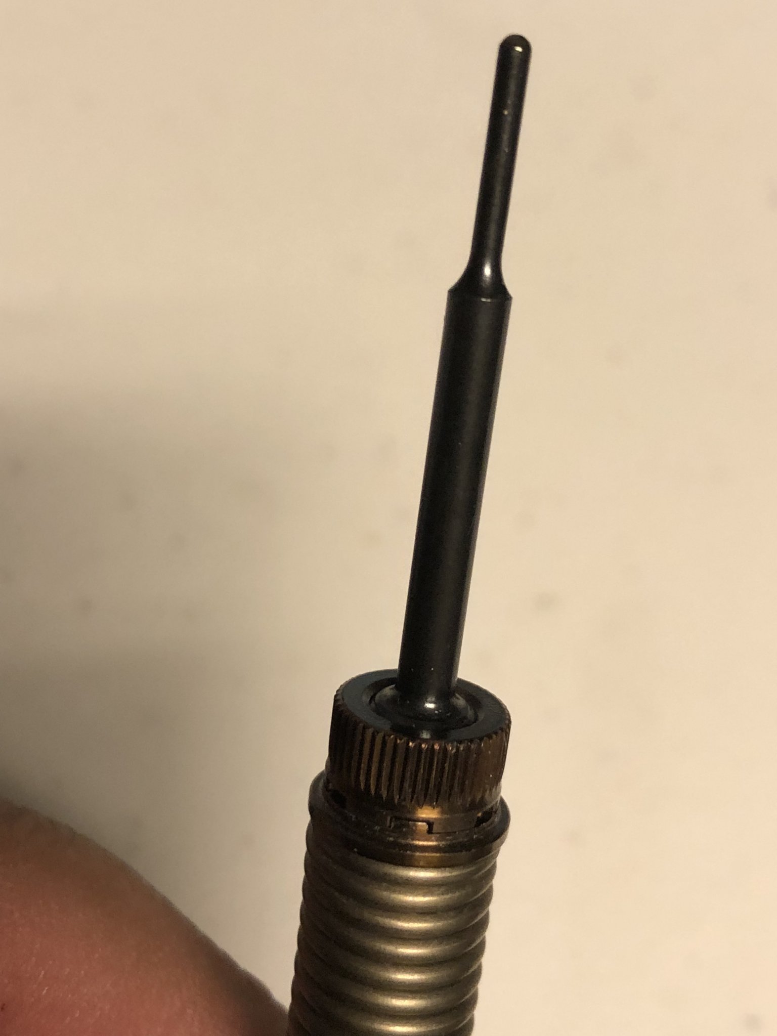

Excuse the ignorance, How do I measure the protrusion? Ive searched and the only way I can see how to measure is with a gauge.
I took a picture of the FP before I took it apart and when I put it back it together it looked exactly the same.
I double checked it tonight and its pretty much as far down as it will go. I can't get the castle nut to turn any more and it's right where i had it set.
Assemble your bolt and drop the firing pin by twisting the rear portion of the bolt body while holding the handle firm. You'll see the firing pin sticking out, and you can then measure how far out it protrudes by using calipers.
If your Nucleus' bolt is similar to mine, you'll have barely 0.020" of firing pin protrusion with the castle nut set up like that. I adjusted mine to be be right around 0.040" and that resulted in the nut being slightly below the shoulder on the firing pin where it necks down, whereas yours is just about level with it. You've really got to lean into the spring on top of that washer (pressing it against the floor worked best for me) to get it compressed enough to adjust further.
Before you adjust though, do measure how far your pin actually protrudes to see if it's necessary. @bohem made a great post on the first page here discussing firing pin protrusion and why you see problems if you're above 0.050" or below 0.030". Here's a link: https://www.snipershide.com/shooting/threads/nucleus-light-primer-strikes.6896558/post-7161913
I measured protrusion by using the back end of a set of calipers and measuring the bolt face to the front of the bolt. Then I dropped the firing pin and made that measurement again and the delta between the two is the firing pin protrusion. Depending on your calipers you may even be able to stick them in on the bottom of the bolt and just measure from the bolt face up to the tip of the firing pin.
You can make both measurements using your system with the pin protruding. The bolt face and the front of the bolt are both machined by ARC to be flatter than you could ever measure with calipers (you'd likely need a specially setup micrometer and even then might not find differences without a lot of trouble) so a measurement from the front of the bolt to the bolt face will be the same regardless of which point on the bolt face you measure to.
The way I measured was by placing the base of my calipers across the front of two of the action lugs to ensure it was parallel with the bolt face. Measured to the bolt face, then adjusted the angle of the calipers slightly so that the protrusion from the base of the calipers touched the tip of the firing pin instead of the bolt face.

After your bolt has been fully assembled, the tip of the firing pin should protrude from the face of the bolt by 0.035 - 0.045 inches.

Also, I realize that disassembling the striker mechanism using the large washer that we provide with the action is difficult so are offering a striker assembly tool that will make the job much easier. This can be ordered from our website very soon. See pic below.

It's interesting to note that the firing pin protrusion question (how much is enough?) is mentioned here in the second video talking about how increasing the firing pin protrusion will reduce the energy imparted onto the primer once you get beyond the point of "enough".
