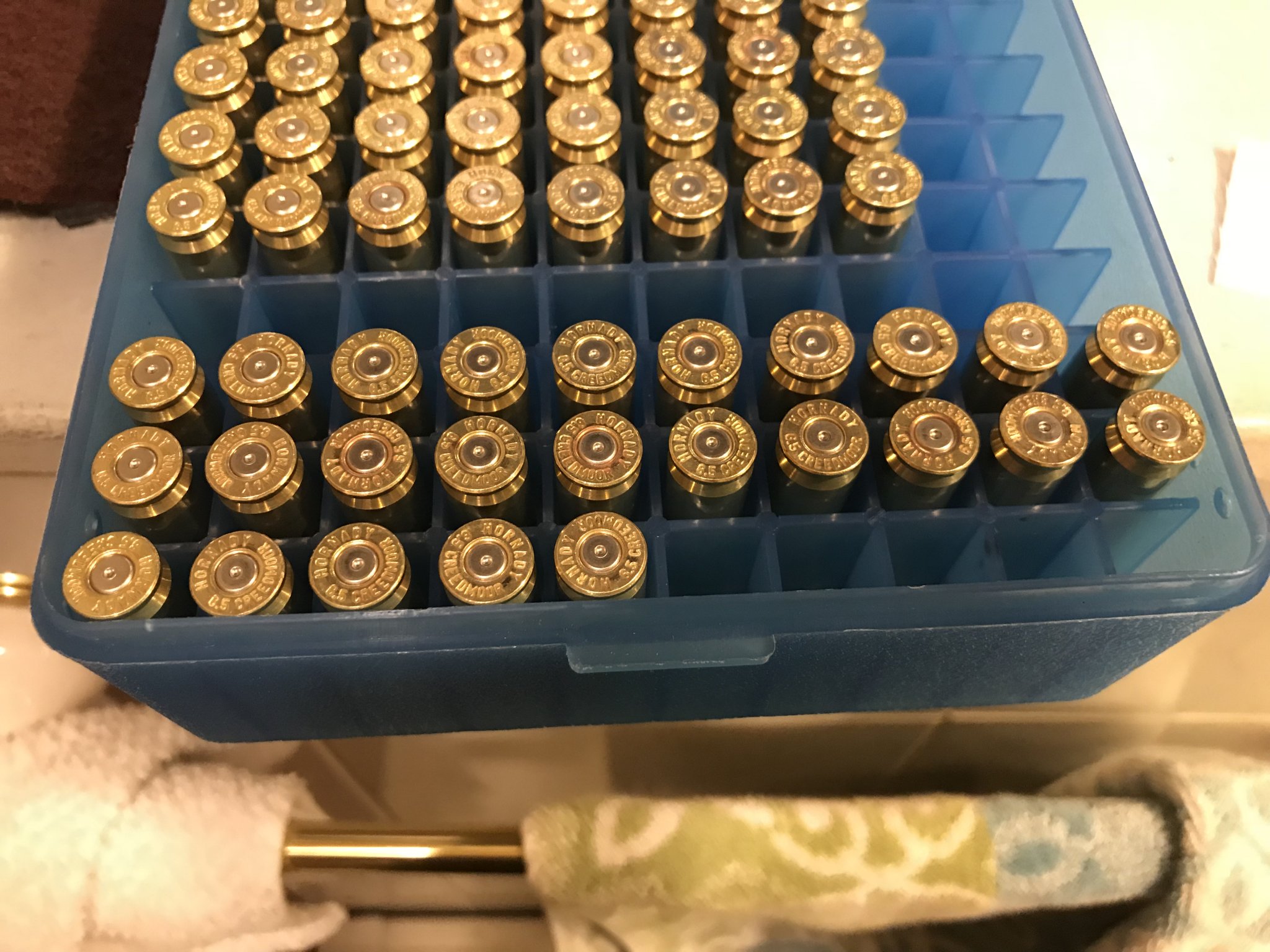

1. cleaned in Acetone with ultrasonic and 150 degree F heat for 2 hours after scrubbing by hand.
2. assembled, measures protrusion and length from nut to tip of pin. both measurements were in Ted's specs and currently .035" protrusion.
3. Greased only what Ted said on the cocking assembly with 3M Teflon grease. mid temp -45 to 185 F "Aerospace" $150/.5 oz
4. dry fired multiple times to work in the grease and feel.
5. first 5 rounds failed to fire. put them in my hunting rifle and all fired.
6. got with Jon at ARC and he sent me a 19 lb spring. Should have specified long action. new spring was for a short action.
7. got a correct 19 lb spring and a Allen screw to replace the one that I launched off the bench while compressing the spring by hand with the washer.
8. cleaned, measured protrusion, lubed, and dry fired new LA 19 lb spring. still easy cocking.
9. Test fired 60 rounds and 58 of 60 fired. Not good, but much better. 97% fired vs 20% on the new Action before tear down.

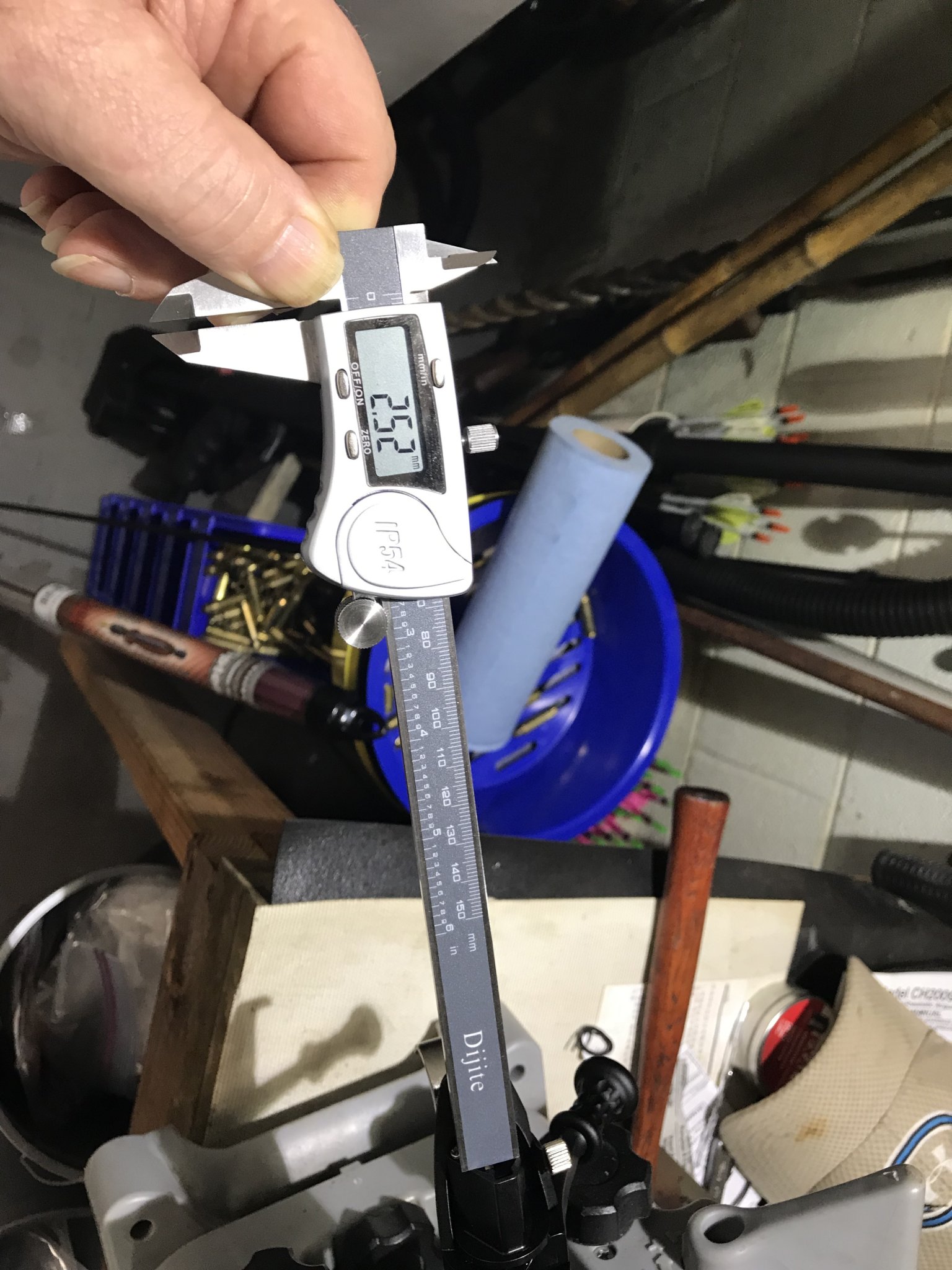

Now to compare which trigger has more or less firing pin travel based on measurements.
I included a picture showing how I measured the firing pin distances.
As you said, "We are here to learn" and Teach if possible. As with any truth, it can be verified with facts and measurements that verify the issues and corrections.

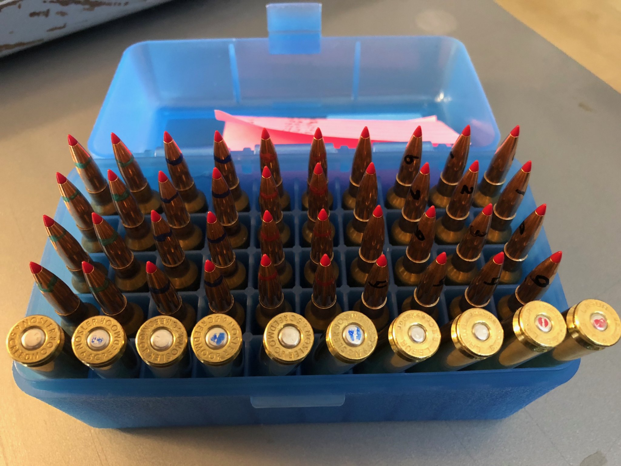

1)virgin brass: light strikes on both primers. got and installed the 19lb spring......still light strikes.
2)at that point, i loaded some rounds with a decent jam and that mostly cured the issue but not 100%. tested jammed rounds with the 16lb as well and no bueno on that.)
(NOTE: being that my cartridge is somewhat of a wildcat so take that into account. BUT, my cartridge is designed to take factory 260 ammo out of the box, fire and out comes 260 improved brass so that really shouldnt be the issue. also, i think there is a slight difference in the peterson brass shoulder length and the original lapua 260 that i had always ran and had zero problems. but that was with cci200's. peterson may be a fuzz shorter?? my smith did test fire vigrin lapua and it was gtg with the original 16lb spring.) i no longer have any virgin lapua to compare to so not sure on that measurement.
3)with formed peterson brass i have no problems with light strikes and the 19lb spring. the 16lb spring and cci41's were iffy.
4) i said eff it and ordered the LOW sear from BNA and installed it yesterday......It has helped!
i had taken my measurements on my action and was in the 3.9-4.0mm range so i figured i was close enough to try the LOW sear. As mentioned, it’s helped but I’m not at 100% yet but I’ve got most of it figured out....probably the remainder or the issue is brass needing formed.
only tested cases(not a loaded round) and so far so good with the CCI450's and the 19lb spring. formed cases were gtg with both the 450's and 41's.

How are you only getting .183" of firing pin travel on your action?
Both my short and long nucleus actions have 0.250" of firing pin travel without a trigger fitted. I only have my short action built right now, and with a CG mod 22 trigger the combo has 0.026" overcocking on close for a total of 0.276" of firing pin travel. I'm not counting spring rate or firing pin assembly mass which also has an effect on energy delivered to the primer, but 0.276" total firing pin travel is right in line with many other actions.
I'm 1100 rounds in on my 223AI nucleus build using Remington 7.5 primers with the 16# spring with only one misfire, and that's because that piece of brass had an extremely deep primer pocket and the primer was set way too deep. Last couple times I've been at the range it was about 30F, so I haven't experienced cold weather light strikes. I have a 19# spring on hand, but it's still in the package for now.
The light strikes are obviously an issue for some, but others like myself have no issues... Certainly frustrating for those having the problems. From what I've seen Ted seems to be holding the tolerances very consistent on these actions, so I'm wondering if it's an action issue, a trigger issue, or a combination of the nucleus action with certain triggers leading to excess sear drag causing these light strike issues. I'd love to play with a "problem" action & trigger combo and try to pinpoint the issue.
I don’t get it either and I wasn’t going to open my mouth yet because I have Lapua brass and cci450s coming today or tomrow but I have an earlier nucleus with the 16lb spring still installed I had zero failure to fires through 400 rounds plus until I started handliading this winter at which point I’ve had 1 and it was a hornady factory loaded 140eld I was shooting over the chrono I’ve shot 200cci250s and 400 cci 200s since without an issue we shall see how small primers work out but I have .035” pin protrusion and a trigger tech diamond my action is also left handed maybe something was done a little differently on them but in any case hopefully it continues to work well but it makes me wonder how some people are having 30% failures and some people are not having issues what could be different between them that could cause that much variance in our results
My FP is also at .035” protrusion. All other primers I’ve used and shot through the action have fired(win srp, cci 400, cci 41, fed srp) Including a few rounds of factory federal match ammo as well as some wolf gold .223.
Cci450’s are the only ones giving me issues. I’m hoping it may be this lot of primers. So I’m going to pick up a different one and give them a try.
Hopefully yours will work with no issues.
Reactions: hereinaz
Reactions: hereinaz
Dependent on my schedule and weather, I will be testing things out either tomorrow or Thursday. Nucleus with 25# spring and Huber trigger, Nosler brass with CCI BR-2 and 250 primers, and Lapua Brass with BR-4 and 450 primers. Assuming 100% ignition, I'll run a similar test with the 19# spring.
Reactions: Dooby
The 0.183" number might be incorrect as I was going from memory of what my 'smith said 6-months ago.
If I measure off the back face of the firing pin (where you would screw in the hex bolt to compress the spring) to the rear face of the bolt shroud I get the following:
Dropped (fired) = 0.312"
Cocked with bolt up = 0.128"
Cocked with bolt down = 0.118"
That puts the travel at 0.194" with the trigger in place.
With no trigger I get the following:
Uncocked (bolt down) = 0.312"
Cocked (bolt up) = 0.118"
That's a difference of 0.194"
