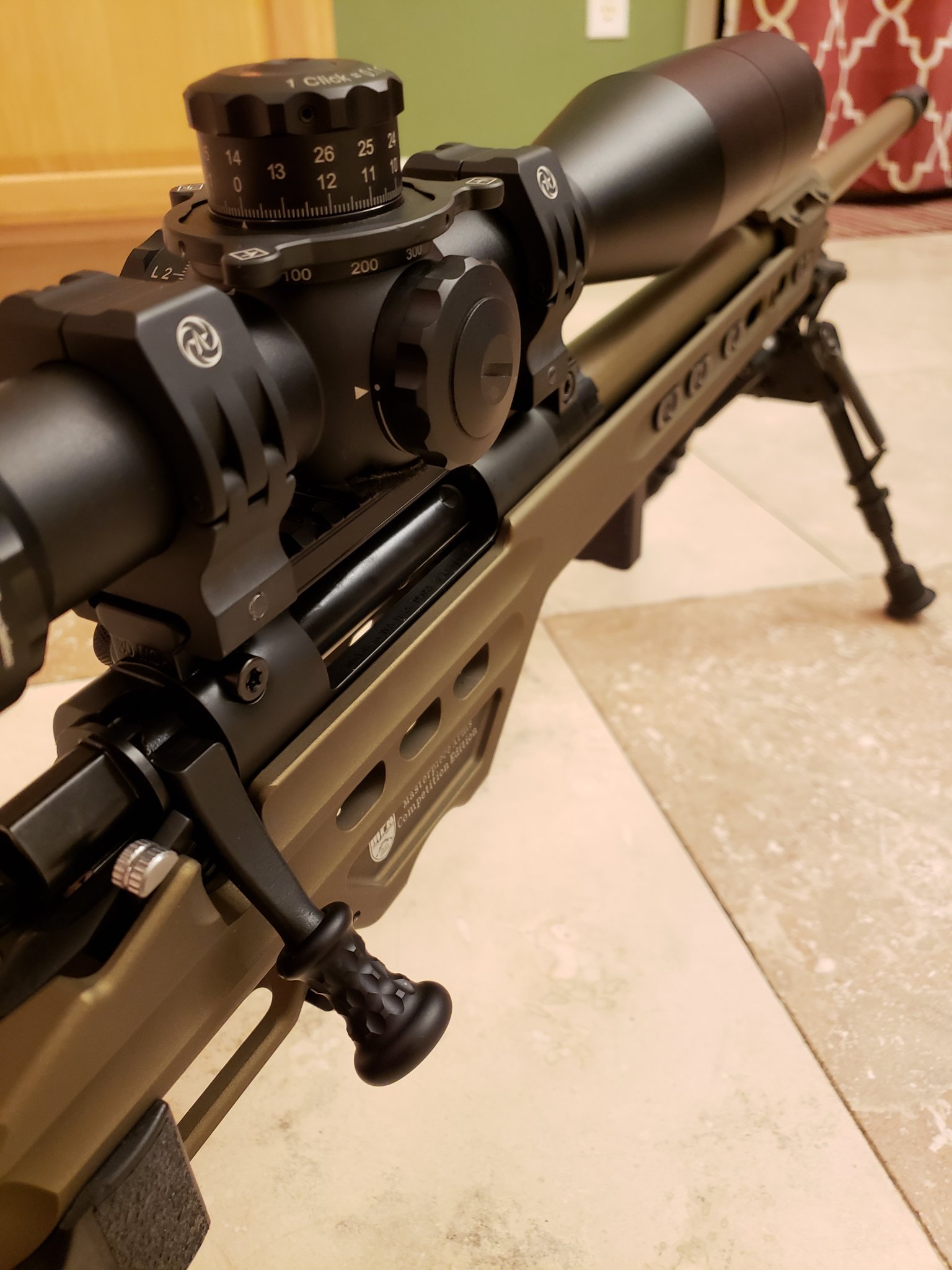

Just picked up my Nucleus and it’s beautiful! Just want to give a heads up to everyone that ordered a barloc (like I did) that they are back ordered so you may not get it with your Nucleus. I called ARC and talked to Justin and he said they ran out of barrel nuts and are about 2 weeks out before the next batch of nuts are done ready to ship. Justin was really helpful answering all my questions (I’m sure I sounded a little irritated) and helping me out.
Reactions: leftyk82 and MElank
gonna be pretty pissed if thats the case as it showed not back ordered on my invoice.
Great pics. Sharp looking rig!

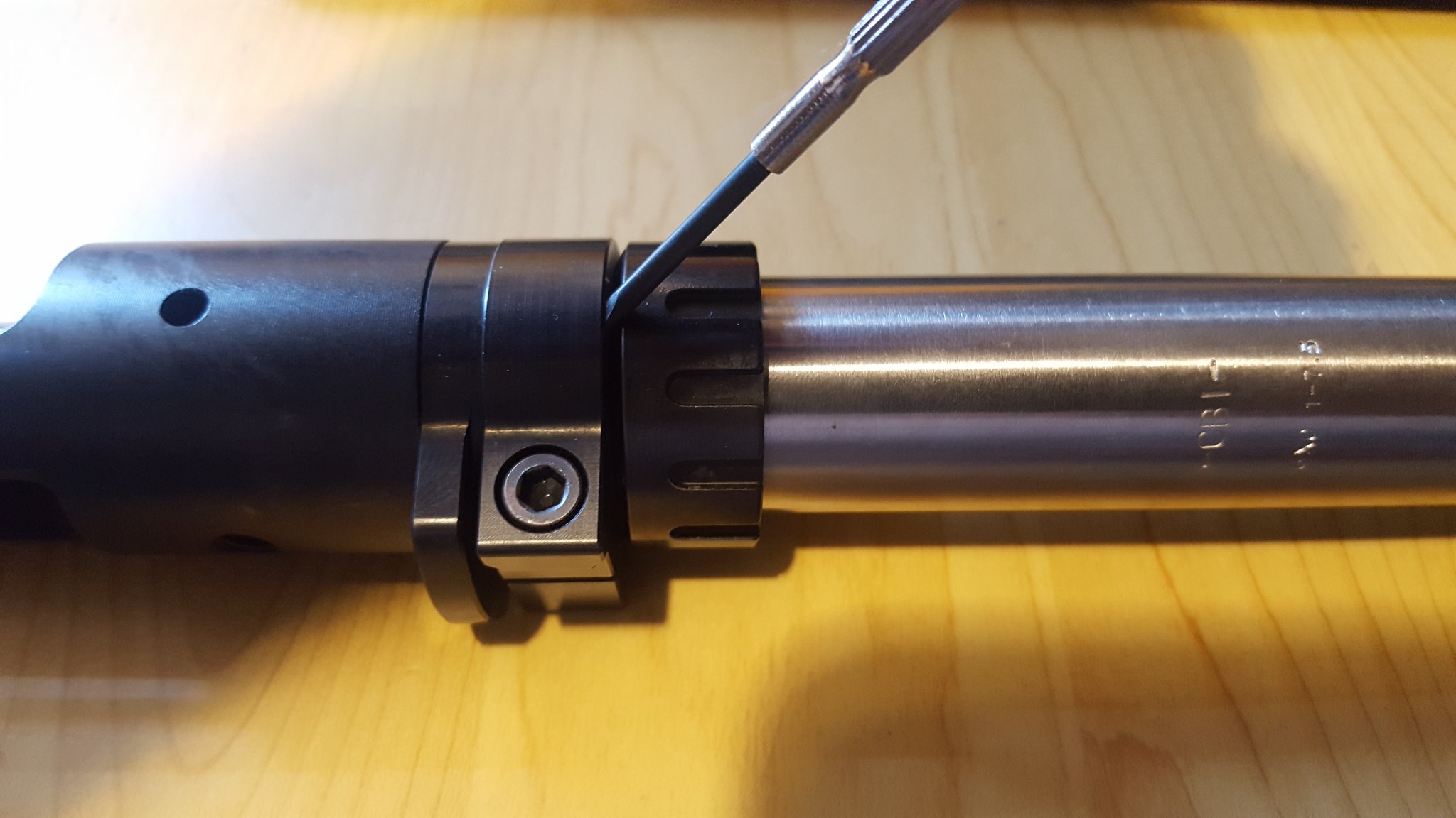

the barloc nut? what wrench are you using?
Barloc has a a cool little wrench. I'll post a video tomorrow explaining it. Basically, you just get the nut snug, so that when you tighten the clamp ring, it forces the barrel nut away from the recoil lug, cause they both have a ramp and the clamp ring has an opposing ramp.
If it is just a straight Savage barrel nut on a Savage prefit, you would use the barrel nut wrench like NSS sells. There are a ton of videos showing how to swap a Savage barrel. It is the same for a Nucleus.

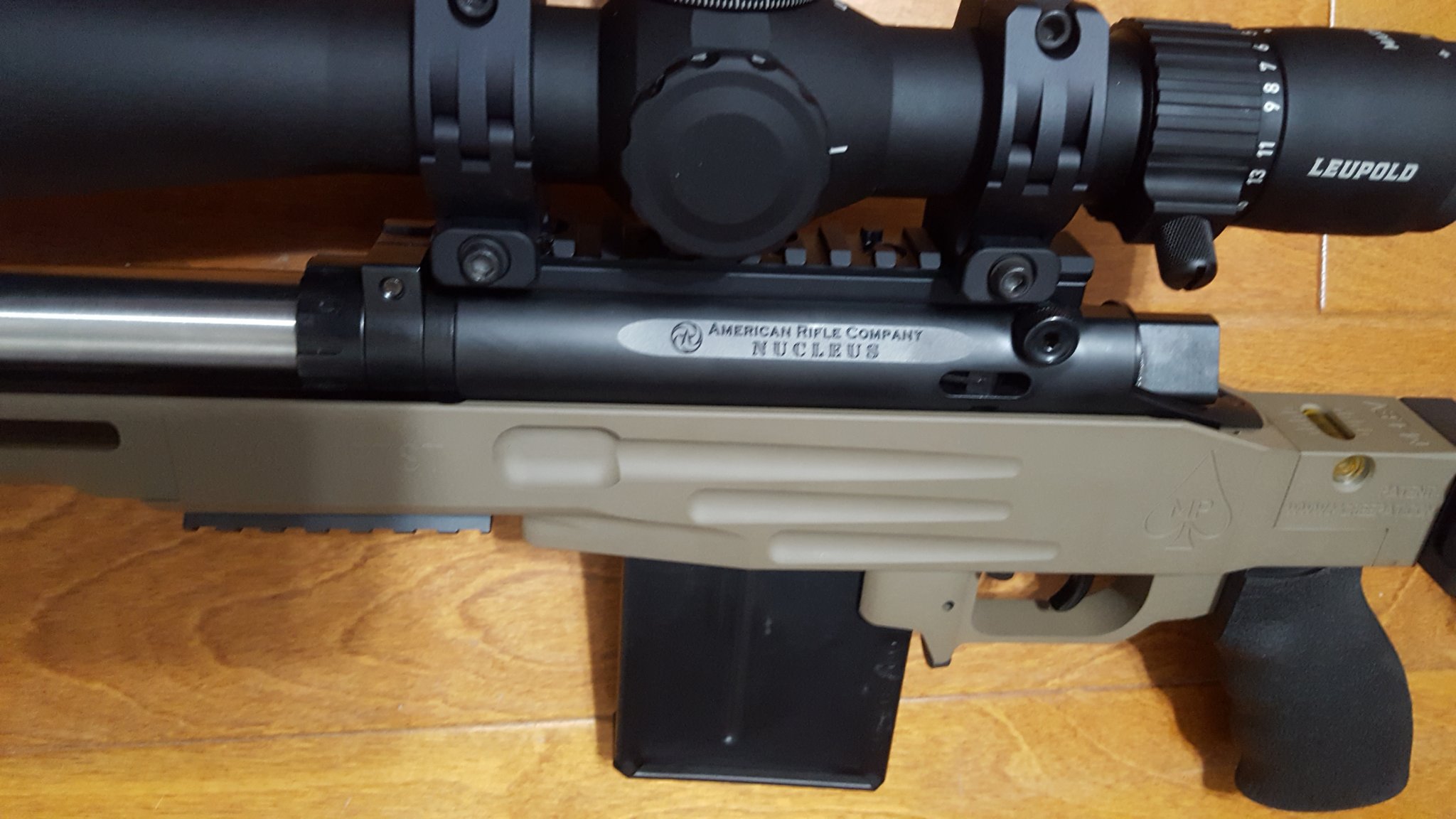

Cool where they chose to put the SN. My FFL was confused trying to find it, lol. I was stoked to see I have #00005...
Looks like it's right along the ejection port? I'll hopefully have mine in hand Thursday. Just waiting on the barrel from PVA which should be shipping this week also. Everything else is on hand and ready for assembly.

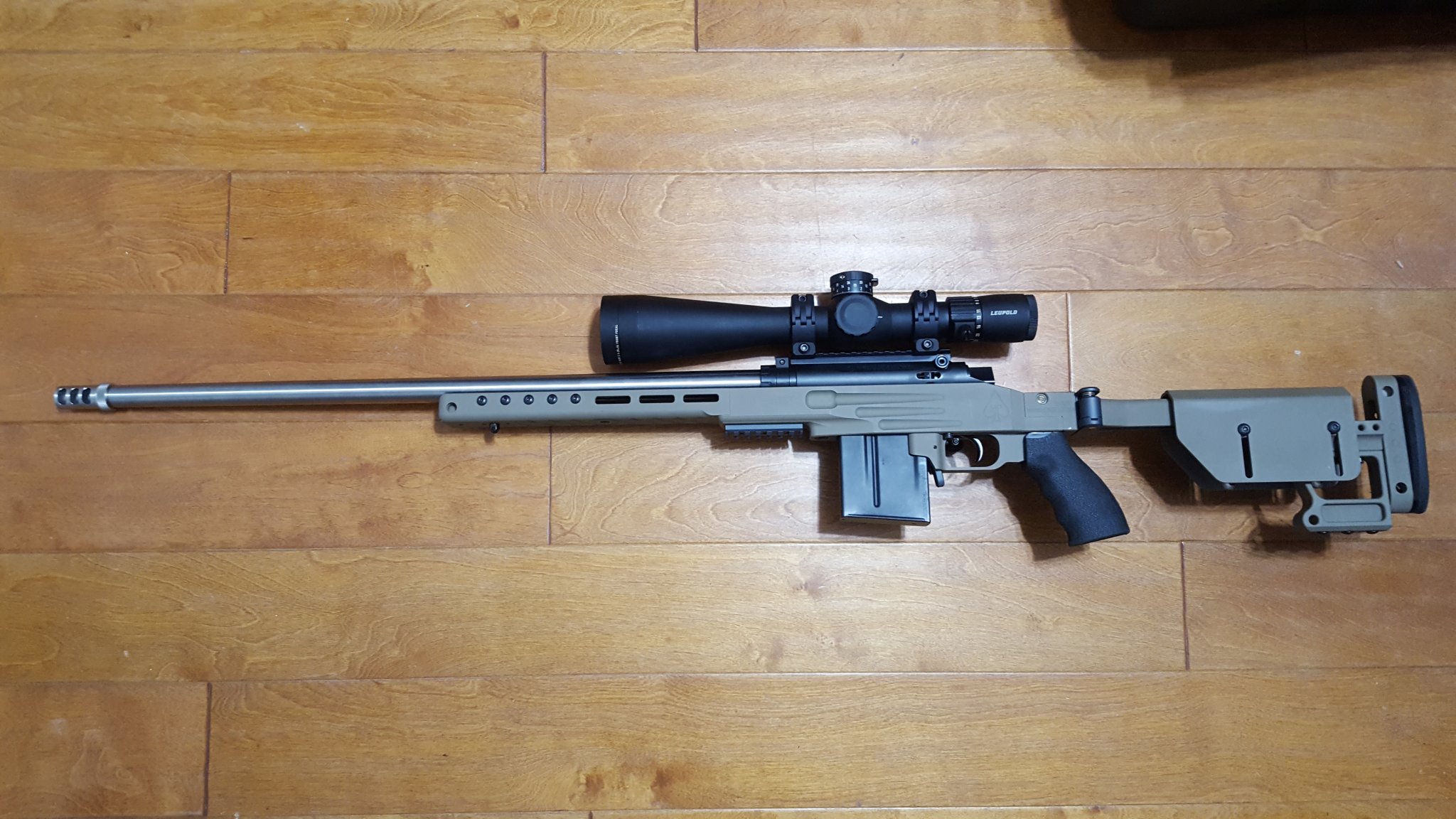

I started a new thread so we can see all the Nucleus build pics in one place without scrolling. I started it off with pics of my build.
Assuming their 3 prototypes were 1, 2, and 3 and on the same set of numbers as production, you could potentially have the second production ready Nucleus ever made. Even if they restarted for production and began with zero, way cool!

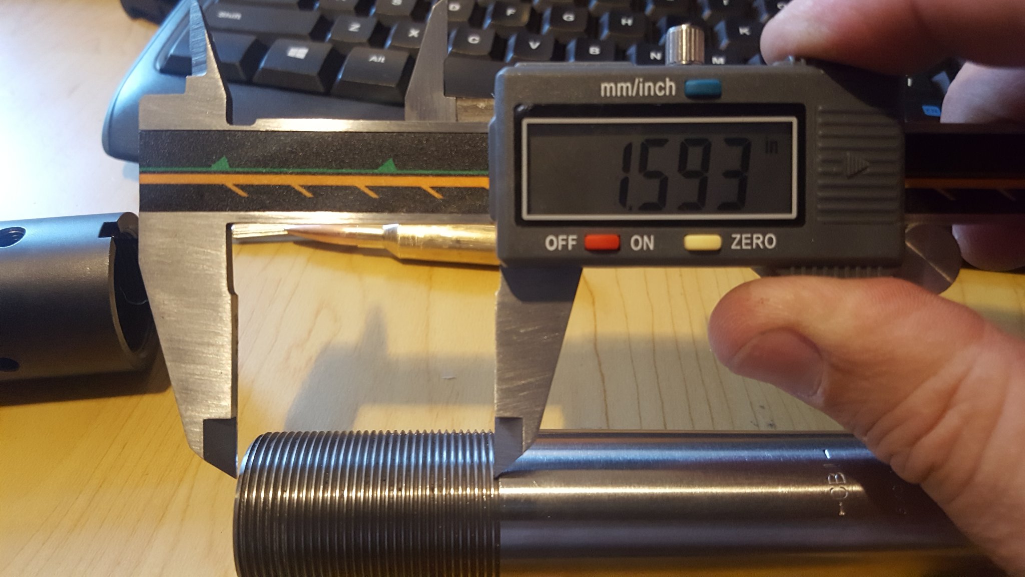

I stand corrected.
The Barloc DOES headspace a 6xc Criterion and Shillen prefit in both the Nucleus and Savage action.
The pic show how much space remains when the barrel is threaded down all the way onto a 6xc cartridge in a Savage action.
The other pic shows the length of threads on a Criterion. My other Shillen was almost identical.
