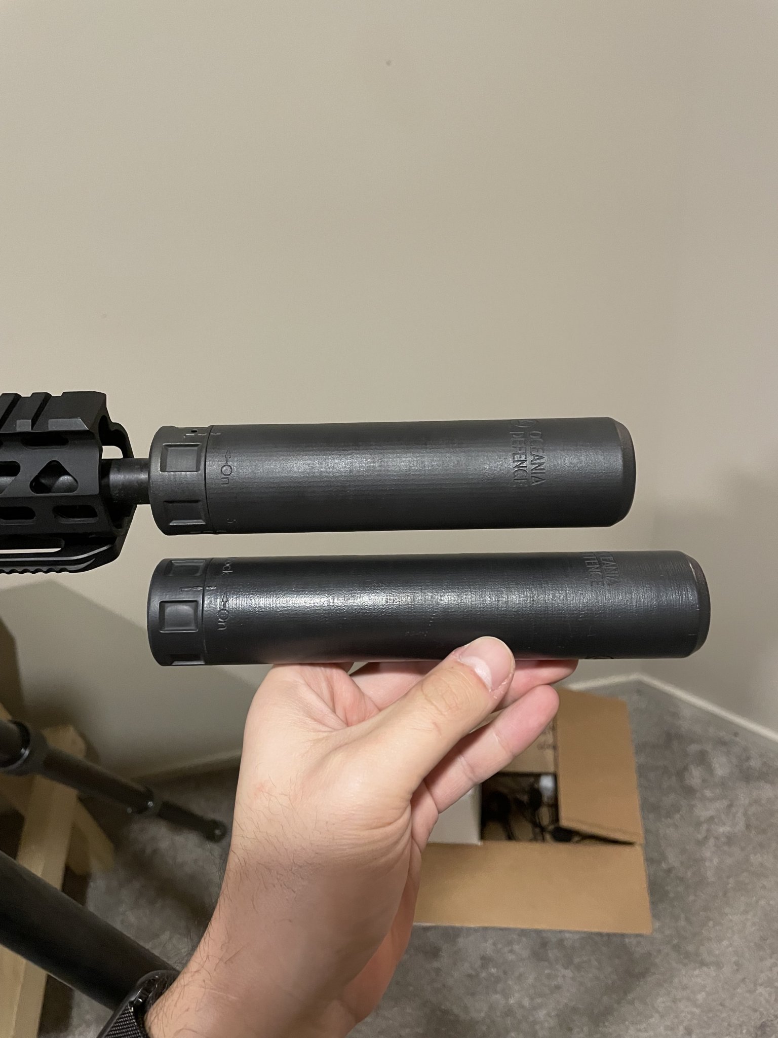

They are good. I have two Oceania Defense suppressors in both 5.56 and 7.62 printed in Inconel 718. They are significantly ligher than other stainless steel or aluminum machined suppressors. Also they are the one of the QD suppressor that is locally available in New Zealand market.

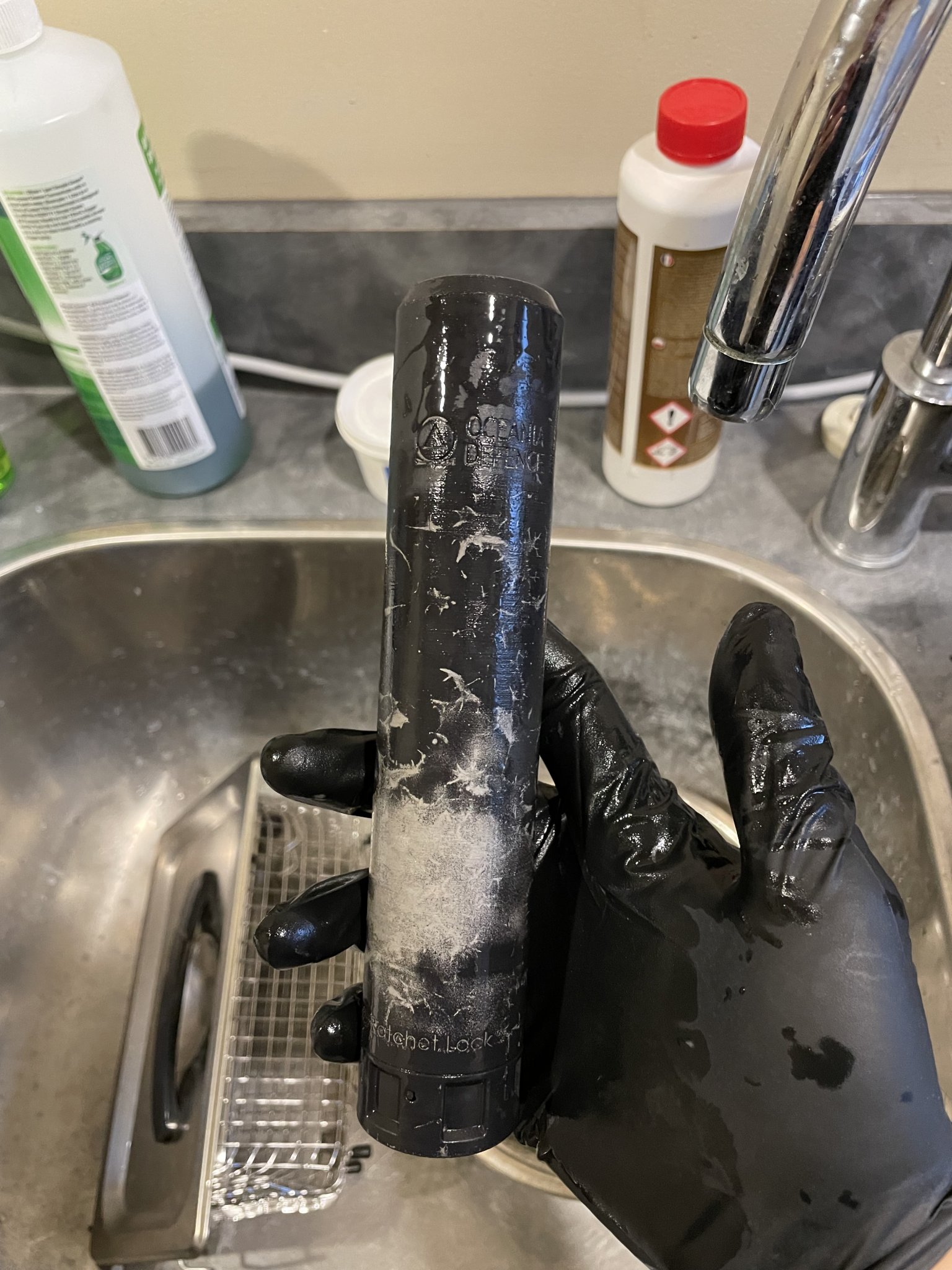

One of the downside is the suppressor is fully sealed. You have to use chemical or ultrasonic cleaner to clean it. Unfortunately you may risk tearing the cerakote off by sinking in the ultrasonic cleaner for too long.
Might want to check your inconel alloy number. 718 exists and is what I think you meant.
I have turned 625, 718, and 909. Have ground 718 and 909.
Sincerely,
someone who grinds inconel 718 pretty much everyday

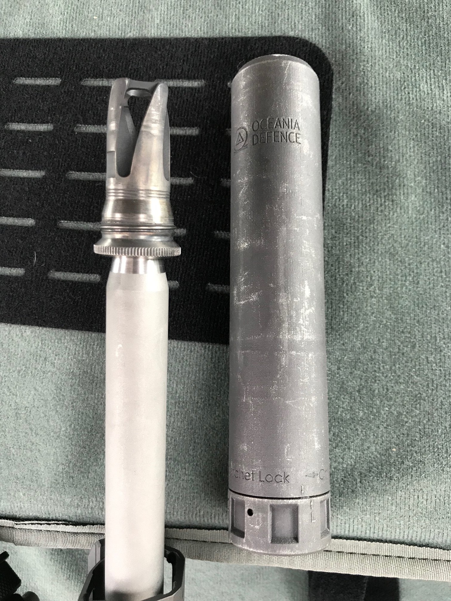

At least yours came painted.
Mine came in a Rae finish which was quite frankly crap.
Still debating using it on my 7mm SAUM.
