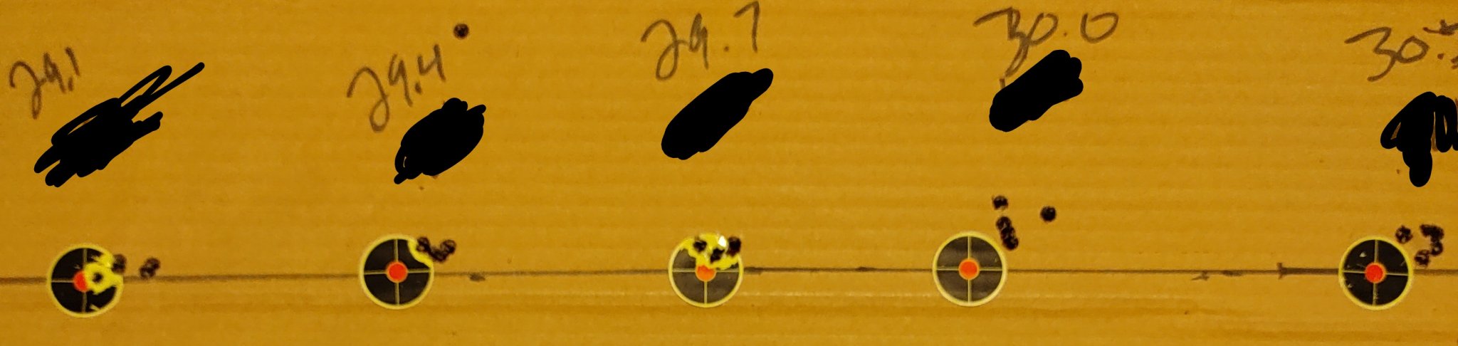

    The first picture is from fireforming and just shooting groups at the cardboard with different charge weights.

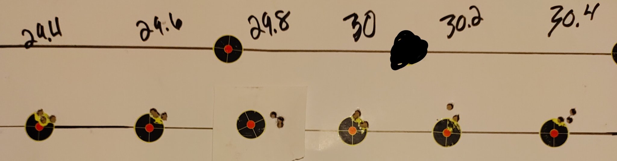

    The second is from the actual OCW test. I only did 3 shot groups.
    Questions:
    What powder charge would you go with?
    This was done jumping the 105s .020 from the lands. I understand every barrel differs, but could I tighten one up a good deal by playing with seating depth?
    Thanks fellas
    Fire forming loads

    Was there any significant wind event when you shot the 29.8 group?
    It seemed to really jump to the right compared to the ones next to it on either side.
    If you ignore the 29.8 step, the rest are a nice slow steady change which would imply you could just pick your desired speed with impunity and go test seating depth.
    I would go re-test the 29.6 to 30 to see if that jump repeats cause if it does you will want to stay the hell away from there.
    You may want to check a mild jam to see if these bullets ever cluster, even if you don't ever plan to run it jammed. For the trouble it will show you what if any effect you are getting from your throat dimensions.

    I pulled a shot real bad on 29.8. So I re did the 3 shot group, and cut it out of the paper and pasted it next to the rest the best I could that's why it looks out of wack. POI was about the same as the rest.
    I'll re test 29.6-30.0 and see which one I like and then move to seating depth.

    Just keep in mind...
    The shot group center shift is the whole focus of the OCW test pattern.
    You are looking for one of two outcomes.
    One is a few powder steps in a row where the group center shift is stable, or if that doesn't happen...
    to at least stay away from places where the group center makes big jumps.
    Being what we are, it is difficult to try and ignore the actual size and shape of the groups, but the idea is the group center is the priority.
    If possible, these are also best shot in a round-robin fashion to mitigate barrel heating and fouling effects.

    In hindsight I should have just shot an extra for the 29.8 group and left the group on the paper. Live and learn. Thanks for the info.
    Agree w/RR. Reshoot 29.6-30 or maybe even include 30.2. If nothing changes pick the charge that gives you the velocity you want and go to seating depth trials if you don’t like the groups sizes. Otherwise load up 40-60 and start gathering drop data, true your ballistic solver and put the load into production.
    Reactions: Dildobaggins
    Interesting. Not that I disagree with either of you, but I thought 29.4 was a good group. Am I missing something? Will do though. Less monkeying around use of components with 29.6-30, so I won't complain. Haha
    OCW doesnt care about group size, its all about seeing center poi alignment (or lack thereof ) and finding poi stability between consecutive charge weights.

    What was your muzzle velocity at 29.4-29.6?
    And if you’re going to do seating depth, id do one or two test samples at .020 to see if the groups are same at that distance from lands and do another at .040 and .080… reason for the huge gaps is i want to see where the groups start to open so I know the “width” of my “precision node”.
    Also don’t shoot traditional groups, shoot dot drills instead. One shot per little 1” pastie. Two rows of three pasties, maybe two separate targets. One for .020 (2 test samples, 3x2 set up) and another at .060 or .080, same set up.

    My muzzle velocity is unknown. I have a magneto speed V3 coming at the end of the week. Feel like I've been shooting in the dark since I started reloading last year.

    Good shooting. I’d go 29.6. You have a big widow there where the impact didn’t
    move. The right bias on 29.8 looks shooter induced to me. It looks like right is your tendency. Are you left handed?
    Thank you. I used your ELR 3D bag! I am not. The poi is a little to the right, but I did notice that myself, that my groups tended to go from right to left. Definitely need better technique, but my trigger is also set at 16oz which I want lighter.

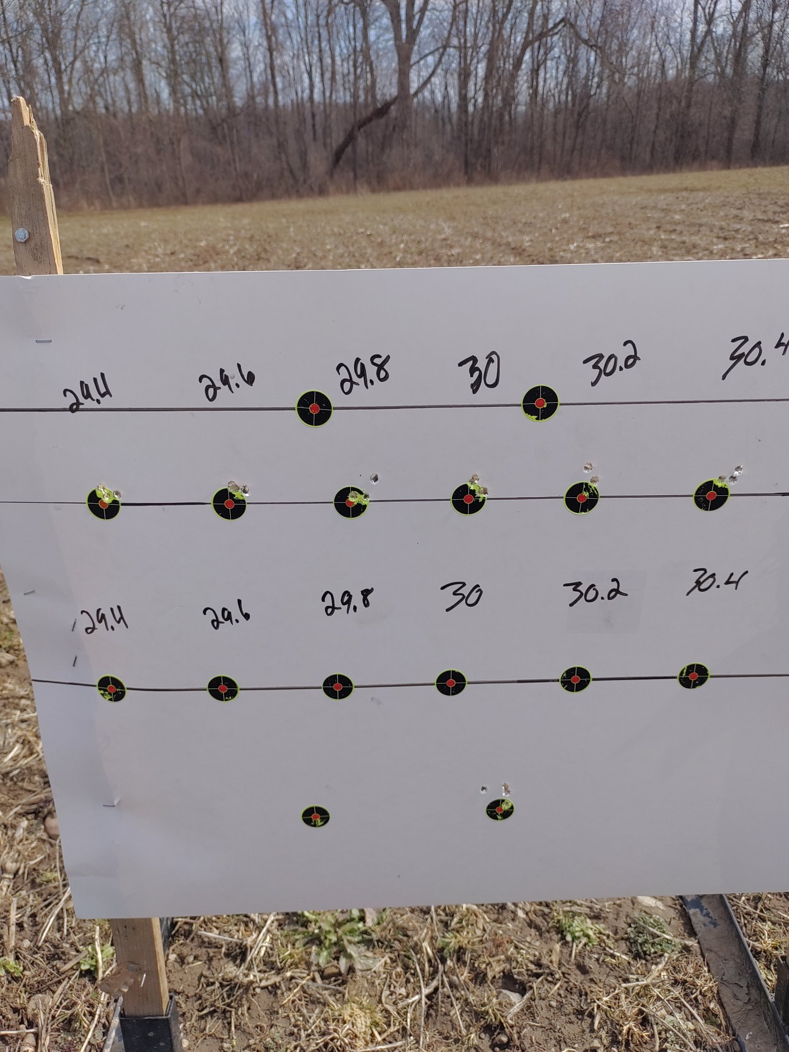

    I'd shoot this again but start at your top and work down...ill bet your upper groups will look better.
    This is the reason you should shoot OCW tests round robin. 90% of people don’t, but it’s a hugely important part of taking the shooter out of the equation. That being said, whether the OP shot RR or not, the target shows a pattern that makes sense so I’d trust it. I’d guess another node is up around 30.8-31.4
    No offense but why would I shoot the whole thing again, when 29.4-30 look like that? I don't understand what it would accomplish?
    Sorry I was just going to fix my post....had a dog fight and must of hit post as I went to get that mess stopped.
    So I'd reshoot 30.2 down to 29.6 just to verify those upper charges were not shooter error I'd also load up 4-5 of each just in case you pull a shot.
    That said I shot out 5-6 BR barrels before I moved to the BRA and the first barrel ended up at 30g varget cci450 and 105 hybrid .070 off the lands.
    Second barrel was 30g varget cci450 and seating really didn't matter so the next 3-4 I'd FF 100 pieces of brass at 29.5g then load at 30g and run a seating test.
    I agree but in most cases the more rounds that are shot the more shooter error comes into play...I personally am not a group shooter and do not know many ppl that can shoot group after group weather its round robin or just groups.
    Quick notes. I did shoot round robin. So this is my first 6br, and after researching extensively I was a little worried/odd feeling, but the reason I stopped the test at 30.4 and didn't go any higher was because I was getting very, very slight ejector marks, but a pretty hard/stiff bolt lift at 30.4 and I stopped at 30.6.
    I'll go back out and reshoot 29.8-30 because I'm absolutely 100 percent confident that the other groups were not pulled and shot well. If the others group/poi the same, then I'll leave them, and load 29.6

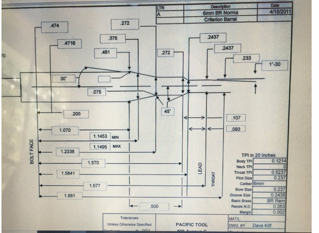

    I believe it's .94 or .93 I had the reamer print picture on my phone from a different forum.
    Thats a short free bore .104 is pretty standard and I think .130 or .135 is popular...my reamers in BR and BRA were both .145 because I found I had better groups and consistency over the life of the barrel with big jumps. I think with .98 free bore and 30g of varget you'll start to compress around .030-.040 off the lands.
    It's off the internet, so take that for what you will haha. I'm going to be doing another 6br or 22 br this summer. I will keep that in mind!

    Me seeing a guy who shot his OCW round robin AND used a PURG bag.
    Really though if you shot that test RR, 29.5-29.6 is your OCW… 100%. Your fire forming groups showed the same result for 30+ and you've got pressure at 30.4 so there’s nowhere to go.
    But shooting RR is not shooting groups at all. It’s basically doing dot drills. That’s the whole point of shooting RR. If you end up with a clear pattern on target as the OP did you can take it to the bank.
    I am not arguing with you but if you think about it the OCW IS shooting groups just a different way of doing it...if I am shooting 5 dots with 1 round then going back and shooting 1 round at each dot again for 3(or how ever many you decide to use)total rounds at each dot and trying to get every round shot at that dot through the same hole or as close as I possible can for the best group/groups seems to me like I'm shooting groups.
    Everyone has their favorite way of shooting load development I've shot most of them over the years and personally I don't think there is any perfect way its what you find works best for you and your needs.
