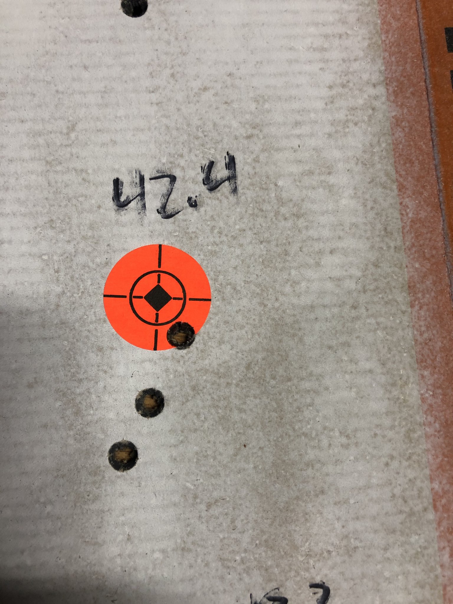

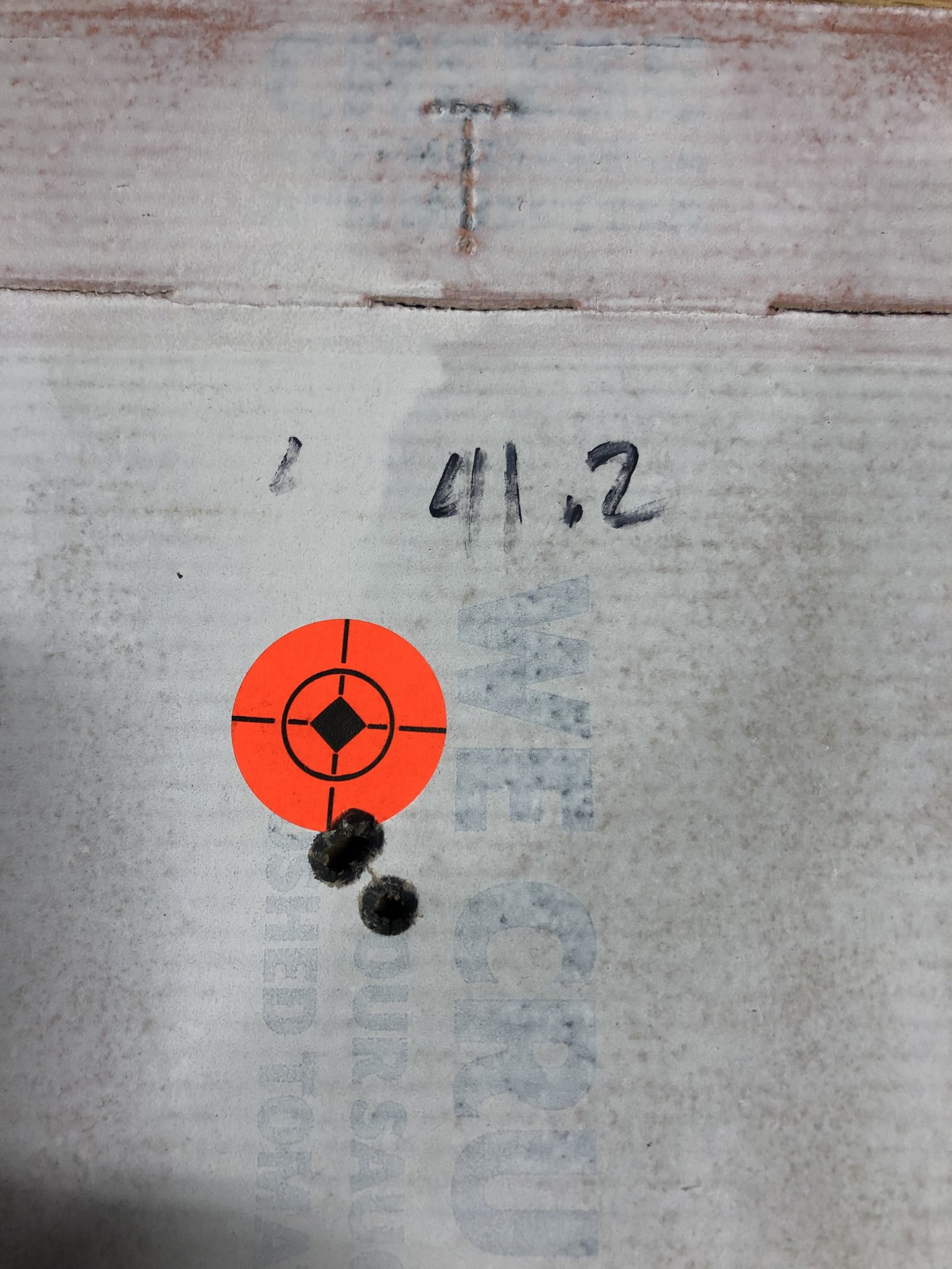

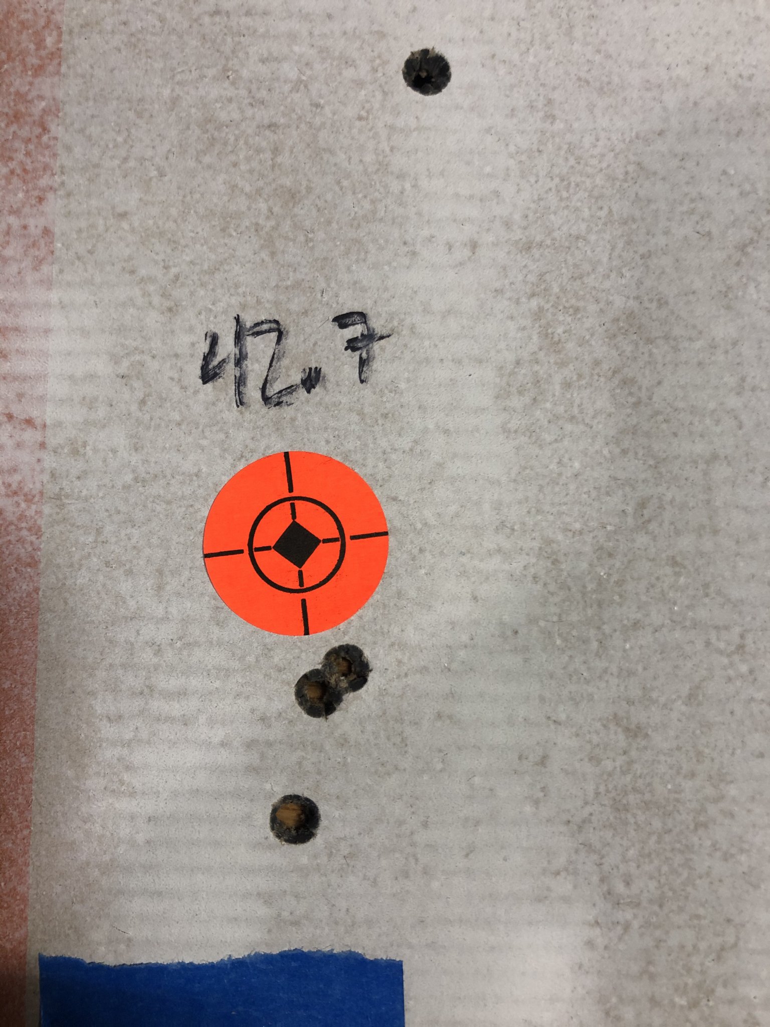

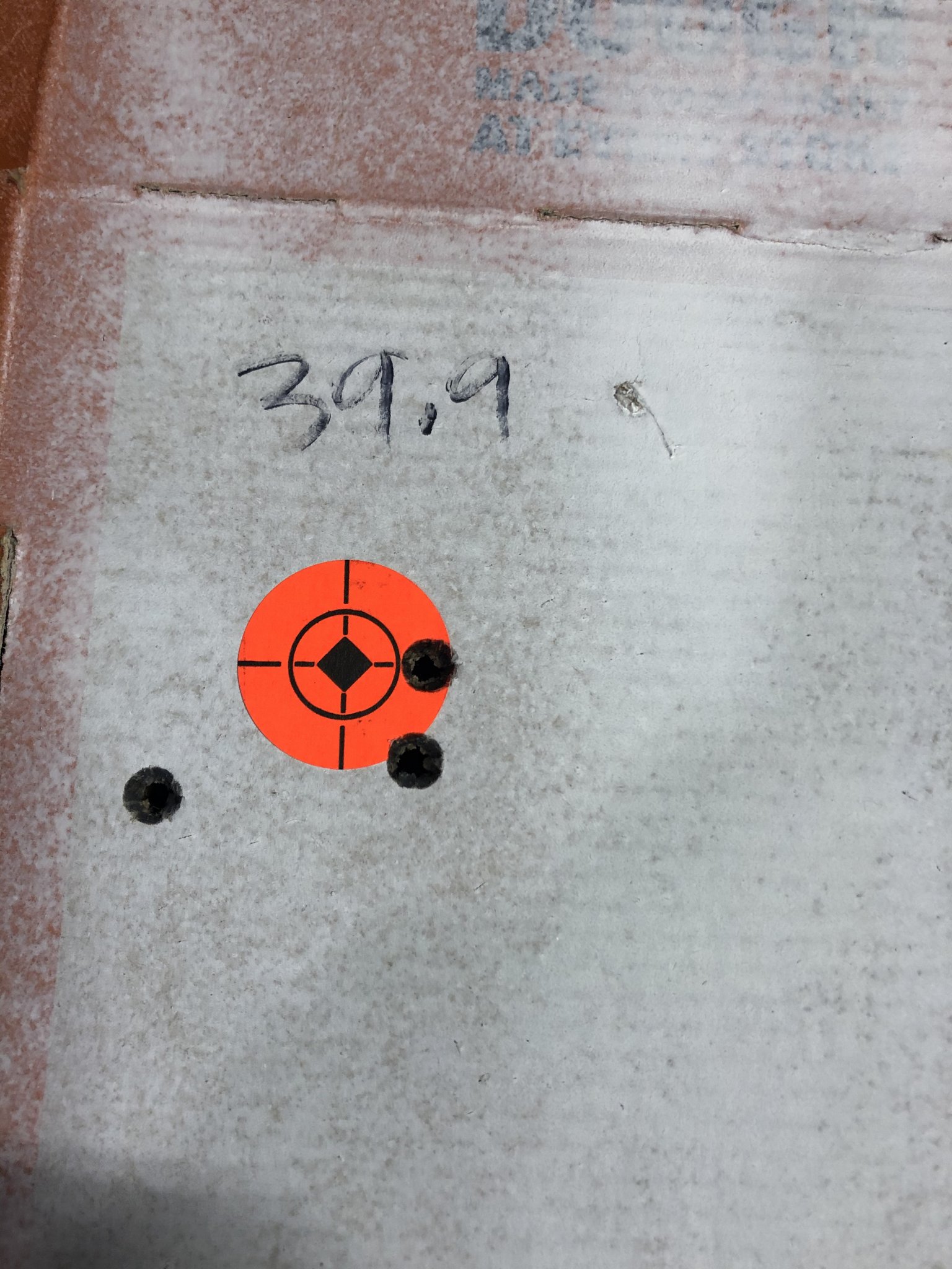

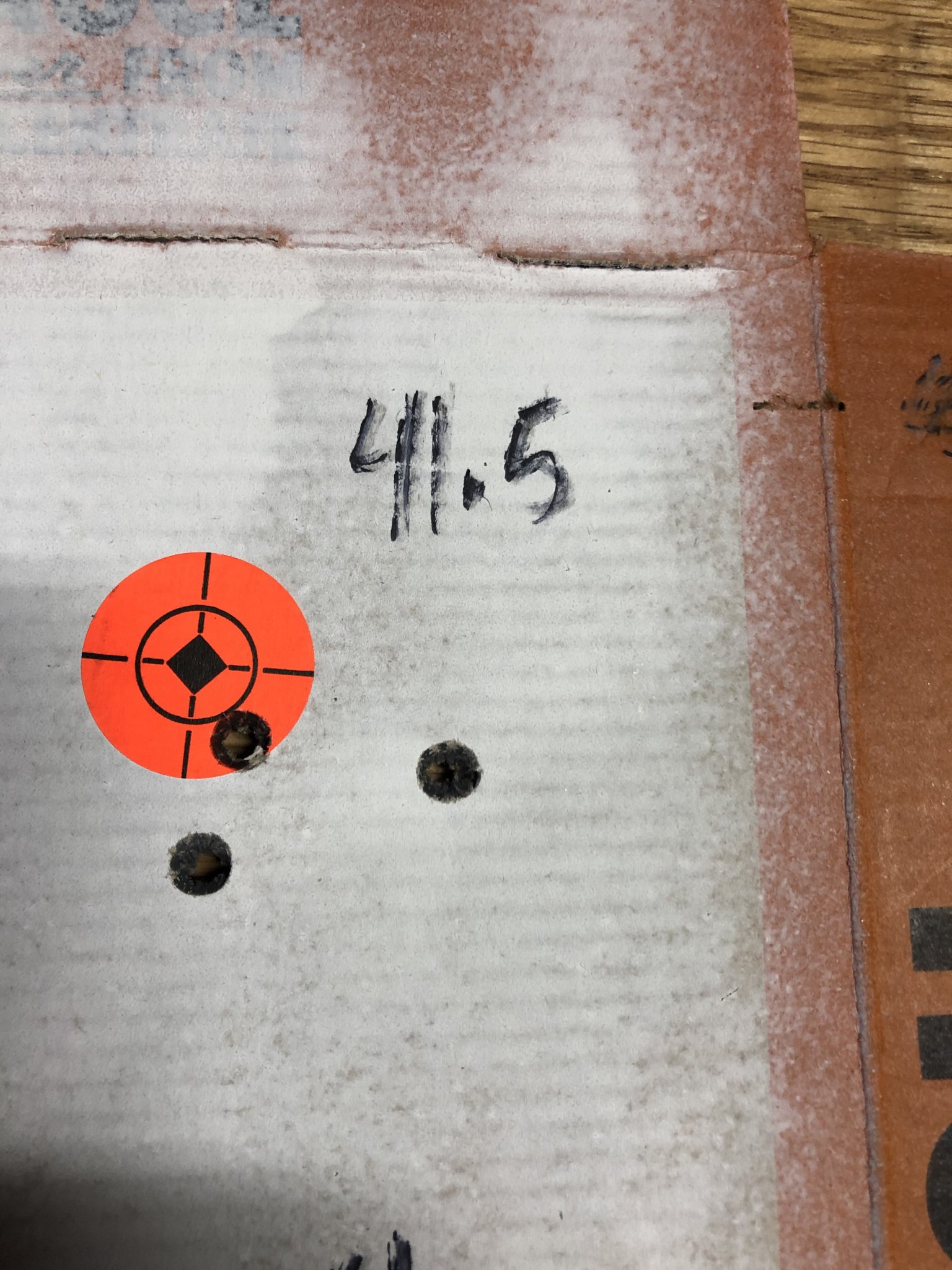

    Gents,

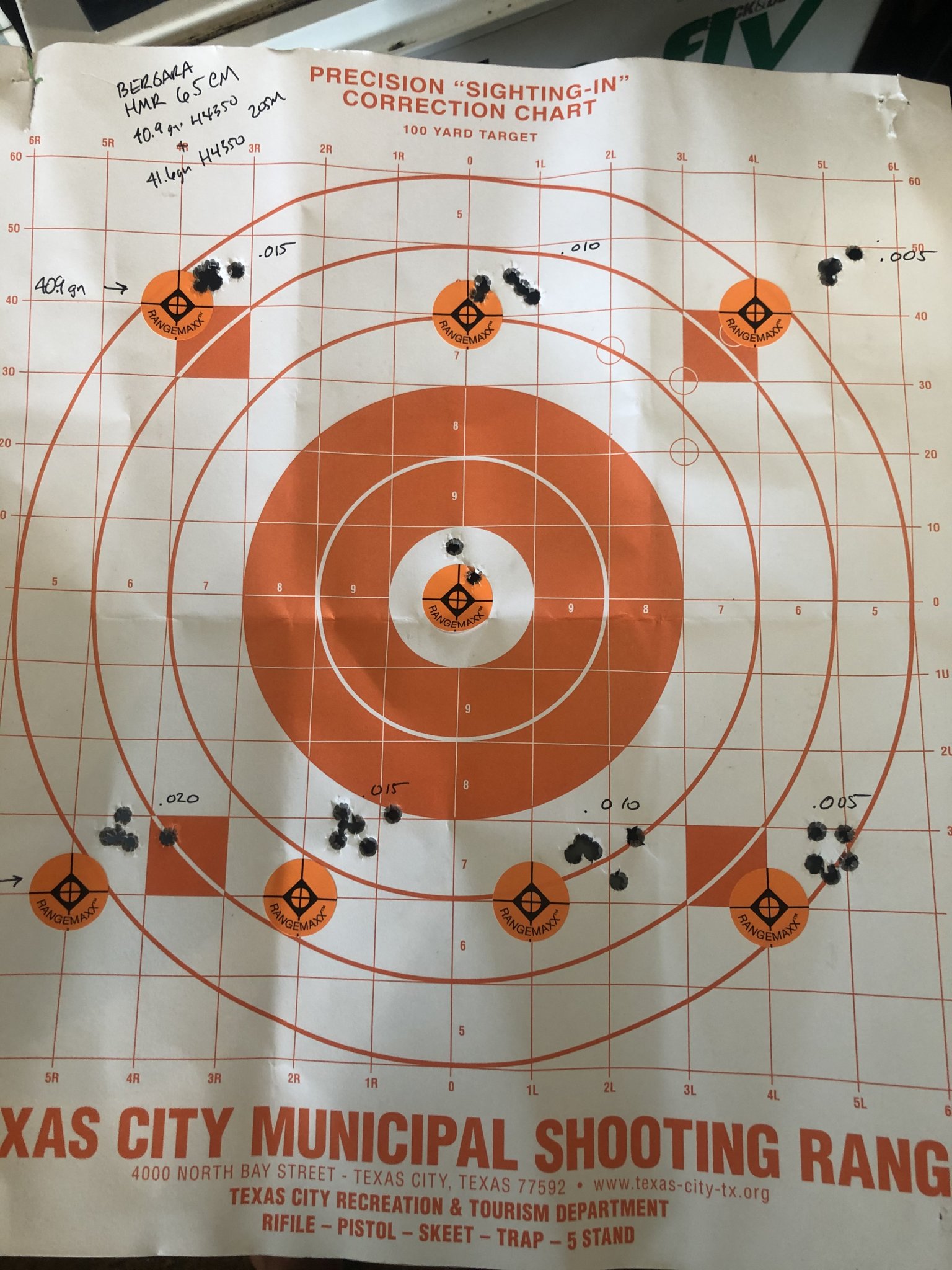

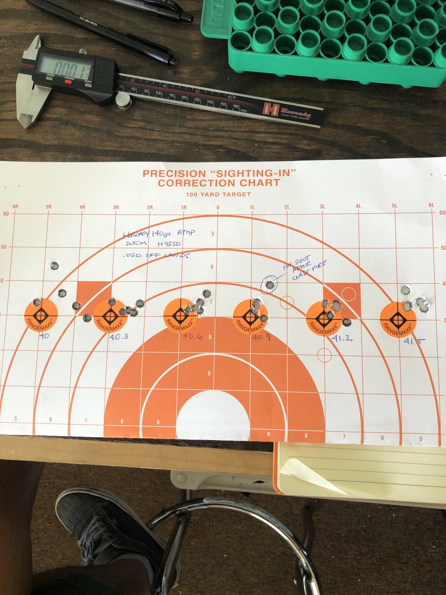

    I wanted to compare Hornady 140 ELDMs to the 140 Berger Hybrids I previously tested.
    Powder is RL16
    215M primers (all LGS had)
    brass is 1x fired Hornady, FL sized, trimmed, 0.002" neck tension, 0.002" shoulder bump
    CBTO 2.255"
    COAL 2.875"
    0.085" jump
    I think my rifle likes these pretty well. I shot the test round Robin, a little pressed for time. By far the best SD and grouping I got was at the upper end of the charge weight. My consternation is that i also experienced slightly sticky bolt lift. No obvious pressure signs in the brass or primers but I'm not the best judge. Should I continue to develop this hot load or explore the other charges. I'm new to reloading so I don't exactly trust my interpretation.
    Thank you
    Forgot to mention: Tikka CTR 6.5CM
    Charge Weight / Velocities x3 tests / SD / ES
    39.9 / 2680, 2608, 2610 / 5.3 / 10
    41.2 / 2664, 2704, 2709 / 24.7 / 45
    41.5 / 2717, 2716, 2694 / 13 / 23
    41.8 / 2770, 2744, 2719 / 25.5 / 51
    42.1 / 2780, 2761, 2746 / 22.1 / 44
    42.4 / 2759, 2763, 2778 / 10 / 19
    42.7 / 2781, 2795, 2792 / 7.4 / 14
    43.0 / 2826, 2815, 2816 / 6.1 / 11
    43.3 / 2845, 2833, 2818 / 13.5 / 27
    43.6 / 2840, 2847, 2844 / 3.5 / 7

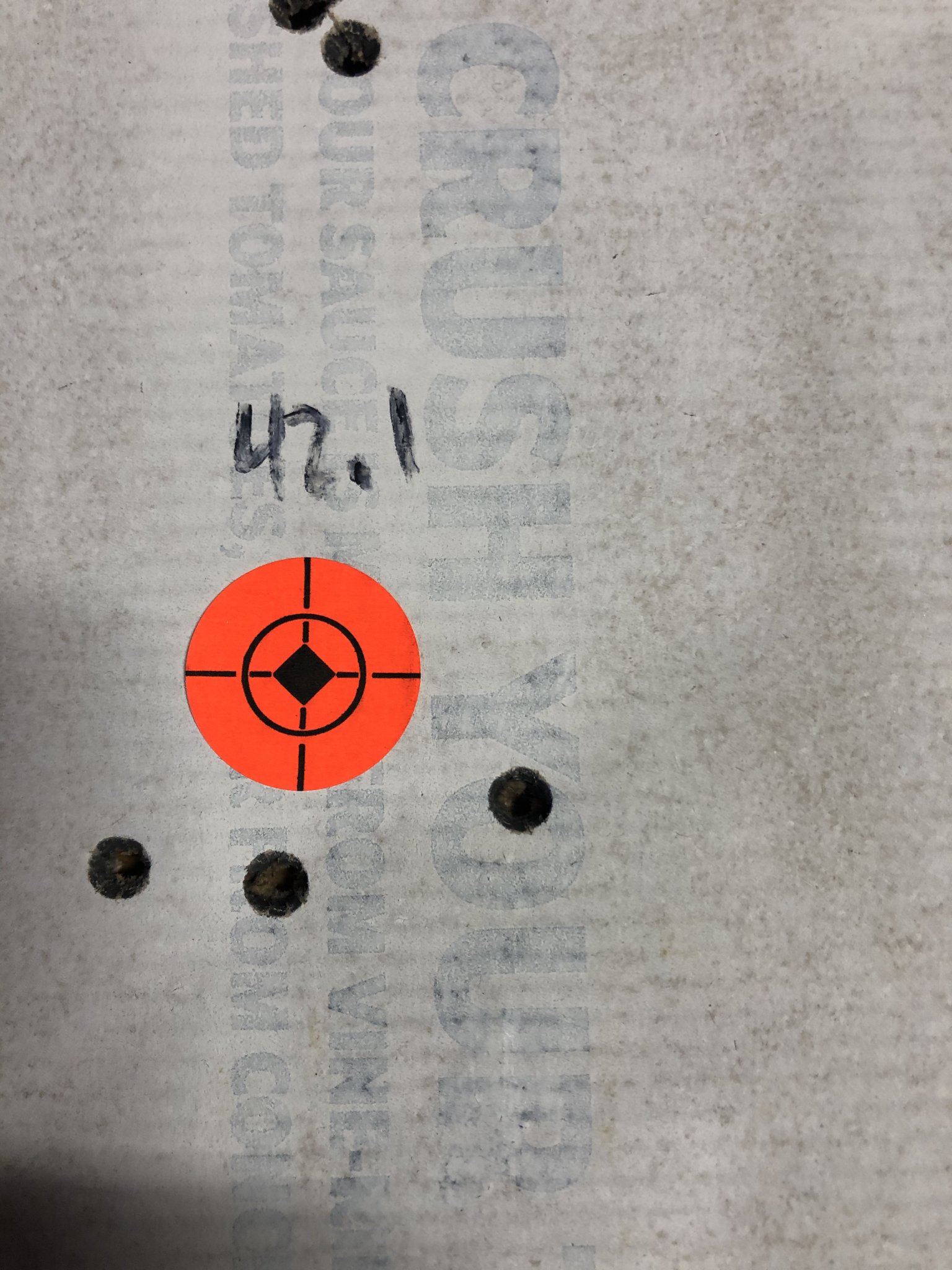

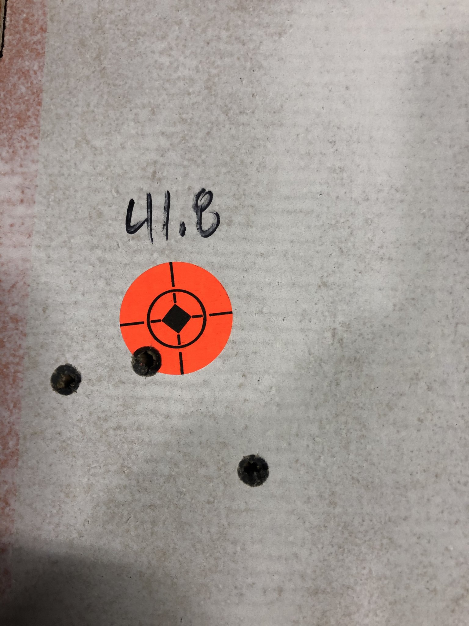

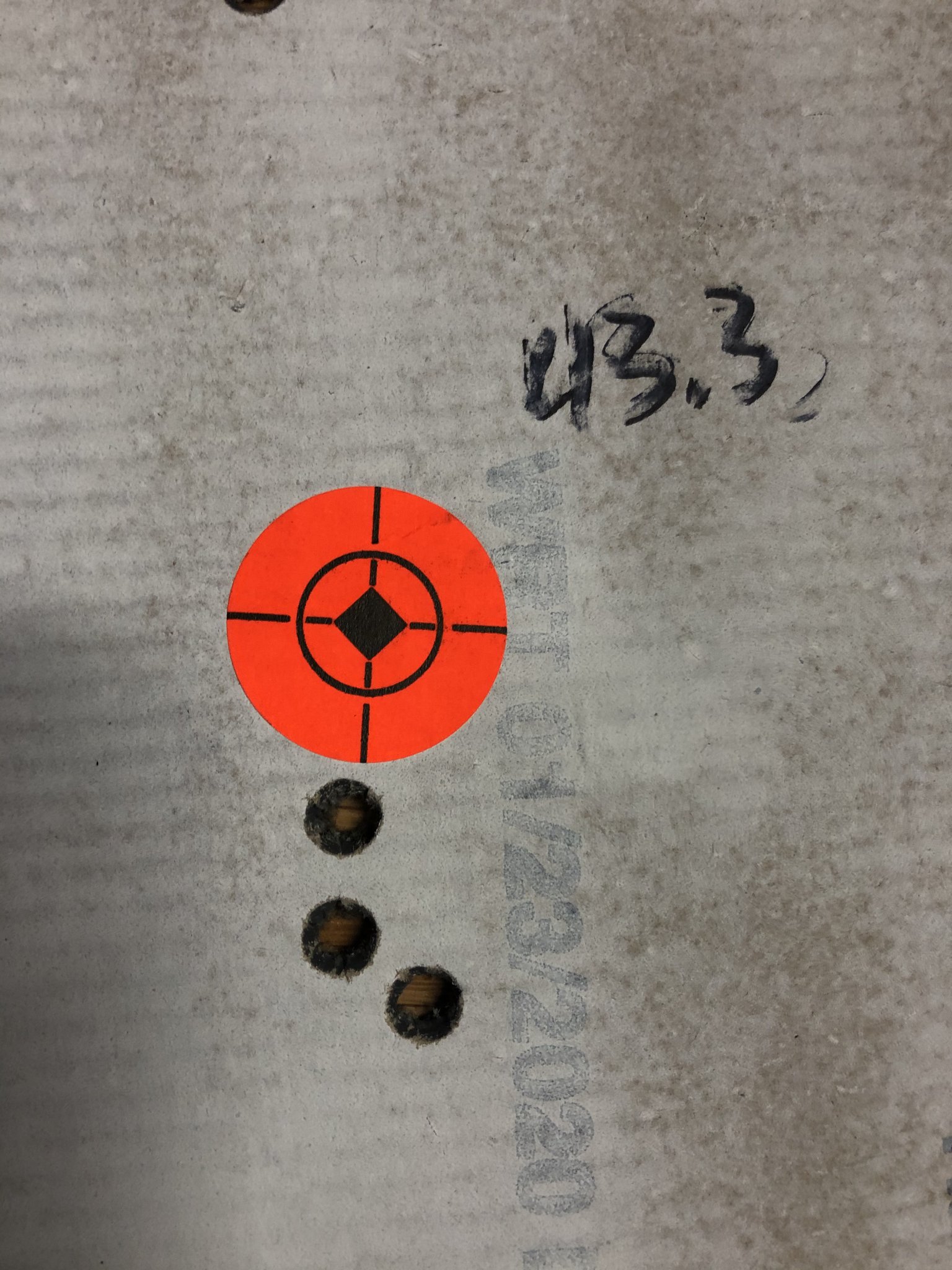

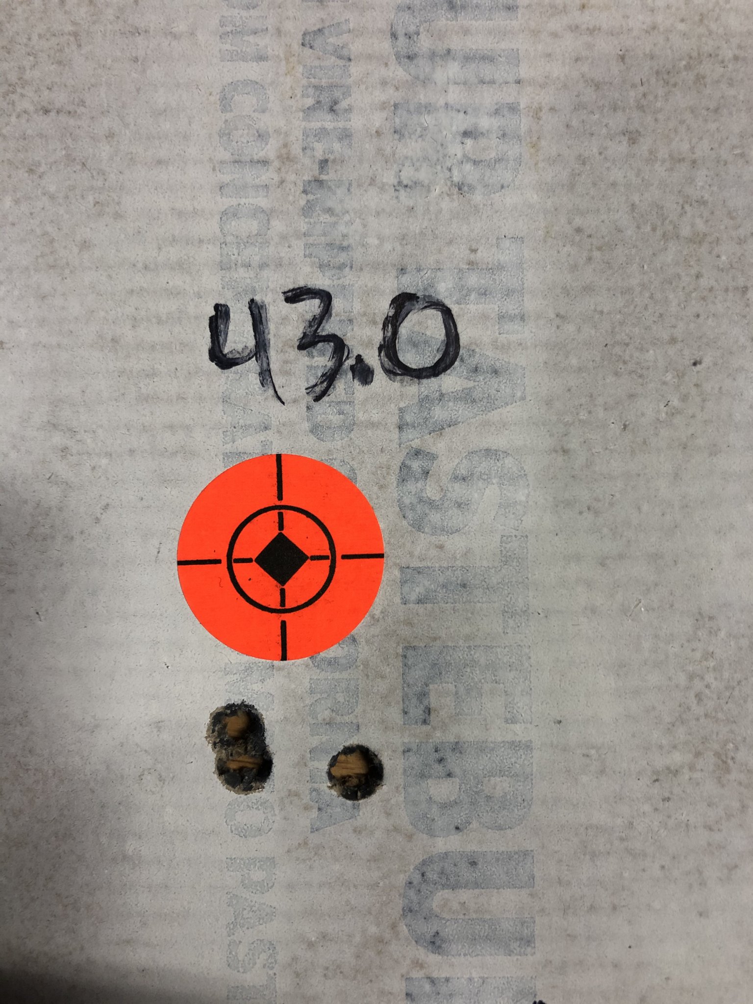

    Groups shot round robin not consecutively

    Sticky bolt is a for sure sign of pressure if everything is sized correctly. What charge weight did that start at?
    Just looking at your data, I’d do a seating depth test on 42.7. Find optimal seating depth node and load on the long side of it to account for throat erosion. Then I’d take that seating depth and load +/- .1 grain increments out to .5grain either size and narrow that node down a bit.
    42.4 42.7 43.0 was the only area where your ES leveled out and was consistent.
    I’m assuming you’re not weight charges on something like an fx120 with your ES’s being all over the place?
    Thank you for the analysis! I’ll explore seating depth variations and powder charges in that range. Charges were weighed on an old RCBS 505 scale. I tried my best to take my time and weigh as accurately as possible to the point of using tweezers to add / remove powder kernels. I definitely see a charge master etc. in my future but want to nail the fundamentals first. Sticky bolt became evident around 43.3.
    Dont worry about getting a chargemaster yet. I still do workups with a beam scale since its very accurate. I wouldnt mind a lab balance like a fx120 for speed and accuracy. But my old dillon ohaus has been rock solid for over 10 years. If you set it up and zero it properly, it will give you more consistent powder charge weight than much of the entry bbn level trickles.
    I will find my node where I can have a couple tenths variance in powder, and then I'll use my intellidropper.
    In your case I would send it with 42.7 and maybe play with seating depth or neck tension. Also, might want to go to a non magnum primer. Sometimes that can change the pressure curve enough to give me premature pressure signs.
    Yeah, I have no immediate plans to upgrade equipment. I don’t want to throw money at issues related to my reloading or shooting until I can rule out my skill level as the limiting factor. I think I might build a platform of sorts for the scale as I have to crane my neck down to align the markings. There may be some sort of parallax effect to the way I’m reading it. Thanks
    Yep, I’d run with the seating depth test at 42.7. Start at .005 off and move back .003 at a time until around .040 off lands. The seating depth node should show up easily in groups.
    Then do .1 grain increments from 42.2 to 43.0 (since you saw heavy bolt, I wouldn’t much higher). And see where the node inside that node is. Then be done with it.
    I second the recommendation to try a non-magnum primer. Even with magnum rounds, magnum primers haven't given me as good of SDs and ESs as regular primers. I don't hunt or shoot in truly frigid weather, only in teens (at most) and twenties, and haven't had an ignition issue.

    What is the reason that the 42.7 load caught people's attention? Is it because it is in the middle of a group of three low SD/ES loads?
    Yes. Load stability.
    You can tune your group size down pretty tight through seating depth. Most incorrectly just pick something like .010 .020 or .030 jump and then try to tune the load to that. That is backwards.
    SD/ES is controlled via brass prep and charge weight. Group size is controlled via seating depth.
    Find your charge nodes, the do seating depth tests in the middle of those nodes.

    I've found those bullets love to be seated from 5 thou to 20 thou off the lands. Anywhere in there should shoot pretty damn well. I haven't found the need to chase the lands with these bullets.
    Like others, I do bullet seating depth tests because it's a necessary step to optimize precision. Bullet seating depths for precision, velocity and powder charge tests for SD/ES.
    Agree with this. I use BR2s in my 300 and BR4s for my SRP stuff. If you're shooting in freezing temps, then a magnum primer might be warranted. Fortunately for me, I never have to do that :D
    yeah, I fuicked up and got impatient and bought Magnum primers as that was all that was available. feel like i should start all over.
    Honestly, it's not a fuck up. It's one way to go vs another. I have 215Ms for my 300 as well - I just found the BR2s to be more consistent.
    By the way, that 40.9 gr group is pretty good, minus the flyer. But many times when you see a group like that with one outlier, it's the shooter responsible for the outlier, not the load. Then your .005 and .015 seating depths are both very good as well. We're it me, I'd load up 20+ rounds of each and validate.
    EDIT: Keep the 205Ms for now. You got a good group with the load test, then good groups at two seating depths using the same load. One more validation with a decent sample size will tell you whether it's real or not.
    Reactions: Gregor.Samsa
    Thanks. I’ll post up results of the seating depth test when I can get out again.
    For prs, probably fine to just pick a middle node somewhere with not too much seating tests.
    But you won’t find many F class and such not doing seating depth tests with any type of bullet.
    My goal is to make the best ammo possible. Otherwise I’d just run 6cm with hornady 108’s and be done with it. So I tend to look at the disciplines like F class for loading examples and advice.
    Your correct f-class shooters are about as OCD as it gets about reloading just below BR guys!!
    Yep. That’s why when it comes to loading “perfect” ammo I take advice from people with an F class or Benchrest background (even if they shoot prs now or mix it in).
    And I take advice on ffp optics, building stable positions, shooting supported, etc etc from PRS shooters.
