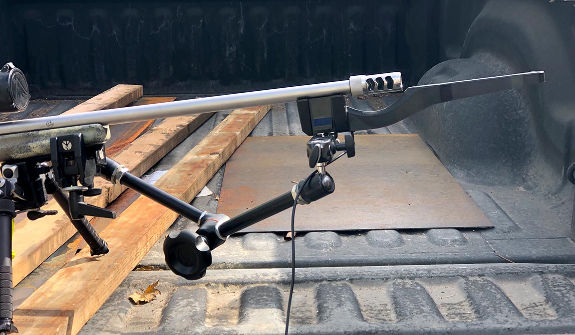

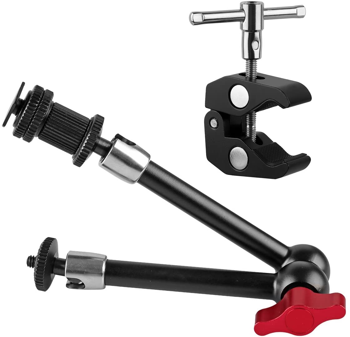

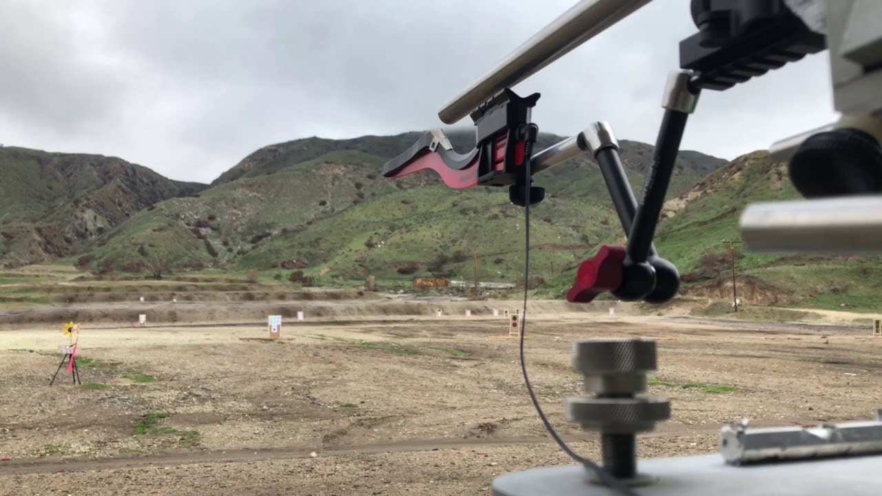

Sounds like the DIY "magic arm" mount would solve your problems. Pretty cheap to make and can suit any angle, any stock. The parts can be bought off amazon and just drill and tap the QD pic mount in the front to accept the magic arm. Note, the first pic is not my rifle and this is not my idea, i found it on the internet yesterday and ordered the parts today for an off barrel mount that won't cost me hundreds of dollars because I live in Canada.
View attachment 7594840View attachment 7594841View attachment 7594842
I've got a few magic arms for mounting remote cameras and lights, that would be and easy fix. I will probably still use my tripod for a lightweight wood hunting stock. Easy to mount with a pic rail.

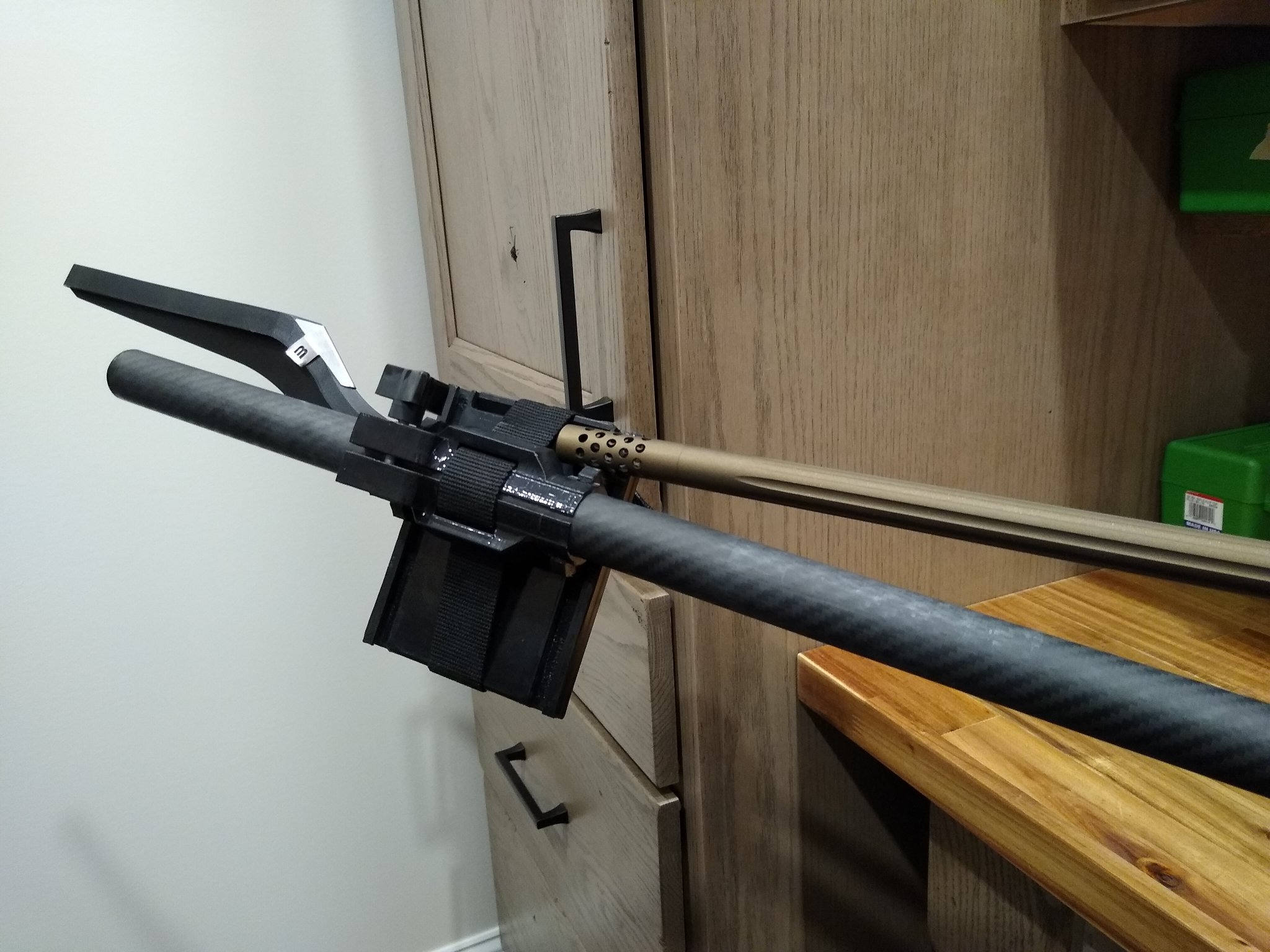

I am confident you won't find a nicer or more adjustable mount out there than mine, and if you value your time worth much you won't be able to rig up your own for less. These have been really popular and you will like it!

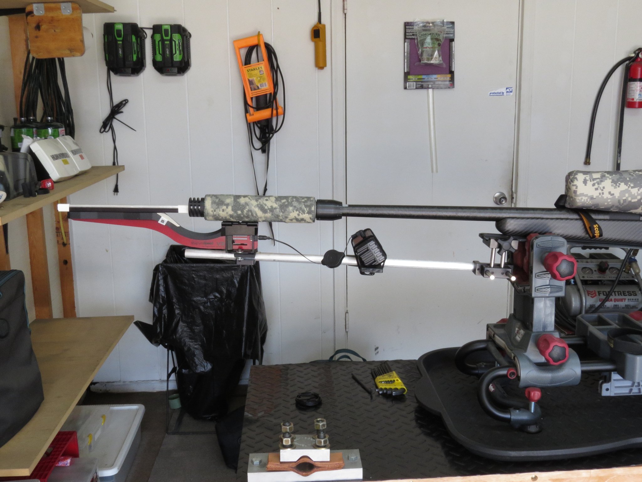

Will it work with a stock that doesn't run parallel to the barrel? These pics are of Wiser Precision's mount. Wiser have been very helpful and I value the service they provide. However, as you can see I cannot angle the rod nor bayonet to get it parallel with the barrel. In this case, the rod is too long and cannot be angled away from the bore. Also, the bayonet cannot be adjusted or "canted" to be parallel to the barrel. This obviously is necessary not only to avoid shooting the bayonet but also allowing both sensors to read. I spoke with your company earlier this week. They seemed genuinely interested in helping but also stated, as does your site "no cant adjustment".

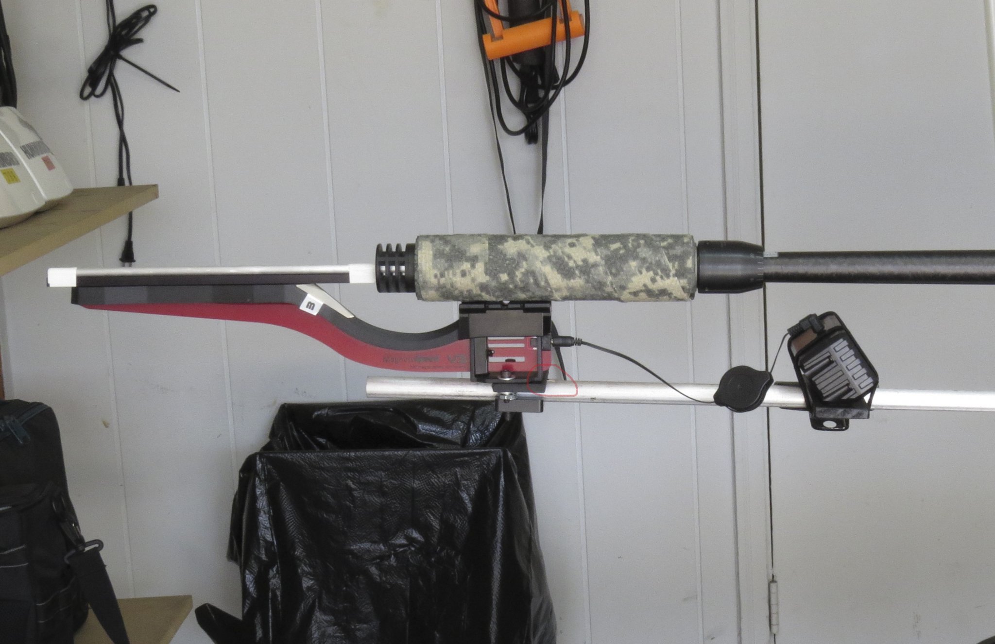

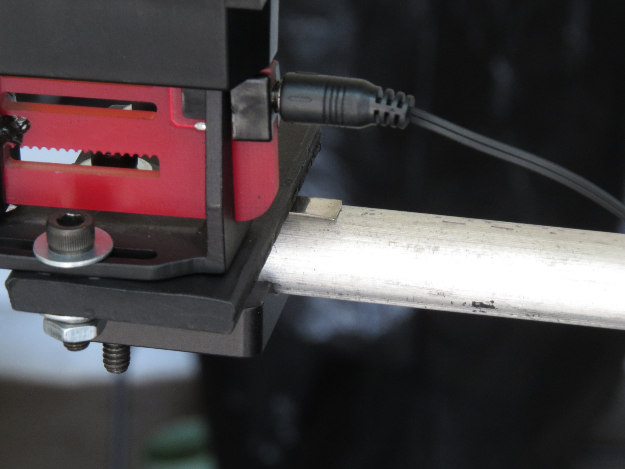

I don't know why MK keeps telling people they won't work with a contoured stock all you have to do is shim the bayonet mount to level it.
Small shim inserted at back of mount to bring the nose down to a level position.
I've been using mine like this for close to 2 years.

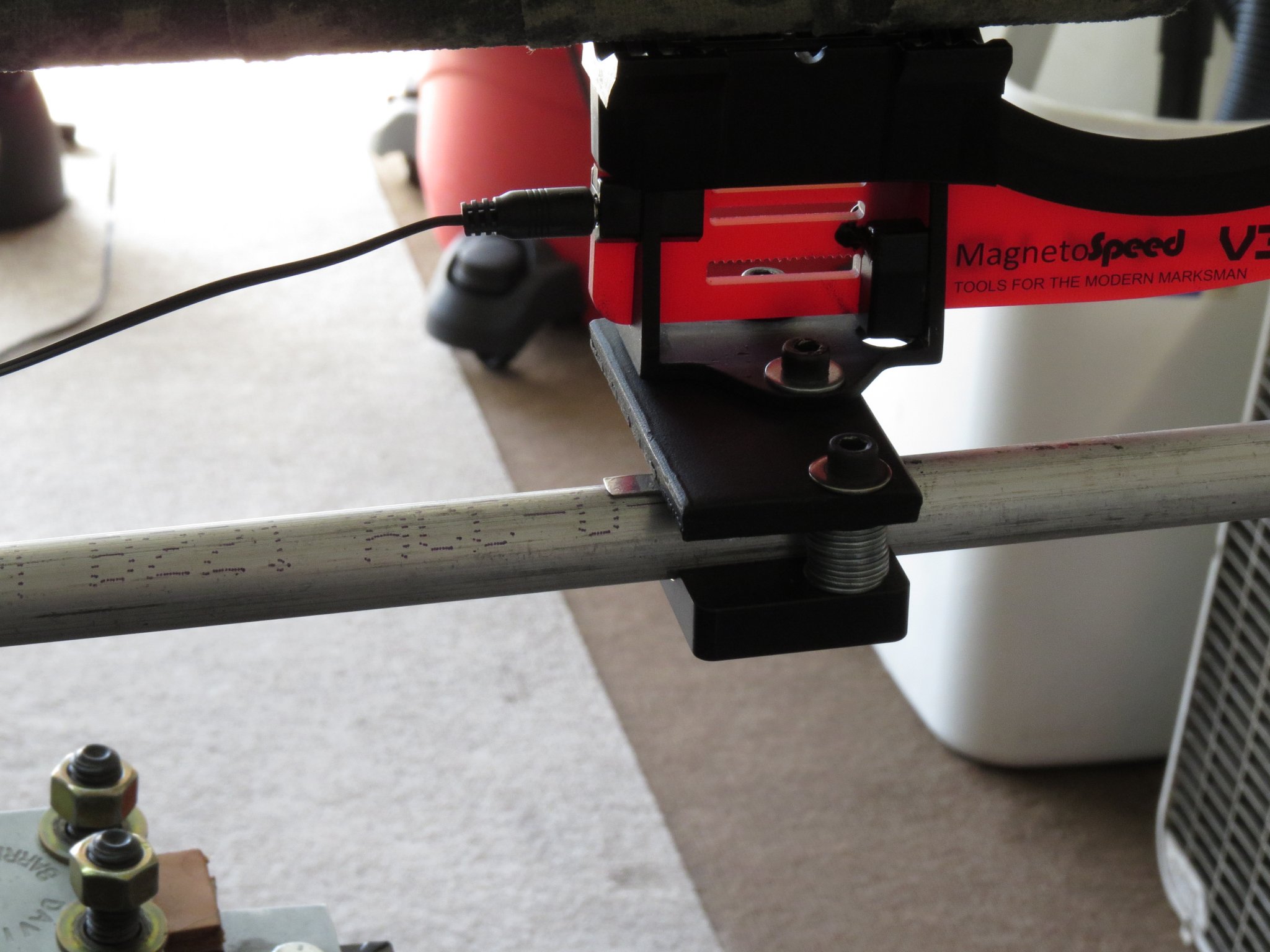

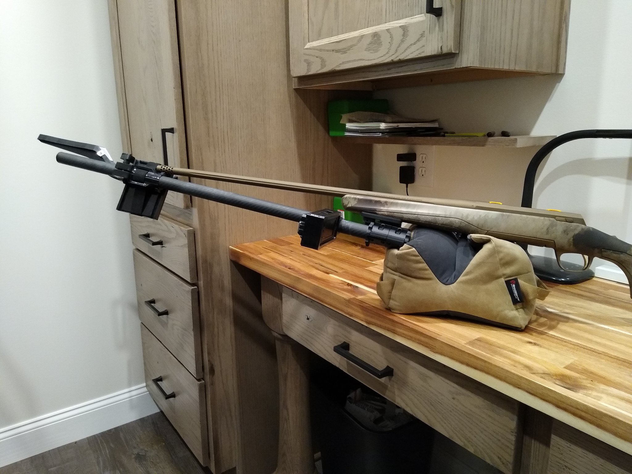

As it sits, it will not work with things not being parallel to the barrel.
There are a few options, you can shim the bayonet vs it's clamping pieces, or you can shim the rail the device is mounted on. Third option is you can use a bender on a longer Arca rail, which turns out awesome if you know what you're doing, but obviously requires a bit of knowledge.
Sadly I can think of no way to add rock solid cant adjustment at a reasonable price. Sure it can be done, but not without substantially raising the price :(

JGR1953 gave me the same solution. I'll give the shim a try and order your product. Not sure what the lead time is as your site says "backorder" I already drew plans on a toothed aluminum ball head for the bayo. This may give the clamp for the ball head the friction it needs to stay in place under recoil. You guys know more on the validity of that idea than I. Thanks for your help and great job on the Bullpup Chasis! I shot one at a private event without the bolt ext and the accuracy was great. Having the action closer to my shoulder seemed more natural.
No factor -0rder placed. A lot of rifles today have a parallel handguard, but I get plenty of folks with a contoured stock that want a load worked up. So hopefully this all will make mounting the chrono go much better.
I've got a few magic arms for photography work. Used them to mount cameras on backboards, strobe lights clamped to rails, etc.... Just got one out to use on my magneto speed. Clamp will mount on a chassis or a stock and arm articulates where you need it to go. I could remove the clamp and put an arca mount on it but I don't think it is necessary. Threw it on for a photo.
Here's a knockoff of the manfrotto for less, https://www.bhphotovideo.com/c/product/1310404-REG/impact_20_pivot_arm_with.html/reviews

He stated with longer barrels, cans, it wasn't reading as desired. I have no idea so don't shoot the messenger haha.

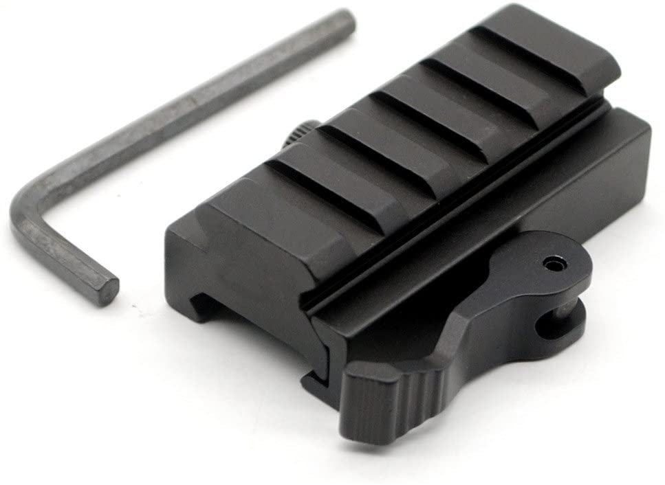

He wanted a pic rail at the end of my typical magneto mount.
I guess that makes sense. Probably not too hard to attach a chunk of pic rail. I guess there is also a parabolic adapter that supposably increases its detection range out to 3m.
