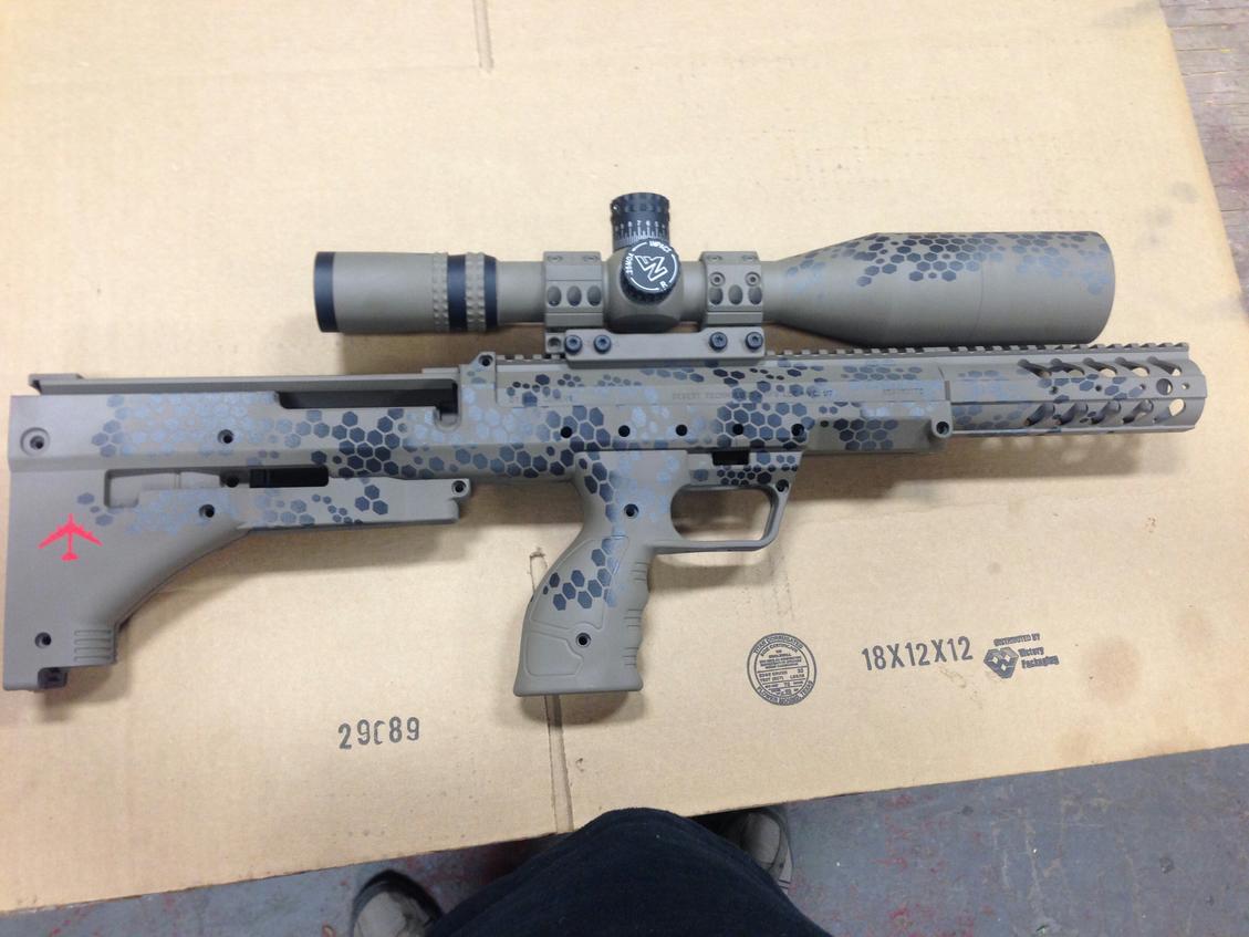

I did that exact thing. Took me weeks to read everything, but I read every single post while waiting for my rifle. Which I just got a picture of from the cerakote guy with its new paint job. Can't wait to get it back and put together.
Sweet Spray I wanted something similar to that scheme but maybe different color. I think i'll wait a few years for my rifle to get dinged up a few before getting some work done. Thanks for sharing!
