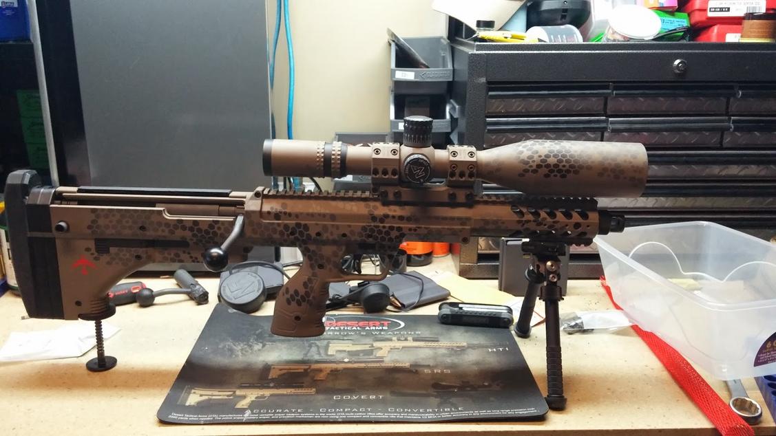

Great paint job on the rifle. Did you make your own stencil? I have made one for the multi-cam type pattern and have done a handful of rifles with it.

Actually I sent it to Metal EFX to get cerakoted they did a great job on it.
