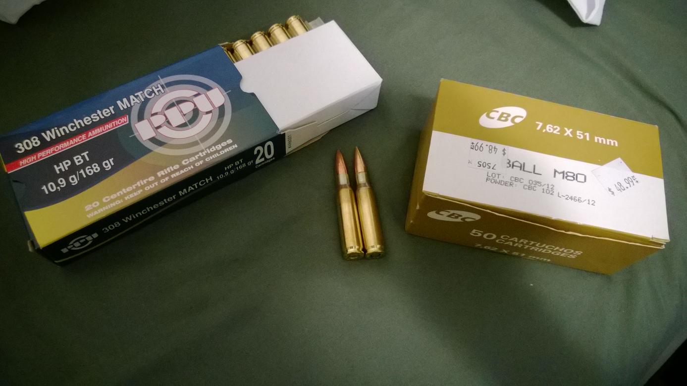

I was talked into buying some cheapo ammo which I'm not sure is going to work for my 308 chambered DTA. It's 7.62x 51mm it's the same shape and size as the 308s but the shop guy said it may have a little more kick to it. Is it a safe bet to say it's okay to fire it? Anyone got any input on this?
Generally discouraged... What manufacture and bullet weight? If it is true 7.62x51 NATO ball you probably are better off saving it for your FAL/HK91/M1A etc. On the whole 7.62x51 vs. .308/5.56x45 vs. .223 I have always stuck by the adage: the US can go to NATO, but NATO can't go to the US meaning .308/.223 ok in NATO chamber, but not vice versa. I have heard some debate that Federal Gold Medal Match 762x51 is in all ways identical to their .308 GMM, but nothing definitive. If you're not already handloading-start. If you are dead set on not handloading try some Fed GM308M2 175.gr, or your selection from Hornady. I like Berger 175gr. Long Range Boat tail, Lapua .308 brass, Fed 210M match primer, and 44.1gr. Hodgdon Varget, seated long @2.910" COAL in my covert 16" 1:8. Like the man said, don't put cheap ammo in your expensive rifle...
Here is a picture of it on the right next to a true 308. Again it wasn't my intention to buy the cheap stuff I was talked into it with the assurance it would be just fine. He looked up the rifle and was like "Yeah Yeah It will be just fine". WP_20131105_001.jpg

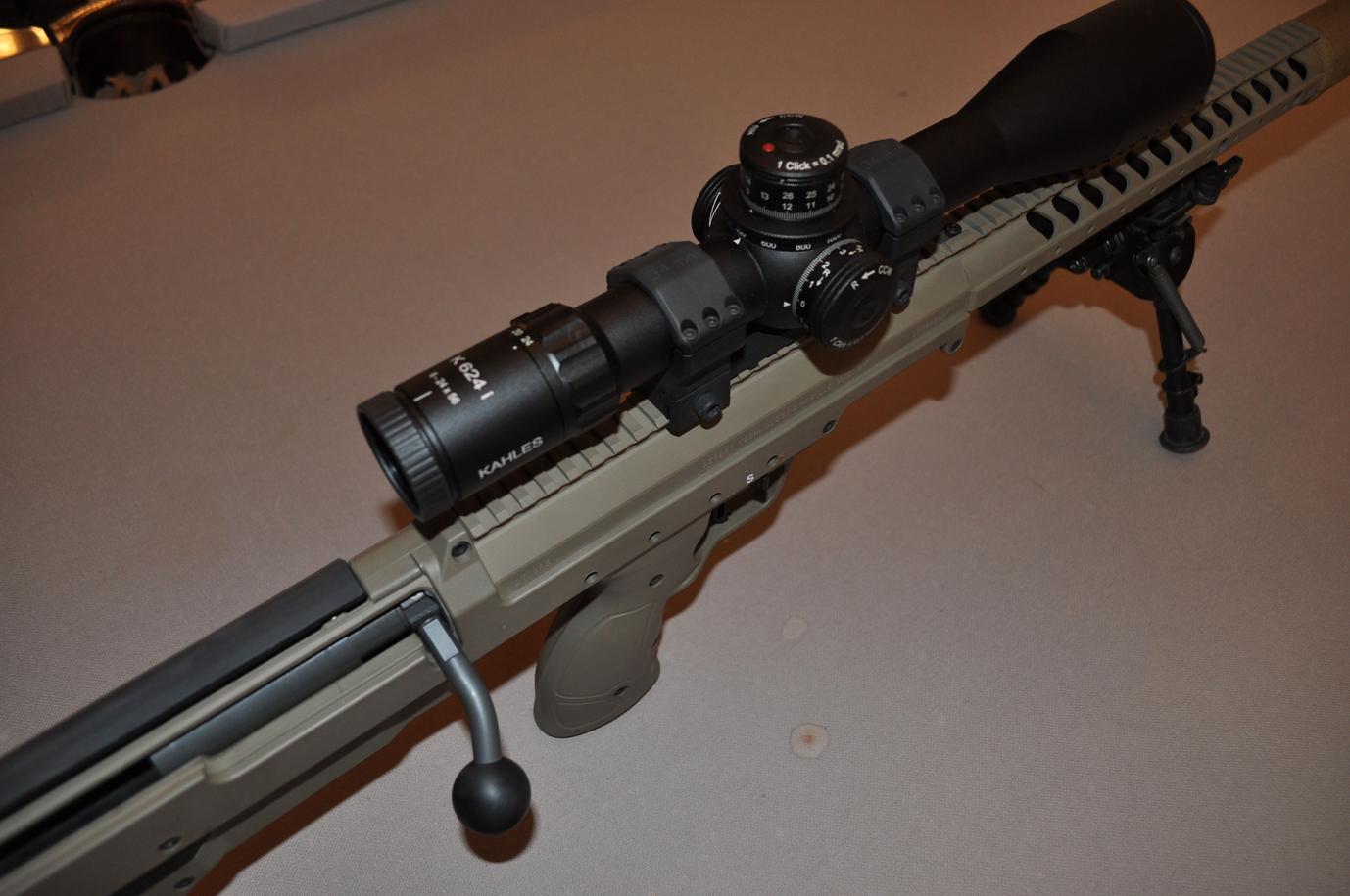

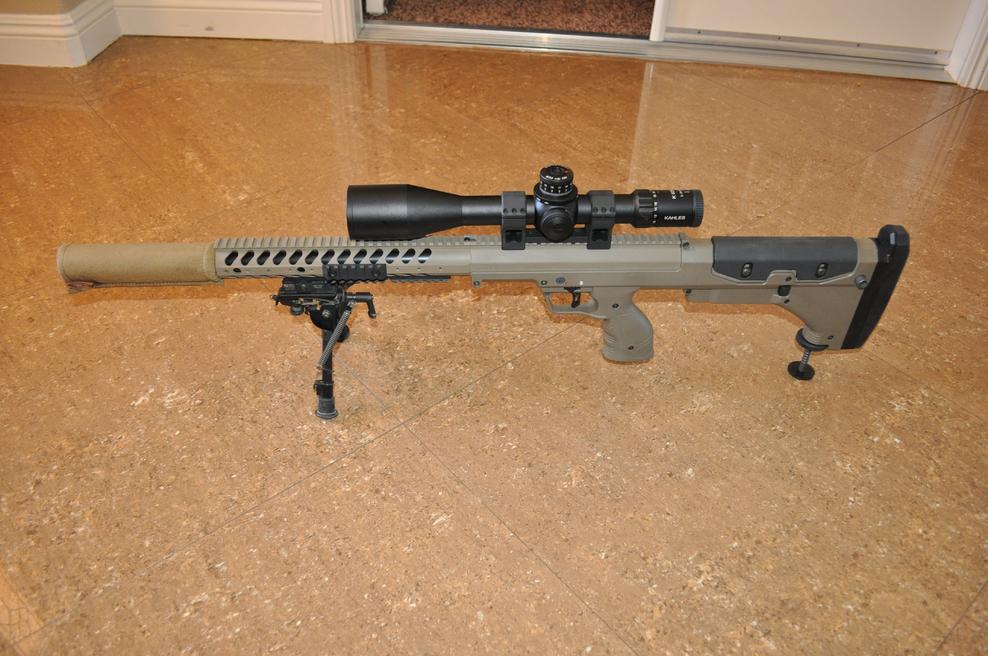

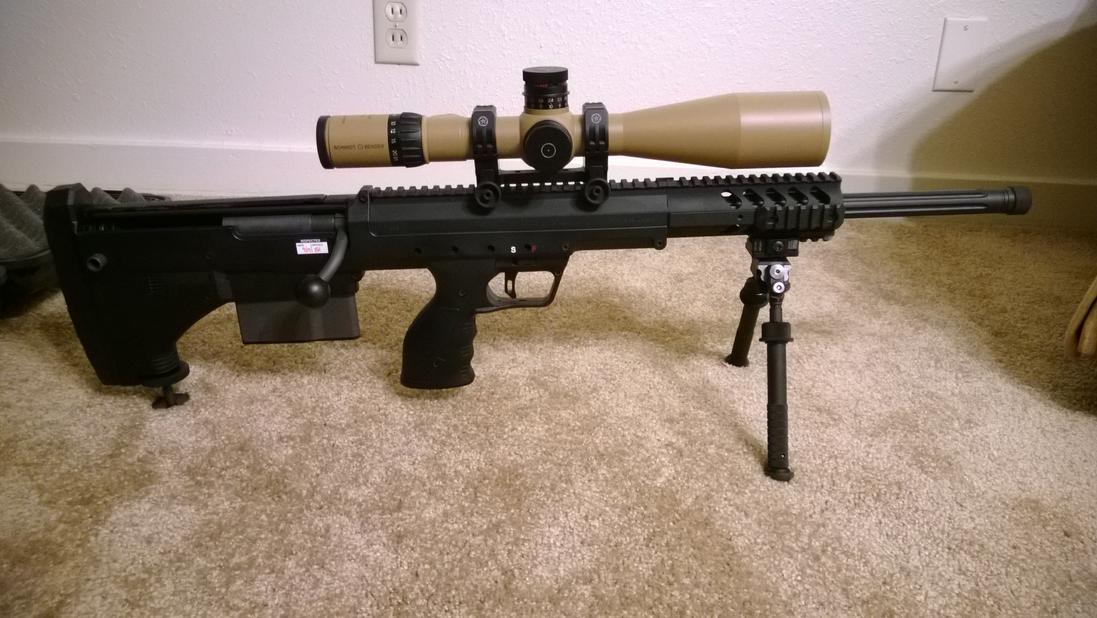

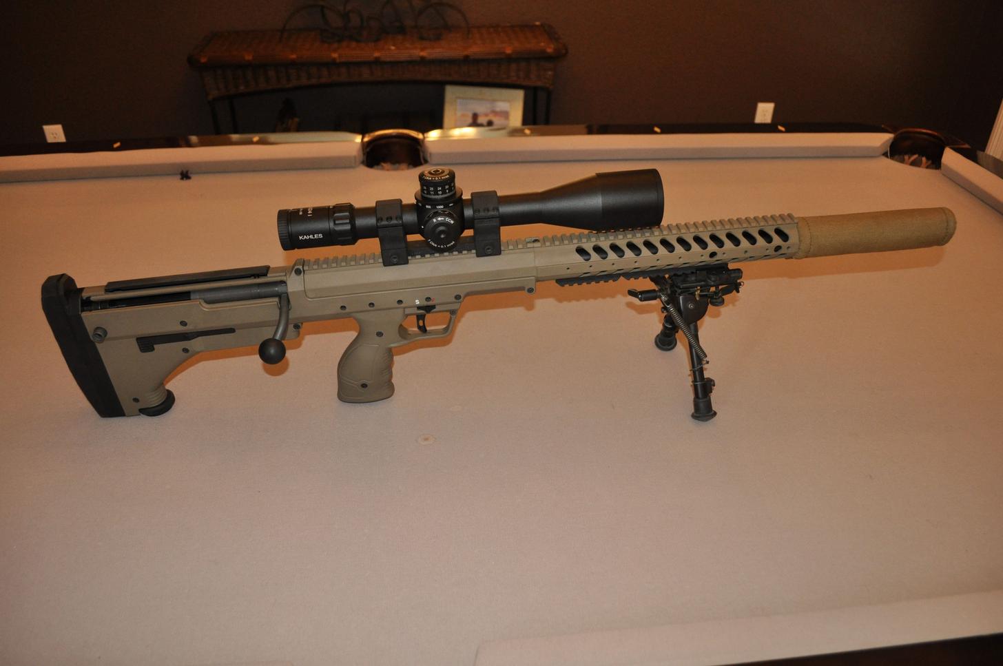

Guys, I am very proud to announce that I am now a sponsored Desert Tactical Arms shooter. Nick and the crew have been very generous in assisting me in my shooting career. I have qualified for the Precision Rifle Series Finale and due to the help from DTA I will be able to shoot the Finale with a new A1 SRS and Kahles scope!
One of the things that I am asked to do is help with any questions and provide help on this and other forums. I will do my best to answer questions here and through PMs.
Thanks,
Ty

Damn Ty, looks like Nick gave you my setup :D
I'd love your feedback on the Kahles as I'm thinking of getting that instead of S&B PM II
Thanks RMW. Would you say it's 'harder' to shoot groups with it, or it just takes more practice to be consistant with?
It is more than nice. Flat out ridiculous! The Kahles is all that they say it is, a Schmidt killer. The scope its self has had lots of press and reviews already, so I plan on doing a write up of the reticle it's self as soon as possible.
