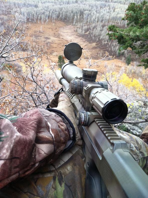

That is exactly the shot I am expecting on next years hunt. That was the whole purpose for the 300 WM. You can directly thank Ron White and the DR Long Range Concepts guys for turning me on to the DTA SRS. I have shot this platform in .308, and 338 LM and fell in love. It was almost cheating in my eyes. Using decent fundamentals and glass the consistency is almost stupid. There will be at least 4 of us on the hunt next year in Wyoming using the DTA. 3 of us being prior military.
Dropped a 173" muley with 338LM at 823 yards a few years back, one shot kill it was awesome, of course it was down in a nasty hole and it took all day to pack out but it was worth it. :)
