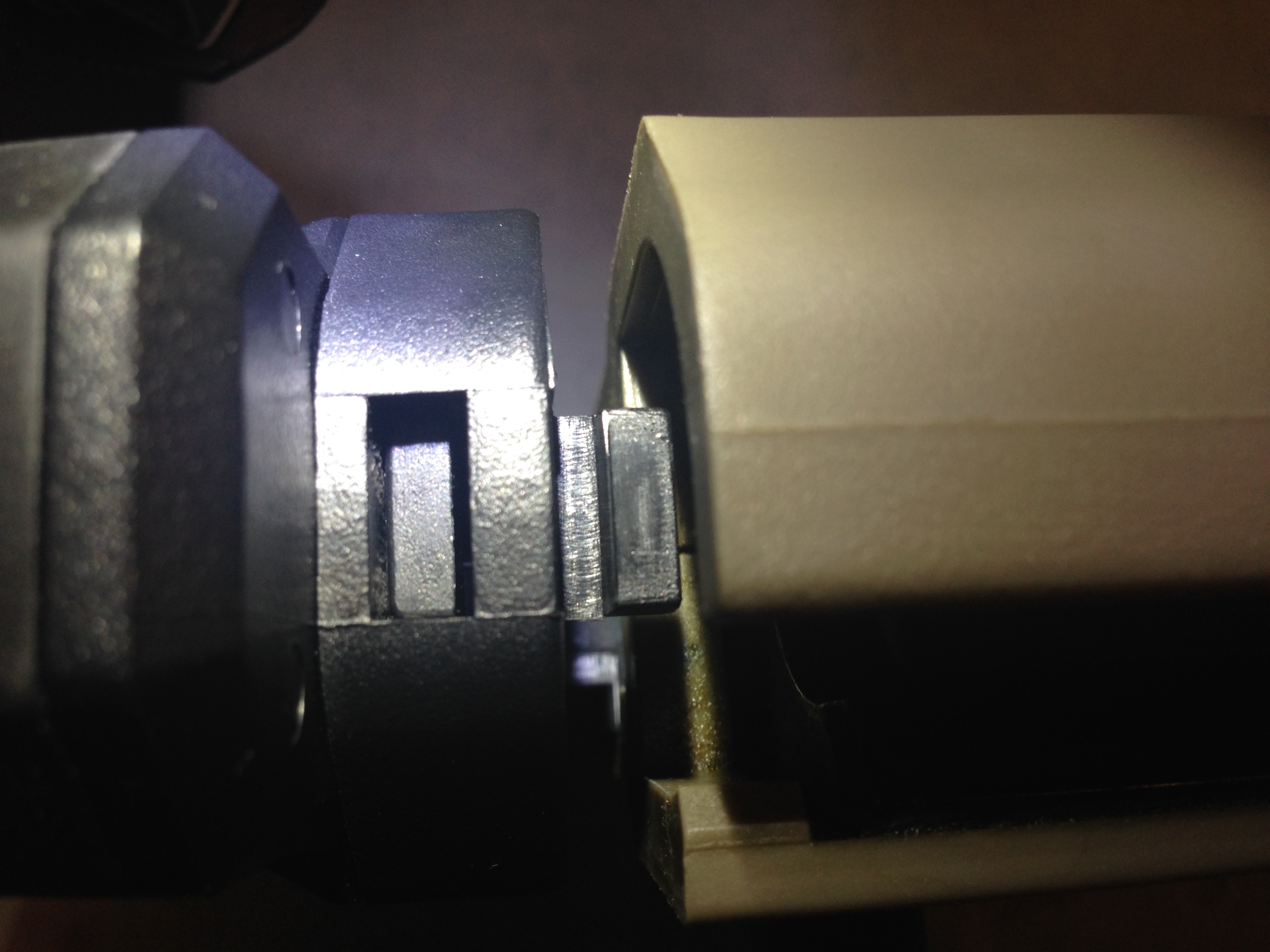

I will post my pictures of where I made the dremel cut for buttstock here. I can delete these if you decide to put some up. I SUCK at stuff like this, so forgive the hack job. If folks have a vise to hold the skin, it will make your job much easier, and cleaner.
The buttock is very secure, and goes on and off easily.
All,
TRY THIS AT YOUR OWN RISK. I am not advising that anyone do this. I am just showing that it is doable.

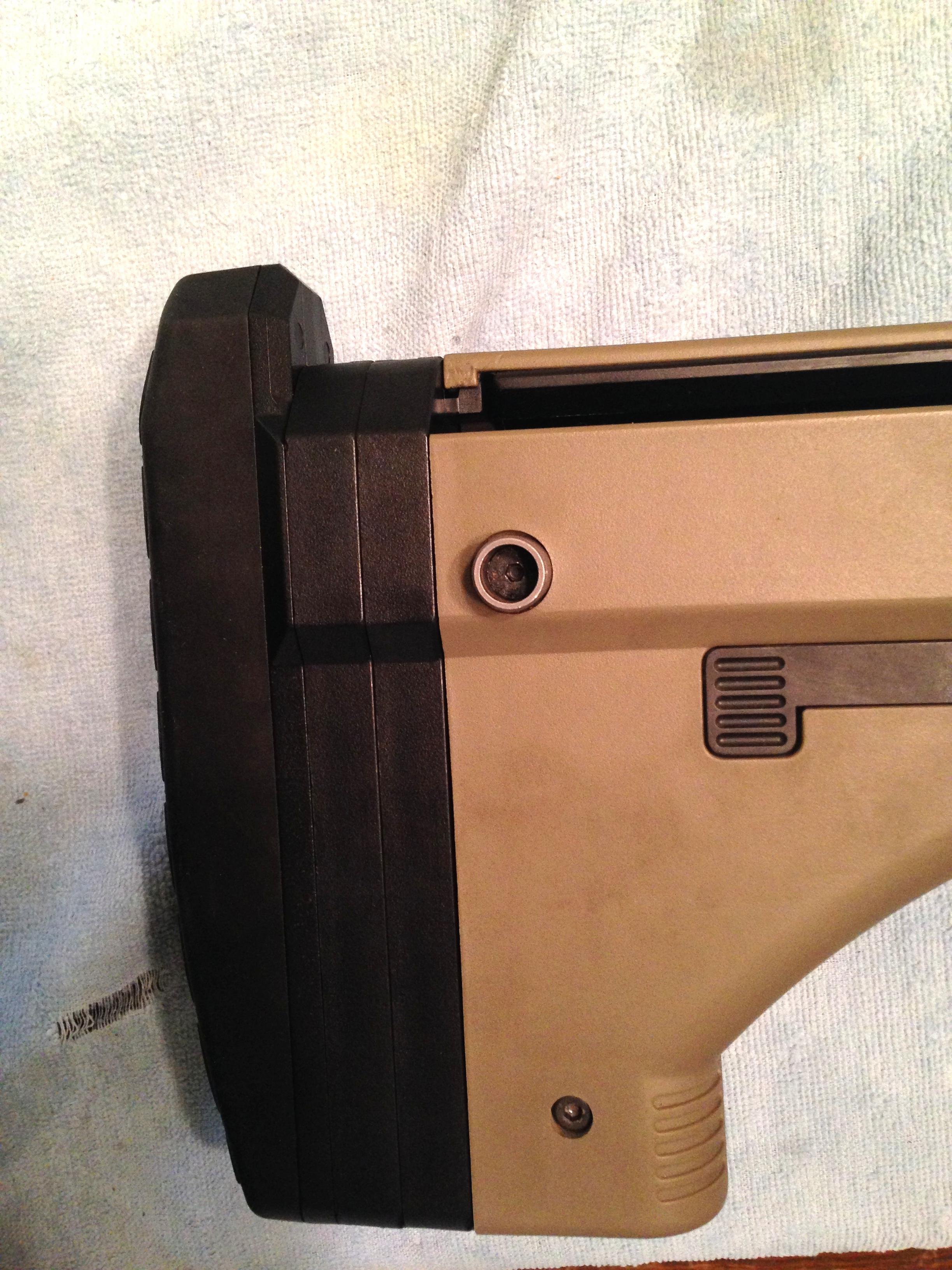

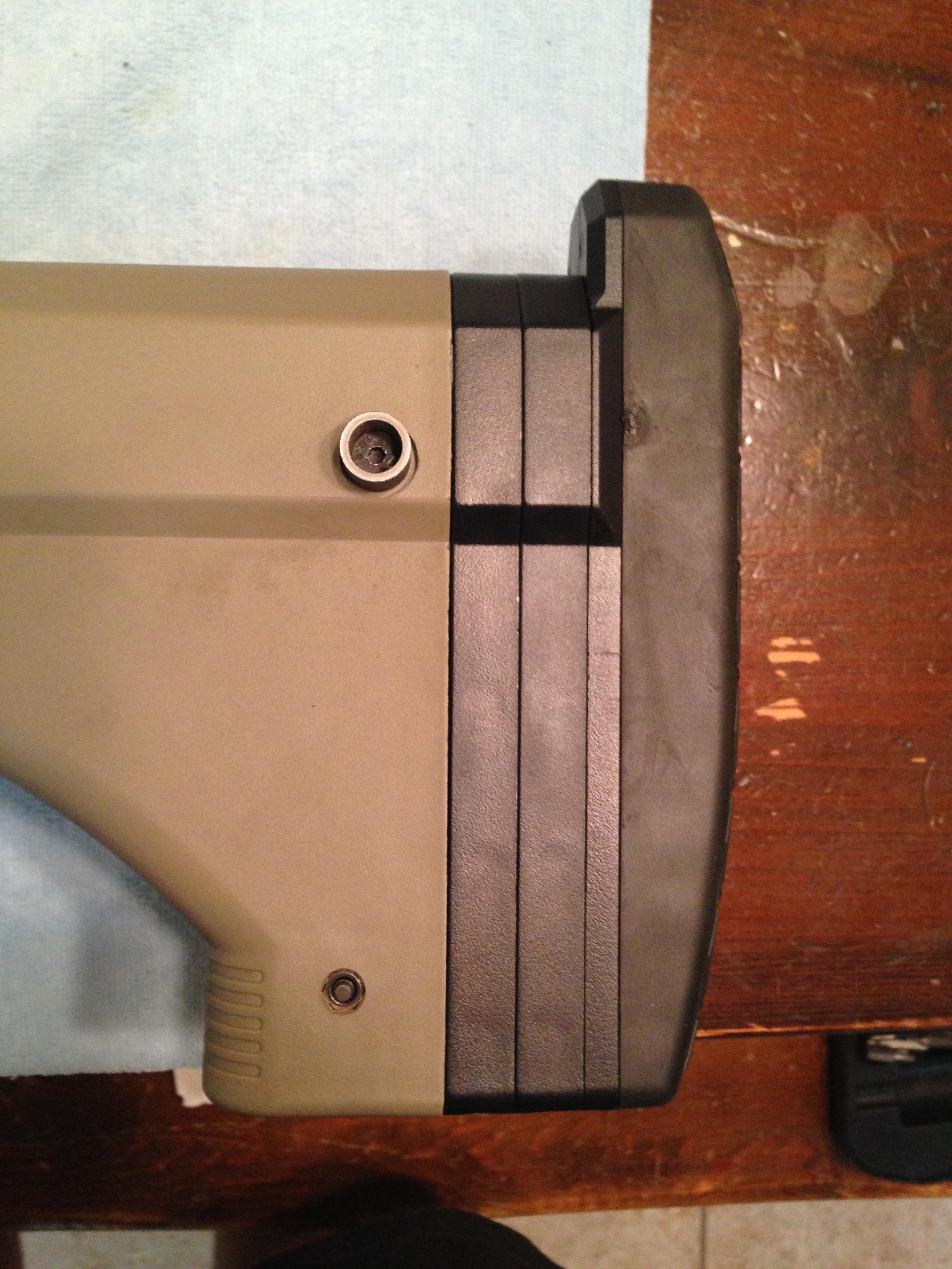

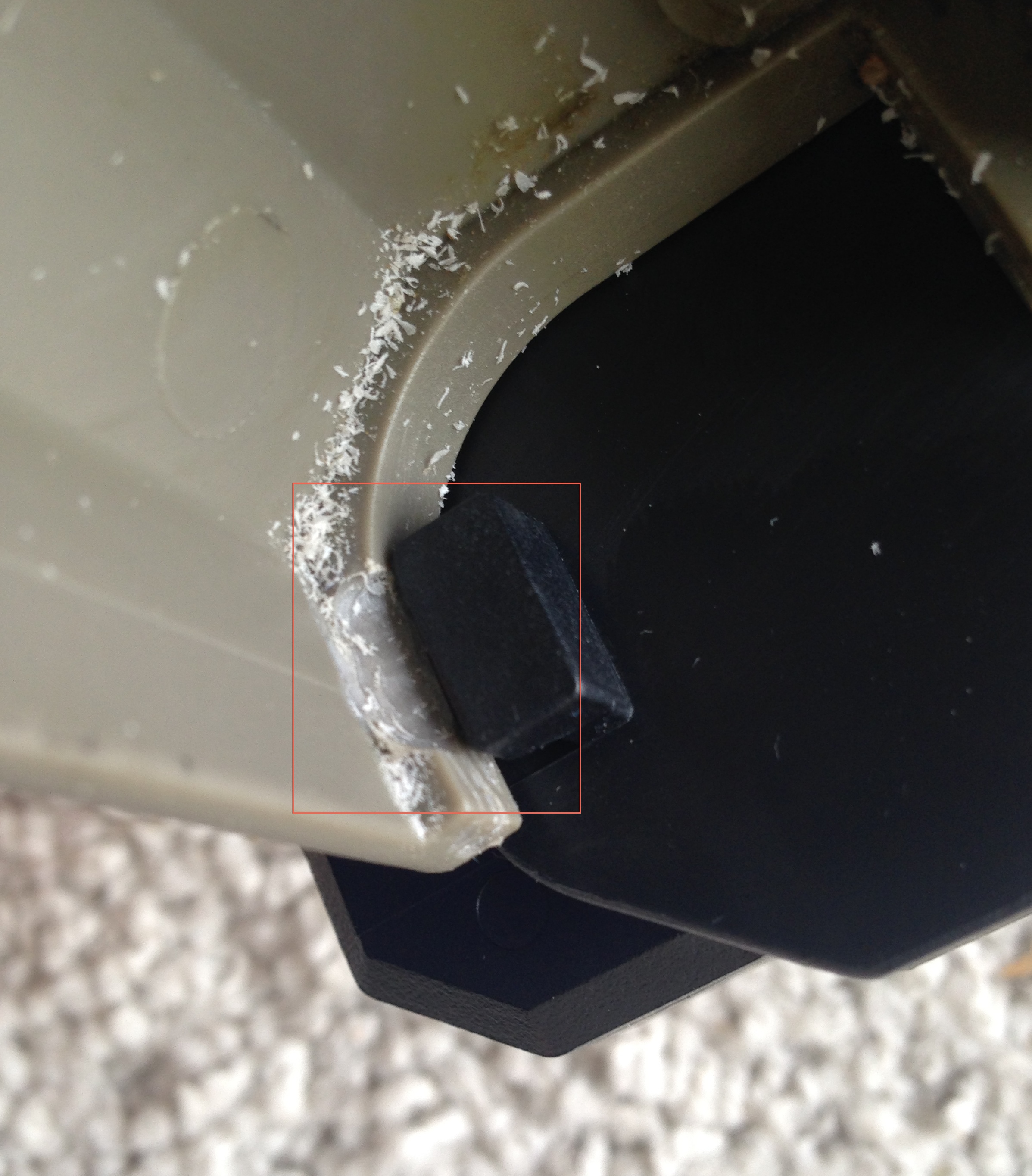

Finished Job:

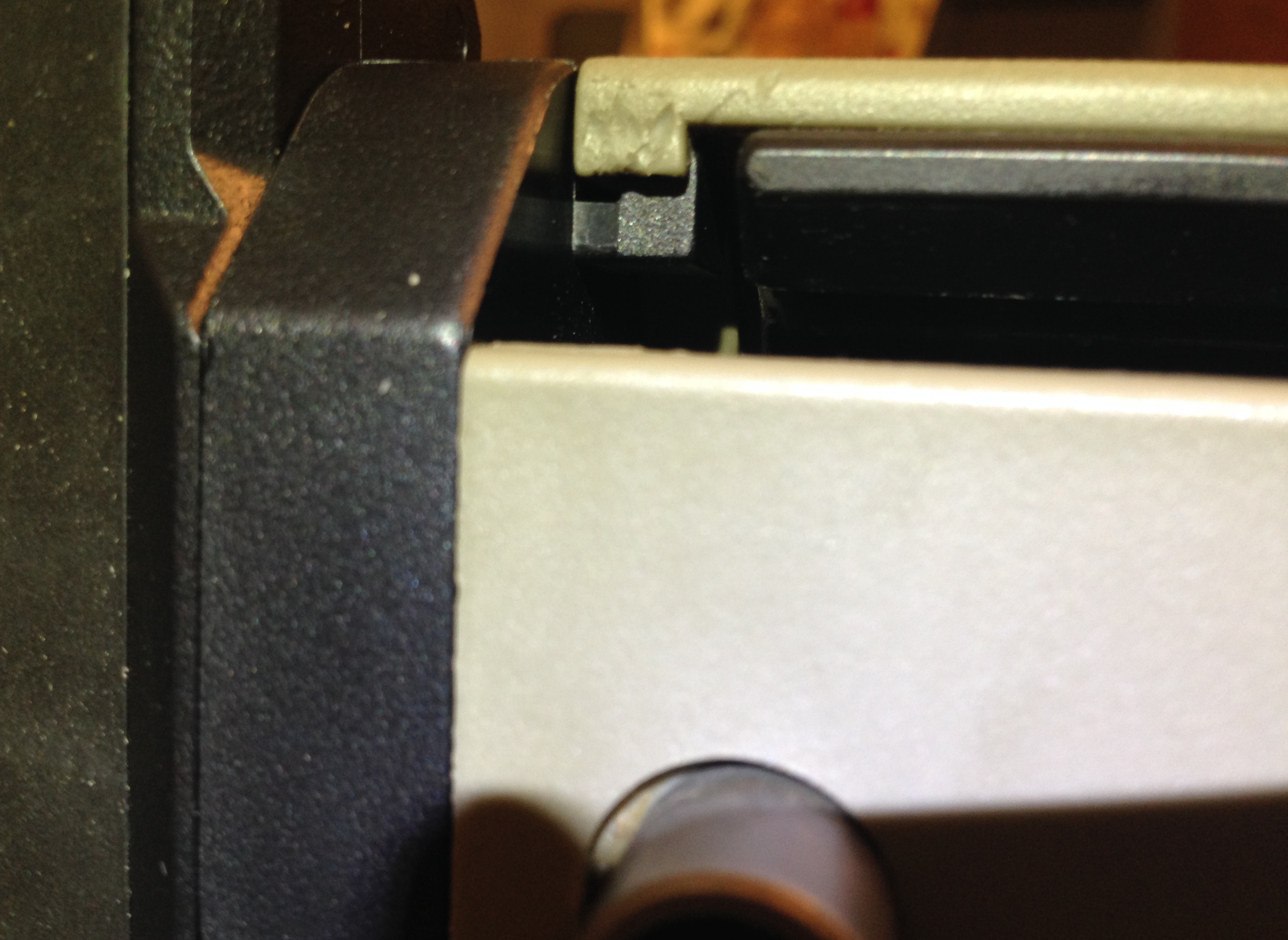

Starting out:
Mark the top of the tab/hook on the buttstock with a sharpie or some sort of marker.
Line up the buttstock to the skins and lift the buttstock up so your cut is marked.

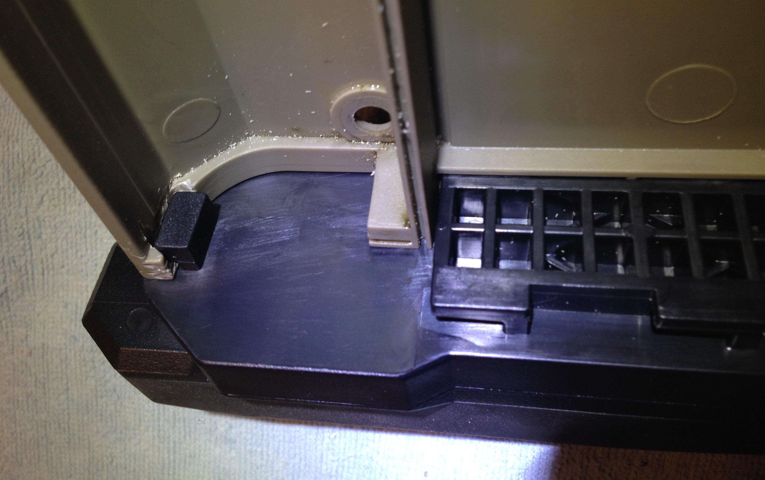

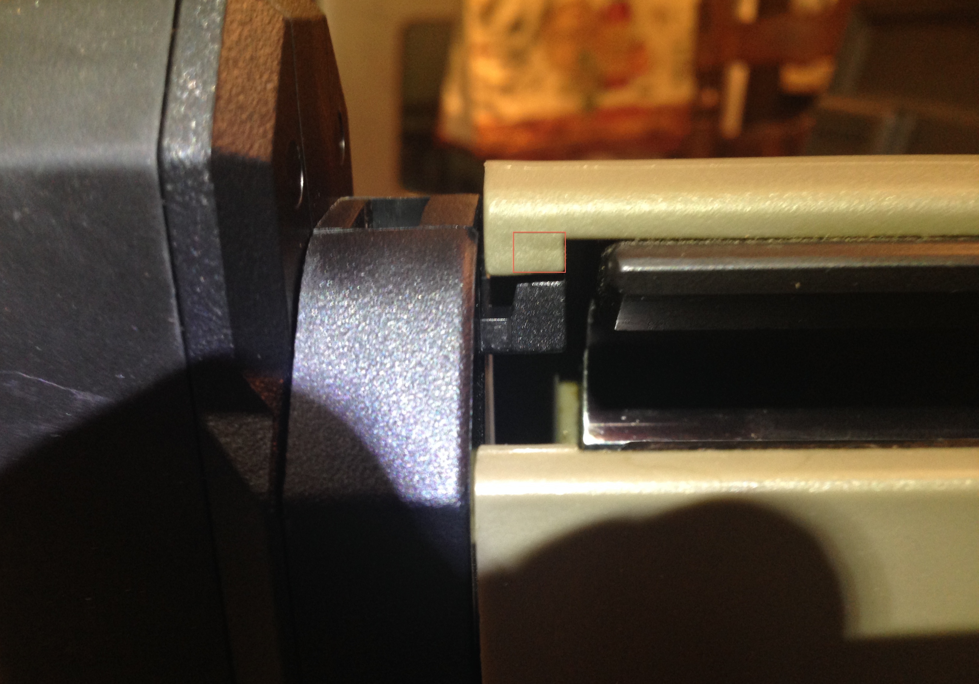

Take the skin off the gun. While you are doing this, remove the old buttstock latch, and store it with your old buttstock. You won't need it with the new buttstock.
Finish marking your cuts.

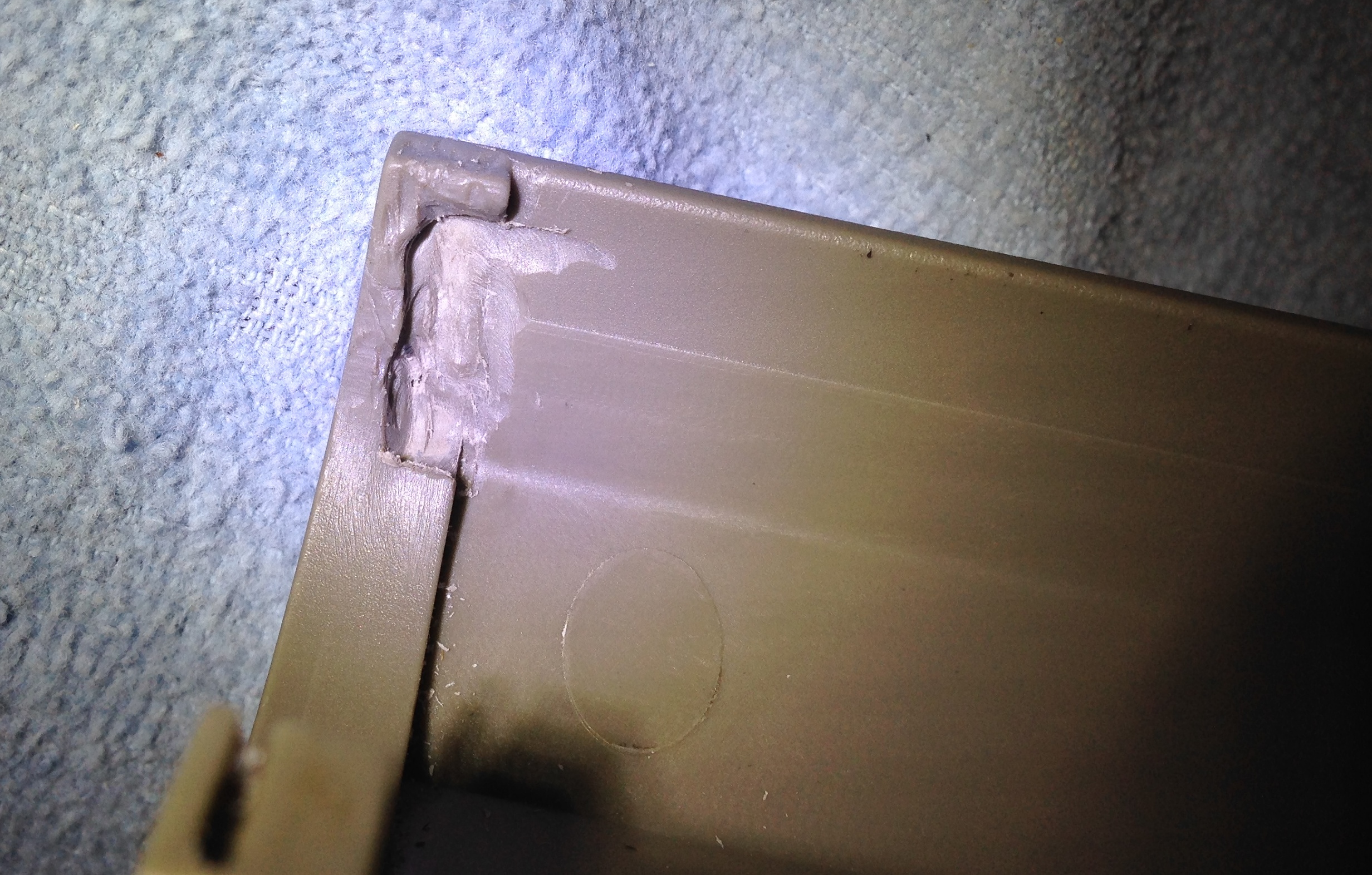

Make your cuts. Cut conservatively, then open up your cut to match the buttstock hook.
This was the cut when I was getting close to being finished. I smoothed out the lines before I was done.

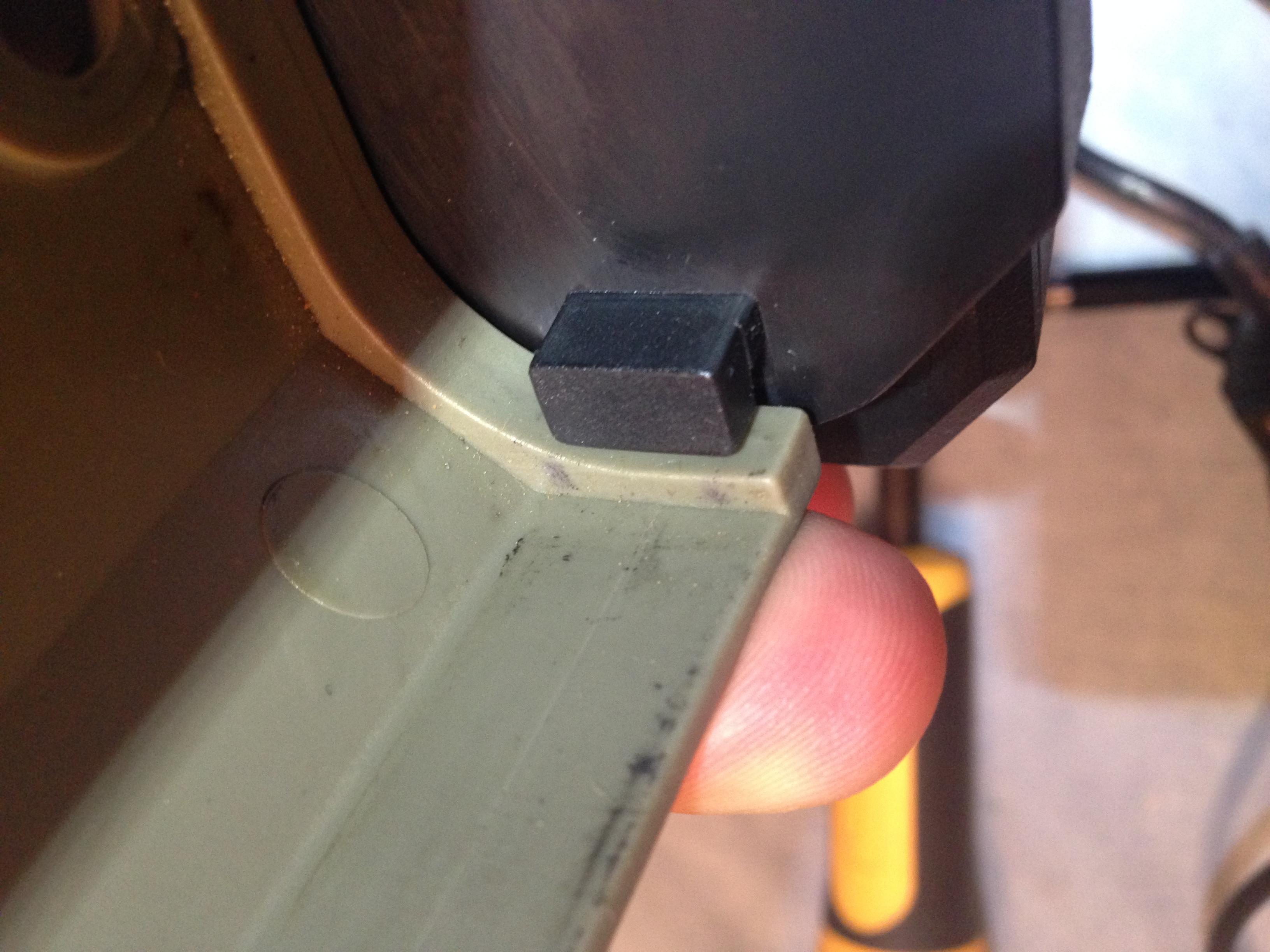

You can check the fit without putting the skins back on the gun. Just slide the buttstock on the skin This is one of the times I was checking the fit. This was close, but not quite there.
This is a closeup of the buttstock hook, in the skins.
