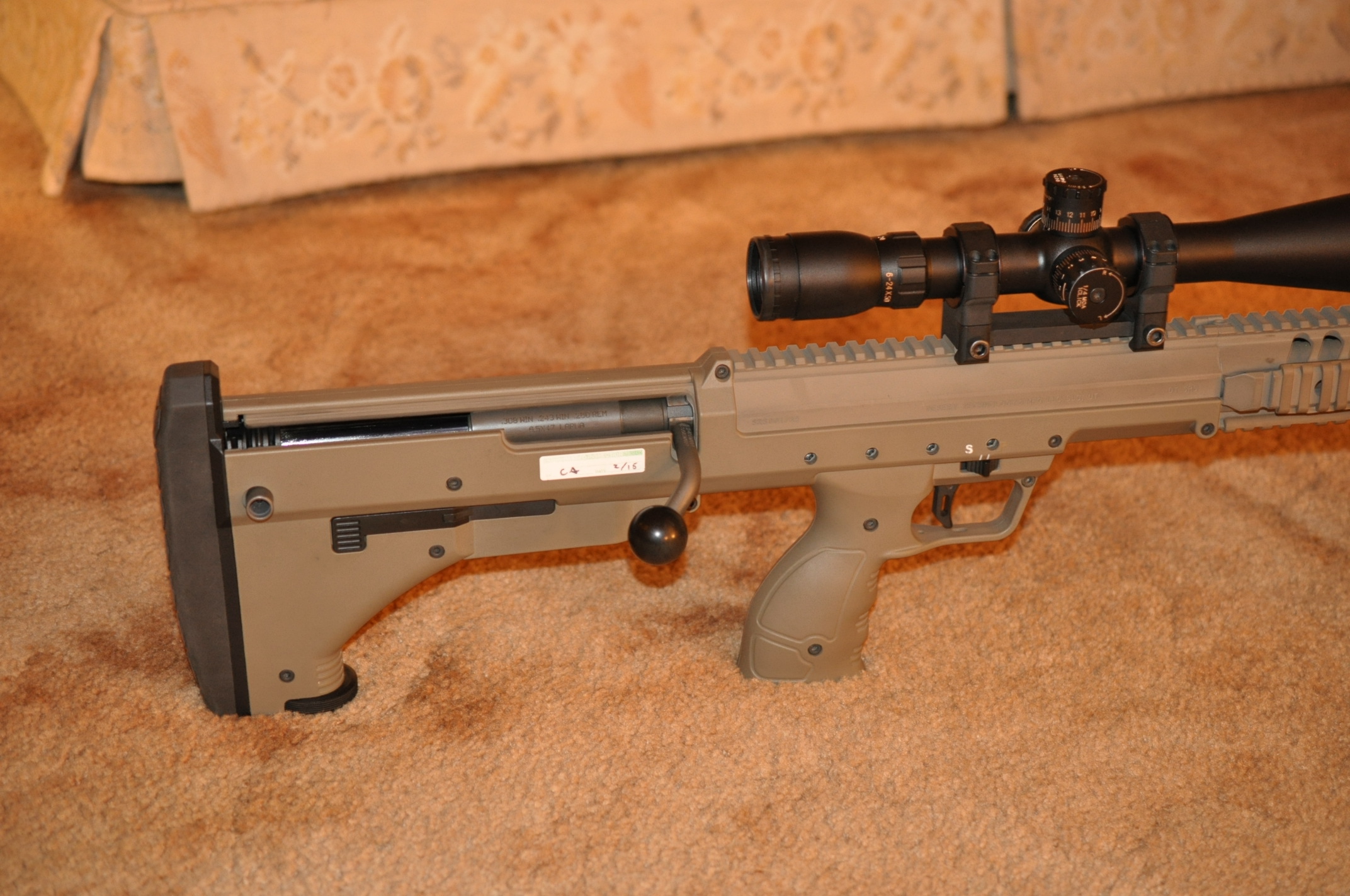

Thanks to Abq-Defense for posting the photos of your conversion of Gen II skins for the A1 buttpad. Got my A1 buttpad in the mail today, and spent some time this evening with the Dremel & several different diamond bits cutting out the slot for the new buttpad's hook. Kinda awkward getting into the corners of the slot, but patience was rewarded with a good, snug fit for the hook.
Really looking forward to getting the SRS down to the range and getting some trigger time behind the new buttpad, especially with the 284 Win bbl installed.

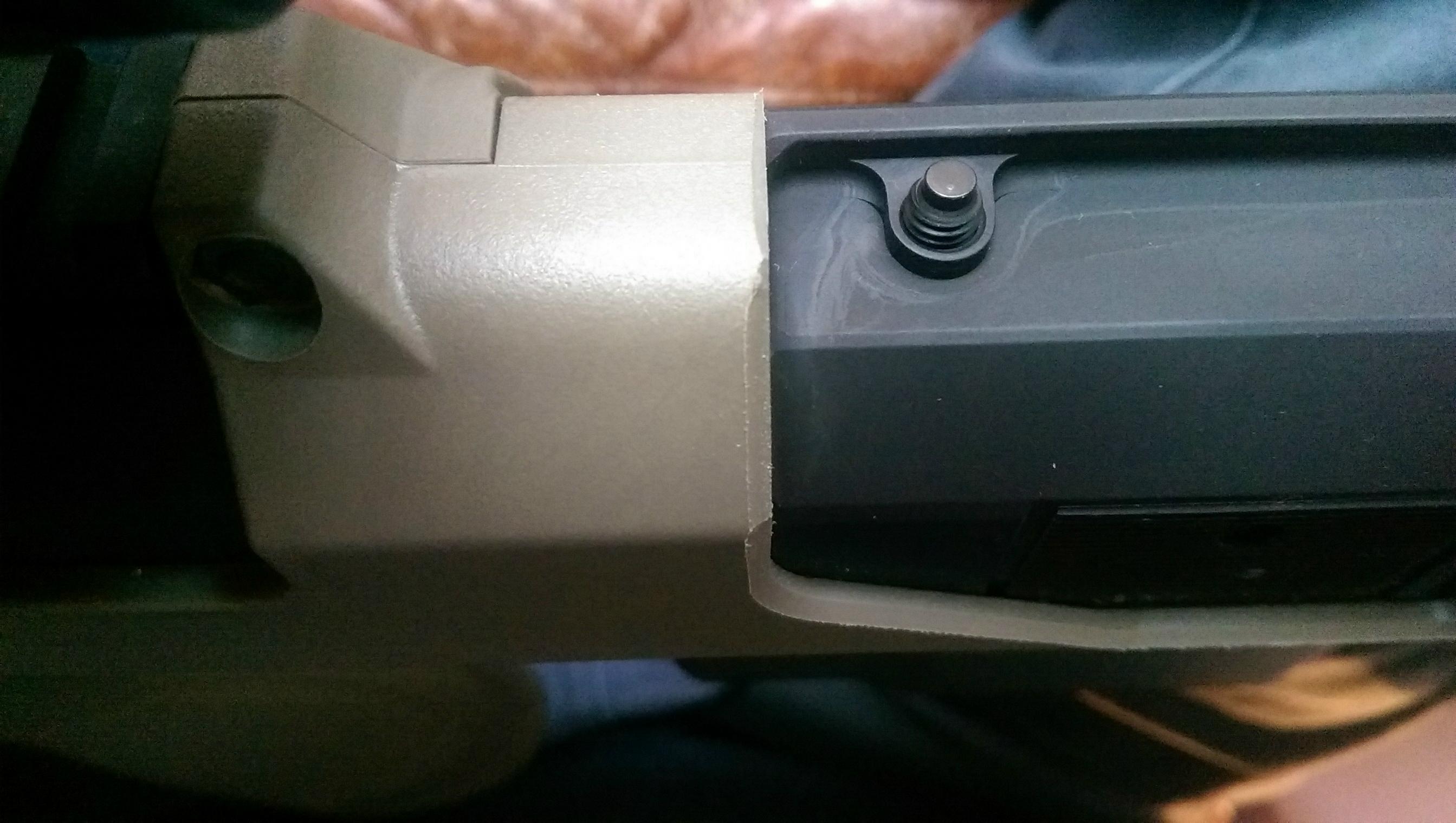

Took off my cheek rest for the first time yesterday and this little fellow fell on the floor. I guess it is supposed to work the sleeve on the bolt.
But it is very loose fit, should I put some loocktite on it?

Pearce. That is the sleeve stop. You have it upside down. You only want to thread it in enough to engage the sleeve on the bolt. You DO NOT want it to come in contact with the bolt body itself. Once you figure out the right depth, put a drop of blue loctite on there and you will be golden.

Thanks Russ locktite it is then. I found out it was upsidedown right after I took the picture.
