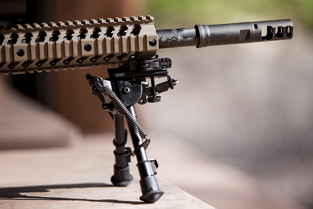

PROOF Research - carbon fiber DTA barrel
Here’s a teaser with my personal DTA SRS. Our factory test pilot took it out to test fire with a prototype PROOF Research carbon fiber-wrapped 338LM barrel (not available for sale yet). Consistent 0.57 MOA 3-shot groups with RUAG SWISS-P 250-gr. They also ran fast-as-you-can-reaquire 10-round group that held at 1MOA. I know it is only a 3-shot group, but 5-shot groups will be coming with pictures.
Weight with stock steel barrel = 12 lb 12 oz
Weight with carbon fiber barrel = 11 lb 4 oz
Disclaimer: I work for PROOF Research
