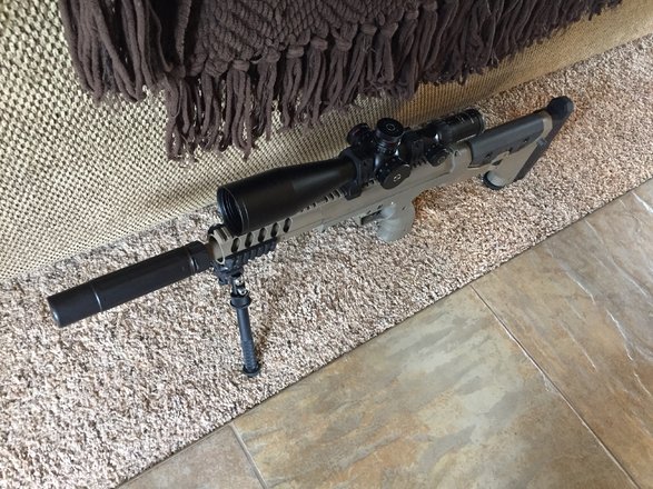

I just recently picked up a Covert in trade. I've had several SRS rifles in the past, but I think this Covert is going to be my new favorite. Its extremely handy. I have a 16" 6.5CM barrel and a 26" 338LM.
