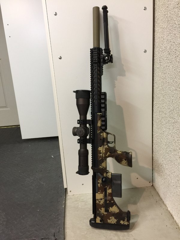

Looks like more of an integrally suppressed rifle than anything. Here's a 300 Norma with a straight 1.25" tube. Weighs 20.5 lbs as it sits.

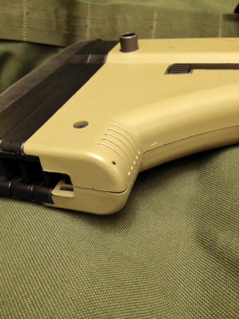

This is what I'm dealing with. there is no plug, it's solid plastic. I want install a butt spike but I don't see how that's possible without drilling that space away. Am I missing something here?

You may need to pop the skins off and see if your receiver is tapped to thread this in:
Yup doing that now. I don't see any pics of a DTA SRS A1 that does not have the butt spike, so once again did I get a funky skin? As far as I can see they all have the cutout, except mine?
You didn't get a funky skin... you just got an old rifle. Pre-2015 for sure. If you bought it new, recently... I'd have words with the seller. ;)
Ah crap! If I purchase new skins would they fit directly on my existing chassis? Perhaps I should call DT and see if they sell those separately. Kinda bummed out. So I have an old SRS A1, but with older skins, could they be skins from the first gen guns, or some intermediate design?
During 2013 after the SRS-A1 release, the rifle was offered both ways - with, or without monopod. Eventually they standardized the skins to ALL have the cutout for monopod. The rifles that shipped without monopod had a little plastic plug inserted in that space. Eventually they just made the monopod standard. That happened a couple years ago. So your rifle is likely from 2013.
All things being equal, all A1 models have the chassis drilled/tapped for monopod. You'd need to buy the monopod (I think they are $300'ish) and then you'd need to buy skins (I think those are $300'ish). Which means unless you got a screaming deal on your current chassis, this will be a loser for you financially. New skins should fit just fine though, and the monopod just screws in.
