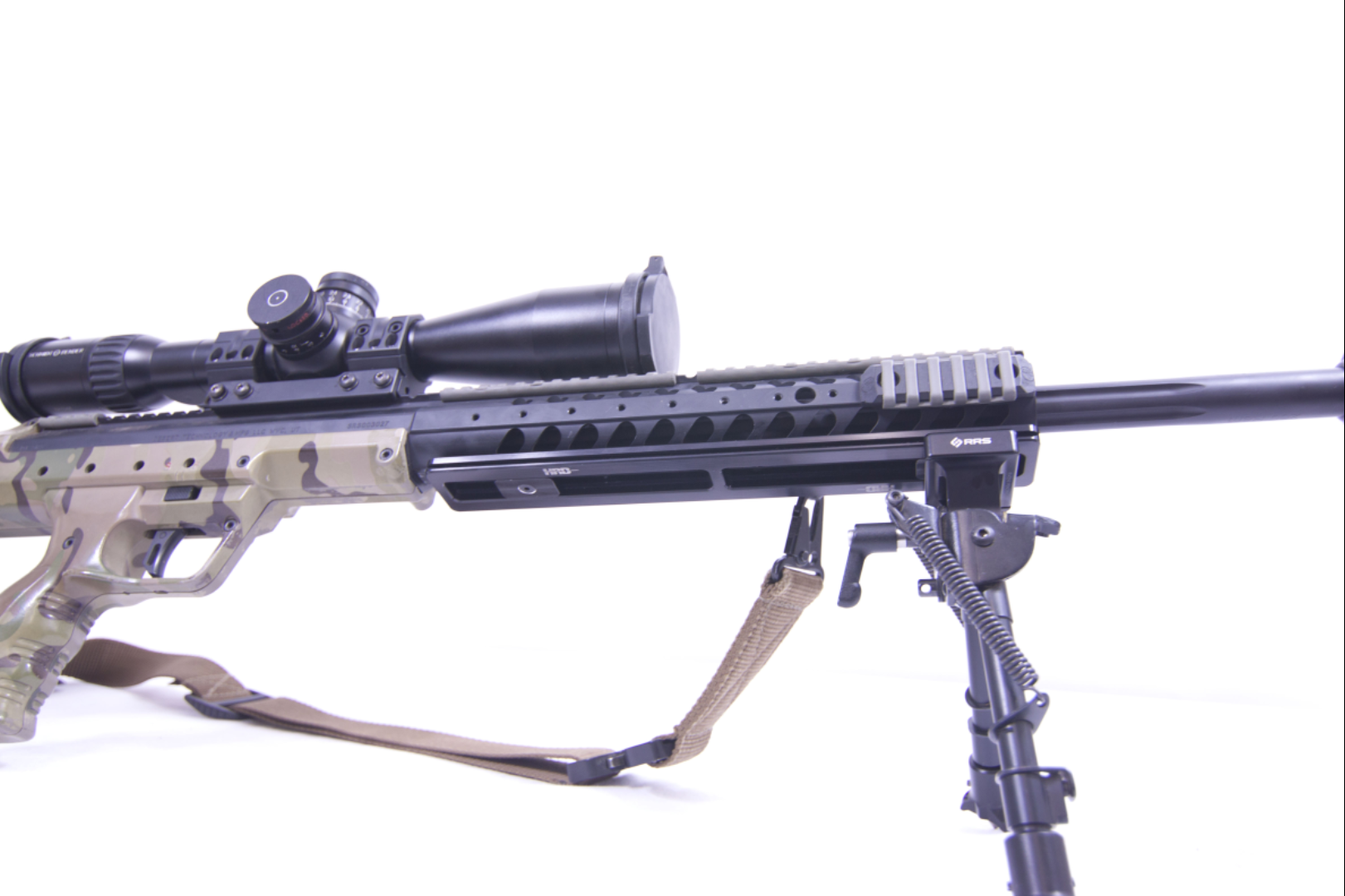

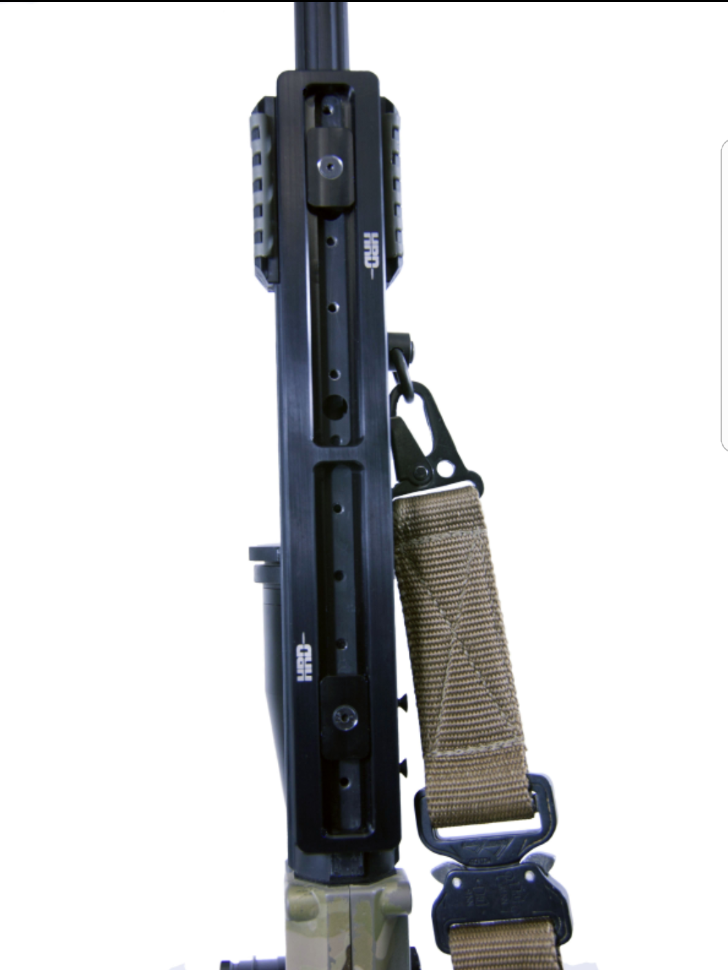

Hey guys, I recently made these Arca Plates for DTA. Looking for some feedback! Thanks!
