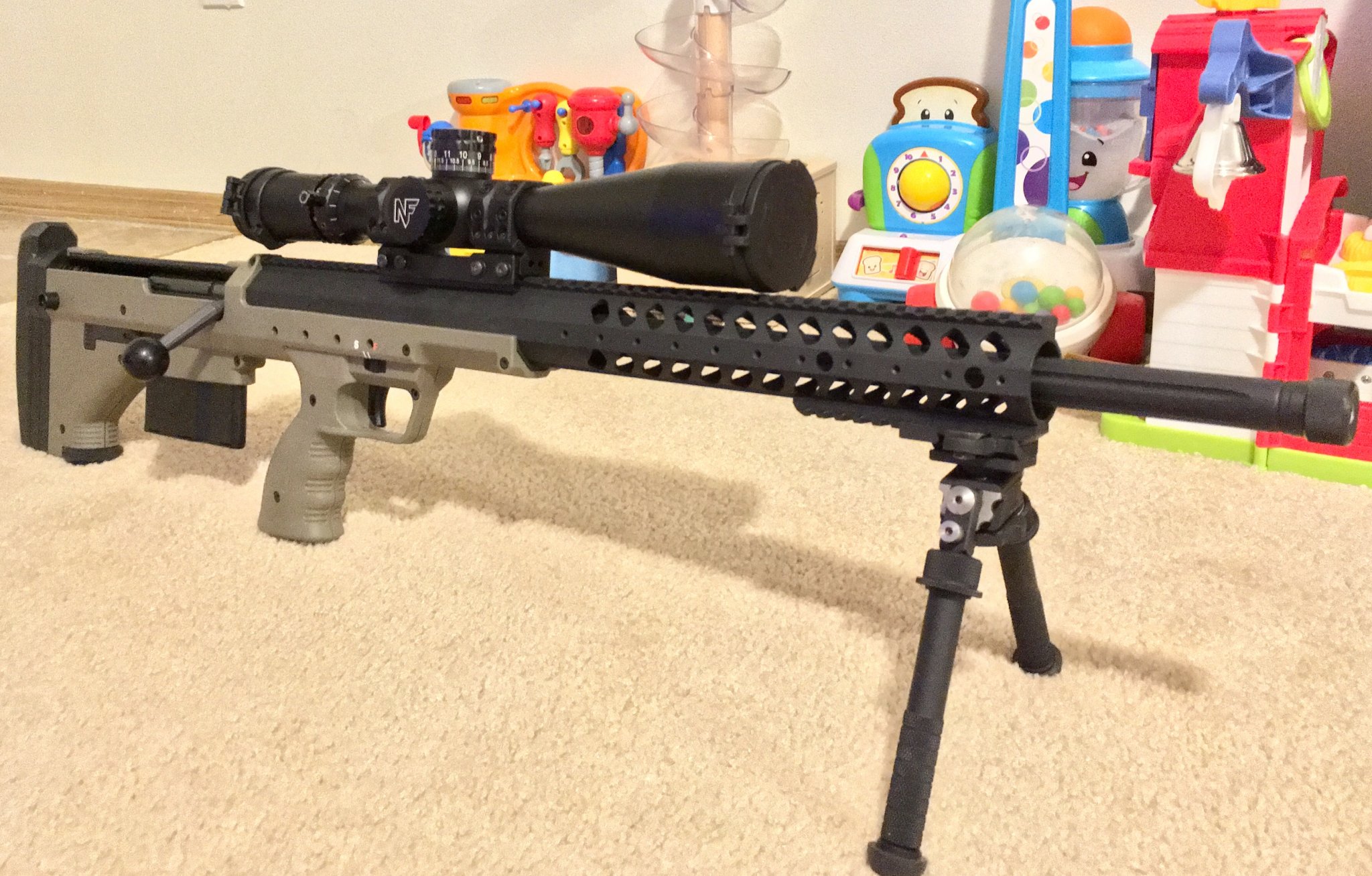

Thanks for the feedback guys! Been wanting one for a long time and finally got one as retirement gift to myself. Trigger is much better than I thought it'd be. Action not smooth as AI but I'm sure that will wear in with time. Have a NF 5-25 F1 on top.
Benchmark is close by I will give them a call to see if they can do a re-thread.
I did not mess with the skins at all yet since the DT mag goes in fine, will give that a shot and see whats what. It is tight before locking in place so thats likely.
App will be my primary for the offsets but I also wanted to log it in hardcopy so I think Ill get an extra "Dedicated Cold Bore Target Data" page from Storm so when I end up with a dozen barrels (hah) I can have them all on one sheet.
Any DT shooters in WA want to get together when all this coronabullshitvirus is over with?
Edit pics
2cc53fe9-7e12-4828-9b2c-7e1a4adcdaac-jpeg.7280726

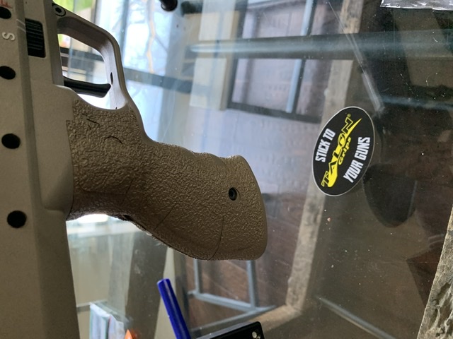

I traded from an A1 full to A2 covert, but unfortunately the trigger LOP is no longer adjustable. Which sucks bad. I got some talon grips and added a little material to the area where the web of my hand sits. Hopefully will keep me from needing to squeeze at an odd angle.
#stuffwedowhenquarantined
