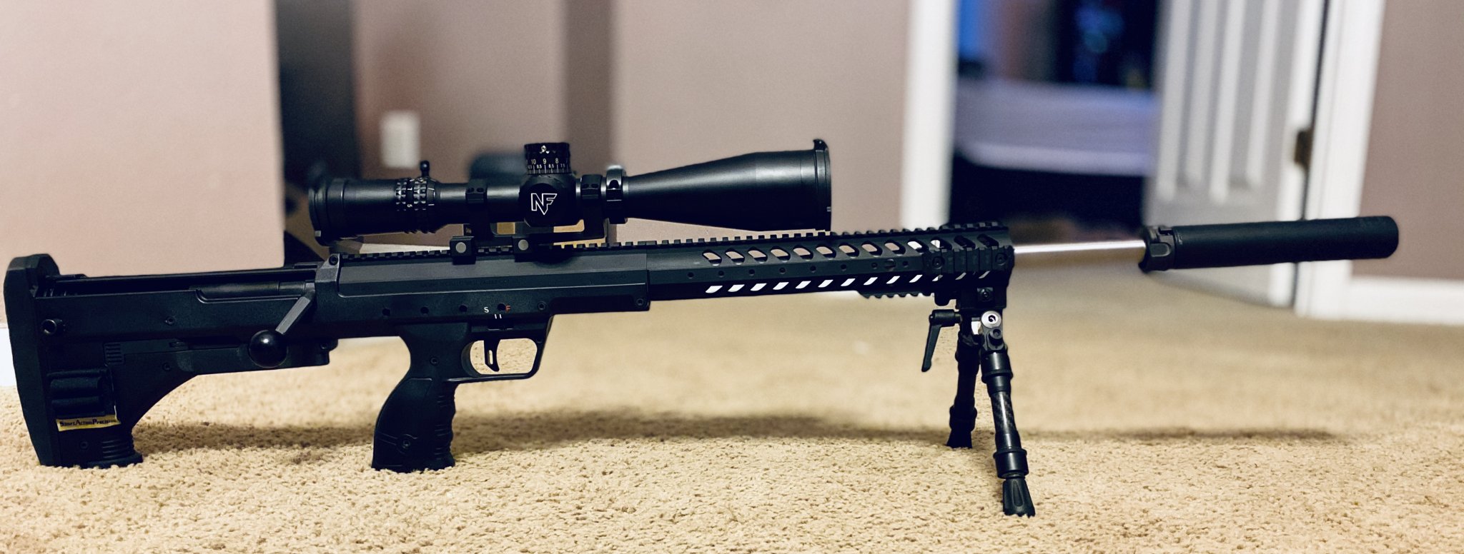

Pic of the current setup

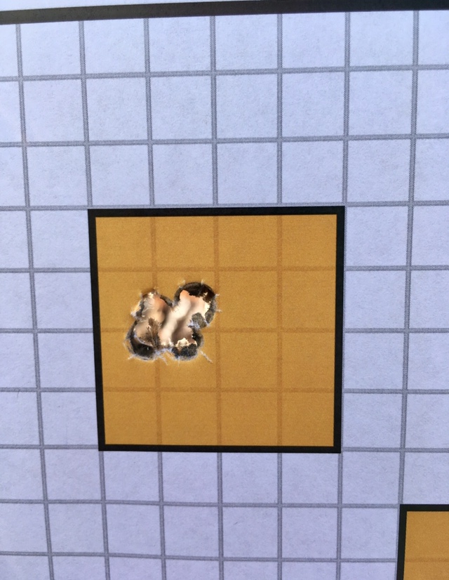

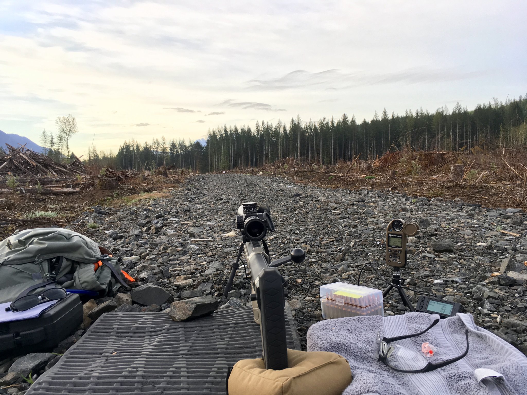

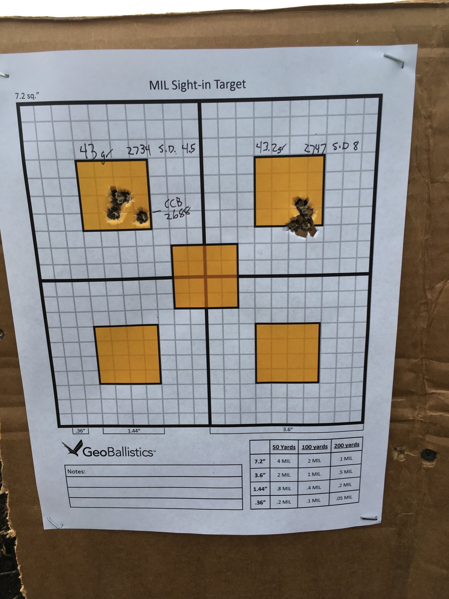

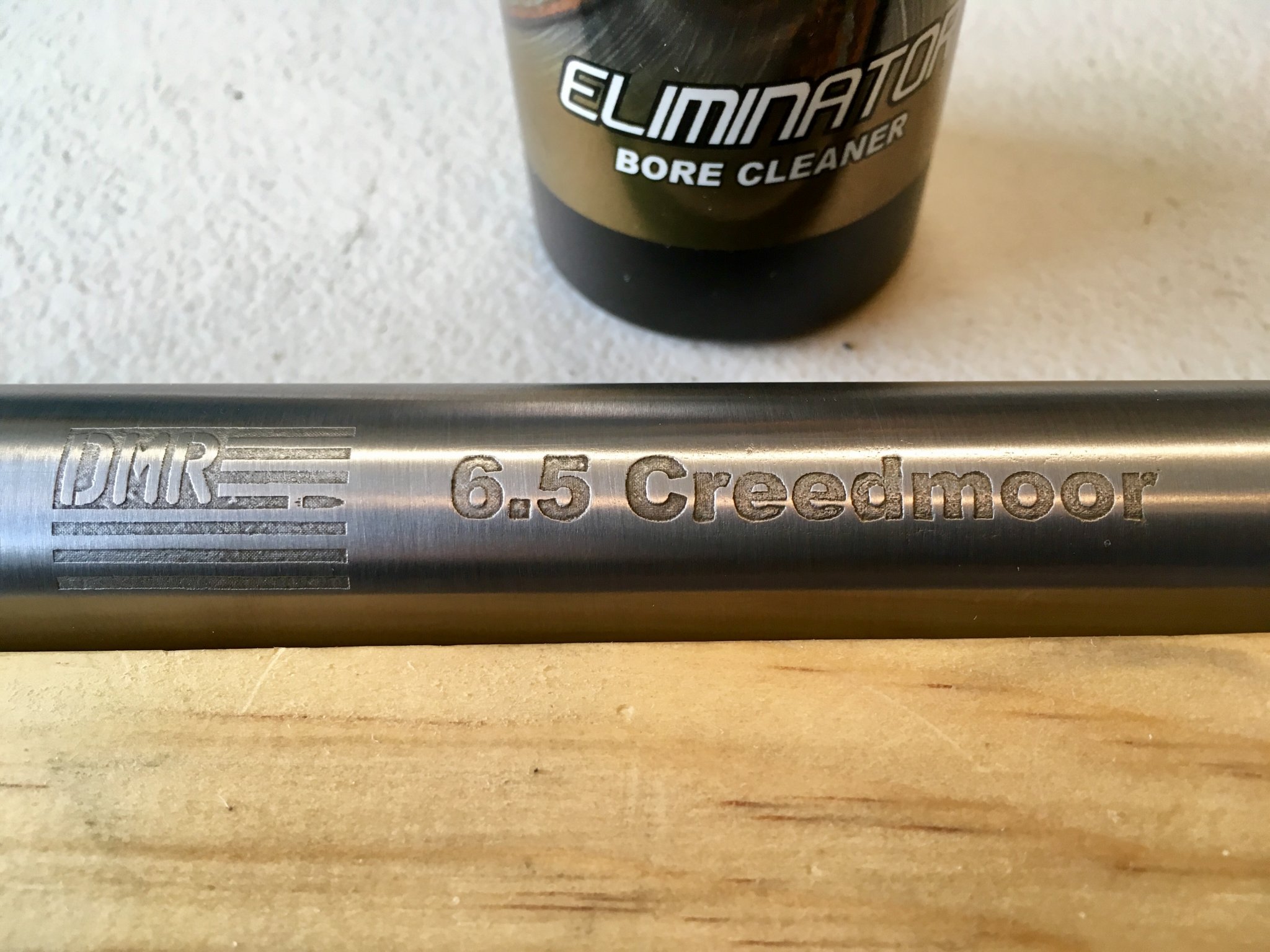

Breaking in this 6.5CM barrel I got from DMR. Loaded up random charge of 43 gr H4350 under a 130 AR HYB for break in and groups were nickel and dime size. Would like more speed but thinking to just roll with 43 gr. Only 100 rds through should pick up some speed soon.
With a 22” barrel I’m guessing you will pick up a little more speed. I also have a 22“ barrel but are shooting 140 vld’s and using RL-16 and getting about 2,750 fps. RL-16 would most likely put you over 2,800 if you want more speed, I’ve shot a few 130’s and was at about 2825.
