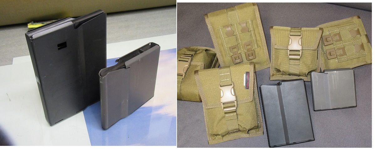

I think maybe @softcock makes them? I know he does bolt/barrel pouches.
for the thin body, single stack DT. Mags .... Yes .
DT Mags. got to be some of the slimmest body out there. Mag. pouches still stay nice and trim with it being double/x2 Mag. pouch.
I list them in the Barrel Bag/bolt pouch for sale thread .
https://www.snipershide.com/shooting/threads/barrel-bags-and-bolt-pouch.6938711/
  • Love
Reactions: M77 and Blazin
I use the Tactical Tailor Fight Light Double 7.62 mag pouch that will fit two 10 round magazines, also the Triad Tactical .338LM mag pouches will work as well, open top/bungee retention for 10 rounders and 6 rounders, and closed top for 6 rounders only.

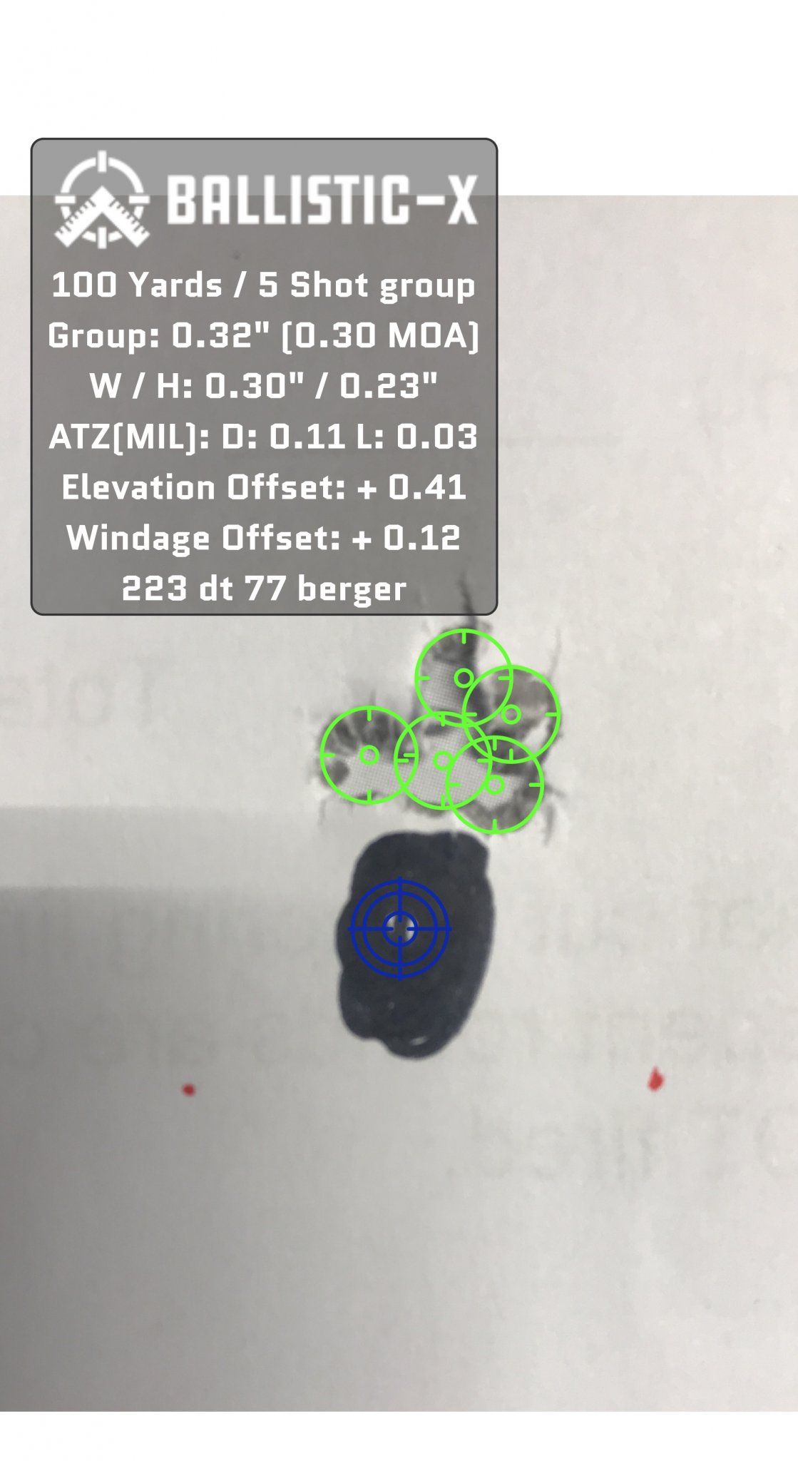

Just picked up my 223 conversion. Looking for some good loads to get started with.
The mag will let you load long.
24.6 gr Varget under a 77 gr TMK at 2.480 oal got me an easy 2900 with a 5.5 SD, 75 ELD was almost exactly the same so that’s pretty much my recipe for the entire 77 class of bullets.
Not super fast but consistent and Lapua brass should last a very long time. It shot so well I honesty didn’t care to do anymore load dev and ran that. It’s fun to shoot a heavy 223 past 500.
Even my AR load shot like a dream. 23.2 XBR under a 75 bthp loaded to mag length in LC02 brass.
