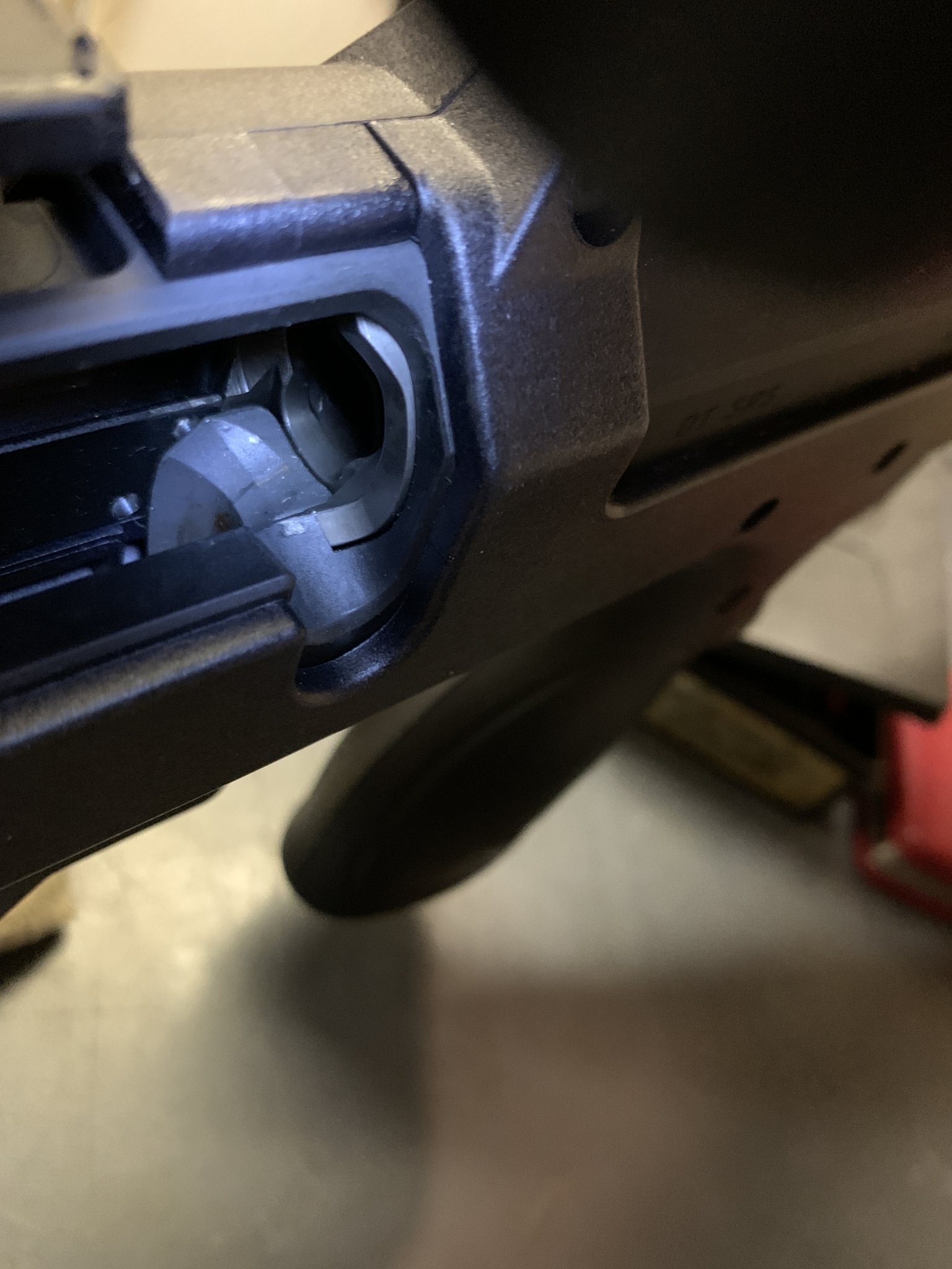

Mother fuckers, even though DTA assured me a A2 conv kit would fit my Gen 2, it absolutely does not. The extensions has been changed, the bottom used to measure 0.591" and the new one is 0.579" which means I can't fully seat that barrel in the receiver. I should get the 223 conv at the end of the week, wondering if it'll fit ...
Sounds like an out-of-spec extension. Does the barrel tenon measure the same or is it a little smaller than the extension?
Length is the same, 1.759 on the 6 ocloak position of the extension
I really think the issue is the width of the extension, by being narrower (by at least 10 thou), I can't push it down all the way to the receiver.
So now the 2000$ question is: is it my old gen 2 receiver that is out of spec or is it the new A2 conv kit that uses a different standard. Could anyone measure theirs ?
Is out of spec extension common issue on a factory kit ? I've never heard of it being a possible issue and I've heard some issues and tolerance stacking with other DTA products ...
Reactions: HenryTheAce
Ok, I started measuring barrels & was getting measurements that were varying from 0.588 to 0.595. Upon closer inspection, the alignment notch has big radius’s at the bottom & appears to have a little taper also. When I install my barrels, I always turn them clockwise, same direction as the bolt rotates when closing. Then I close the bolt. Then I torque from the rear to the front. I can slip a piece of paper between the boss the notch locates on & the notch. The paper measures 0.004”. Lastly, it is really easy to see the notch over the boss when the barrel is installed. So, having said all that, my measurements won’t help you. Have you compared what it looks like with your barrels installed?
Reactions: st1650
I tried wiggling it with different angles, it's just too tight and I'm afraid that to use a mallet or something I wouldn't be able to get it out.
2 More pics ... quite a big of gap ... I'll see what DTA support says .. they do confirm that A2 is backward compatible with A1 and Gen 2. I just think it's the extension that's screwed which is a big relief because then I'll just return it.
Reactions: 65x55guy
Take the feed ramp off and take pics. Then the receiver isn't in the way.
You're right.
I can seat the barrel by removing the feed ramp, putting the bolt in then seating the barrel.
Which means it could feedramp that's causing the issue. But then it doesn't solve my problem since you need the feedramp to index against.

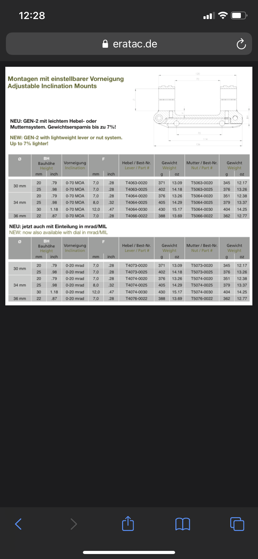

I’m looking to replace my current rings with an Era-Tac adjustable mount. Is there a preferred methodology for figuring out if I have enough distance between the bottom of the objective bell on my NX8 and the top of my SRS A2 handguard to adjust the base the full 20 mils? I’m going to get the higher mount to hopefully get more wiggle room.
