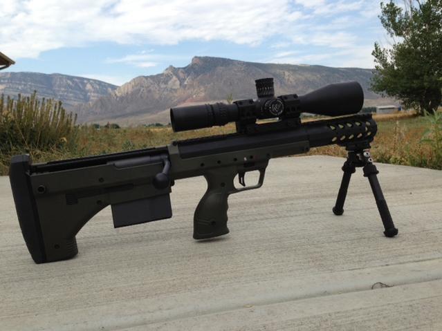

Just picked an ATACR up, a few weeks ago, I rate it very superior to my previous six NXS scopes, glass is much better! I have no hands on experience with the BEAST, but if you don't need FFP - the ATACR is a fine improvement over previous models IMHO
I would very much like to see a picture of it mounted on your rifle, I'm deciding if I should sell my 5.5-22 to get one!

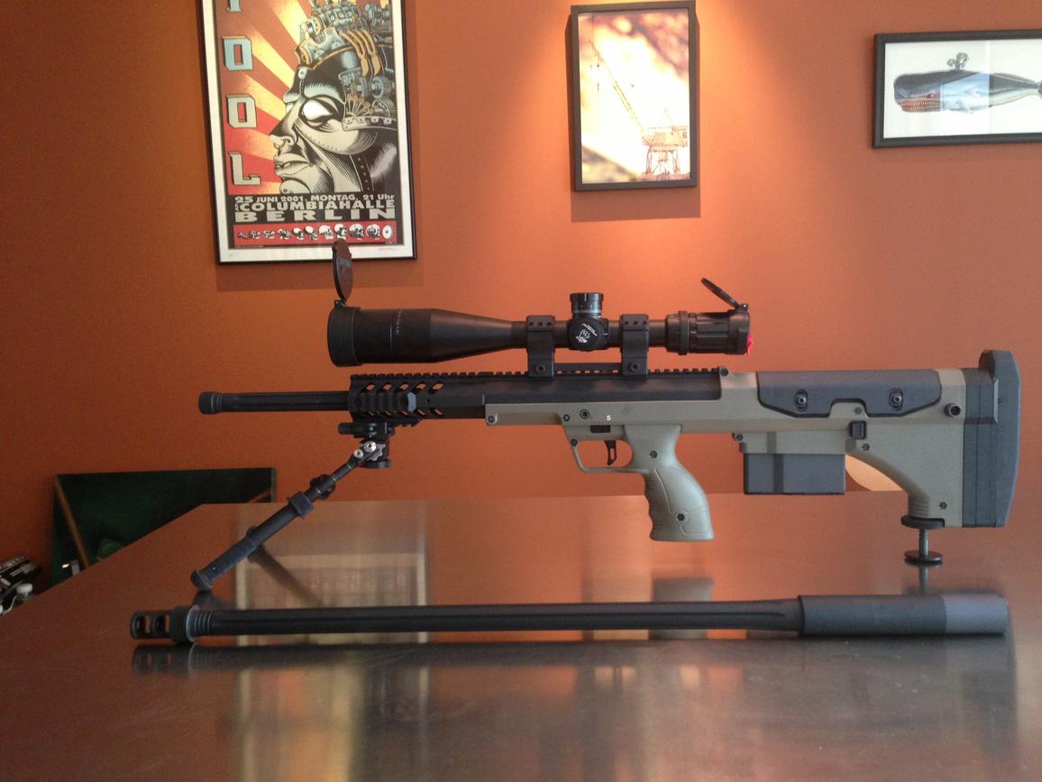

Hey guys. I was owed some money and the guy couldn't come through. I got a couple conversions to square up and I don't need them. Both are new and unfired.
300 win mag, as mentioned above was sold. I still have the 26" 338 Lapua. This is a complete conversion. 1st gen bolt 1st or second gen extension. Whatever you need.
They are Duracoated Flat Dark Earth.
PM me for pricing.
