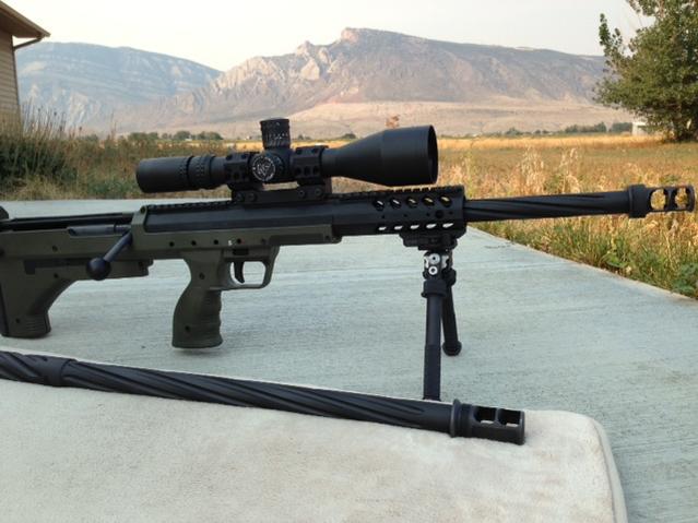

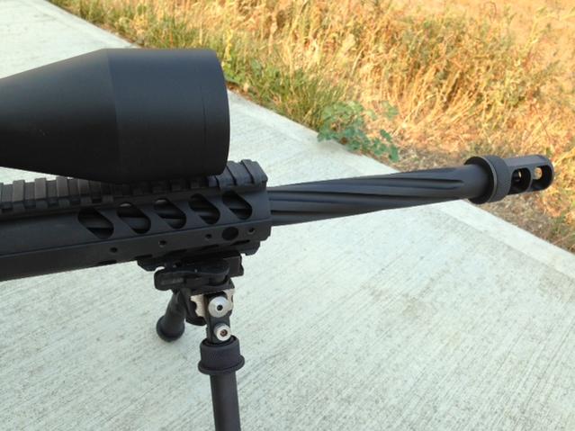

My Covert with a couple of Mark's SAC barrels - both are 22.5" 1:9.5 338 Lapua the other 1:8 6.5x47 Lapua going to shoot it tomorrow...
