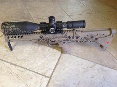

Well I just got a picture of my rifle from the cerakote guy. We had a slight misunderstanding on exactly what I wanted on it so he is going to keep it an extra week and make some changes but I figured I would share what it looks like right now with you guys.
The pattern on the rifle is going to be reversed so its Black and grey inside the hexagons instead of outside and the scope will be more FDE and less black. Ill post pictures when its all done too.
Who did that and how much did they want to do it? Looks good.
