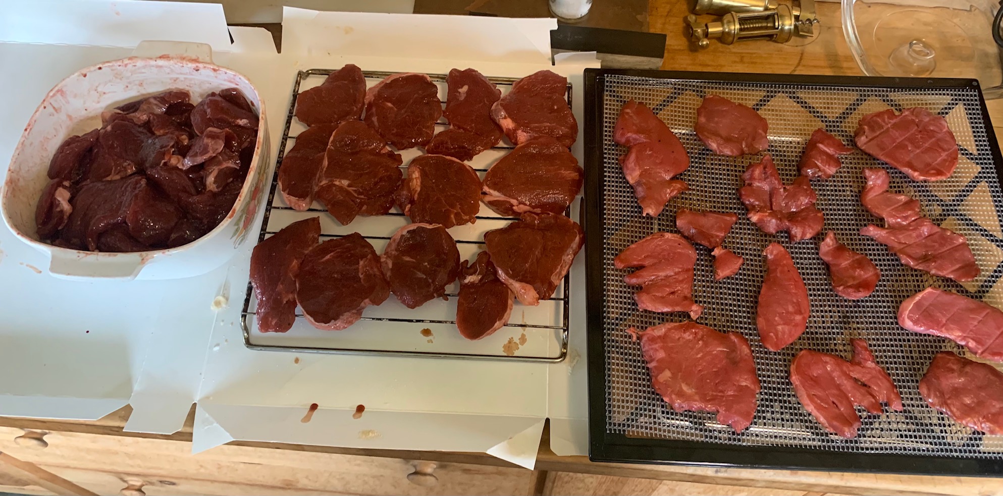

Just to kick things off, this is dehydrating now (10 tray Excalibur). It's 5 lbs of pork tenderloin. Dirt cheap at the grocery store now and very low fat. It jerks great. Started marinading/curing it last Sunday. Today it will dehydrate for about 12 hours before mason jars. Actually in this case, I probably will eat/give away... not can. This is a High Mountain cure. Used some of their Mandarin Teriyaki with some 'inferno' mixed in at about 5.5 tablespoons of the teriyaki and 1 tbsp. of the Inferno. The inferno is just too hot to use 'straight up.' Ever. Also used teriyaki sauce (kikkoman) and some Chinese "Red Sauce" mixed together to create a liquid that was part of the cure. Can use liquid smoke or Soy Sauce as well. Anything you like, really!
Couple of things I've discovered that work.
First, don't cut meat to 1/4". You will end up with 'paper thin' Jerky and it becomes very hard to dehydrate/smoke to the right texture. Go to far and it goes crunchy and crumbly, which you don't want. Instead, slice to a full 3/8". Err on the side of too thick. But 3/8" is pretty good. I also slice the meat when it is semi-frozen. In that sort of 'soft' state but not thawed. This lets me really control the thickness of slices. It can thaw in the cure bowls when it's sliced. Cut across grain. Try and get pieces at least as big as a playing card. If not bigger. Though small 'leftover' offcut stuff can also be dried, sometimes it's best to take those chunks and cut slices into them (not through) and sort of fan them out. Almost like cube steak. (PS I NEVER do jerky shooter/ground meat. Don't trust it for long-term preservation. But that is just me. Others love doing it that way. I am just... not trusting of ground meat.)
Once it's sliced, layer it in to the bowl with the cure, flavor and 'liquids' of your choice. Again... liquid smoke. Jerky Juice. Soy Sauce, Worcester sauce, Teriyaki. Tabasco. Whatever you want! You can also add spices, rubs, peppers... whatever. I did a batch with lime zest in it (fresh shredded lime peel) last year and it was amazing!!! Lay down a layer of meat, sprinkle on cure/flavor, add another layer, etc. Until your curing bowl is filled and the meat is coated with spice/flavor/cure and 'wet' with cure liquid. I do mine in Corningware bowls. Each one holds 2.5 pounds of meat.
Now for the curing... the 'instructions' will tell you to cure for 4 - 8 hours. I have never got satisfactory jerky this way. I cure for 7 days. That's right. 7 full days. Covered and in a cold refrigerator, of course.
Twice each day, turn the meat and 'mixing it up' every morning and afternoon. Add more 'liquid' if needed. But not more cure or flavor 'crystals.' Or it will get over-salty. But a full week. Make sure each time you stir it up, everything is getting coated with liquid (which now carries the cure and flavor. Also, when 'stirring,' make sure you 'unfold and unstick' any meat that is sticking to another piece or is folded on itself. This way the liquid and the cure and flavors will properly penetrate the meat. It takes several days, IMHO, to do this right. (I suspect you need less time for fish or poultry, but I've never done those.)
On 'dehydrating day' I set my oven to 250 degrees and take the meat from curing bowls to wire racks and heat the strips to 250 degrees for 25 minutes. This should kill any bacteria or pathogens even before dehydrating, which is only at 180 degrees or so. It does not cook the meat. There may be a bit of a 'skin' on the outside after that. But it will not be cooked.
Last, dehydrate at about 180 degrees (the top setting on my Excalibur) until dehydrated. It will be perfect when the jerky bends and the fibers start to separate. But it does not bend 'clean.' And if it 'breaks' you have over-dehydrated it. You want to bend it and have fibers of meat separate where it bends.
Here is today's batch going from curing pot to 'oven' rack for a short burst at 250. Then on to the dehydrating racks.

I do the marinade of choice. Most often I do a chipotle marinade which relies heavily on chipotles in adobo and garlic. I have done some asian flair ones and some Hawaiian stuff too with pineapple as the acid. The chipotle is so damn good tho. I usually do 3-4 days in the marinade in the fridge. I have gone longer but ended up with mushier meat. I must have a higher acid content than Sirhr.
I smoke for an hour or so at 180 and then move to the dehydrator at 140. It gets the smoke flavor in, which I like and then finishes up in the dehydrator to make room for the next batch. The last batch stays on the smoker for the duration, about 3-4 hours usually. Sirhr is spot on with the finshed product characteristics that you're looking for. Most of it gets vac sealed in 12-16 oz packages which keeps me from eating pounds of it in a sitting. The last batch off the smoker goes in a Tupperware on the counter and gets crushed pretty quick.
With the shittier meat that won't make a good whole muscle jerky I have done the grind, season, cure and shoot out of the jerky gun. Usually add some dried fruits in the grinder for a sweet and spicy profile. They have turned out anywhere from great to edible but dont do that again. They can get overdried pretty easily so you have to watch close towards the end.
