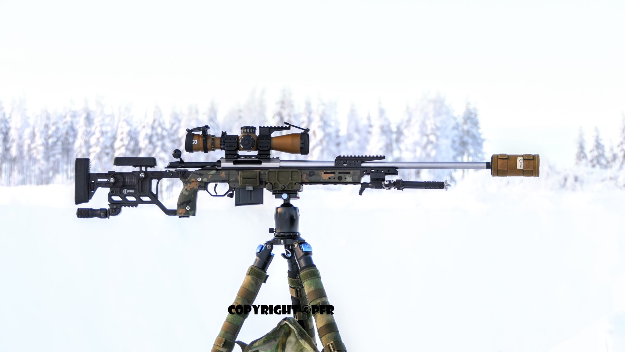

What's the weight on your gun? I've been thinking about something with pretty much identical components.
261 oz with the triple pull. +5 oz over. I can get it under by removing the caps and sunshade easily. I could probably switch out to Spuhr and save more.
248 oz with single pull and SOAR clamp with everything on. A little more with the double pull likely but under.
Keep in mind, I asked Foundation for a standard weight Revelation. Could take out more in the rear if needed. It balances perfectly in the current configuration.

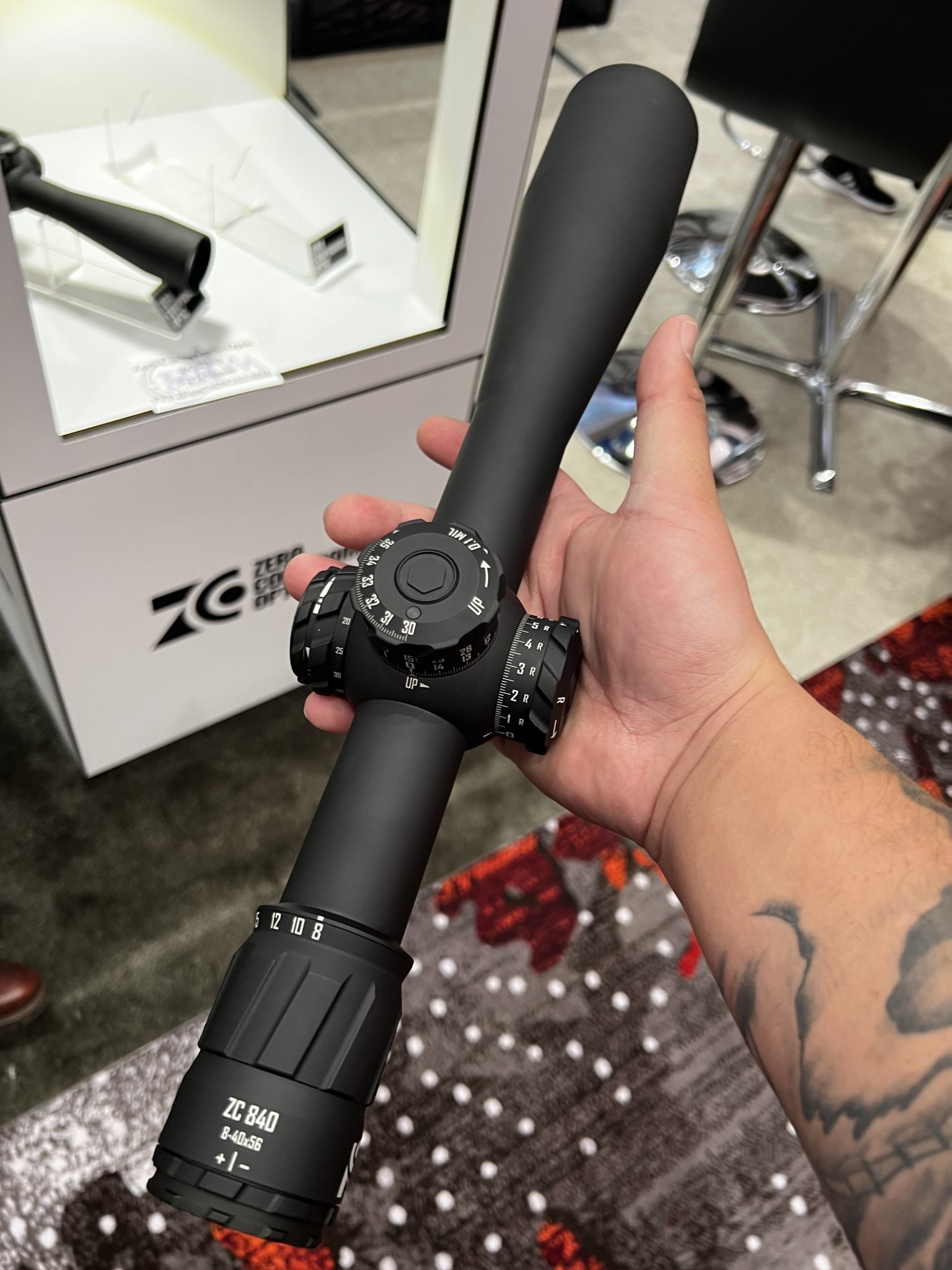

I’m currently running the Kahles 525i DLR on all my comp rifles but the new ZC840 has severely peaked my interest, when will they be shipping out to dealers? I want to look through one before I make a decision to sell or trade in my Kahles for a couple of ZC840’s
About 60 days or so :)
