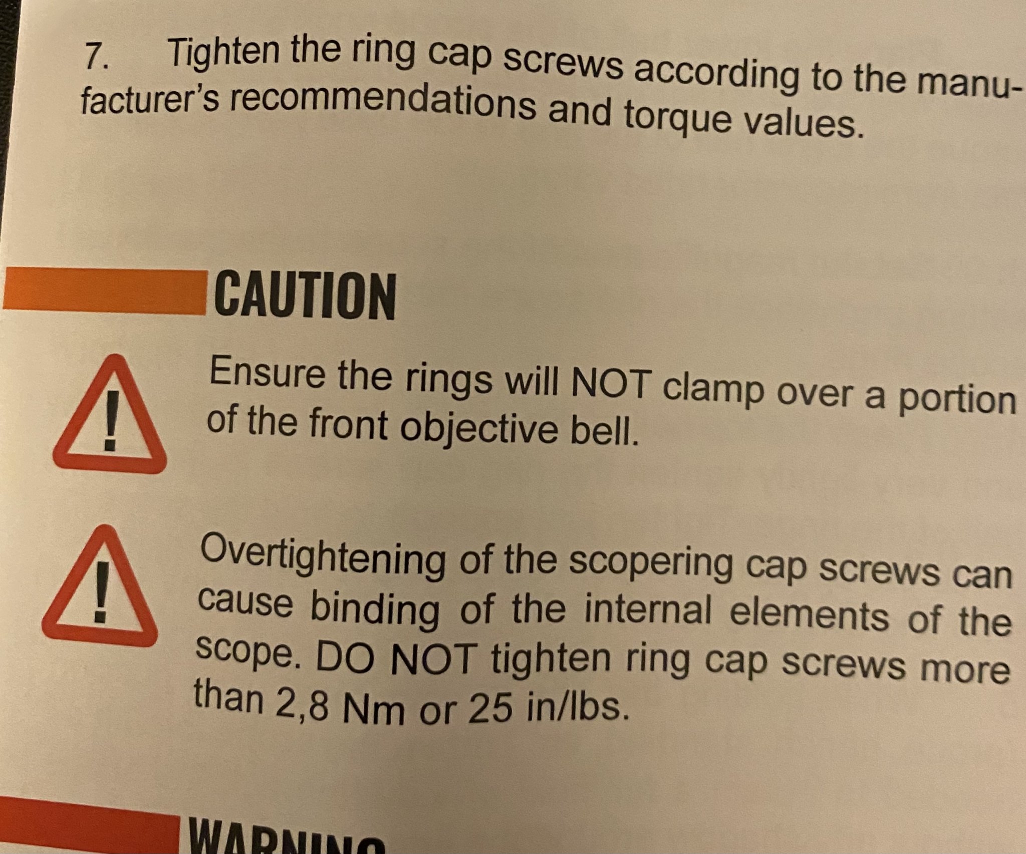

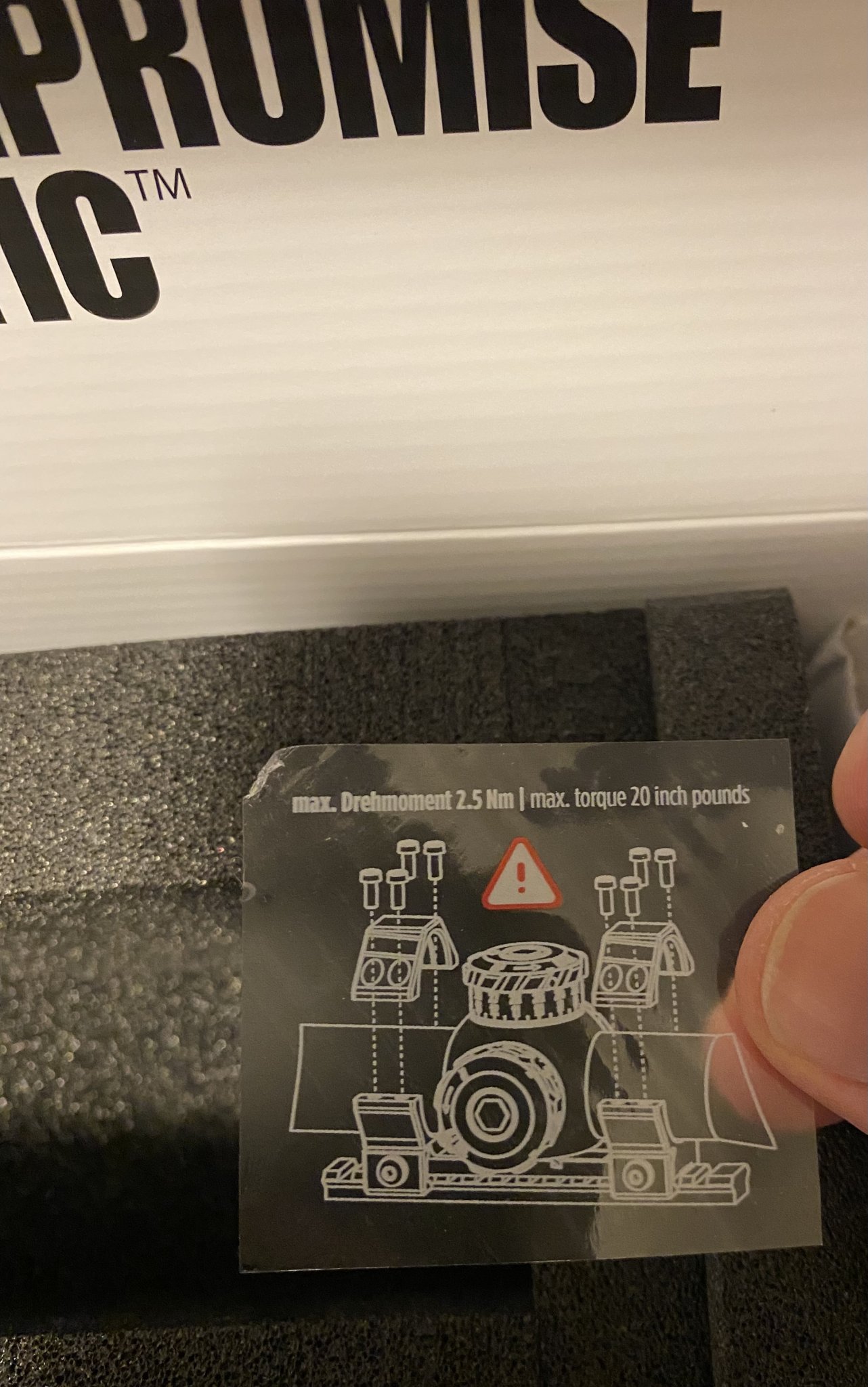

One thing that might be worth clarifying is that there is a disconnect between the sticker that came on my scope and the owners manual that was included. My scope had a sticker saying not to exceed 20 in Lbs while the manual said don’t go over 25.

asking the forum to ignore people who don’t understand basic mechanical engineering principles talking about mechanical engineering.
I'm not sure where you see that we don't recommend more than 25 inch pounds. The literature and Operator's Manual clearly say to use the ring manufacturer torque specs. I know, I wrote the manual.
ZCO scopes will handle the ARC torque just fine as they specify. No worries at all.

The ZCO employee says that nowhere do they recommend NOT going over 25 in/lbs and that he wrote the manual. Now, it does appear to say exactly what @gebhardt02 said he wrote....i.e. follow ring manf recommendations for torque.
But, the owner of one of ZCO's scopes showed up pictures of a sticker on his box and a shot of his manual with one saying don't go over 20 in/lbs and the other say don't go over 25 in/lbs, which is a contradiction, on the same page, of the "follow the manf recommendation" statement????

1. A member here, @spelunk , posted that Jeff Huber directly told he "recommended the normal 18in pounds or risk causing damage" and I have no reason to disbelieve him (that is, spelunk).
2. @gebhardt02 stated that owners should use the manf recommended torque spec and that he wrote the manual so he should know
a. He backed off of this a bit and deferred to Mr. Huber: "I defer to Jeff's opinion on the ARC rings and required torque value. Those rings are quite obviously a much different design than the owner's manual was originally written for. If Mr. Huber has specifically told an owner to use a lower torque value, please follow that advise, there is most definitely very good reason for it."​
b. Another member, @elmuzzlebreak, posted pics of the manual that had a clear contradiction and and included the following:​
i. "tighten ring cap screws according to the manf recommendations and torque values"​
ii. "Do NOT tighten ring cap screws more than 2,8 Nm or 25 in/lbs"​
iii. And there is a sticker in the box stating "max torque 20 in/lbs"​
Now, yes...I believe that these ZCO citations all refer to more traditional rings but there is still a bit of a contradiction in their published documentation AND I do think its reasonable to expect ZCO to clarify these issues with respect to both traditional rings and, given what Mr. Huber said to spelunk, ARC rings and any other use case.

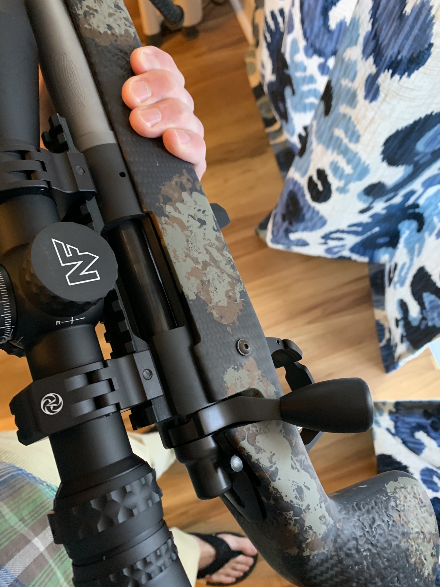

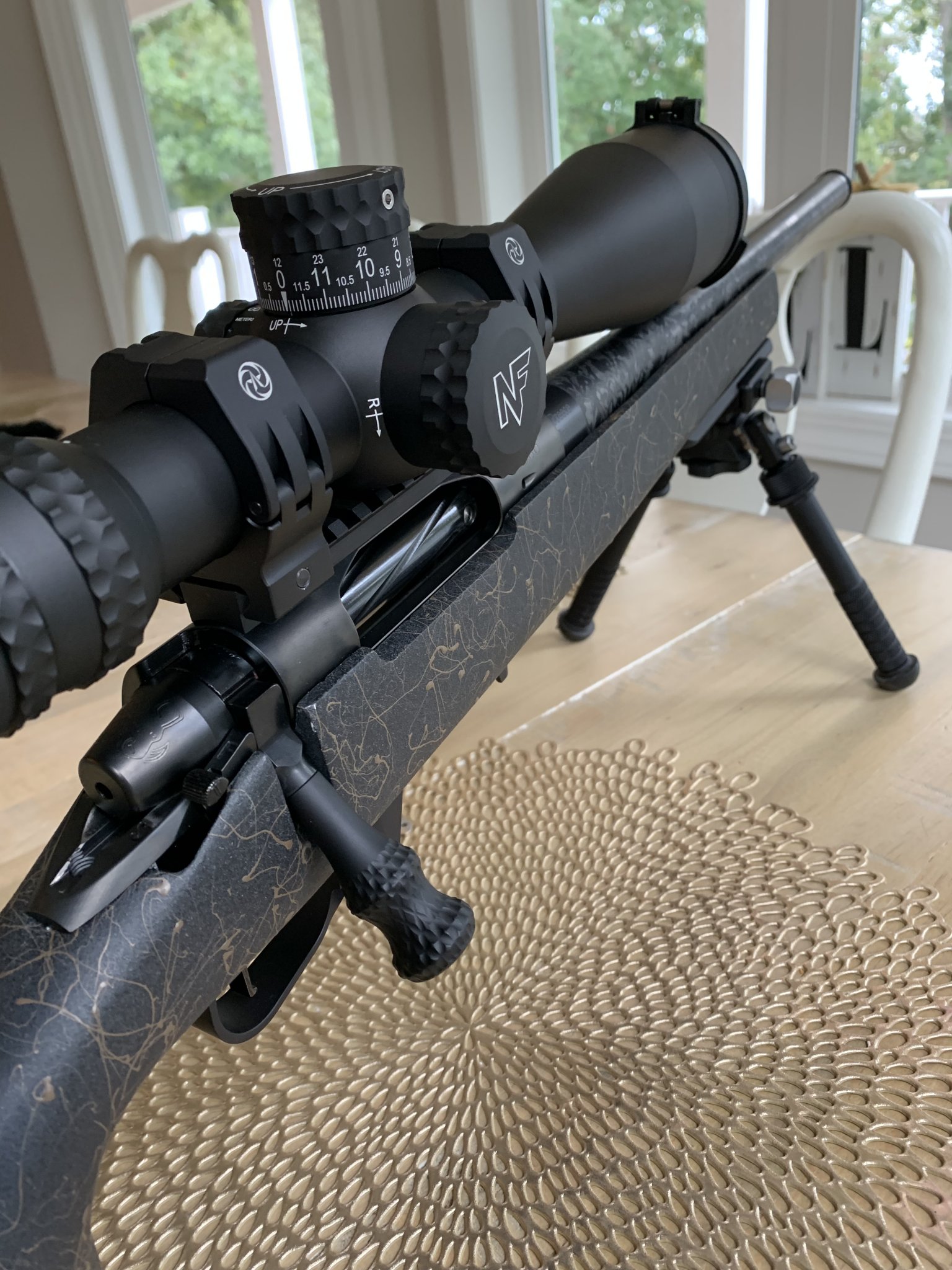

All torqued to 55 inch lbs with no issues, I will continue to use M10 rings. I’ve had several ZCO in ARC rings with absolutely no issues as well, mine sit in Spuhr now though.

We will also go ahead and say that at no point do we recommend going to 55 inch pounds even on the ARC rings. We have been a huge fan of their rings since day number one however we prefer to use 35 inch pounds on these rings. That is our official recommendation for these rings specifically for our products.
Common sense ultimately must prevail here. The ARC, Spuhr, Etc. rings are widely popular and in use throughout the country without any issues on our scopes. They are a great match to our products and we recommend them all very highly.
HI Nick - Thank you so very much for taking the time to research this and reply. 💪
I'm sure there will be no issue with the scope moving in the rings at all at 35 in/lbs.
Cheers and I'm looking forward to getting your 5-27....oh, and mounting it in M-10 rings! :LOL: ;)
Gentleman,
My apologies for the absence on this topic this week. We've been going through a few items and have obviously been very busy catching up from SHOT. I've spent some time consulting with our engineers and looking at some design stuff and just haven't been on here as much to check in on things. Again, sorry for the absence.
It is quite frankly impossible to provide one single specification on ring cap screw torque values to cover every single type of rings design and application. If we had to give a single number to cover as wide a variety as possible, our official recommendation would be 25 inch pounds. I understand the sticker in the box says 20, that's already in the process of being changed. There are just too many variables to take into account such as lubrication on the screws, screw size, number of screws, etc. to provide recommendations on every situation possible.
Hi Nick, appreciate you taking the time to respond to the query considering current workload.
Also understand the conservative approach recommended, but I do distinctly remember this issue has been questioned multiple times since ZCO first released and a statement around 55 inch pounds for arc rings only being ok, issued from ZCO. Trying to go back through historical threads on SH but can’t find it just yet.
Obviously you can appreciate our concern considering a lot of us will have torqued up arc rings with ZCO scopes and are concerned we may have inadvertently caused internal damage that will be exposed at some point later down the track.
Reactions: Baron23 and ACard
Thank you for voicing my concern as well

Sorry to bug you I’ve got a 527 recently and put it in Hawkins heavy tactical rings because I’m adult and don’t prefer hinges. I’m having no trouble with my scope just wondering what a drag in the parallax would be like? Turning the dial and no correction of parallax? Or more of an issue turning the dial?
