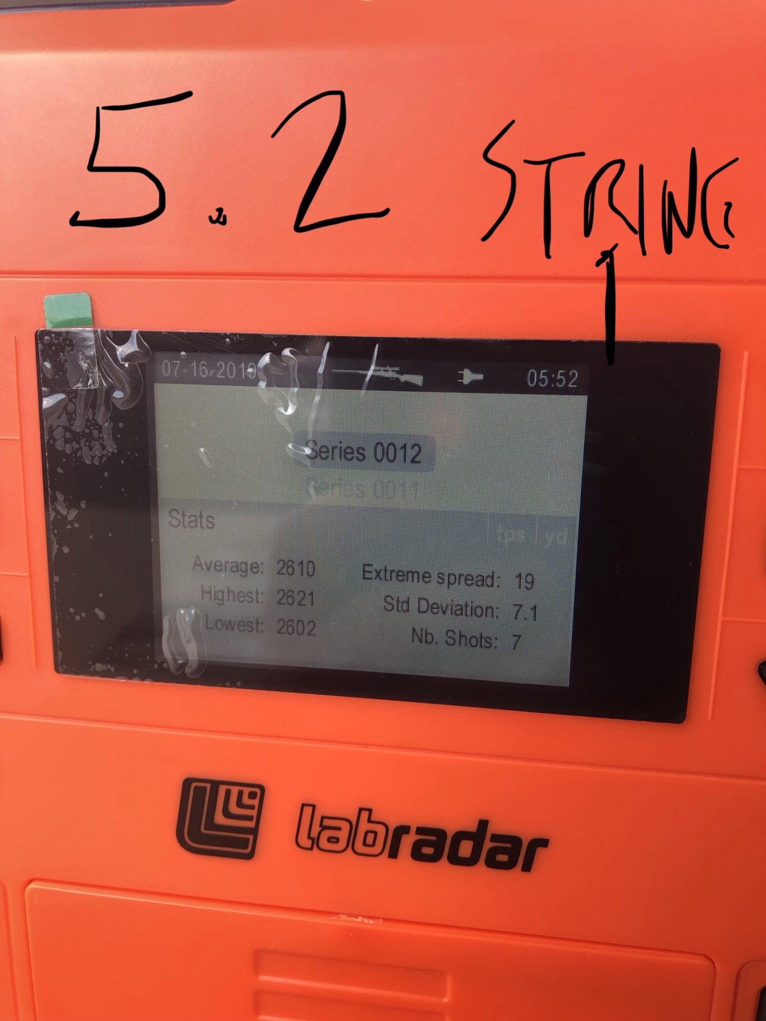

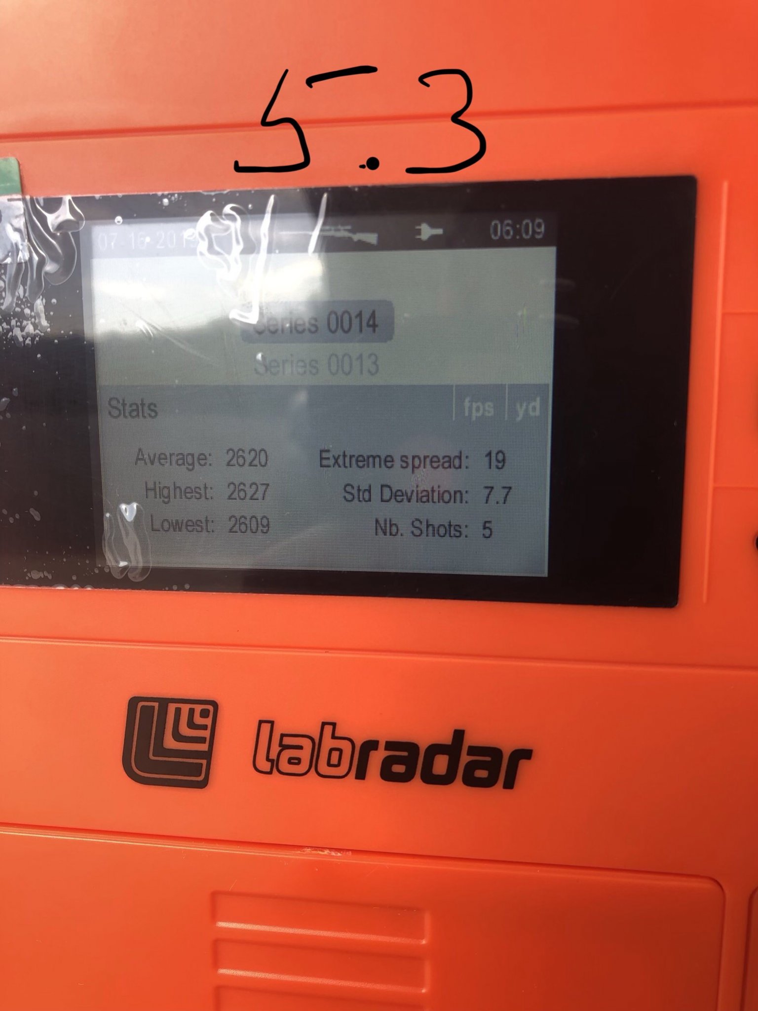

Does anyone accomplish these single-digit ES/SD values I read about here using Hornady brass? Prime brass?
I've been reloading / handloading for 50+ years so I have a good grounding, but I've only been loading 6.5CM for a few months after a couple of decades' hiatus from bottleneck rifle. I'm using RCSB match dies on a Dillon 550 press, Sinclair mandrel for expanding after FL resize. Scale is an ancient RCBS beam scale with weights verified via check weights - it's consistent and accurate to under 0.1 grain. Trimming to 1.191" and chamfering with an equally ancient Forster trimmer and 3-in-1 head powered with a hand drill. Annealing via Anneal-eez. Rifle has a definite preference for Hornady 147 ELD-M factory ammo so I've been using that bullet with H4350 (41.3 grains gives 2799fps at best node so far). Seating depth trials between 0.015 and 0.030" off the lands. Concentricity is 0.002" or so. I'm getting 3/8-1/2" groups @100. Sometimes better, almost never worse.
My first few 5-shot strings did give single-digit spreads and deviations as I worked on OCW workup. The frustration is that after a few hundred rounds with both Hornady and Prime/Norma brass, the overall averages are 25-30 ES and SD of 9-11. Consistently ho-hum, about what I see with factory rounds.
Is this about what I can expect with cheaper brass? I'm going to try Lapua brass in the near future, but I have several hundred pieces of once-fired Hornady and Prime brass I'd like to use to its best capability.

I just chrono’d a new load last weekend.
Hornady brass
140 ELD-M
CCI200
RL16
7.8 for 6 shots (SD).
As SuperSubes said, you are doing fine.

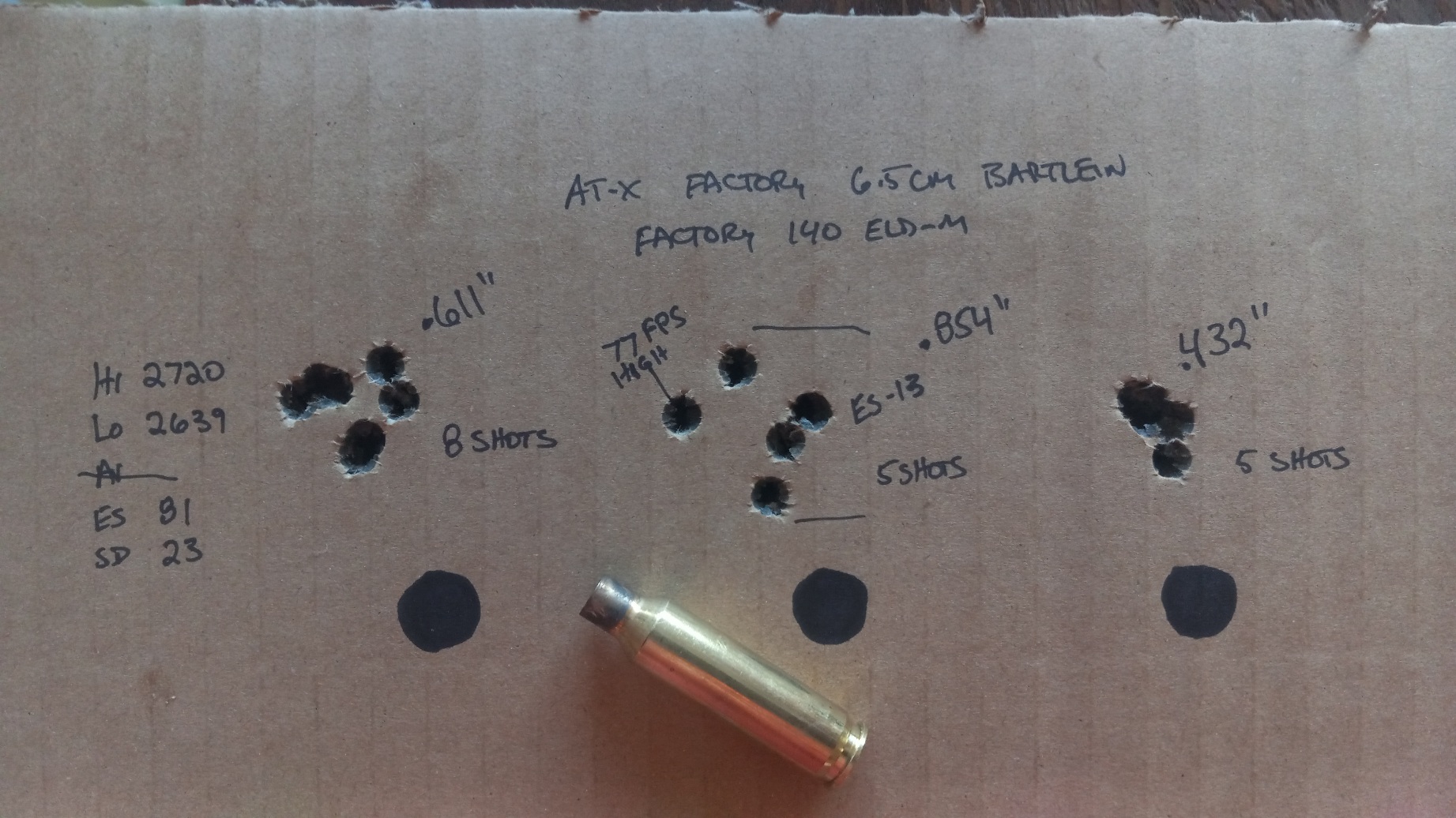

I have loaded close to 2k 6.5 rounds in Hornady brass. Yes, there are FAR better options. I have 2 boxes of Alpha that I have yet to play with because my supply of Hornady is still working.
I load 6.5 CM with 41.6 and 42.5 grains of H4350 and 140 ELD or Berger 140 bullets in RPR
I started reloading with Hornady brass kept from factory rounds. I then "splurged" and bought 100 pieces of Lapua. For me, there is a noticeable difference in SD and ES within the same exact loads, across most brands of bullets. It's just better brass in my opinion. I also got 250 pieces of Norma brass and that shoots better also. I'm using the Hornady pretty much for foulers and warm-up shots.
If you don't want to spend 125 bucks on box of Lapua brass, then just buy a box of Berger factory ammo. That factory ammo uses Lapua brass which you can save and reload. I bought a box, took all the measurements of an unfired round and I just match that same round for my reloads. I've shot .25 MOA all the way to 300 yards with that combo.

The 5.2 and 5.3 is primer weights...note the difference in average velocities
This was in a 308 w/ lapua brass
Did the same test in 6 Creed a while back and the average velocity delta between 5.2 and 5.3 was 12 fps
Reactions: Geno C.

I've now shot 2 boxes of 140gr ELD-M (6.5 CM) ammo through my factory AI AT-X barrel.
First box (a year ago) threw a 2,671 / 102 ES / 44 SD when I put it over a chronograph. Oof. It did however average 2/3 MOA for the 4x5 shot groups as I was breaking in the barrel.
Yesterday I chronographed a second box, just to use it up as it was collecting dust. I only chronographed two groups (5 and 8 rounds), but the ES on the five shots was 90, and it was 81 on the 8 shot group. 😳
First group of the day yesterday was pretty impressive for a factory load. I followed that up with a piss poor group that was almost a half-minute larger, and then the third group of 8 shots was in the middle. No wonder those guys are always harping on sample size with velocities like that. 😄. For the record though, average group size was back around 2/3 MOA again. As a hobbiest, I am no pro...but I reload as a passion, and my spreads from one group size to the next are usually within .100", not double the size.
I've got 30 pieces of their 6.5 CM brass now (no idea what happened to 10 of them). I think that will be enough for me to do a decent test ot two on their brass consistency in various areas, which I plan on doing in the very near future. I've got some Lapua and Starline brass tests to run the results up against.
Target was shot R to L.
Reactions: BuildingConceptsllc
