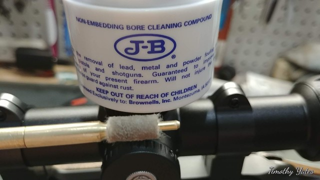

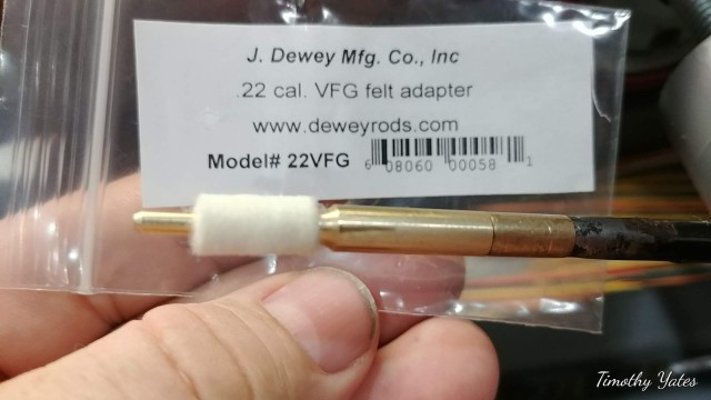

    Carbon ring is treated separate. I use JB and VFG felt pellets to remove the carbon ring. JB may touch the rifling but doesn't go in the bore.

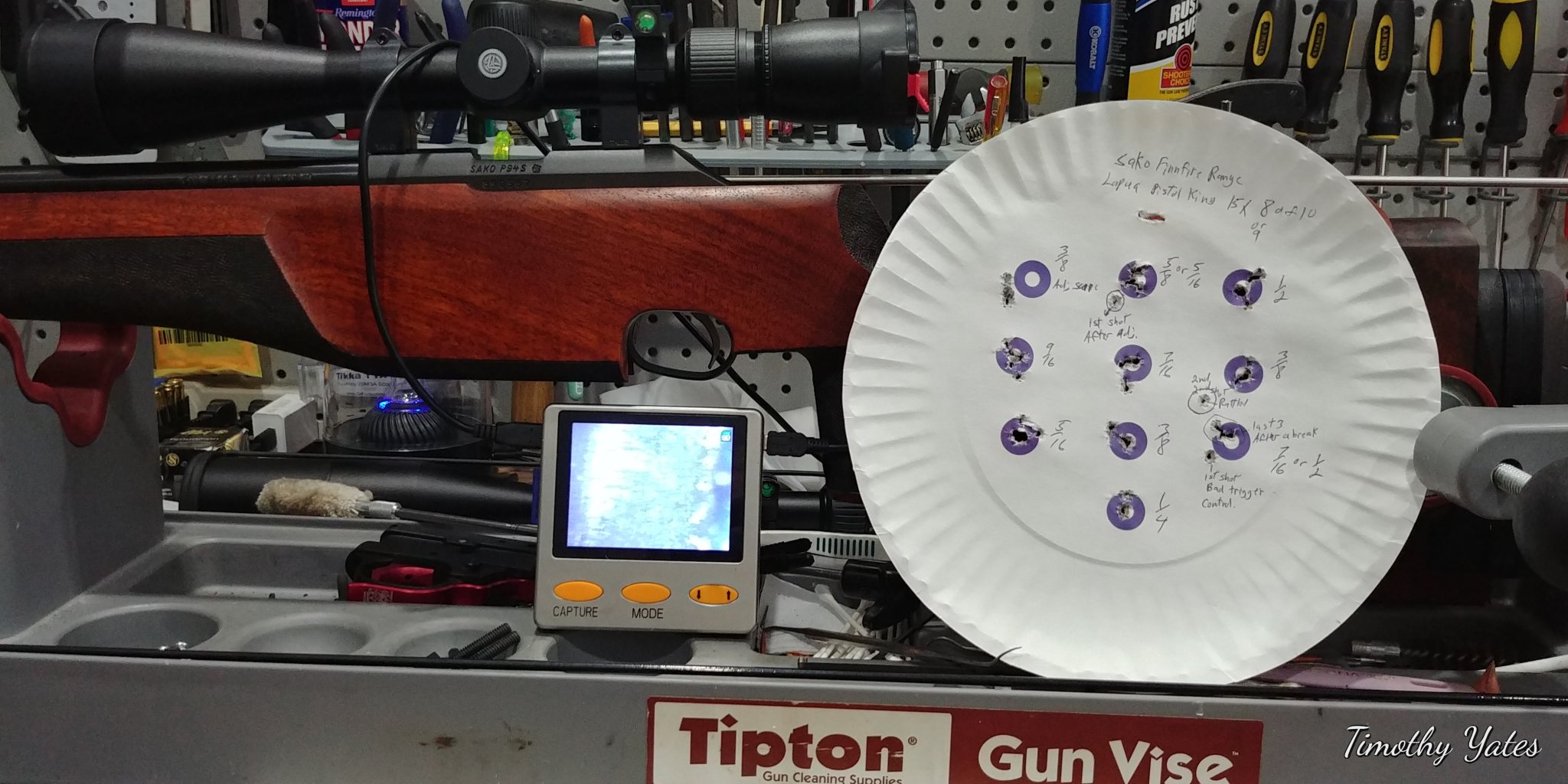

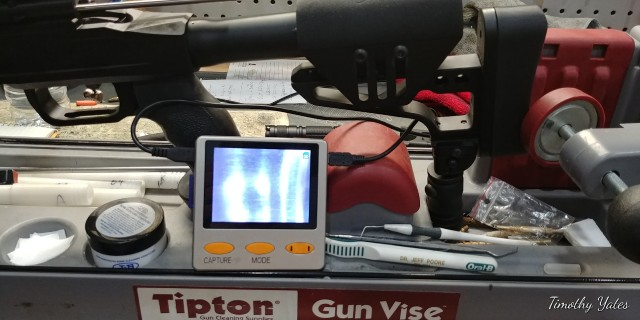

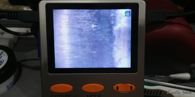

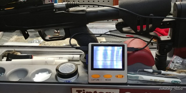

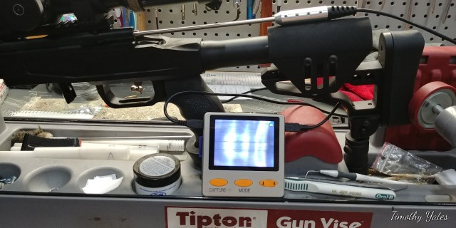

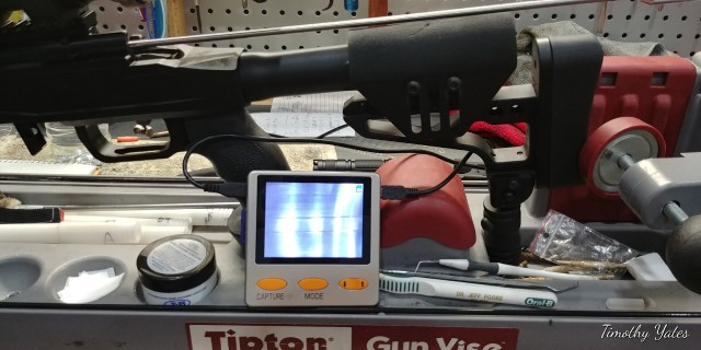

    I didn't think to take borescope photos before cleaning but here is what it looks like now and the cleaning method I used. This is the first time this bore has seen a bronze brush or JB.
    Method...
    1. Run 2 wet patches with 50/50 kroil and shooters choice MC#7.
    2. Use bronze brush, make 10 strokes.
    3. Run 2 wet patches.
    4. Run 1 Dry and inspect with borescope.
    5. Use JB and VFG felt pellets to remove carbon ring.
    6. Inspect for carbon ring.
    7. Use JB and VFG felt pellets and clean bore 15 strokes.
    8. Repeat step 7.
    9. Run 2 wet patches.
    10. Run 1 dry patch.
    11. Inspect with borescope.
    12. Remove excess JB from chamber entrance.
    13. Run 1 wet patch.
    14. Use bronze brush, make 15 strokes.
    15. As many wet patches to get a clean one.
    16. Run 2 dry patches.
    17. Inspect with borescope.

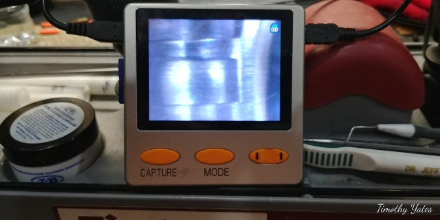

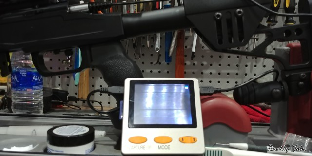

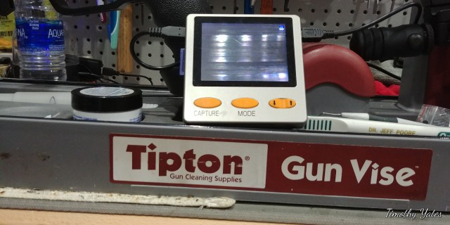

    Here are the results.
    7113171
    7113172
    7113173
    7113175
    7113176
    7113177
    Looked almost as new after I was finished. Not a blemish anywhere.

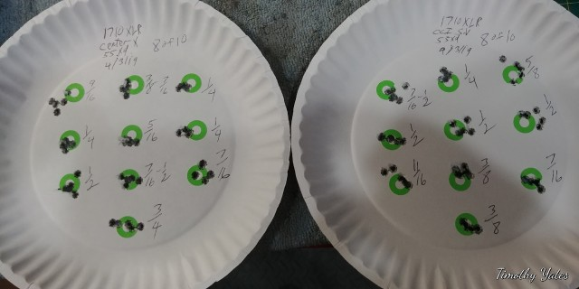

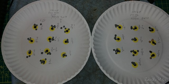

    First opportunity I get (hopefully tomorrow) I will shoot and record the very first shot after cleaning and record the group sequence to see how a cleaning like this will effect group size in the beginning and see if group size increases or decreases as the rifle is shot. I know there has been a lot of talk about seasoning the bore and such before good groups are attainable so I want to find out what happens with my 1710 XLR shooting 50 to 150 rounds of Center-X. What I have here is a basic production gun, not a full blown custom bench rest rig. So I am not considering a cleaning method for a custom gun. I don't run dry patches, I don't clean after 25-75 or whatever rounds, I push and pull my brush both ways, I use JB bore cleaner, I use a boresnake, I probably do several things a bench rest guy would never do and that's fine.
    Here are the test results. The date of the original post was 4/6/19.

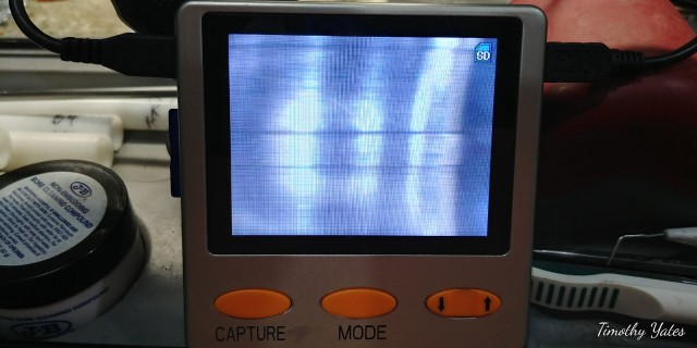

    Ok, here is the follow up. First off, the borescope photos didn't really turn out good but as you can see the first photo has a slight carbon ring building up. The rest are just random photos at different places in the barrel. Still pretty shiny I think for 300 rounds. The second photo is a reflection, camera angle issue. I also shot with my Atlas bipods first and then shot using my BR Rock rest. Never shot groups on the same day with same ammo but using both methods. It appears the BR Rock rest has a slight advantage. The reason for that is on this particular rifle I get a lot of heartbeat feedback through my cheek that transmits to the stock and causes a slight pulse in the x-hairs. I have played with different shoulder stock positions but can't really get rid of it. Any suggestions are appreciated.

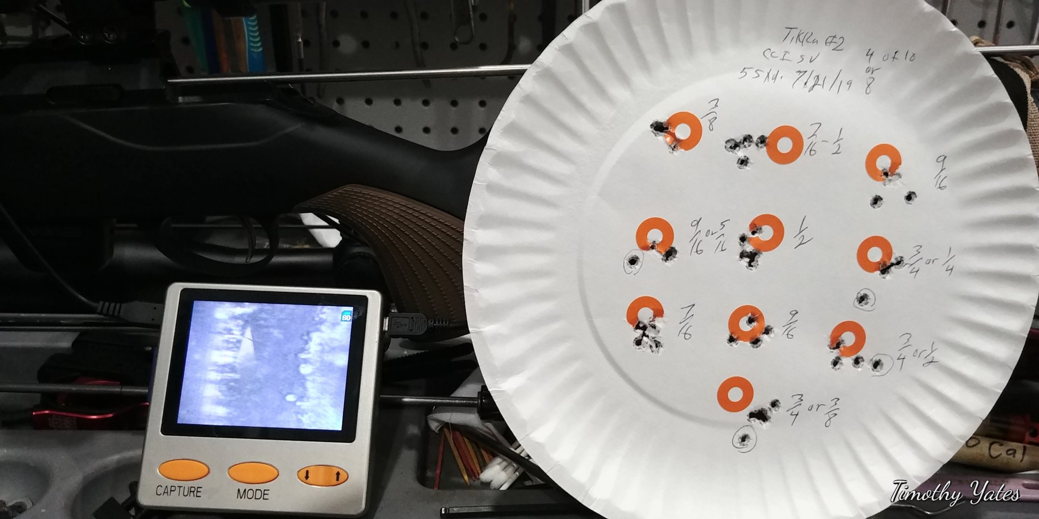

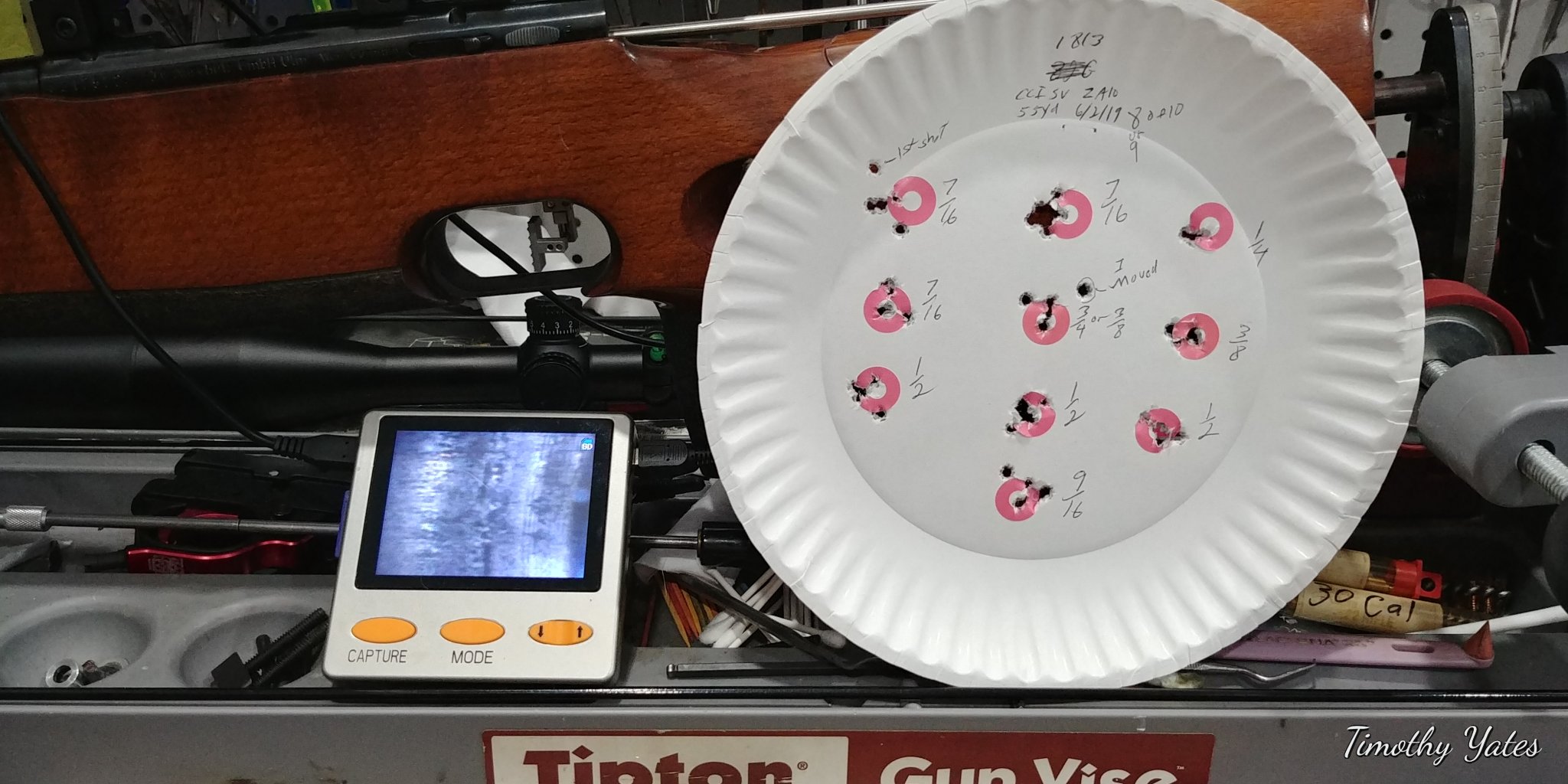

    First off, borescope photos after 300 rounds.
    7113180
    7113181
    7113182

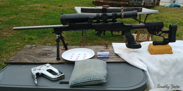

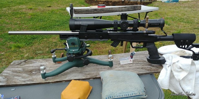

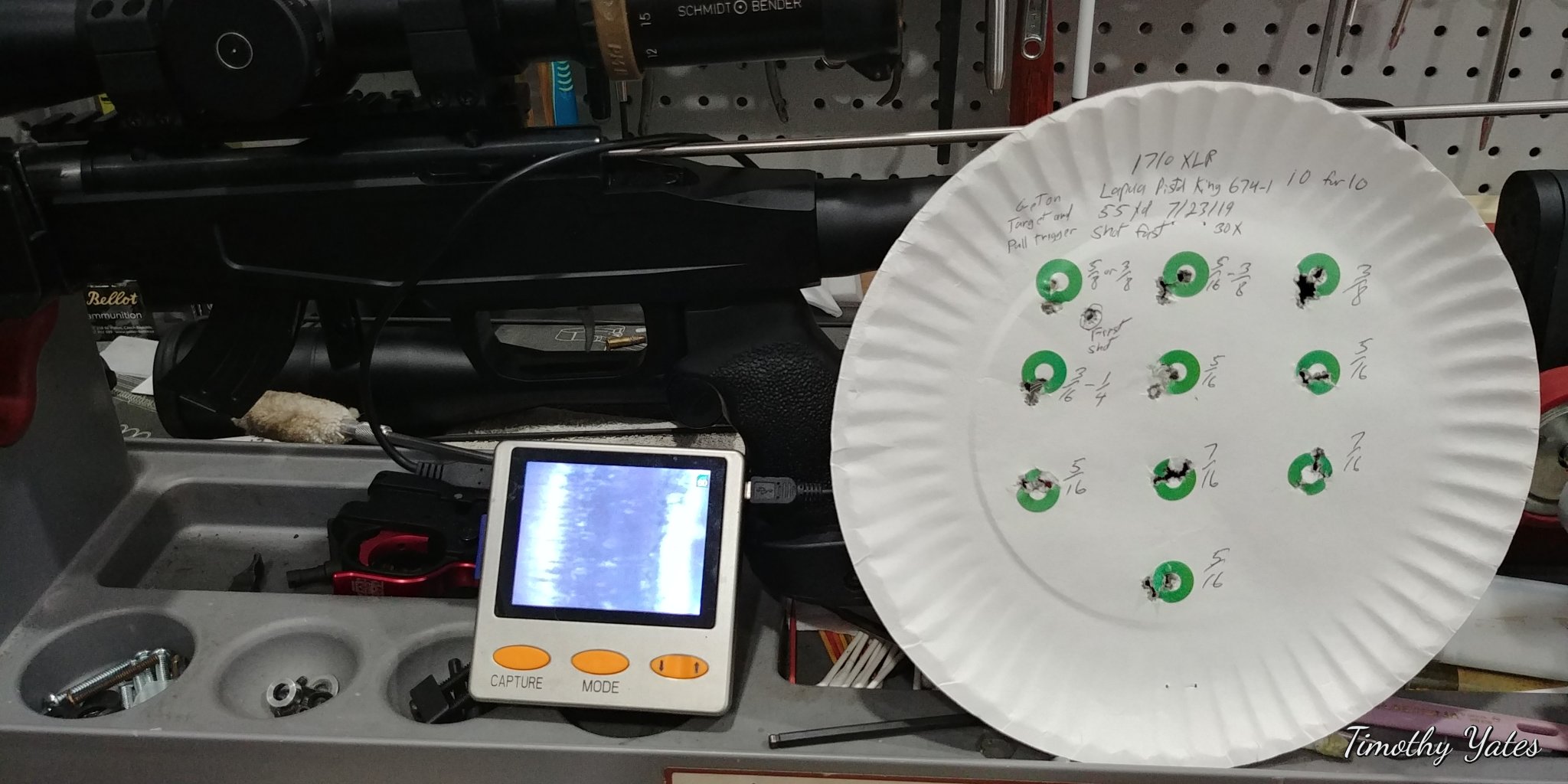

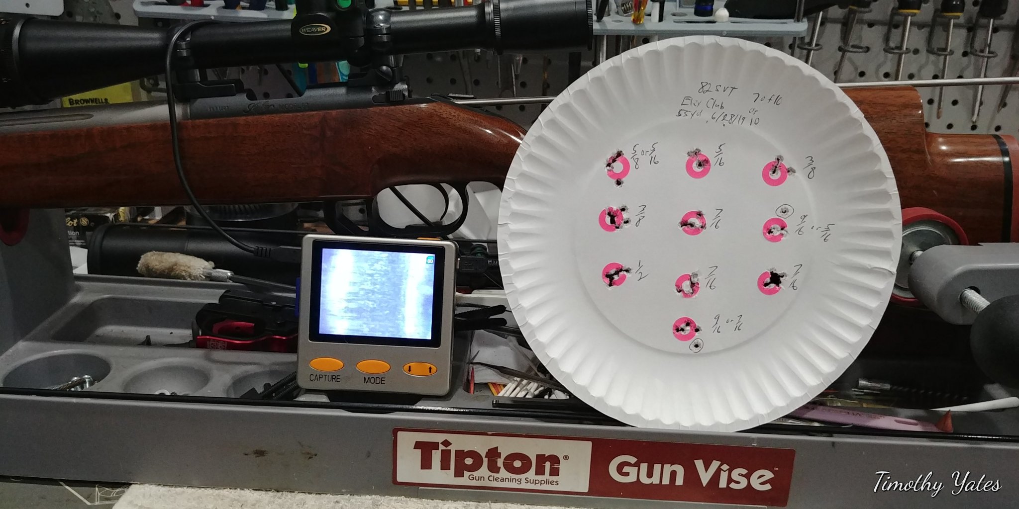

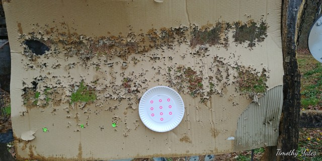

    Here are the two setups I used.
    7113183
    7113184
    Since I can only post 10 photos I will continue in another reply.

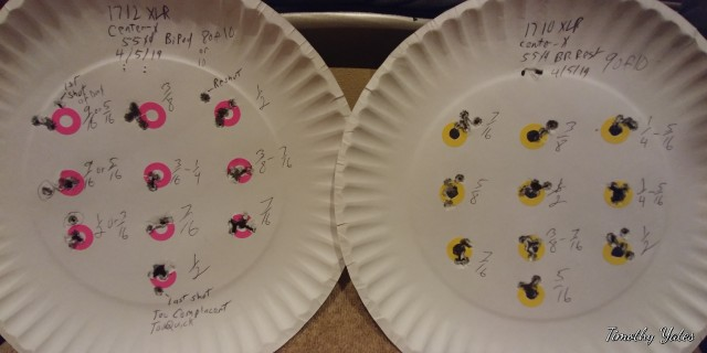

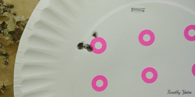

    Beginning of test.
    7113187
    First shot. Rifle was zeroed for Center-X. Shot was not far away from the other 4.
    7113188

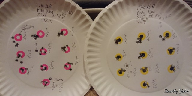

    First 5 shot group. No break in period needed. After all that cleaning.
    7113189

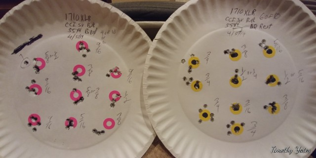

    Groups, interesting fact, I didn't adjust the scope but the groups moved over on their own.
    7113190
    7113191
    7113193
    Final thoughts. Some of the bad shots I am sure was me, especially on the bipod groups. Some groups was a total Cluster (sdfs) such as groups 4, 7 and 10 with CCI using the BR Rest . According the other groups on that target those bad groups tell me I just didn't shoot well. Not sure what else to think.
    The order these targets were shot in was top to bottom with the bipod then top to bottom with the BR Rock rest. So, first shot with Center-X was out, which is understandable. Not only the first shot but the first FIVE with Pistol King is crappy. CCI, first shot is actually the bottom right group that is 3/8", wasn't paying attention when I was identifying the target.
    Next, going from CCI back to Center-X with the BR Rock rest, all shots really continued as if I never shot the Pistol Match or the CCI. Next going from Center-X to Pistol King, nothing changed, no 1st round flyers or such. Last group, CCI first group didn't do well.
    Conclusion, even after a heavy cleaning as described in my first post, this Anschutz 1710 XLR doesn't need a break in period to start shooting great. After the cleaning I see tighter groups with the Center-X and Pistol King. To be honest, this is not the first time this has happened. I have seen this type of result with other rifles. This time I saw a need for a good cleaning and thought I would document the process. The results to me are not all that surprising. Although I am disappointed in CCI SV and kind of a sore spot left because I didn't really get a good ten for ten 1/2" groups. But, still happy with the outcome because I know the bad shots were me.
    Others' thoughts and comments are welcome.

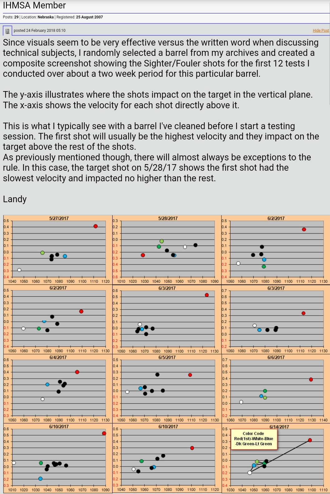

    You can also see in the graphs that the second shot is somewhat slower than average. So fast-slow and then normal.
    In reality it does not really matter, with 22LR you can just waste one (or 2). But my mission to get them all in to the same group. The goal is in the distance.. Looks like 0.2mil up but needs much more testing.
    If you have a rifle with a consistent cold bore/first shot flyer, I don't think you will ever cure it. I don't have a gun like that but if I did I'd live with it or sell/trade it. I do have guns at random that will do this but that's just it, it's random.

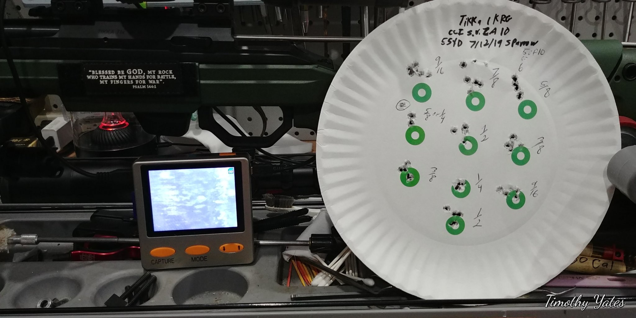

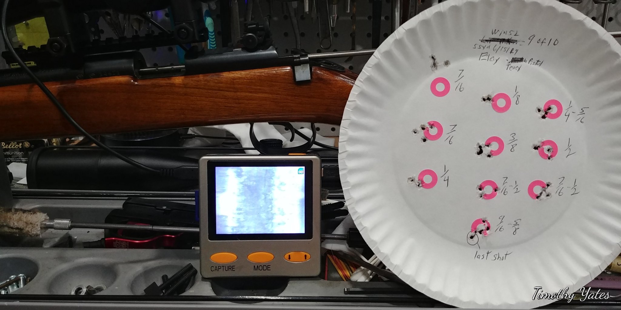

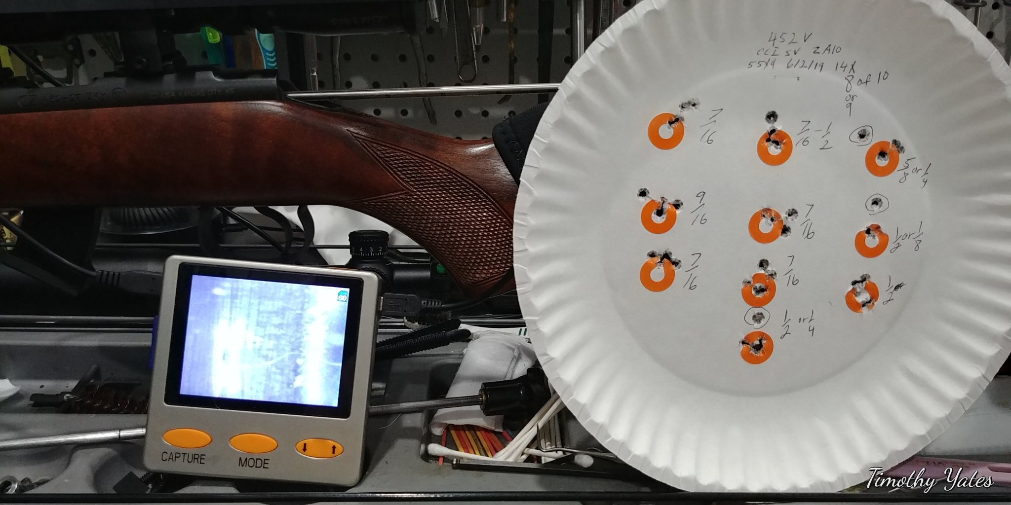

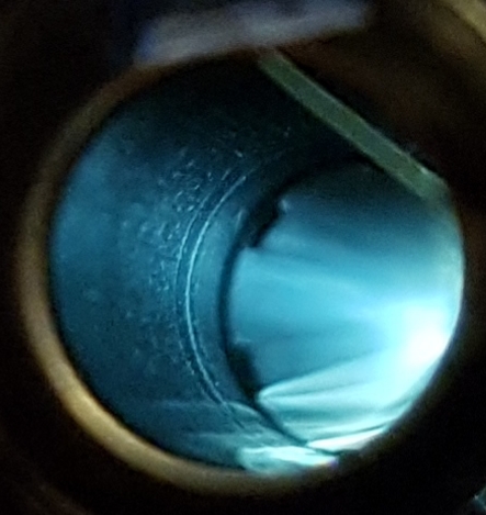

    Here are the photos of rifles, carbon ring and last group shot with that rifle. Personally this doesn't really prove anything except that my barrels have a carbon ring :eek: :p. The rifle shot is listed on the targets. They all have the ring and they all still shoot good. At least you know what the ring looks like in case you never seen on before. The photos are not attached in any particular order.
    Trivia: The Winchester 52 is pre A and was made in 1927. Heaviest carbon ring build up is a tie between the 1710 XLR and the Tikka #2. Nether give me problems extracting. lightest ring is on the CZ 452 Varmint.
    Bottom line, don't worry about the ring unless it bothers you then remove it. I clean mine on occasion.
    Thanks for the pictures. I am quite confused about a metal ring in my chamber. Do you have any experience of one of these?
    It looks like 2 ring shapes embedded in to the chamber, next to each other.
    One is clearly more visible than the other and I can feel it with a bronze pick.
    @ Near miss, I can't say that I have seen anything like that in any of my chambers. Maybe I do have them but the angle at which they are viewed causes them not to show up? I'll have to check mine and try to replicate that angle you are using.

    It looks like an imperfection that was formed when the chamber was cut. As long as the rifle is accurate, feeds and extracts, it isnt a big deal.
    I was thinking this too as it is quite uniform all around it. The rifle is somewhat accurate but moody, it looks like the ring collects dirt easier. Maybe I should contact the resale about this.
    Hint- It's most certainly not a carbon ring. I was being sarcastic. To remove that you would need to setback and re-chamber.
