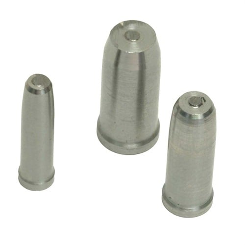

1.527" is what your fired brass measures? What comparator are you using to get that measurement? Is that with your primer knocked out or in? 1.541" is a GO gauge so , am I missing something here ? NO GO is 1.5450"
Reactions: akz28
As has been mentioned, ejector marks aren't always a sign of pressure if that's the only thing being seen.
OP: are you experiencing any hard bolt lift or anything like that?
1.527 is the fired brass with the primer removed. I shoulder bump back to 1.525. I use the .400 comparator that came with my Whidden die set. At that length the stripped bolt falls gently down. I dont have any issues loading rounds at 1.525.
Ok, well I don't have any point of reference with that comparator so it's hard to say. It just looks like it's pretty short with those numbers but, that could be just how it's being measured and not an issue.
Reactions: akz28
For some reference I just checked my 6.5 Creedmoor brass that is sized and ready to load with the Hornady comparator with the D .400 adapter in there and my brass is 1.535". I checked a brand new cartridge and it was 1.533". I also checked my once fired and it was 1.536".

There is always a huge difference in comperators. I use a whidden 0.400 bump gauge just like @akz28, and my fired cases are 1.518, and I size to 1.516. New lapua brass measure 1.5135-1.5145 with same gauge. My chamber is cut to go gauge plus 0.002". Same smith has cut me numerous 22, 6, 25, and 65cm barrels and they have all been within 0.001 headspace.
Reactions: akz28
It would be interesting to check a piece of his brass with my comparator. Maybe if I see him at the range I can grab a piece and see.
Reactions: akz28
I'm using the same comparator to check fired and sized brass. So if it is off I am not sure it would matter since I am going back 2k from the fired brass measurement with the same comparator. But I do have a second .400 comparator that came with a different die set and will check today.
Does your fired brass close back into your chamber? How does your fired brass measure vs. the actual headspace of your chamber?
Don't do it! Lol I had two 420 whidden comperators, gave one away as it was like 008 different than the one I normally use.
