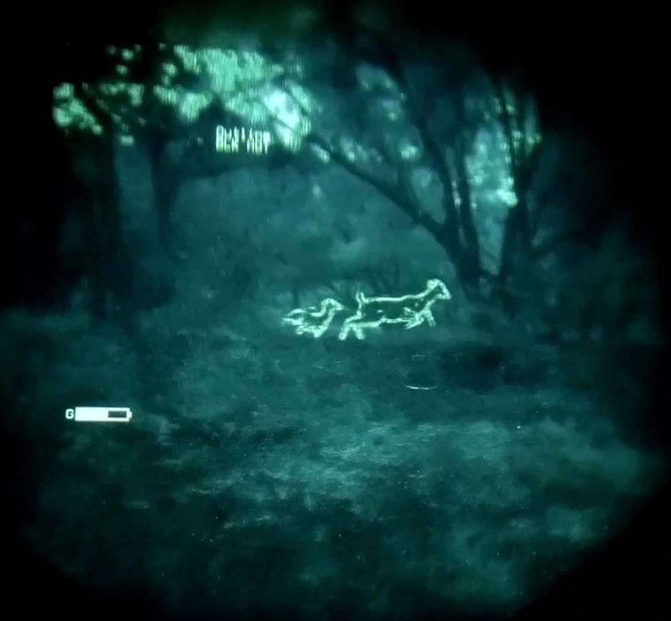

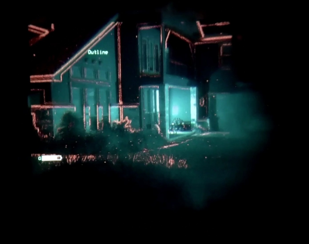

Among the things I looked through at Wig's place was this. In outline mode it's pretty neat. The limited FOV is a limit, the unit is a bit odd but I am sure I'd get used to the batteries and switches.
I loves me my NOX but when comparing outline-to-outline it's in the basic ballpark. You can wander and get hot targets out a ways, use it for pretty neat extra identity of things to not bump into, shoot at, etc. when its real dark.

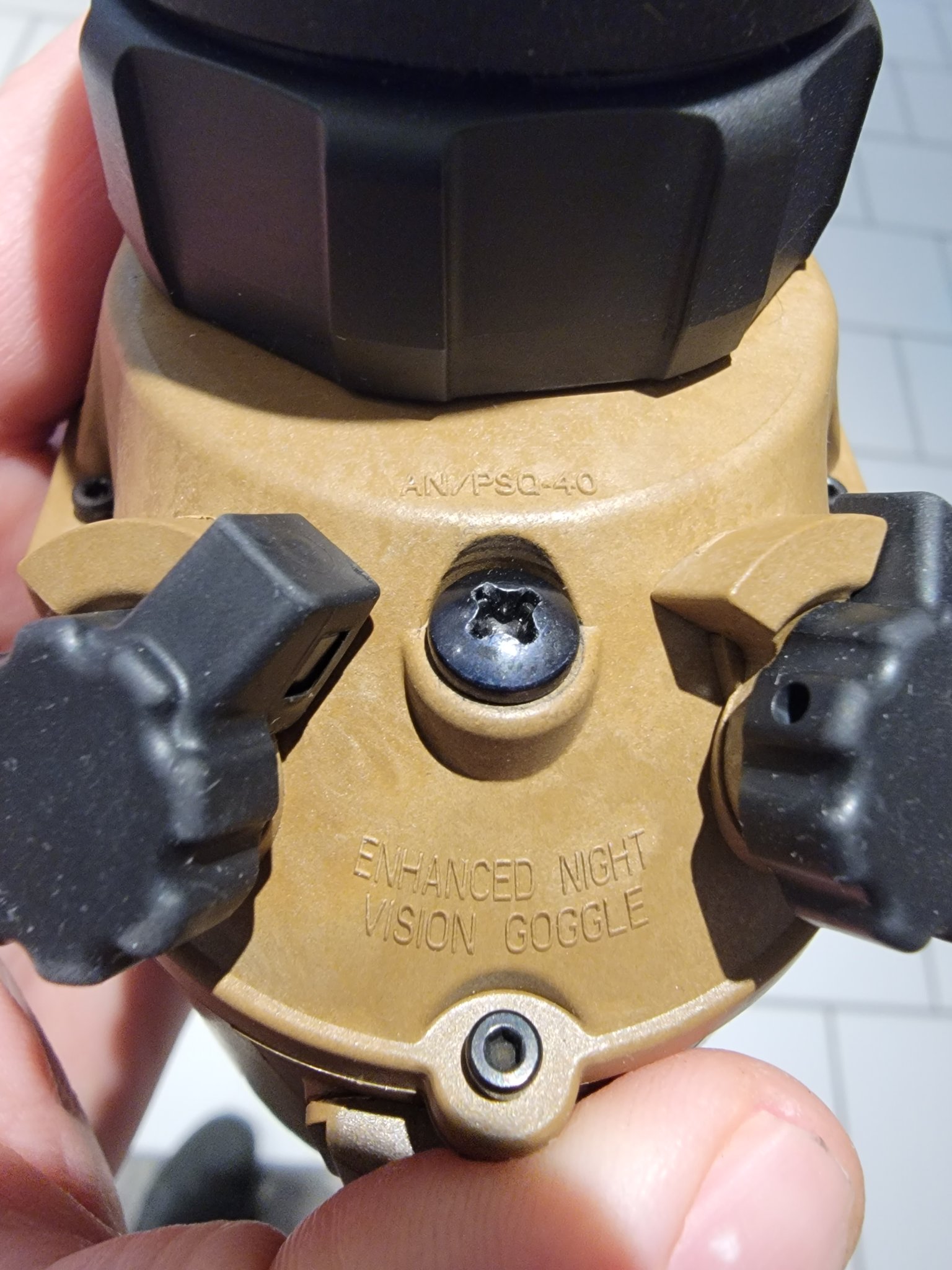

FYI....PSQ-40 is the ENVG-III mono goggle. Another manf is making a commercial copy of it soon. Will be around $14k to consumers.
FYI....PSQ-40 is the ENVG-III mono goggle. Another manf is making a commercial copy of it soon. Will be around $14k to consumers.View attachment 7751678
That is awesome news and would be exactly what I’m looking for. However I had heard that there was one that fell through that was announced in August of this year. Is there an alternative coming out? That’d be epic!
