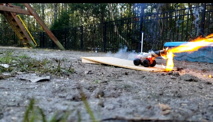

Make a pile at the end of the driveway and toss a match into it.
Or, get the fire pit going.
Put the powder in a ziplock and toss it in from 15' away.
Wooo boy! It makes a giant flash.

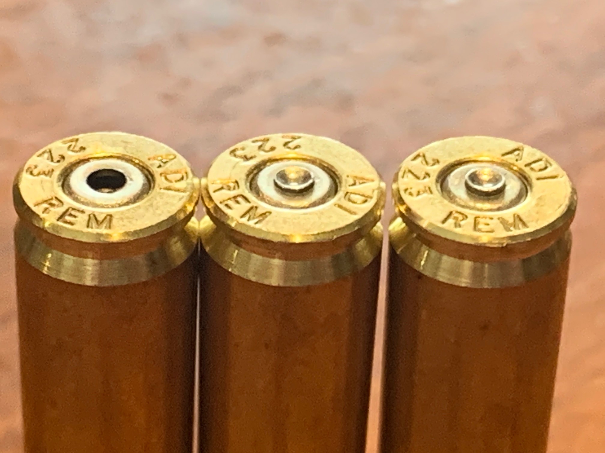

I inadvertently got a tiny amount of H4350 in RL-23 while working with my .243AI and got a few rounds loaded before I realized it. I thought, "How bad could it be?" and so, I tried it out. Blanked a primer out of the gate on what had been a pretty moderate pressure load before. The 2 powders had turned out identical velocities with identical charge weights in earlier load development work I'd done so I wasn't super worried which is part of why I tried it out instead of just pulling them down. After the primer blanking I pulled down the others and poured all the contaminated powder on a paving stone, lit it on fire and made the neighborhood smell great for a minute. This was after I'd done the same thing with H4350 and IMR4350 and had slightly more dramatic but otherwise essentially the same results. YMMV and my .243AI was pretty different from the typical long range shooter's 6mm Bisexual Bobcat rig in several respects so I don't know if any other combo would have the same result. Still, I'd just count it as a learning experience and move on with clean powder. The only "reason" I could come up with for those results was, "chemistry is messy".
what is "blanked a primer"?
Reactions: Sniperwannabee
One which looks like the striker has pierced it but rather than a simple piercing, a slug of the back of the primer cup is actually missing. In my experiences with this condition I've found the missing slug of cup inside the bolt body. Not only has the primer flowed but it actually completely lets go of a bit of the back end.
Like the one on the left (not my pic). The 2 to the right look like they were just about to send the raised bit of primer cup into the bolt body.

ok, yeah that sucks. only happens on my 6.5 CM gasser when I try to push it anywhere near 2700fps. and yeah they get stuck in my bolt jamming the firing pin.
I would scrap it and chalk it up to a lesson being learned. It not worth the risk to yourself and others.
Not to beat up on you, but this would be a good time to review your procedures. The old rule of one type of powder on the bench at a time is a good one. Think, stay focused and avoid distractions.

I lit the powder on fire in the front yard. My little girl loved the show!
