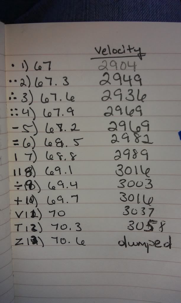

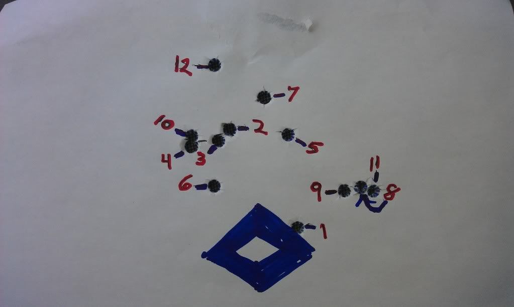

I just got my rifle back from the smith having the action bedded and my orginal load wasn't as accurate as before. I'm guessing it somehow messed with the harmonics in the barrel. This is my first ladder test I have done.
I'm guessing my node was on shot 2,3,4,5 then 8 & 9 maybe 11 with 8,9?
Let me know what you think.
Its a savage 112 BVSS w/ 26" fluted barrel
My test was at 300 yds.
Temp 90*
Winchester Brass
WLR primers
H1000 Powder
168 gr. Berger VLD
OAL 3.400" Mag. length
Load 11 & 12 seemed to make the bolt slightly heavier to lift so I stopped on 12.

3,4,5 - Looking really good.
8,9,11 - maybe. If you aren't happy with the velocities of 3,4,5, test these guys.
Re: Opinions 7mm rem. Berger VLD ladder test results
So In your opinion 3,4,5 look better than 8,9? If you don't mind me asking why do you like it better as a node? Just curious from a learning standpoint.
Thanks
Funny how we look at stuff differently. I would make up 5 rounds each of 8 and 9, plus a new load of splitting the difference between them of 69.2 or 69.3 grains.
Due to bolt lift issues, I would disregard #11
No right or wrong answer here...
<div class="ubbcode-block"><div class="ubbcode-header">Originally Posted By: B Man</div><div class="ubbcode-body">So In your opinion 3,4,5 look better than 8,9? If you don't mind me asking why do you like it better as a node? Just curious from a learning standpoint.
Thanks </div></div>
I like the way there is a clear trend of numbers - 2, 3, 4, 5 - all right on top of each other (remember, we are really only interested in vertical dispersion w/ ladders). The more numbers on top of each other, the more likely they are in an accuracy node and not just randomness.

+1.I agree, work with 2,3,4,and 5. Looks to be under MOA.
I just loaded loads 3,4,5, and split 8 & 9 for one load to compare to the other three. Hopefully I will have some time tomorrow morning to test them before it gets hot and the mirage gets bad. Testing at 300 yds again.
Trailrider, yes those loads were 1.8" so its looks promising.
Let us know how they shoot B Man. From the ladder test, it looks like you have got the potential for a great load.

Notice the difference in velocity from above with the same charge. All I can think of is the difference with the lighting conditions. Test was 91* and slightly overcast
