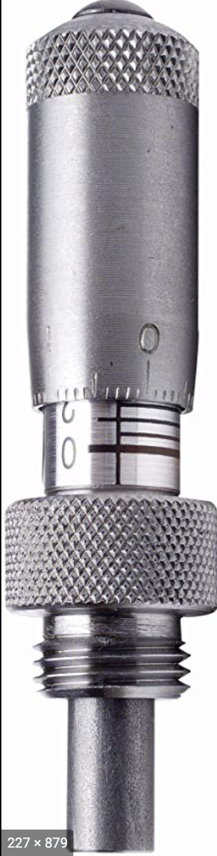

I have three of the old Hornady mic seater tops that have small numbers and thin lines. That is my only complaint with them, but I wear reading glasses when setting them and can still read the mic's. Not too long after I bought my mic tops, I noticed Hornady updated the mic settings on the new mic tops and the numbers and the mic lines were thicker.
Do you have the old mic tops like mine? I came close to contacting Hornady to see if they would swap out my old mics for the new ones, but I get buy with just reading glasses.
I'm keeping my old mic tops, for me they are still very useable.
Buy the Forster if you need it, it's probably the least expensive for the large mic top seaters out there.

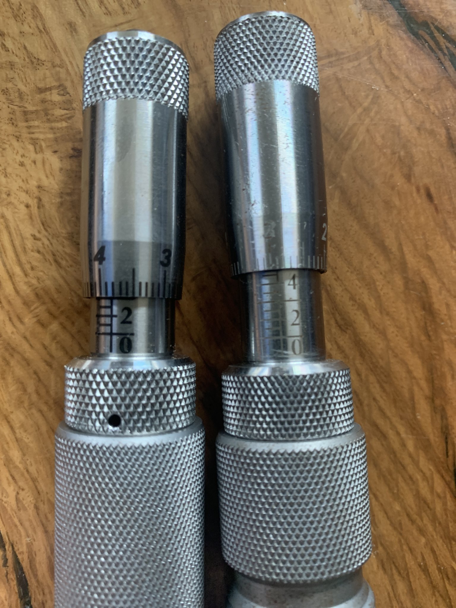

I’ll be damned. I guess I set my old ones and never looked at em again and forgot what they look like.
here is new vs old
here is new vs old
Thanks for the photo, others can see the difference from the old to the new. A big difference. I bought three of them (old style) at the time, thinking I needed one for each of my regular Hornady seating dies.
