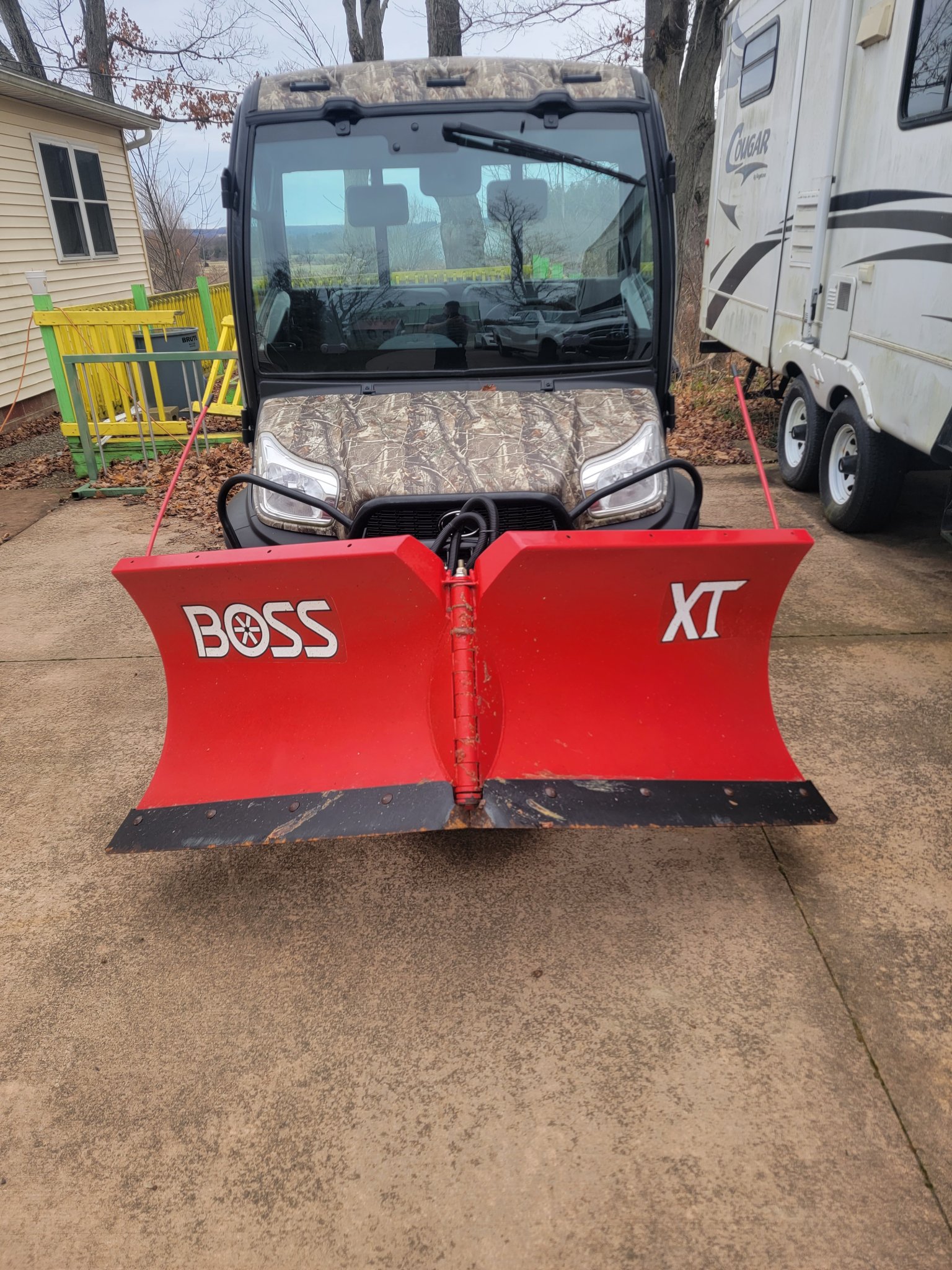

I have the Kubota with the Boss plow. I like it. It pushes more snow with less drama than I expected.
The down sides are that it shifts more like a Russian tractor than a Japanese tractor. When plowing there is a lot of back and forth and when I had a right shoulder injury it hurt to shift.
The starter bears special mention, as with this Kubota has caused me nearly endless aggravation. A year or two back I even had a thread here asking for ideas. As soon as out of warranty sometimes it would only click without turning over. It got so I had to click it hundreds of times before it would turn over. Eventually I replaced the starter and it worked great, I was proud of myself. After about six months the same thing started again. WTF! So omitting a lot of how much of a pita thus was, my brother looked at it for me and disassembled the starter. He found it extremely corroded in the solenoid actuation contacts. So he polished them. Now it workes great again. I still had the original starter. We took it apart and it had the same problem.
Over all Ide get the RTV1100 again. I also have an old gator. The gator is fast and fun, but the tyranny would never hold up to plowing.
The Boss plow goes on and off easily. Just know that when its off the mounting bracket costs you some ground clearance.
Get a quote to install the plow from your local Boss dealer before you talk to the Kubota dealer. Chances are the Kubota dealer just takes it to him for the install, and marks it up a couple hundred.

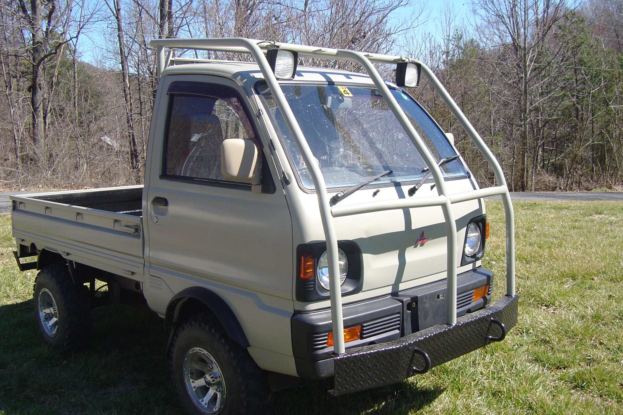

Have you thought about one of the mini trucks ?? Might want to look at them .. had an older Mitsubishi.. full cab, heat, a/c… some have dump beds .. an at the time was way cheaper… I lifted mine added bumpers, push bars, roll bar .. bigger tires an wheels ..

My local dealer only sells the Boss plows. Boss has there own warranty through their dealer. At least that was the case three years ago when I got mine.
