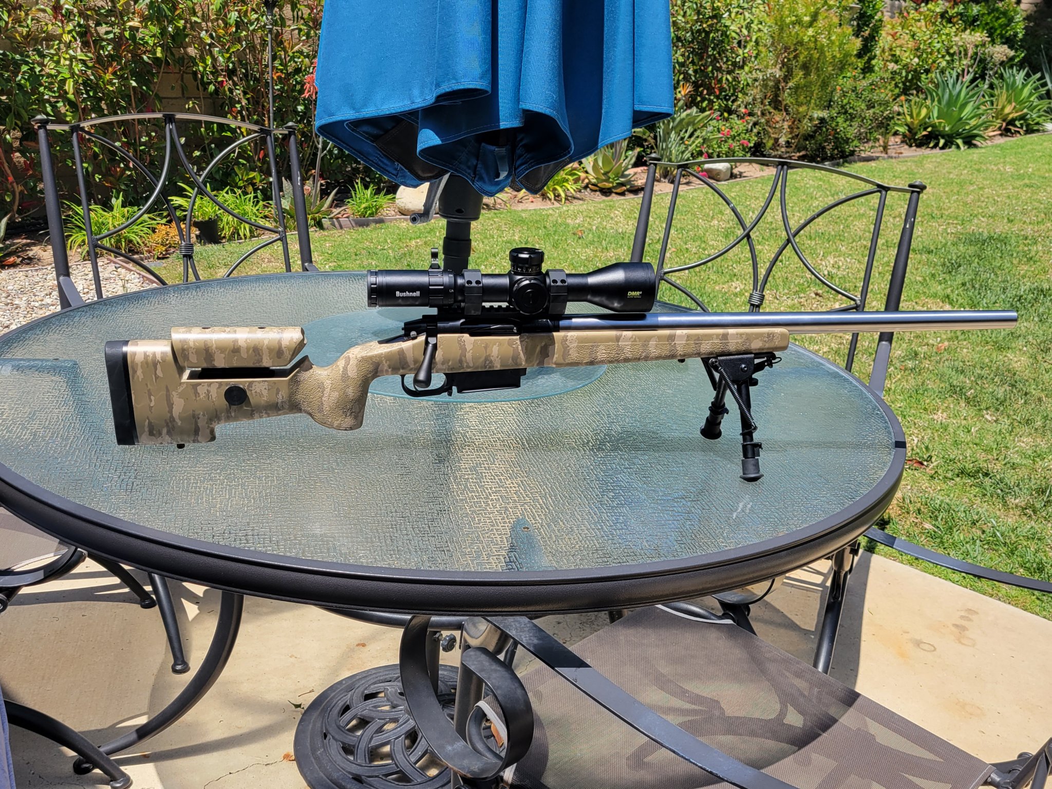

Origin build first shots
Mauser48
May 17, 2018
269
187

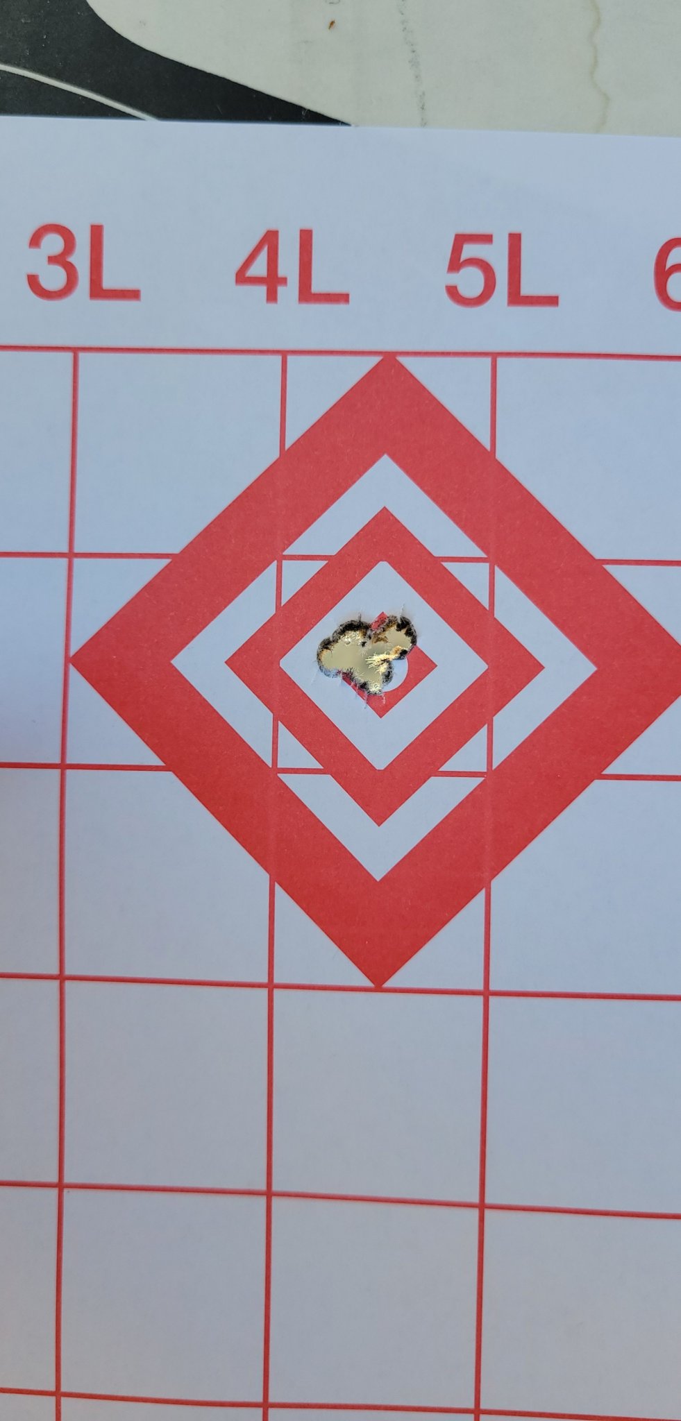

Finally got out to the range with my origin build. Completed it about a year ago but just got out to put s few rounds through it. It is a 223 wylde chamber, bighorn origin action, bartlein 1-7 twist m24 barrel by keystone accuracy, McMillan A3-5 stock, triggertech primary trigger, and bushnell dmr ii optic. Ammo was lake city brass, 23.2 gr of imr 8208, and a sierra 77 smk seated to 2.260 coal. Pretty well known load to shoot good in everything so I figured I'd start here to get some rounds through it and sight it in. I sighted it in with a few shots and then shot two 5 shot groups. Both groups I'm very happy with for no load development. Group is at 100 yards. I'll have to measure it again, I believe it was right around .250 inches. My magnetospeed didn't pick up the shots so I don't have a velocity unfortunately. I took it out of the box and quickly read the instructions, I'm sure it was an error on my part no doubt. I was in a bit of a rush so I didn't investigate it much. Show me your 223 origin builds and what bullets you have been shooting. I'd like to work up a load with a 75 or 80 eldm. I do have a box of the 80s laying around.

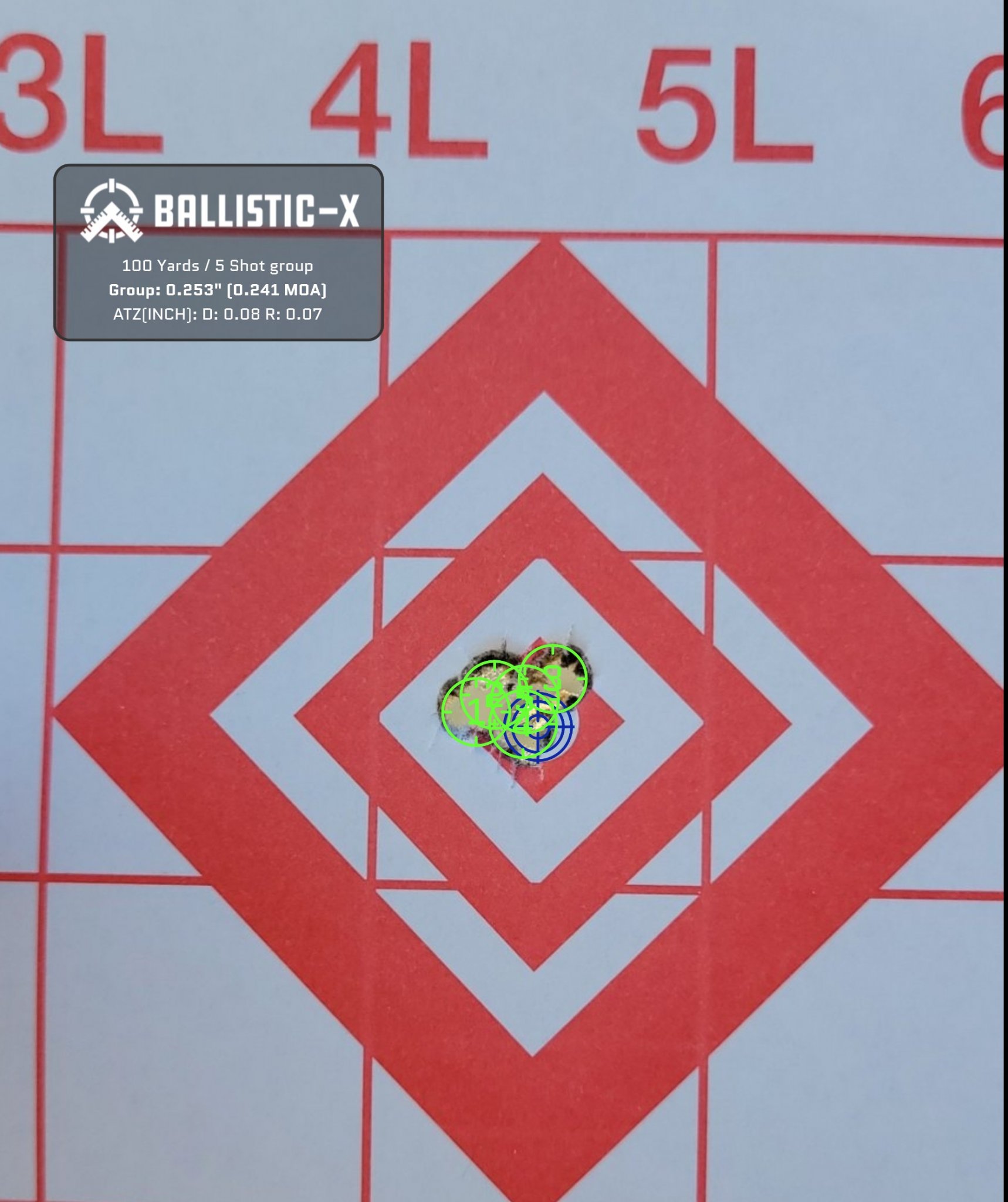

I put your grouping in Ballistic-X for you.
Not a bad start!
That looks awesome.
  • Ballistic-X-Export-2022-04-30 10:27:13.205261.jpg
Thanks that's a cool program! I picked up 1k of the sierra 77 smk about a year ago from powder valley on a good deal. Figured those always shoot well in everything. I just figured with a bolt gun like this I might as well take advantage of some bullets with a better bc like the hornady eldm series.
It's less than $10 on the android store.
I use it all of the time!
