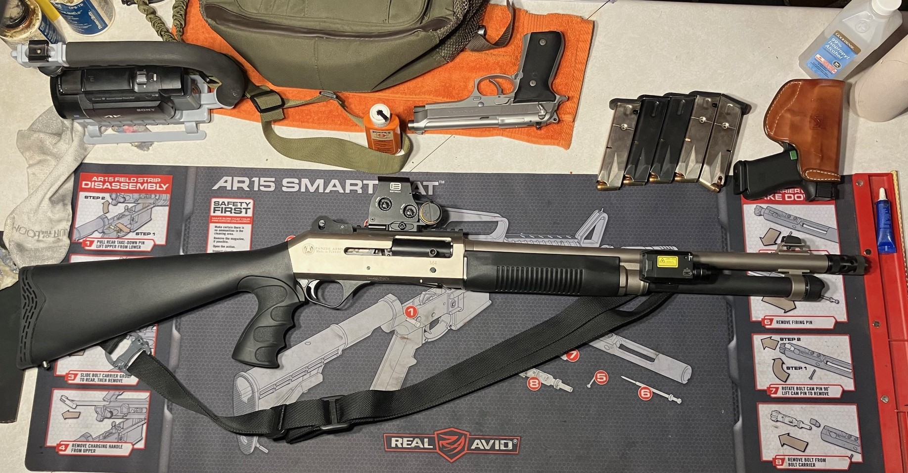

    I bought a Panzer version, marine finish (nickel coating) stopped at Brownells showroom and checked out the real Benelli M4 in the marine finish and was shocked... Finishing marks, casting flaws. I dont know how they can ask the price they do. That being seen I was super happy I grabbed the clone. I was expecting crude machining inside but I stripped it all down when i got it to get the oil out of the gas cylinders and inspect and its amazing nice. I've had it for over a year now and its been flawless with any ammo. I see now Panzer has a new version out with a metal handguard.
    Lots of people bash the clones but take them right out of the box and dont clean them. The Benelli manual states like a hundred times not to put any lubricant in the cylinders or on the pistons... The clones all come soaked in it for shipping and storage. I have not had a single problem, not a one, cheapest shells, slow, fast, tried a bunch.
    When I got mine i was watching tons of videos, lots having failures on weaker loads.... made sense to me if oil is in there the spent gas+oil = slower moving bolt. So I did my own video addressing it... Amatuer video.
    Heres mine... and the video below if anyone extremely bored.

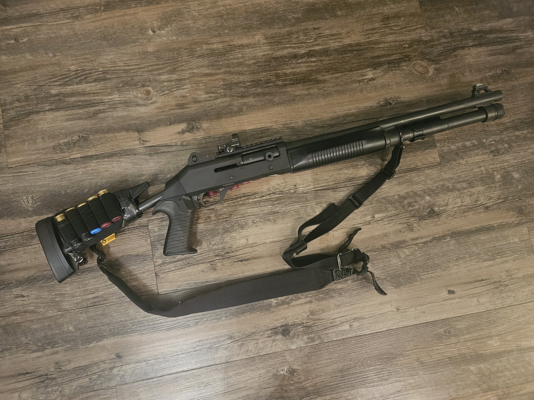

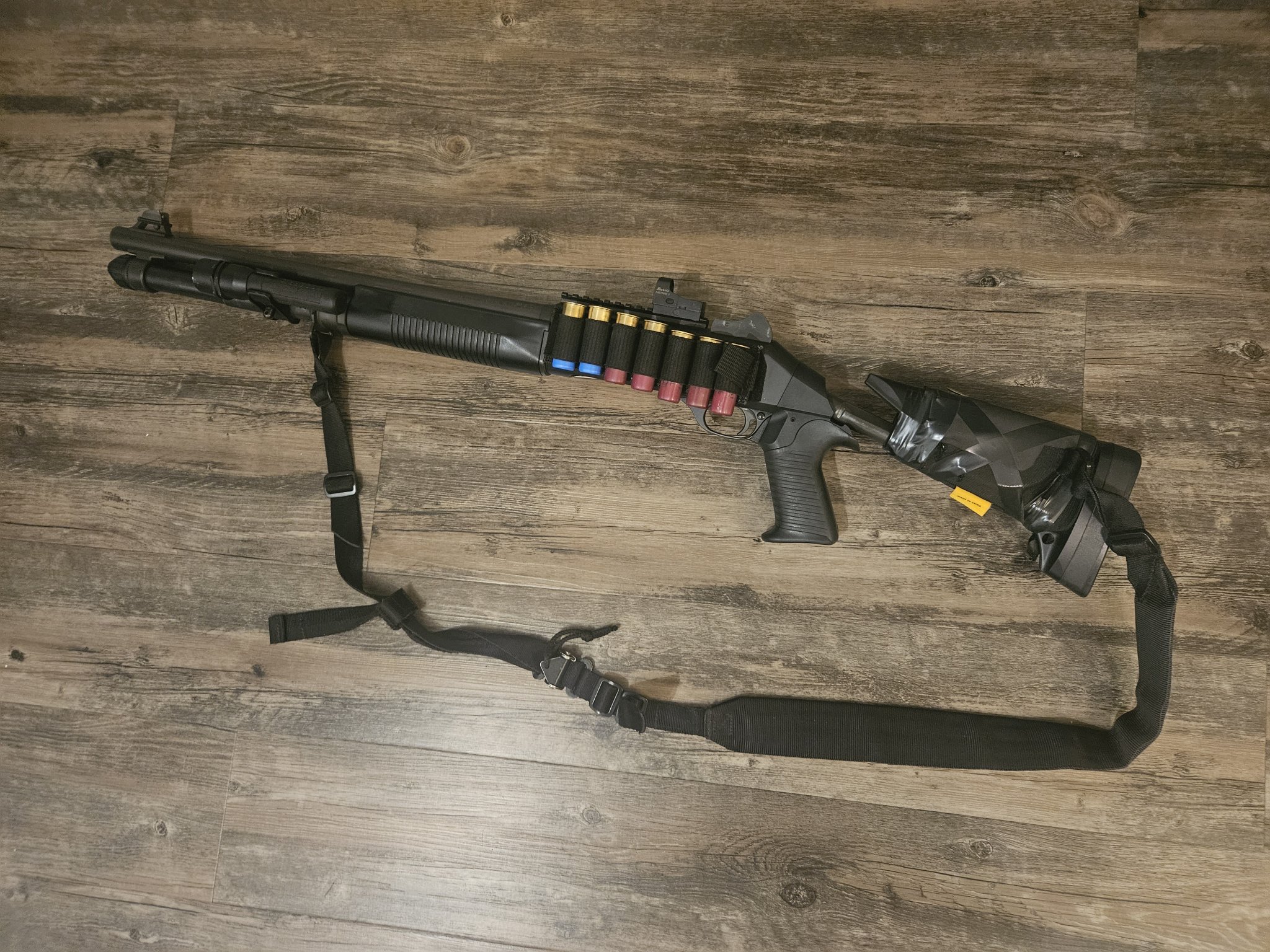

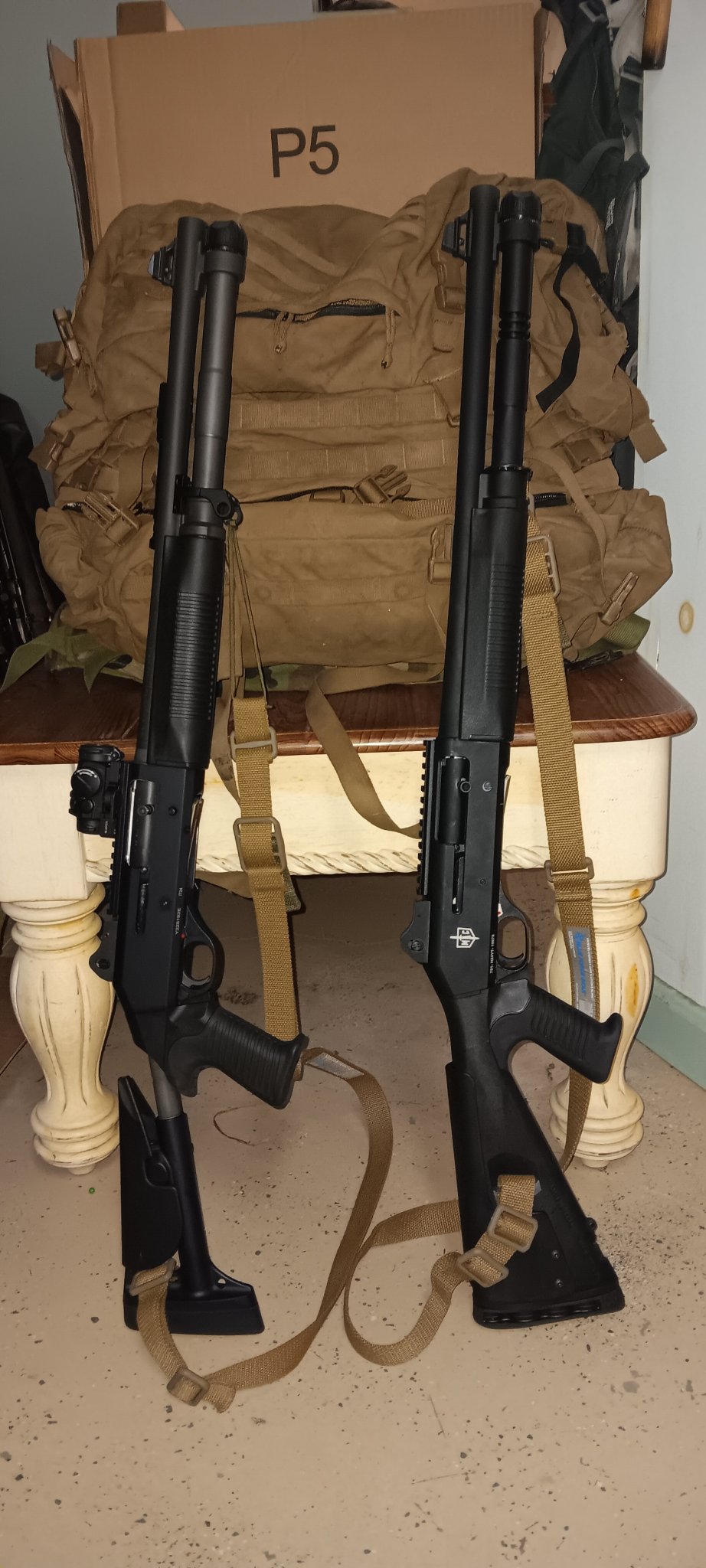

    Most of the factory parts I replaced on my M4 broke including a GG&G charging handle, S&J jumbo safety, and Mesa cheek riser for their Urbino stock.
    While I have an aftermarket charging handle on it now (forget which brand) but I have "downgraded" the other stuff back to stock factory. I think the Italians and the Marines know how to make a reliable shotgun, even if it has a few quirks.
    My other accessories include a velcro on side saddle, an el-cheapo butt stock shell carrier held on with electrical tape, and a $10 flashlight clamp that has lasted for thousands of rounds. Probably doesn't really count as a "build", just a shotgun with some stuff strapped/taped to it.

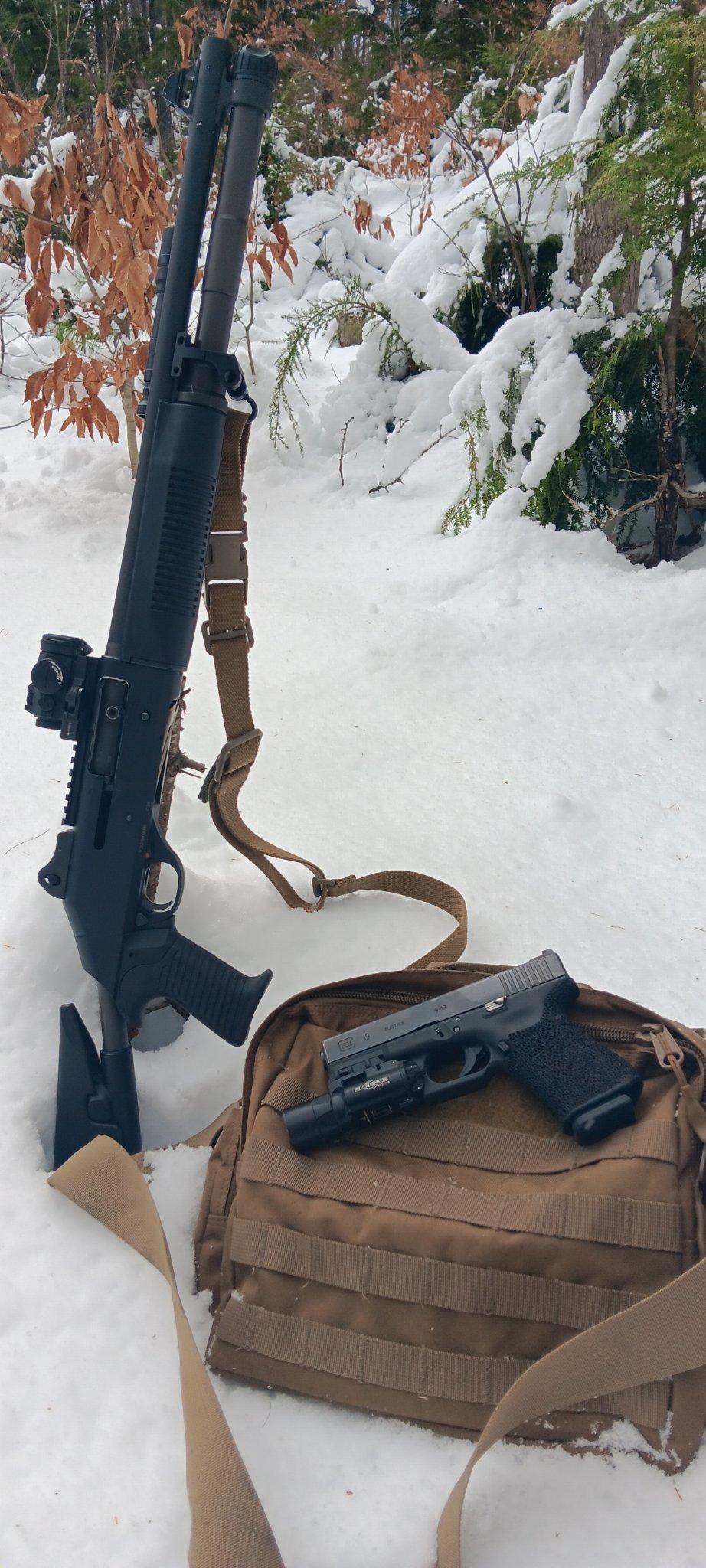

    Maybe it was the G96 lubricant I was using at the time but it didn't seem to quite have it's usual oompf at -33°F.
