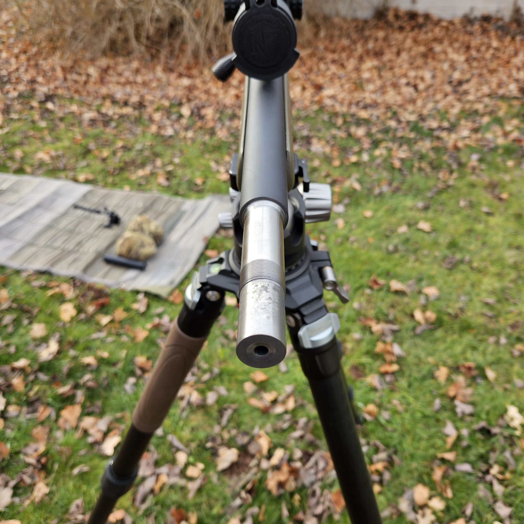

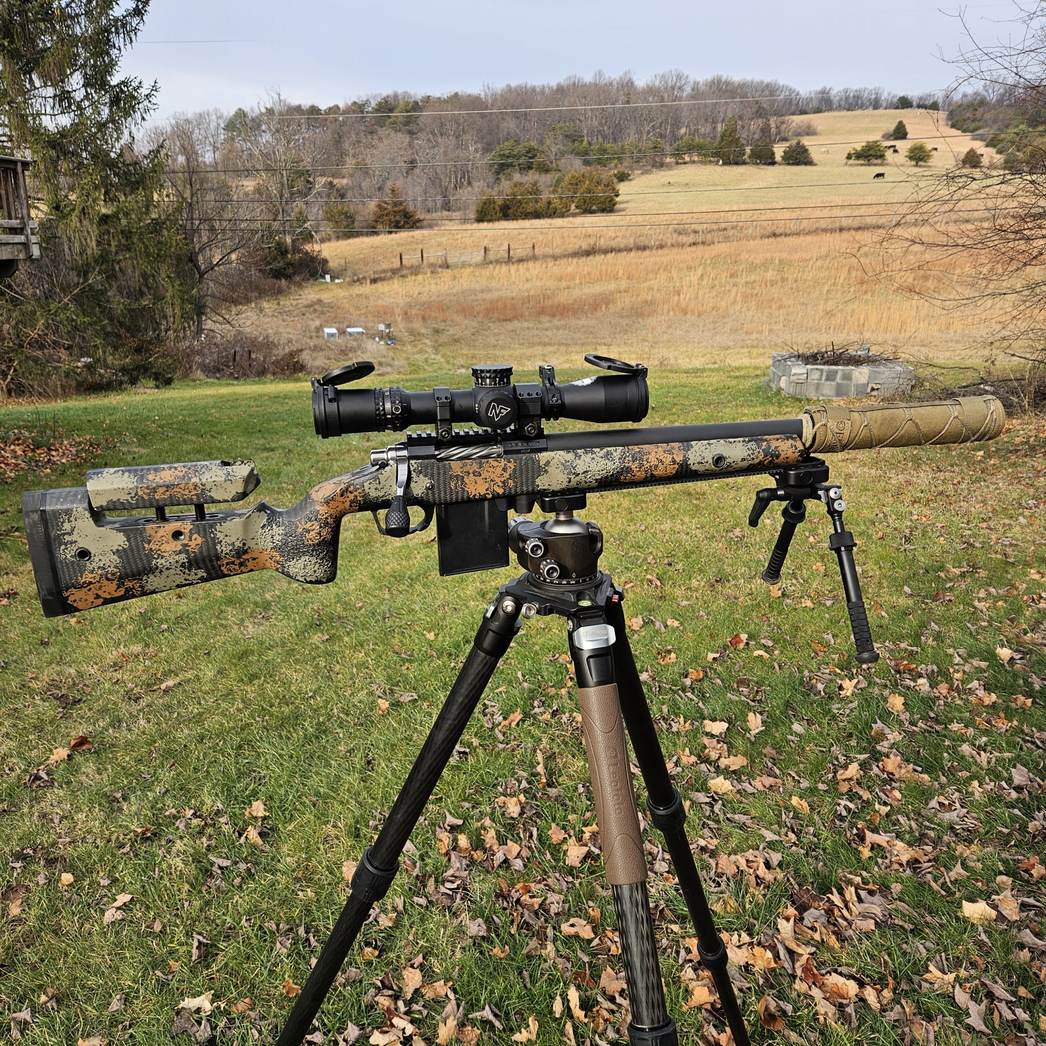

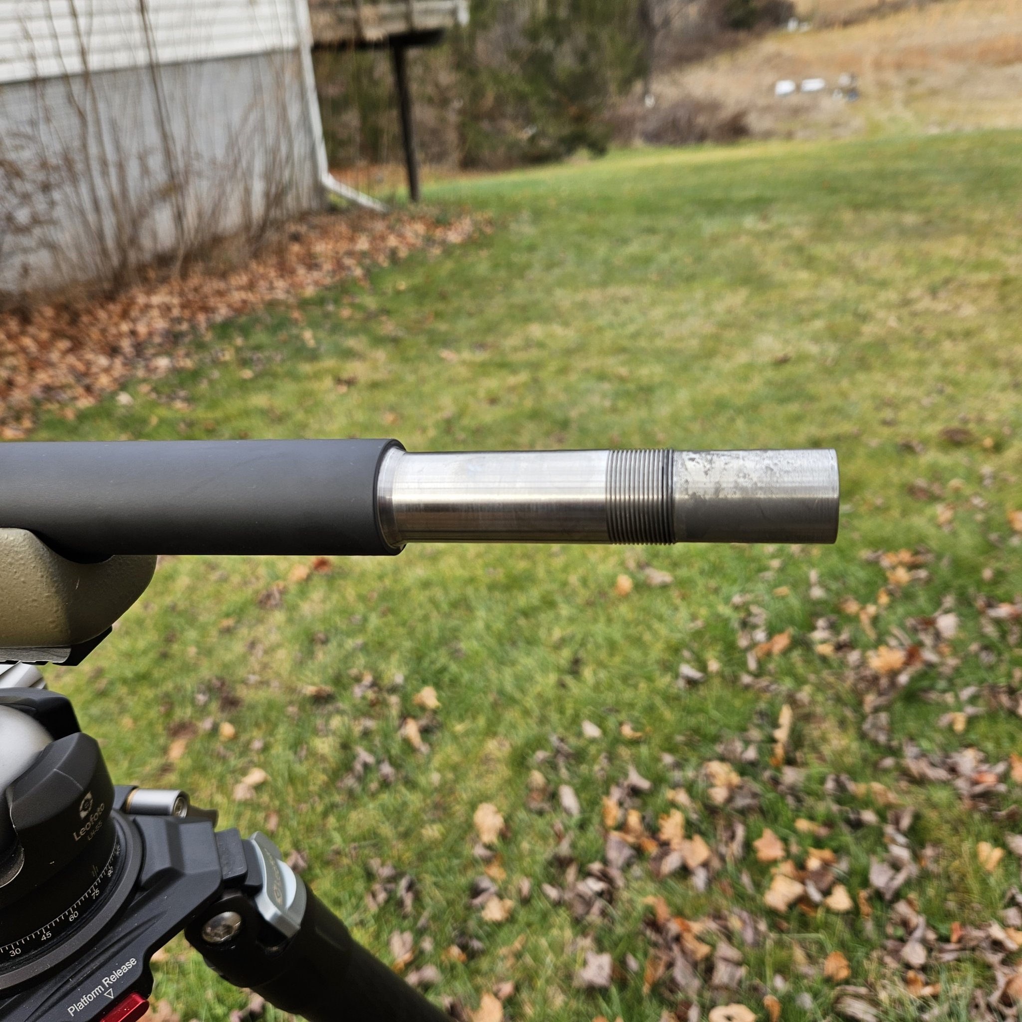

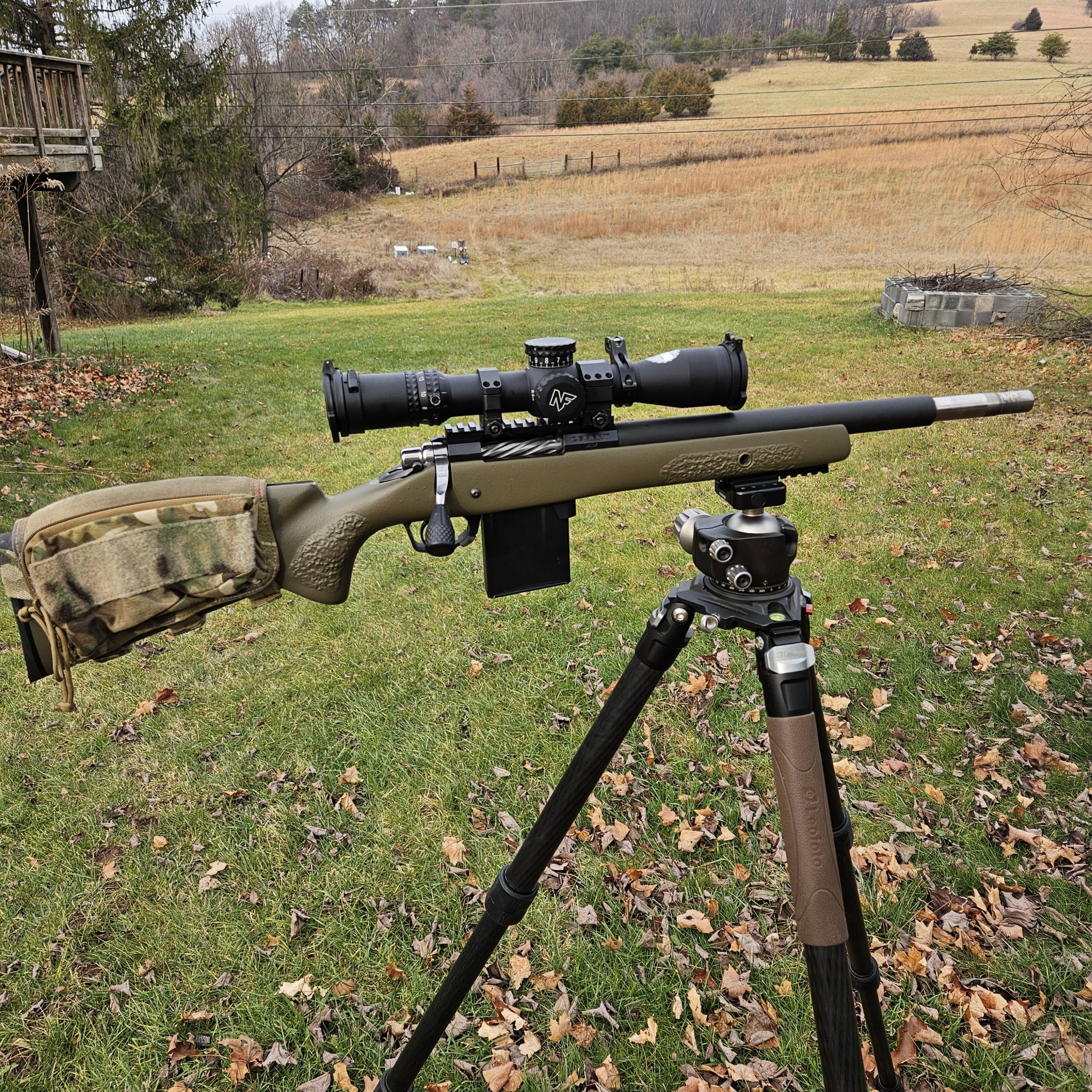

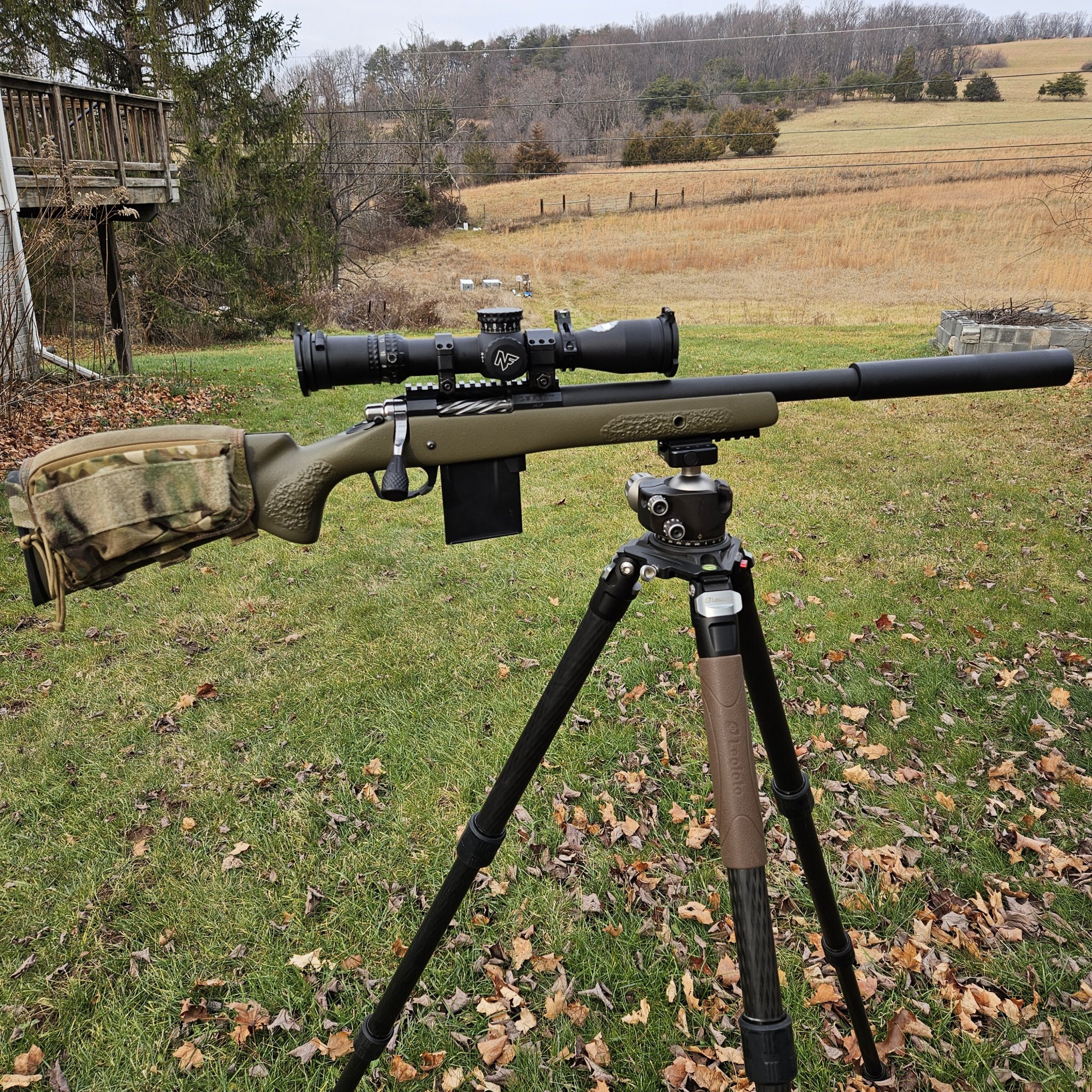

Finally got one of my 223 barrels cut for my Otter Creek Labs OCM5. I wanted to minimize the added OAL when the suppressor was added so I wanted more barrel past the threads where there would normally be a brake or flash hider. I brought the idea to Ryan Beck with Base Camp Guns in Martinsburg, PA and he created a program for his CNC. With the mount cut into the barrel the suppressor only adds 5" to the overall length. Ryan did an awesome job with the machining and their cerakoter Dave(I think is his name) did and awesome job too. I'm really happy with how it turned out. Almost looks like a 16.5" 223 version of the XM3.

So from bolt face to end of can is 21.5"?
What contour is the barrel? Also what is the rig total weight as you have it shown with can?

The OD green stock is a Manners EH-4 and the other is T2A
Defiance Deviant
16.5" Krieger HV 7.5 twist in 223 wylde
NF 4-16x42 with Mil-XT
Badger USMC 1" height 34mm Steel rings
Yeah, within a few tenths of an inch. Heavy Varmint contour but I think I'll go with M24 with the next one. I'm not sure on the weight and I'm not home ATM.

Would appreciate a weight if you had one but no hurry. And yes, looking at dims, I would go M24 also. Been doing some calcs, M24 gets close to the weight of a proof carbon sendero 18" . A little flutting and it may get below it.

With the T2A it's 14lbs 4oz. I believe the EH4 is a little over a pound lighter. With a M24 contour, lighter rings, and lighter action you could probably cut another pound or 2.
i appreciate the info. im trying to get under 10 lbs, which i think i can do with my plan of attack. action, stock, barrel contour, can and scope.

I've got to shoot it more recently. I love this thing. I don't think the extra barrel taking up room in the expansion chamber is hurting performance much or at all. Sounds excellent.
I don't see how the "extra barrel" is directing gas to the side and away from the blast baffle
If the brake is firmly inserted into the blast baffle, then the barrel in this scenario then blocks the blast baffle from getting direct gasses. And the bullet enters the can effectively after the blast baffle ends.
But with this being a reflex can, gas still fills back to the rear.
This could maybe put more direct force on another baffle but I'm not worried about it at all. Ops inc cans are way over built and have been for decades.
Maybe the ocm is also but it's different materials to cut down on weight, so ymmv
