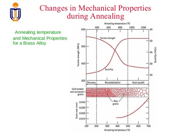

Yup, the amount or type of color change has nothing to what's actually going on with the metal's structure. And things like the flame color change having to do with the zinc being burned out of the brass is also false as that doesn't start happening until the brass is in a liquid state (~1700°F). What we see as color changes is due to the burning of the residue on the surface of the brass, like left over lube, cleaning solutions, gun powder residue, or oils from your hands, etc.
