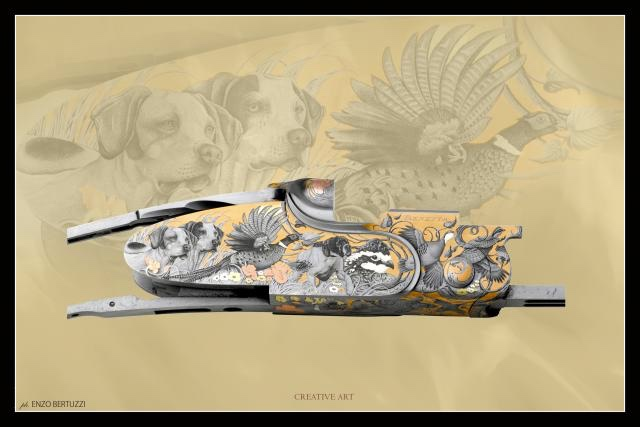

If we eliminate engraving and other embellishments (which are nice, don’t get me wrong here), why do shotguns have a different price structure than rifles, exactly? They “seem” like simpler devices than rifles, but I suppose looks can be deceiving.

I think the astronomical price has to do with the tedious work of hand fitting the wood to the metal, as well as the master engravers doing art work. I do believe they are all hand built as far as wood in regards to shaping and forming, along with the high grade/quality of wood. They are works of art for sure, but not in my interest for that kind of cash for sure

Engraving is not what drives the cost of quality guns. How many times does that need to be said?

Again, you can drive the price of a $12k OU into the stratosphere w wood and engraving but it’s still a $12k shotgun from the get go.
Not sure what shallow engraving you are speaking of, but chances are it not hand engraved at all. Laser engraving on production guns is common these days.
