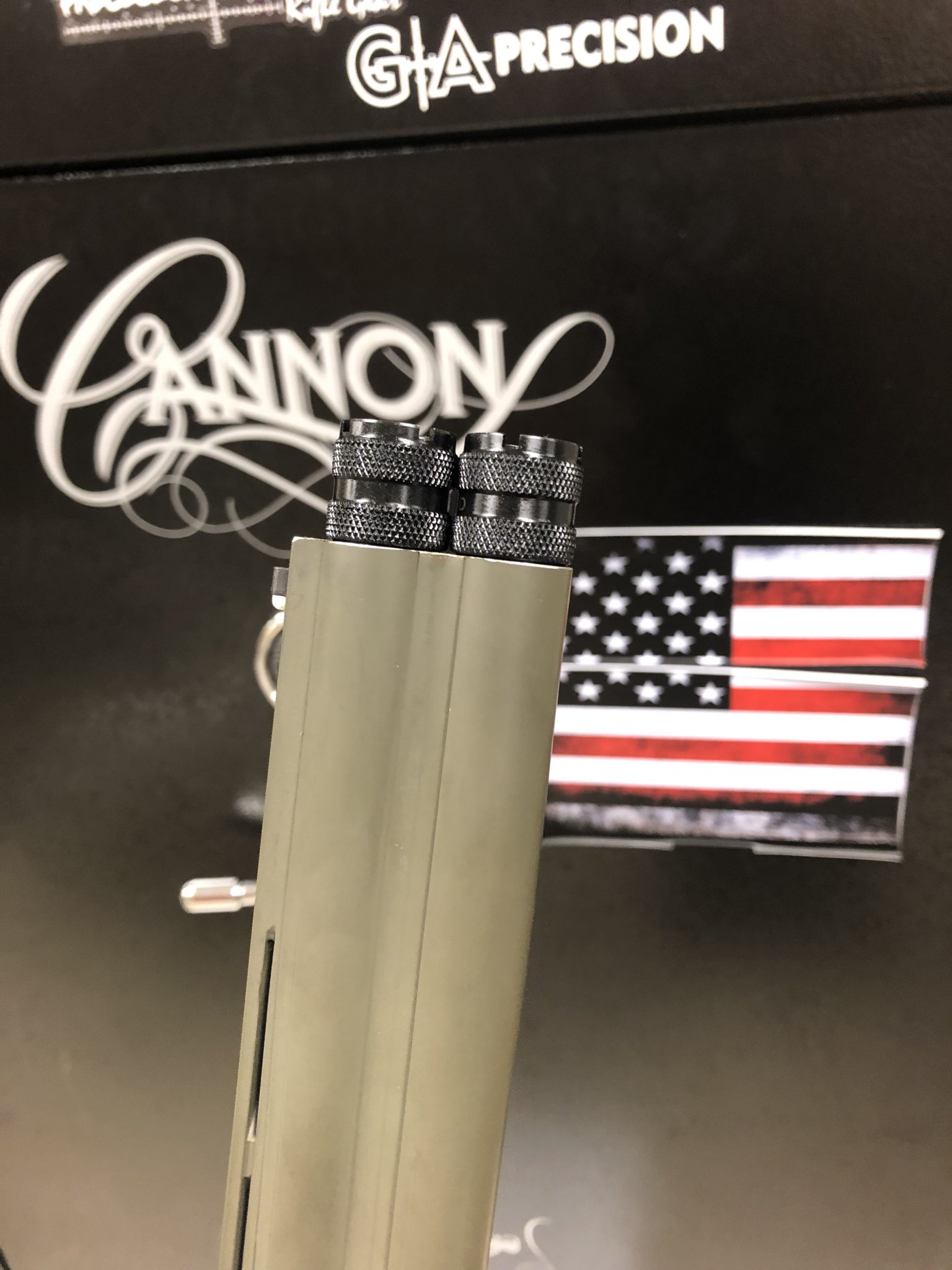

Update on choke tube issue. CZ wants to start with the easy route and I can’t say I blame them. They are sending me a new set of chokes to see if that might be the issue. If not, then it will be returned to them for a looksy.

CZ wasn’t messing around, new chokes showed up today. Perfect fit on both barrels and all 5 chokes. Guess time will tell on the rest of the gun. Will start putting rounds through it.

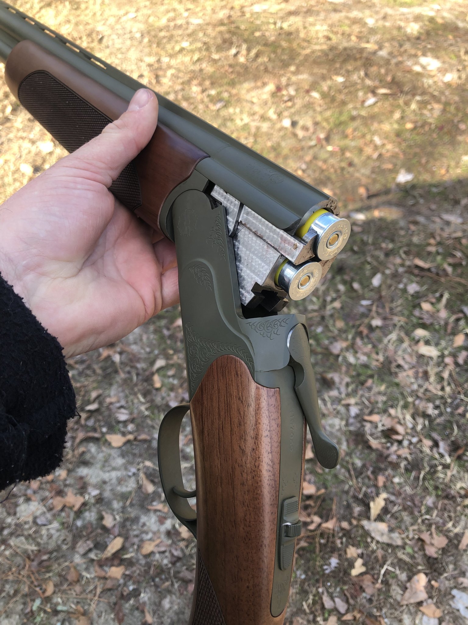

Small update. Took the CZ out yesterday and shot 2-1/2 boxes of shells through it. I like the way it shoots, and it functions pretty smooth. I like some functions of the shotgun.
The magnetic chambers are neat, can hold in any direction with breach open and shells don’t fall out. Independent ejectors are nice as well. Makes reloading singles nice and smooth.
The fact it doesn’t automatically go to safe when the breach is opened is nice. My other O/U goes to safe so can get caught offhand in the dove field.
More updates as it continues to get use. Maybe take it to the squirrel woods soon and get some meat with it.
