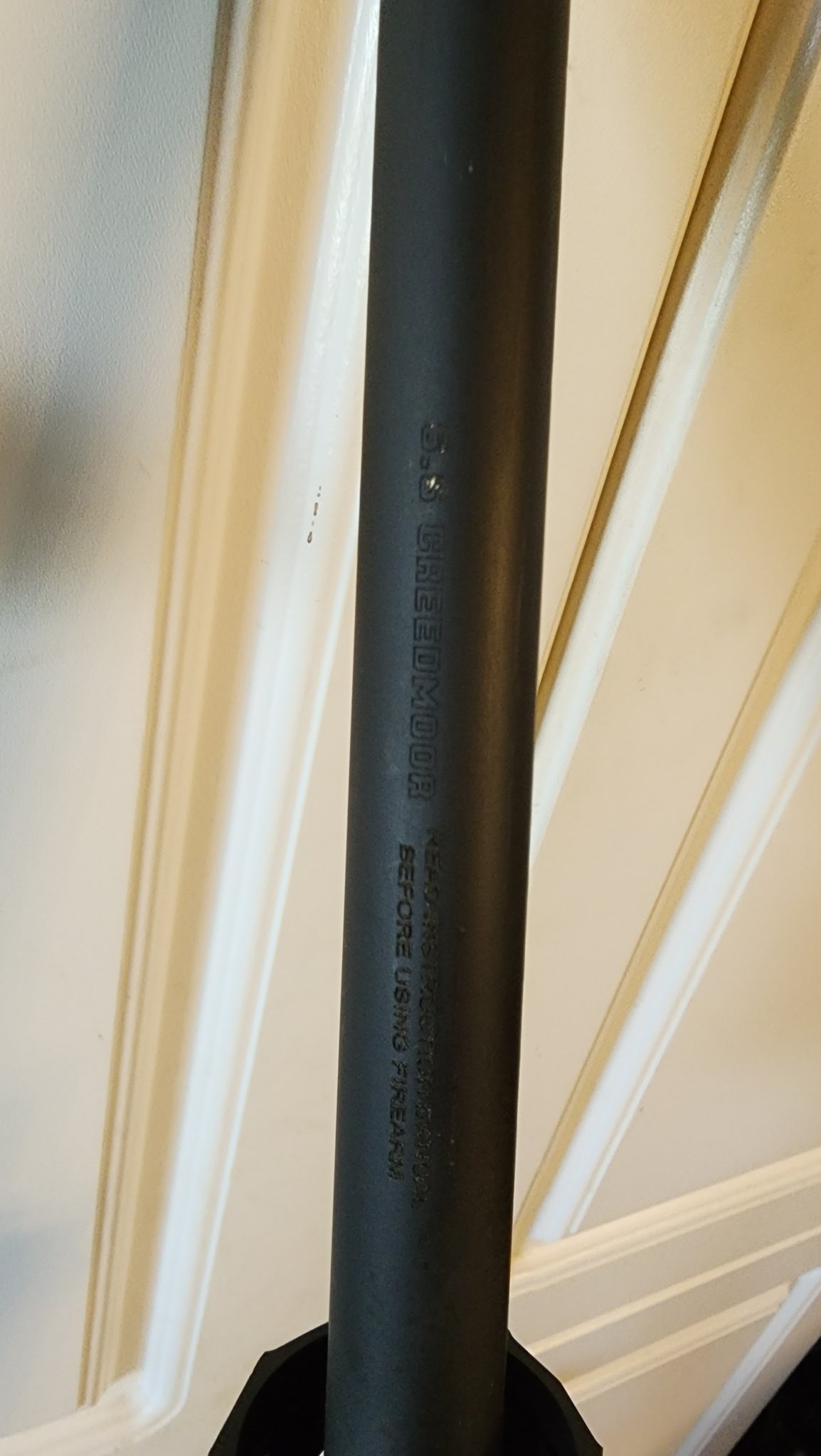

Post a couple of pictures of the barrel clambering stamp, brass in question and caliper measurement on brass above the case head.

Checked the barrel. Yall got me really paranoid there for a bit. Its a 6.5 CM
Reactions: XLR308

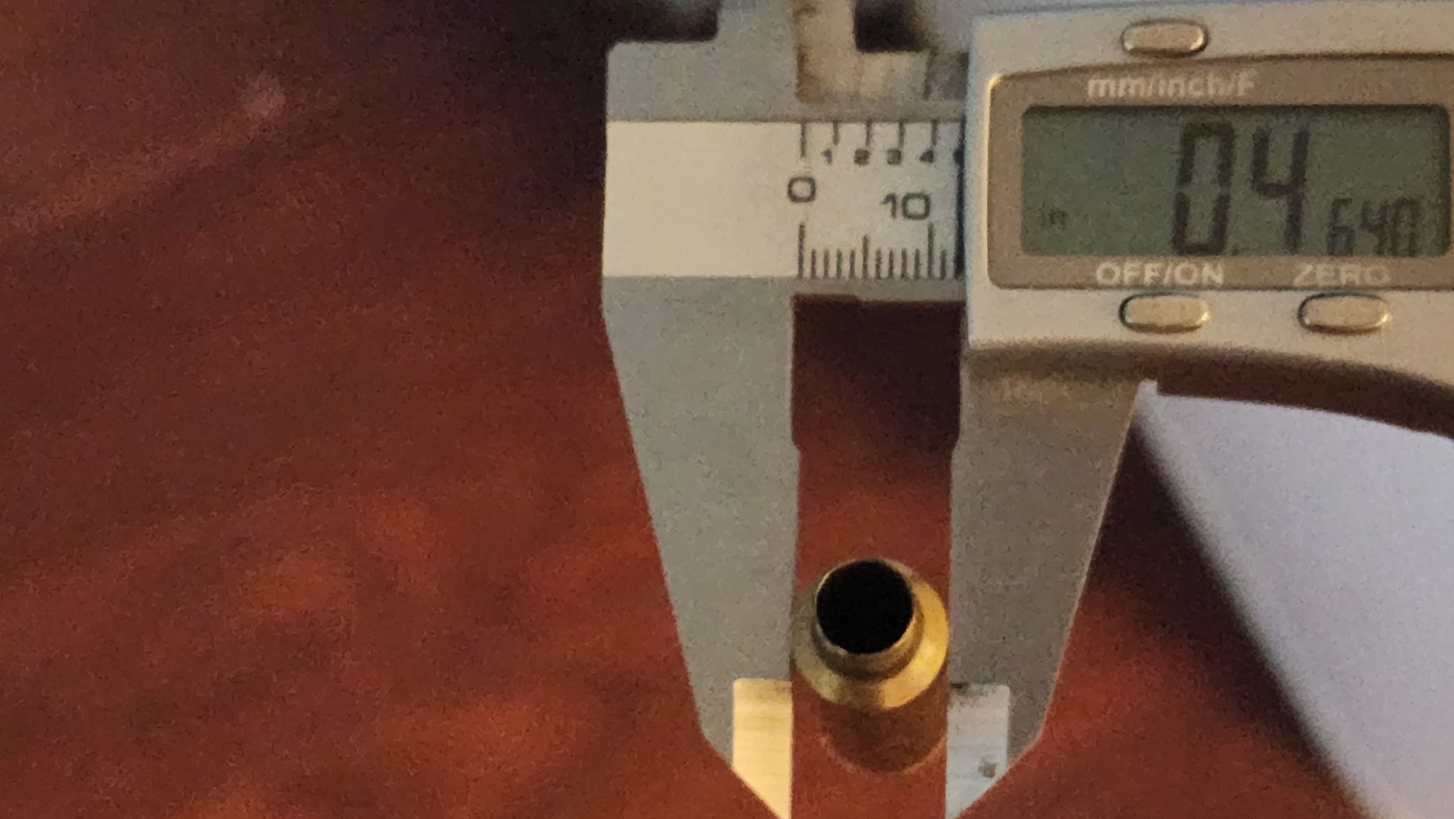

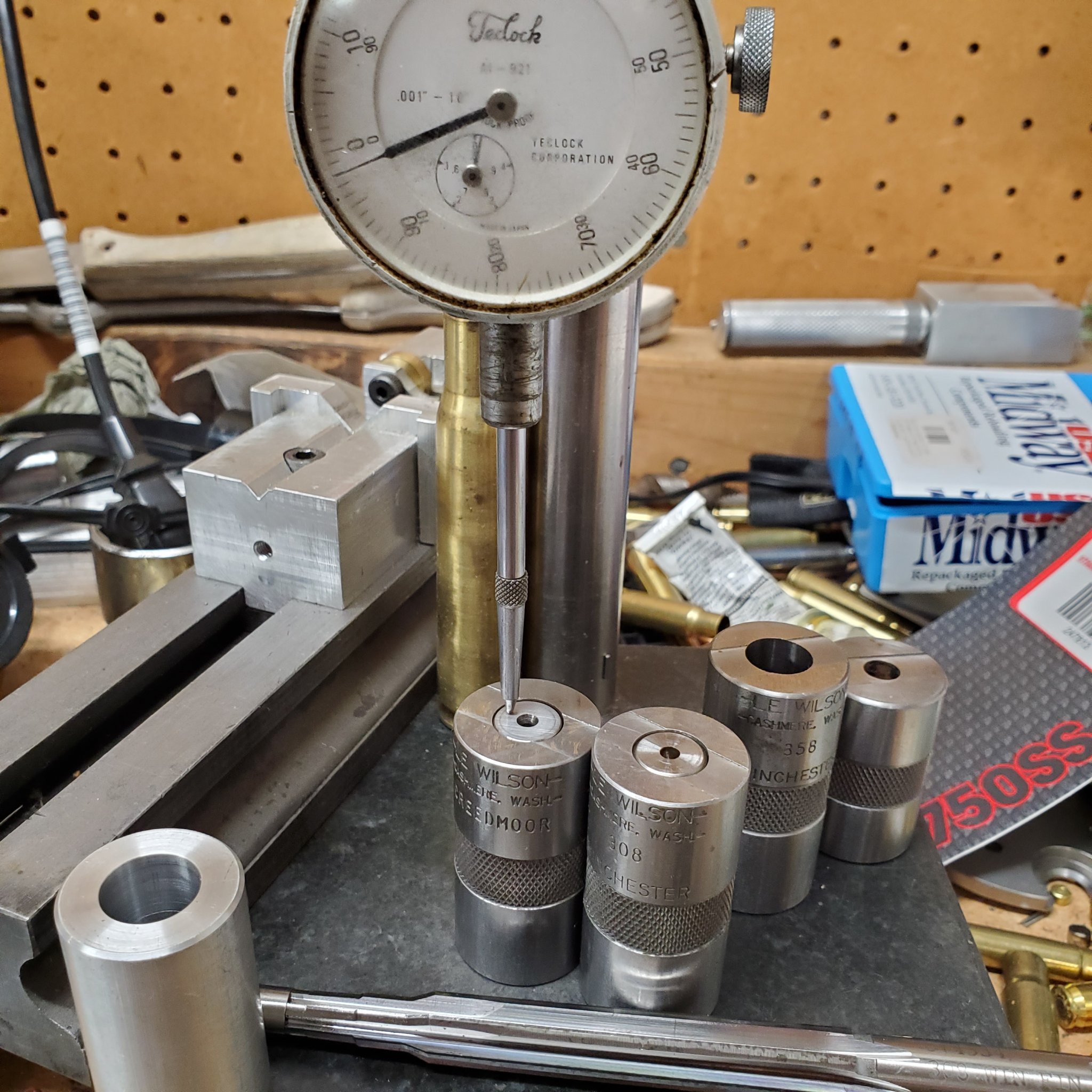

I had already resized the brass when I first posted so I'm not able to take a photo of it. I trimmed all the cases down to 1.9 and that seems to have reduced the expansion on this last reload. I'm ordering some go/no go gauges as well. Reloaded them again tonight and the ammount of force needed to fully resize them has gone down drastically. So keeping the case short seems to be helping. I also did the threadlocker method for getting the measurement to the lands. It came out at 2.772.
OK, so initially, you simply misstated 60 thousandths for 60 ten thousandths.
I'd say something is very wrong with a chamber that's producing an expansion of .0055 - .006 on that part of the case. I've not seen that from my RPR factory barrels or the replacement barrels I've put on. You should REALLY call Ruger and explain your issue to them and get them to replace the barrel.
Your brass isn't going to last very long with that kind of movement. Or, you could get a custom die that doesn't size it down by .001 or so. :( But I don't really think that's a good solution.
They'll want you to send your whole gun to them in a box they provide that they can directly inspect the barrel themselves. I had an issue with one of my new RPR's throat and had to do that. They sent me a whole new gun rather than just replacing the barrel.

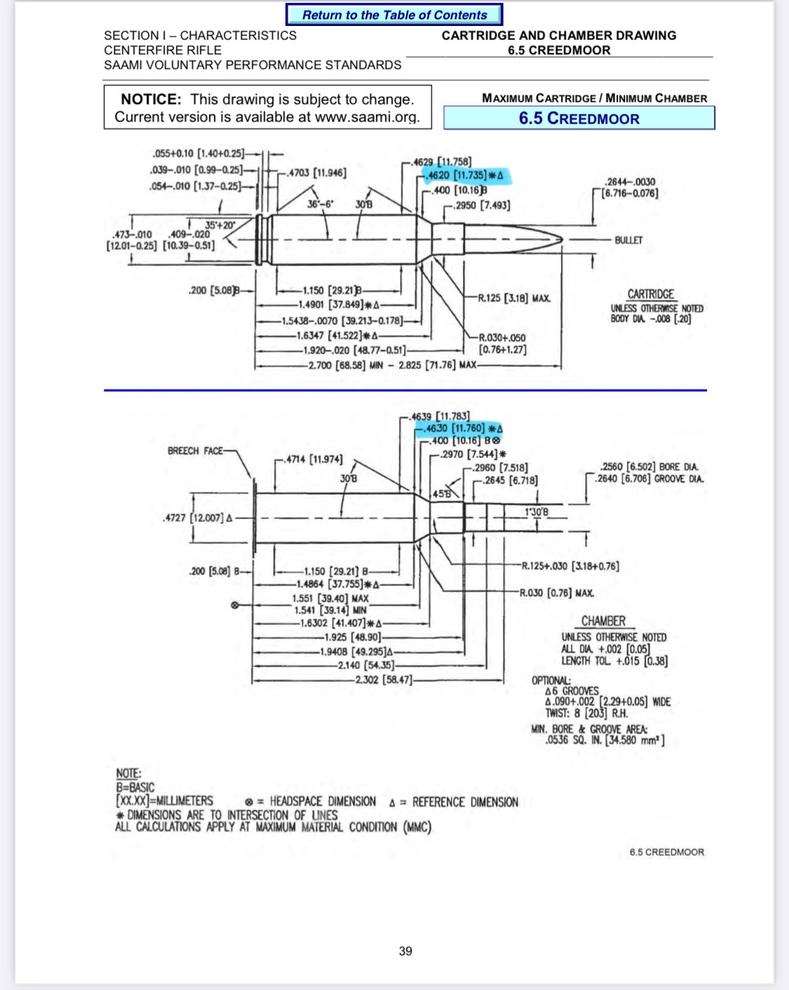

How much of an expansion should I be seeing?
I’d slow down a bit.
That measurement from SAAMI max cartridge is supposed to be .462, and minimum chamber is .463. Your fired brass isn’t that far off. That measurement should also be taken with a micrometer (vice calipers) if we want to start rejecting parts.
WRT sizing feel, that could be anything from your press, to your lube, to how far you’re pushing the shoulder back (what’s your comparator measurement from fired to resized?)
As another esteemed poster here would say, we really need to see all of your fired and resized case dimensions.
With my 6.5 Creed I get .4625 diameter at the top of the shoulder with fired brass, and sized brass measures .4605 using a Whidden die.
My guess is that you're dealing with stacked tolerances here... your chamber is on the large end of the spectrum and your Hornady sizing die is on the small end of the spectrum. Might look into a different sizing die to get the dimensions closer to each other.

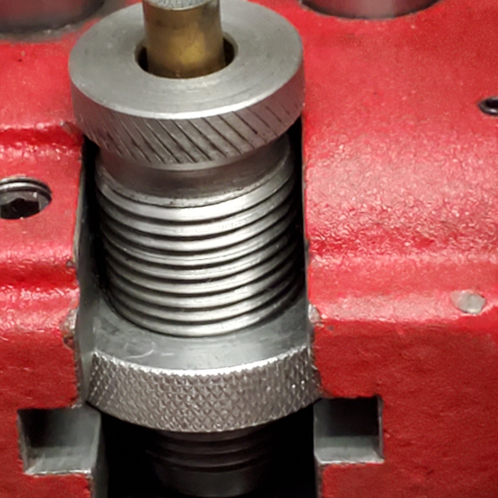

Try different FL dies they are not all the same. Get a cheap Lee FL die and polish it out, accurately.
But you don't have a lathe...
I have a Hornady die in 308 that is difficult to size brass...it's not the only Hornady die, that's that way.
I like their seater dies but not their FL dies, some work okay others do not.
Here's what will work, for the average shooter.
If it's a bolt gun use a neck die and every third firing use a Redding 308 body die, to bump the shoulder back .002"
If an auto or bolt, one can use the Redding body die first then your FL sizing die every firing.
I had an oversized Rem factory chamber the "No-go" gauge would go, but it was very accurate for a factory rifle. I used the Redding body die to move the shoulder back and a neck bushing die to size the neck. Got up to 40 firings on the Lapua LR brass and 48 gr of Varget with 155s, in this oversized 308 chamber.
Use the white Lee Resizing Lube on tough sizing, better than the others ...I use it on oversized 50BMG brass fired in Machineguns, to fit my bolt gun.

I have many 308 dies, 3 Lee, 2 Wilson, 2 Redding, RCBS, Hornady, and a Redding body die I just got done using.
Lee dies are cheap, I buy many of their dies and modify them with carbide cutting tools or polishing.
You have a lathe...great...most do not.
You can make your own dies our of steel, no need to harden them, they will last a long time.
Or buy the Lee FL die, try it out ...if it oversizes your "oversized" fired brass polish it out in your lathe a little at a time ...polish and check, do not polish the 20° 308 shoulder. Easy to do.
You just have a slightly custom chamber, make the brass fit, by slightly altering the FL die.
Example home built die in action to convert 308 Win brass to 8.6 Blackout brass, in one pass no dented shoulders.
Making 510 whisper brass, out of 338 Lapua. There are no cartridge gauges so ya make your own, with your finish chamber reamer, and use that to chamber your barrel. The Aluminum gauge is .338 RCM AR 10 build with reamer next to it... the Wilson cartridge gauges are off a bit as shown by the go gauge inserted in them, used to chamber the barrel.
You have a lathe use it,...not everything is readily available to the shooter.
