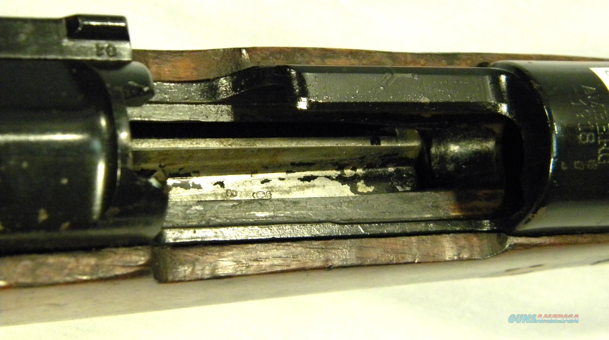

That's what I figured, especially with the stock so poorly buggered. Here's a pic of the receiver inside. Think it might be worth trying to save?
Some were blued during the Weimar era... never painted. Looks like it was converted to a 98M with a tangent sight.
If the stock has the original butt plate, check for a number in the middle of the plate...that is the mark of the WW1 era rebuild facility. Weimar proofs will be on the receiver and stock.
There could be some extra bubba work under the paint. Patched holes etc. Or it could be the special SS painted super duper G33/40 silenced model. :)
Paint don't mean shit if it's on there or not. You can strip that crap off. What you need to look for are pits that the paint covered. The stupid thing is paint will help prevent corrosion in the place of regularly oiling and wiping a firearm. So, if it's online ask for some more pics. Especially of those under the woodline. A lot of Mausers have been saved under the woodline due to saturation of the stock. But, have pits right at the woodline as they were stored out in humid environments.
Depending on the money, I'd go for it if you don't see damage AT THE WOODLINE. That's almost always the telltale. Corrosive crap gathers there and that is where you usually see the worst pits.
Added: Wear your damn chemical gloves when you take the paint off this thing....WE WANT PICS!
Amberg only produced 300,000 Mauser Gewehr 98 and Karabiner 98az firearms, the fewest of the Imperial Arsenals.
I personally would only purchase it with the paint removed. That thick paint can hide a load of flaws that would increase your total project cost to remedy. As I stated in a DM to you, I would use a commercial large ring like the Husqvarna 640 and build on that. It is your project and you can do what you want...if you are not doing the work yourself you wind up spending thousands on a rifle worth hundreds of dollars.
