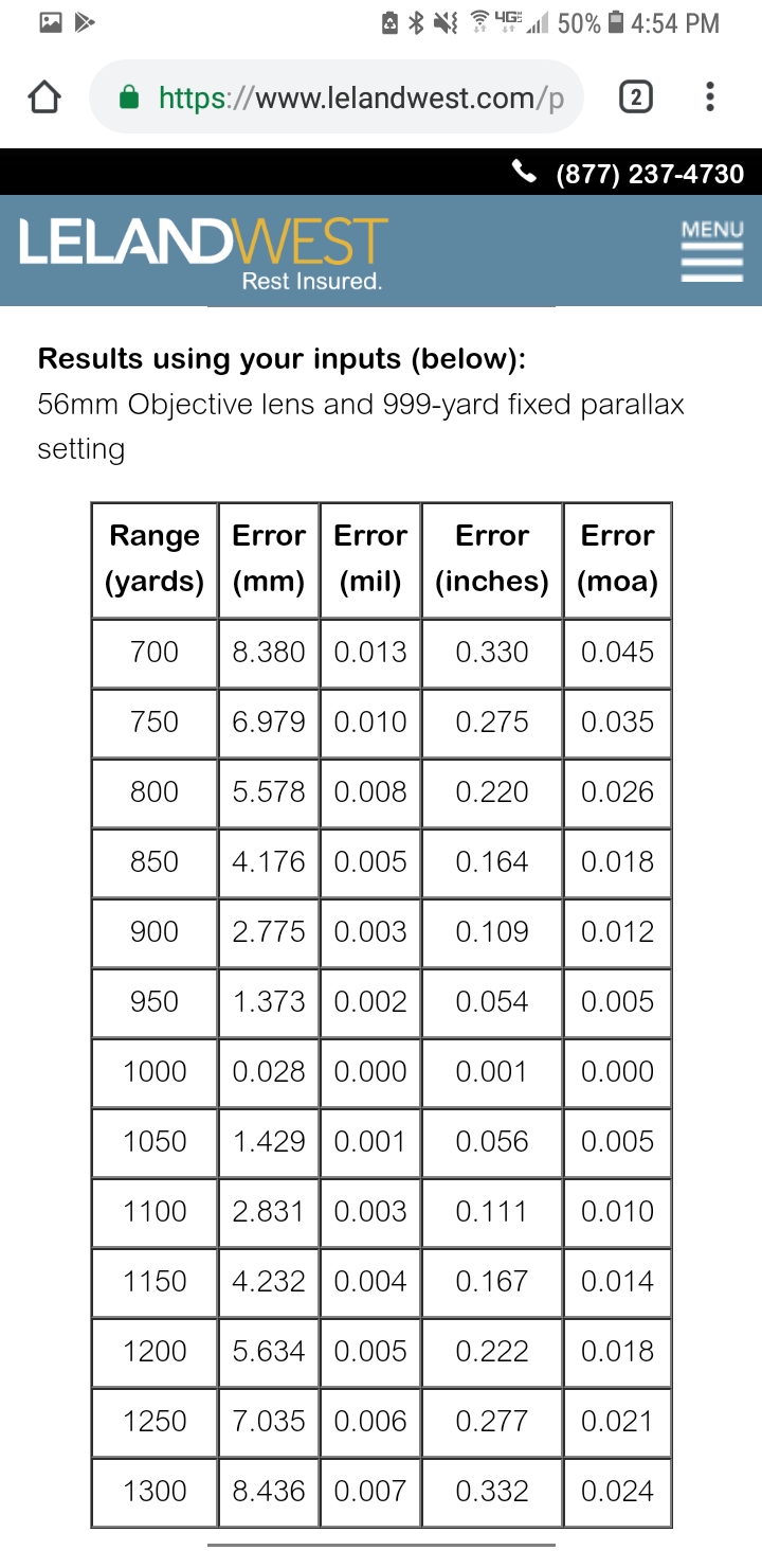

    So long as the scope has ability to dial out parallax, I don't care if dial says 900 or 700 for an 800yd target. I just need a clear image with minimal parallax shift.
    But parallax at long range is pretty damn small to begin with (read: meaningless) when dialing even remotely close to the correct range. See chart below.
    If you set parallax adjustment to 9991-1000 yds, the error if shooting to other ranges is listed on far right. At +-300 from dialed distance, .02-.04 MOA ; less than half of a tenth of a minute even when 300yards off dialed parallax.
