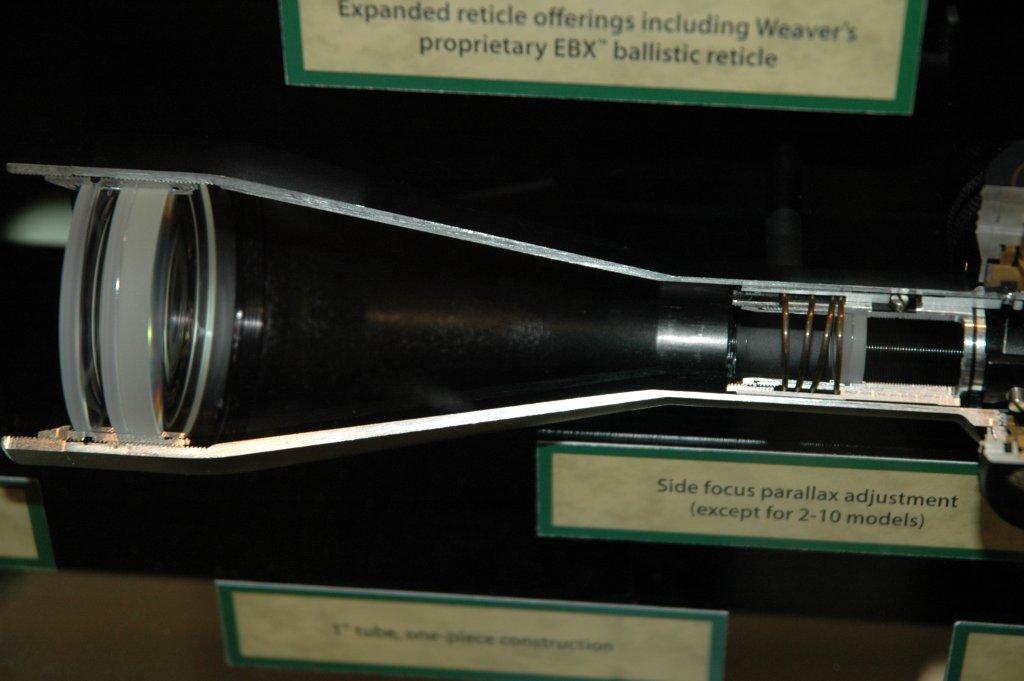

Hi guys. I have a Vortex Viper PST gen2 5-25x50. I was wondering how the parallax setting mechanical works inside the scope. I am interested if its possible to "wear" any parts in the scope when dialing on the parallax setting? Is there any parts inside that is prone to wear if the parallax is dialed ALOT back and forth?
Peter
it does have a separate lense and can be out of tune, but wearing is a bit extreme, though not impossible. Also if your front rings are tight or out of spec they can bind that lens causing issues.
There is a cheater lens in front of the erector that is moved to bring the target image into focus and helps with parallax.
Some times they are out of spec and will not work correctly. if you have a screw on the parallax knob like your elevation or windage you can maybe try to adjust it, but I don't know with that model scope if you can move it or if it's locked in place?
Also if your diopter is not properly focused that can throw the image out of whack too, you have to set up the scope with the diopter first then the parallax focus should be better throughout the adjustment range.
Lens in front of the turret, the tiny one inside
Thanks alot guys! But how does the lens inside the scope moves? I figure there must be some threads, small gears or something like that?
When i first got the scope, it felt like the parallax was a little inconsistent in the resistance it took to turn it, so i thourgt it might be grease that needed to be spread out internally. Therefore i worked that parallax back and forth alot, and it worked. However, it did take a long time with a lot of dialing the parallax turret back and forth, and i cant help but wonder if i have introduced wear on the internal mechanics.
The last lens in the objective lens group moves front to back a little. Like with anything mechanical, it can be worn out to a certain degree, but that will take a LOT of work.

Usually if the parallax mechanics are damaged it is instantly noticeable and most often a catastrophic failure.
I think wear is not really an issue in this area since the mechanism is basically two gliding, well fitted "pipes". I would not expect it to be a problem in a userlife if it is well made.
It varies based on how the internal mechanics are designed in a scope, but usually the amount of moving parts in a parallax adjustment is less than the amount of parts moving when you adjust magnification.
The most common failure in a side parallax adjustment I have seen, which is a very uncommon failure point, has nothing to do with over use or design, its people who mount rings wrong and pinch the tube. If the portion of the tube that the lens controlling parallax moves in is pinched or crushed, it wont be able to adjust correctly or at all.

ILya described an adjustable objective (AO) where you focus the scope by twisting the objective lens and lowlight described a side focus (SF) which uses an extra lens in the scope just as he described. These are two different methods of doing the same thing.
There are many scopes that experience some amount of backlash with the side focus knob and to counteract that, it's a good idea to go back to infinity and then focus on the distance you need, rather that change directly from one distance to the next. This is especially so in lesser scopes than the very top tiers.
Also, the progression is logarithmic, which is why close distances have more focus travel whereas longer distances have very minimal travel. The movement of that extra lens inside the scope is very short, in the order of millimeters.

Everything wears down eventually, but for perspective I've tested scopes that are 30 years old and still adjust and hold zero just fine. In general, how you treat a scope is going to have far more of an impact on its longevity than its design.
Great to know :) Would you say, that with the moving parts with the magnification adjujstment, that its possible or prone to wear in that area ( i know it depends on scope model and so on, but generally speaking )
I wouldn't say that. The mechanisms are different. A magnification adjustment (zoom) is accomplished by twisting the inner tube which causes a couple lenses in the tube to move along grooves and thus go forward or back. The AO is similar where twisting the objective just moves a lens forward and back. Those motions are direct and they have been used in camera lenses for decades and they get exercised far more in those devices than anyone can even dream about in a riflescope.
The side focus on the other hand, probably has some type of rack and pinion gizmo that allows the twisting of a knob to move a lens back and forth. The attachment is not direct, like the zoom on a lens or a riflescope, so it's more prone to some type of problem.
That said, I use the snot out of my side focus knob on my March scopes, they even have the large wheel to allow granular control with my arthritic hand and they have never failed me. I have many scopes with side focus and some with AO and none of them have ever had any issues.
