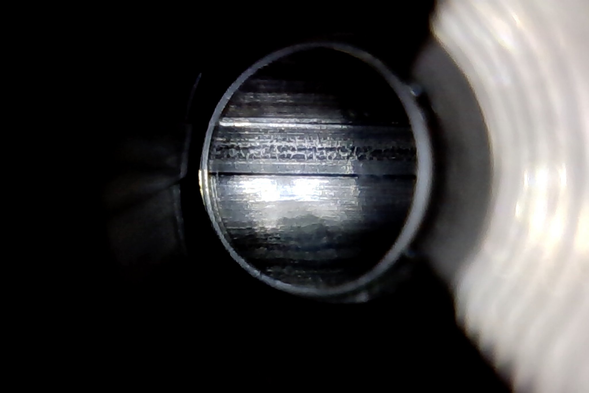

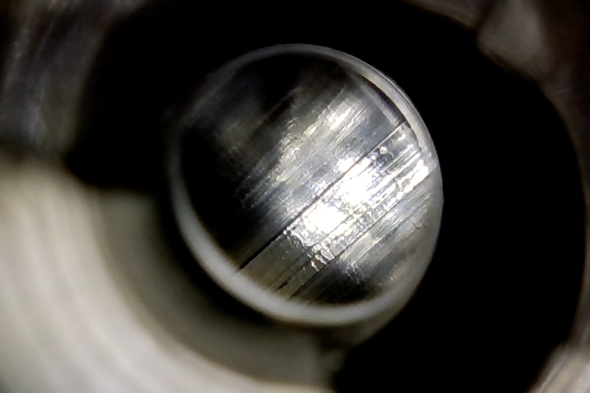

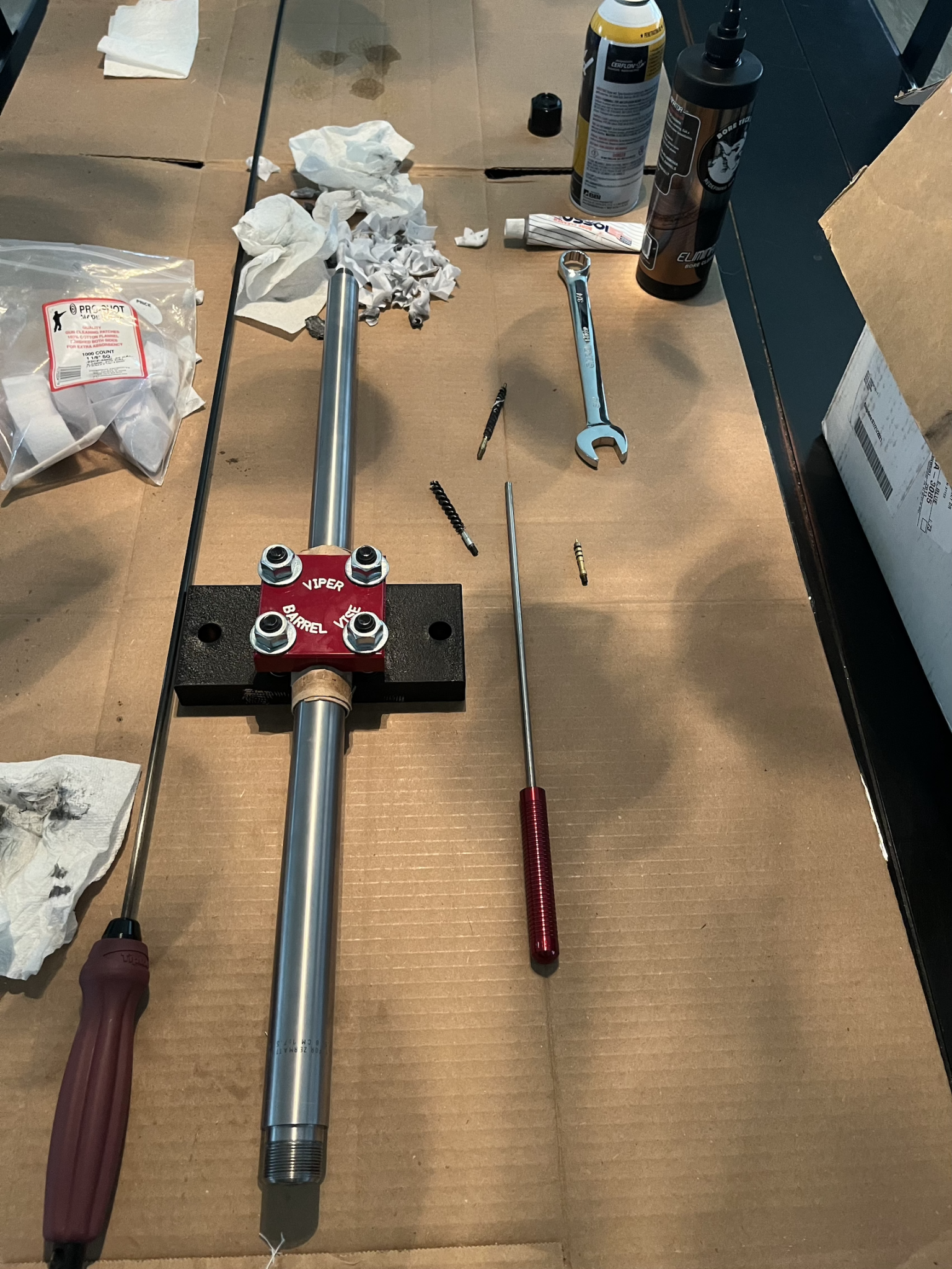

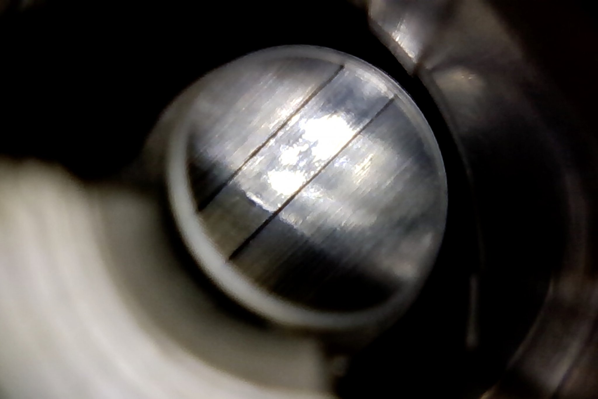

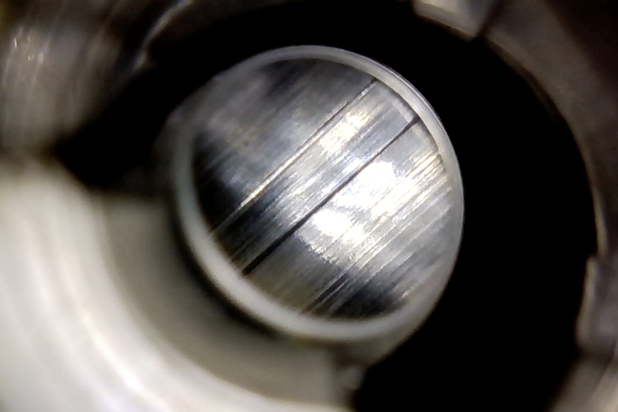

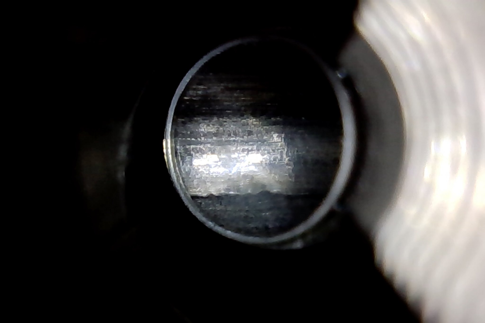

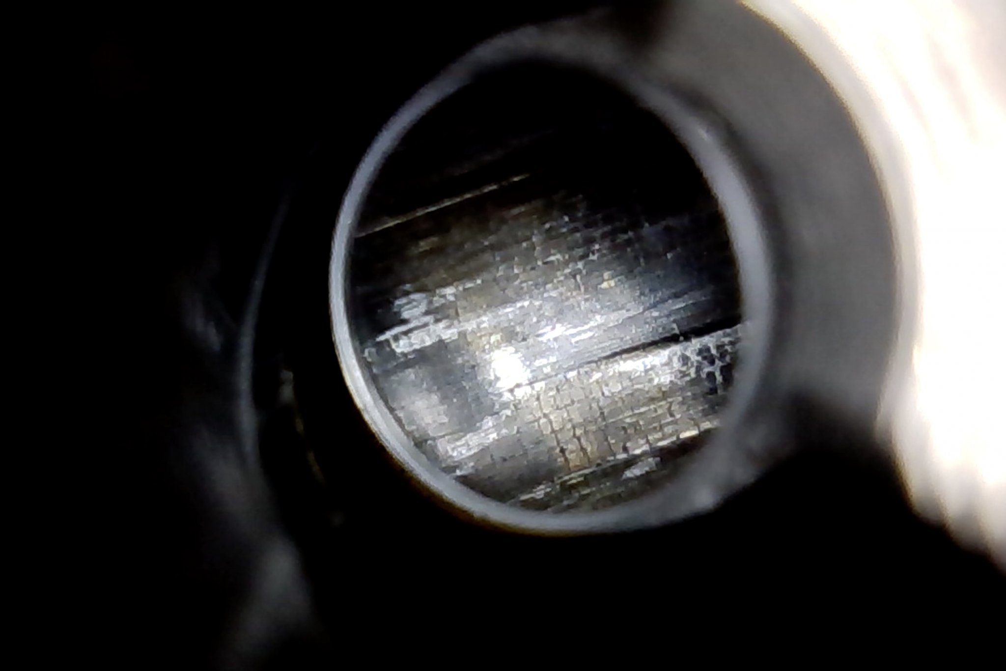

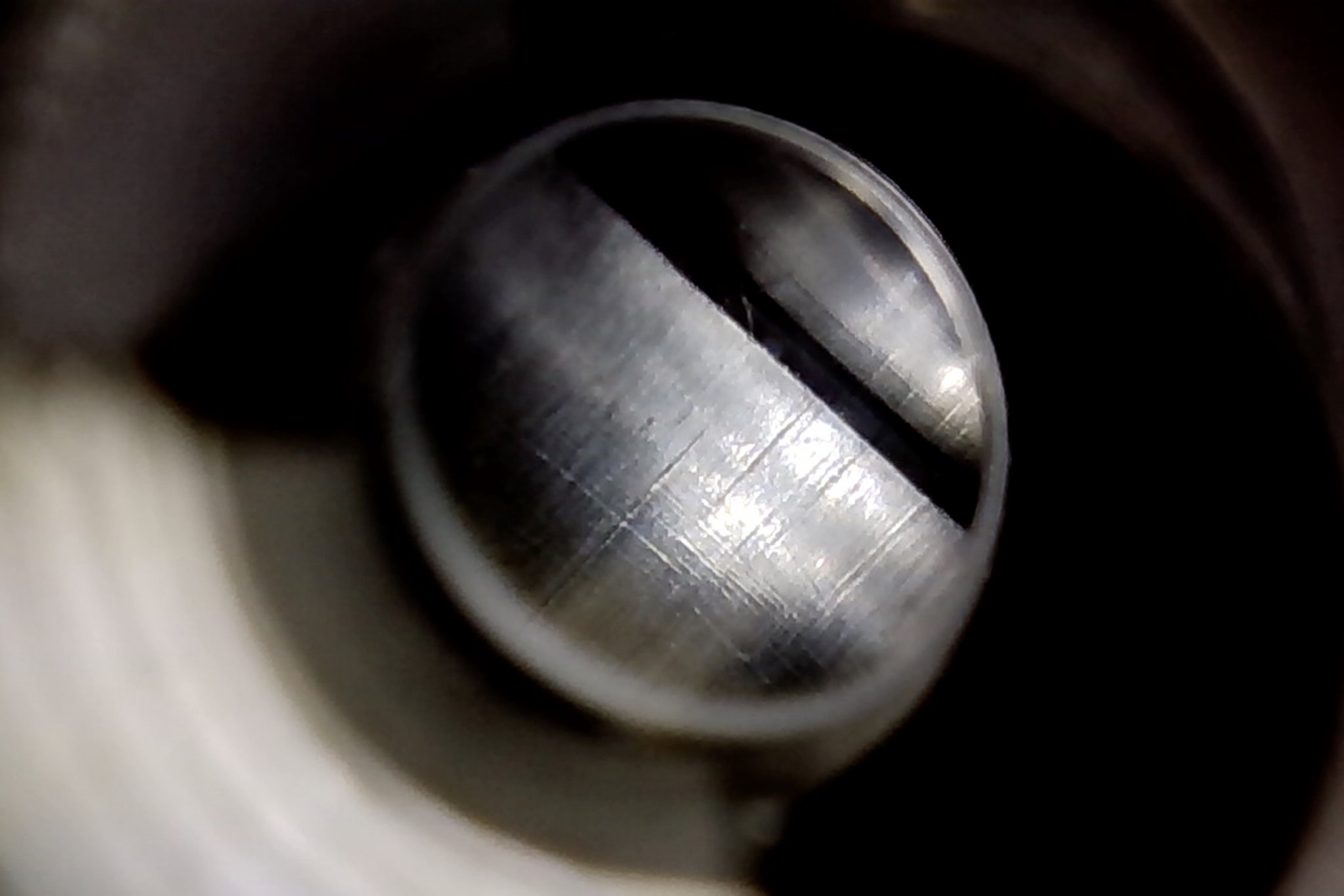

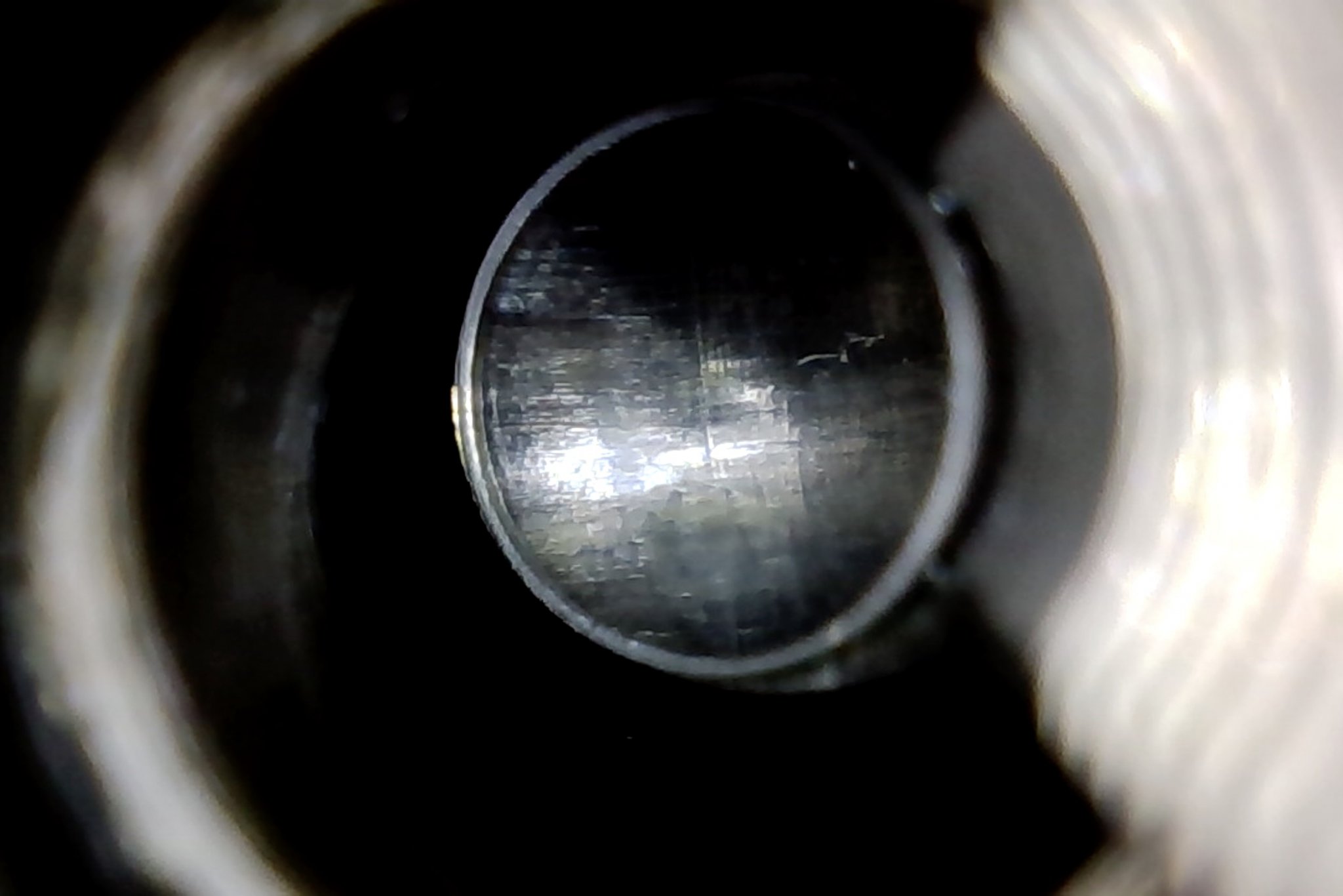

Here's a 6CM barrel that had 2300 rounds on it when I pulled it, I used a fairly large jump and loaded 0.100" off the lands the whole time, and used a mild load making ~2900fps. Measuring the lands/throat, it barely moved, I lost something stupid like ~3 thou (almost too little to measure).
I figured it died because of fire-cracking... but now I'm not so sure... now I think it stopped shooting because of heavy carbon buildup.

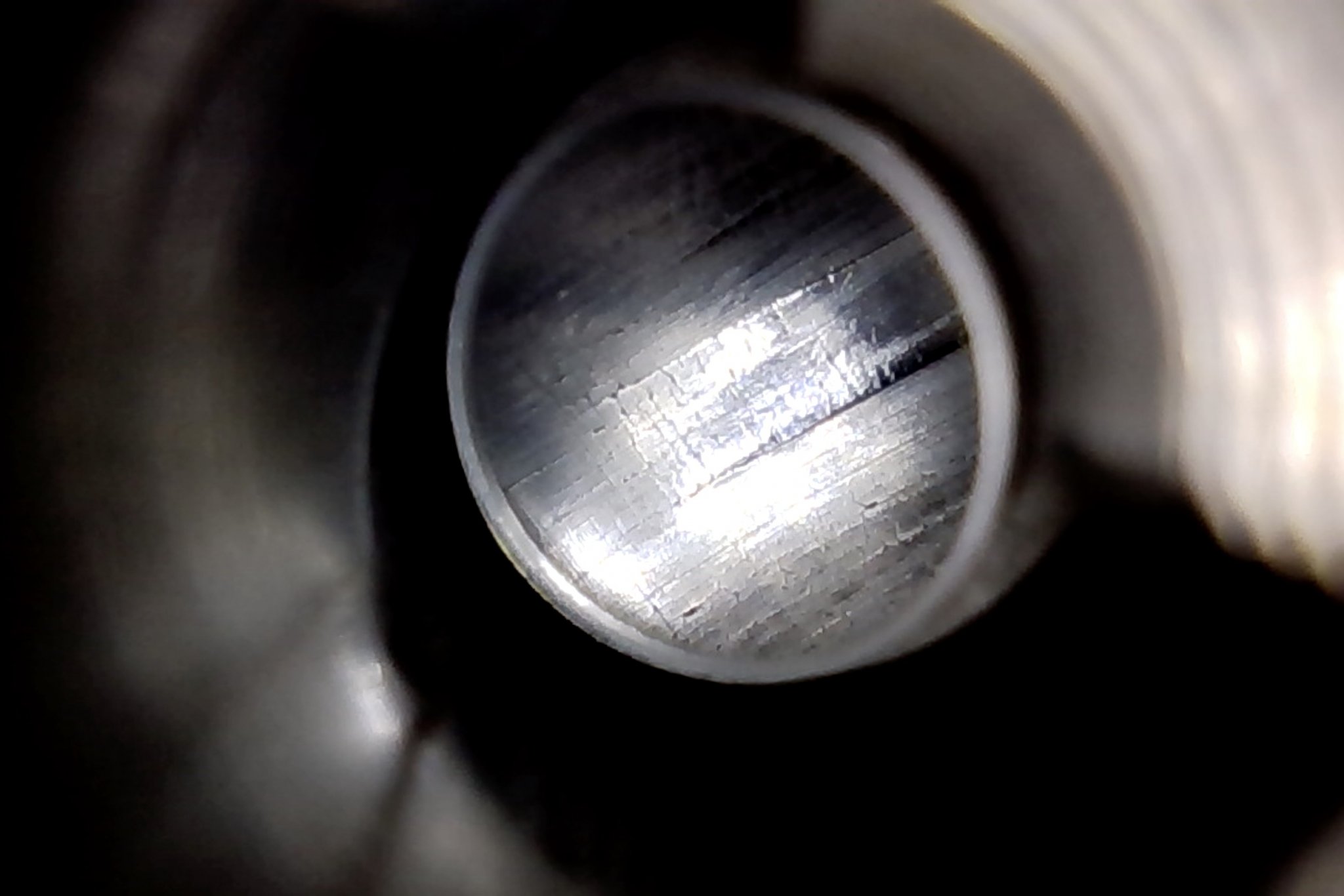

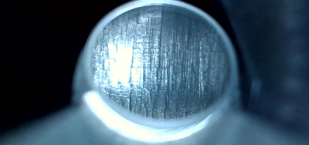

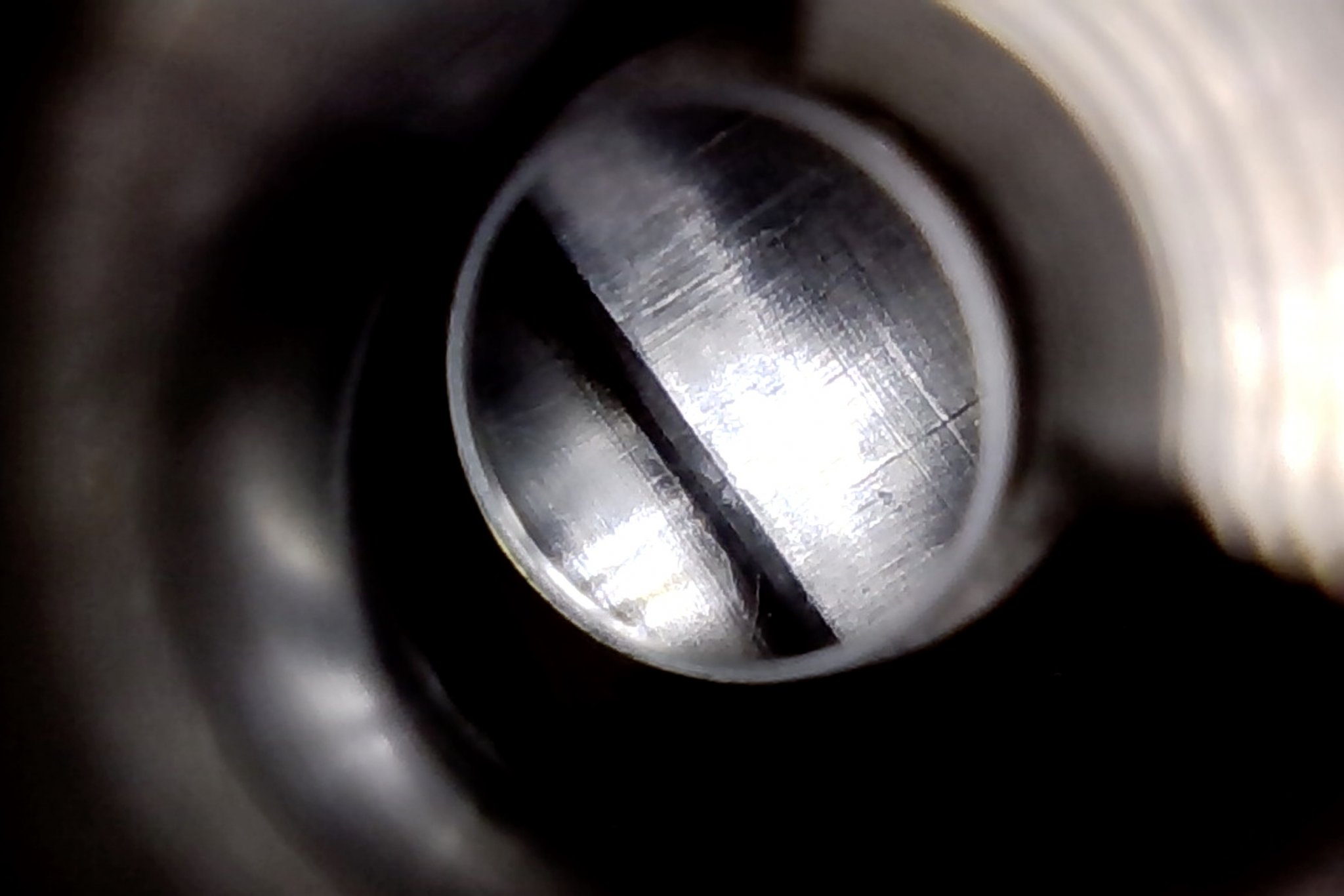

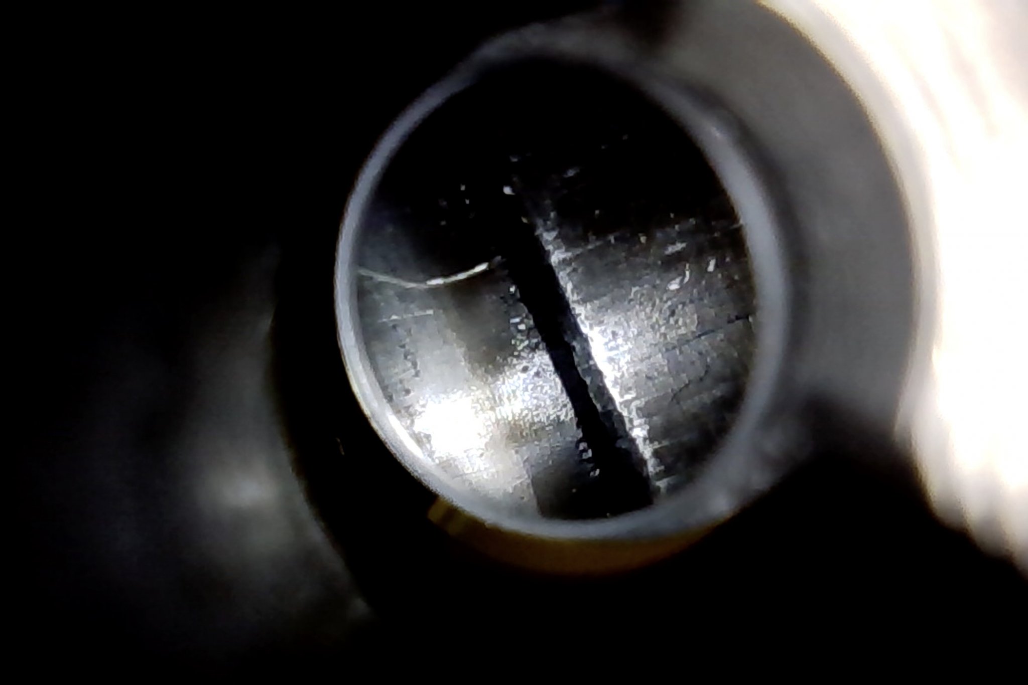

I decided to put the borescope to use and try using penetrating oil as I had heard good things about it breaking hard carbon loose...
Anyhow, if pictures are worth 1000 words, here are "10,000 words". This is after soaking in Eliminator for a couple of days (didn't do a whole lot honestly), then ~30 minutes with penetrating oil, a little Iosso, and a couple of bronze brushes ->
Before:
Photo on 3-19-23 at 2.32 PM #2.jpgPhoto on 3-19-23 at 2.32 PM #3.jpgPhoto on 3-19-23 at 2.33 PM.jpgPhoto on 3-19-23 at 2.33 PM #2.jpgPhoto on 3-19-23 at 2.33 PM #3.jpg

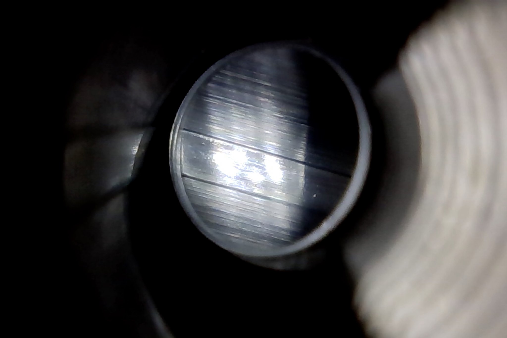

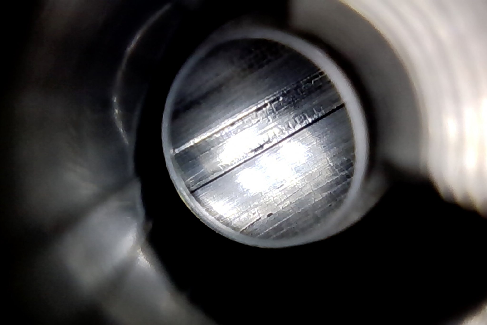

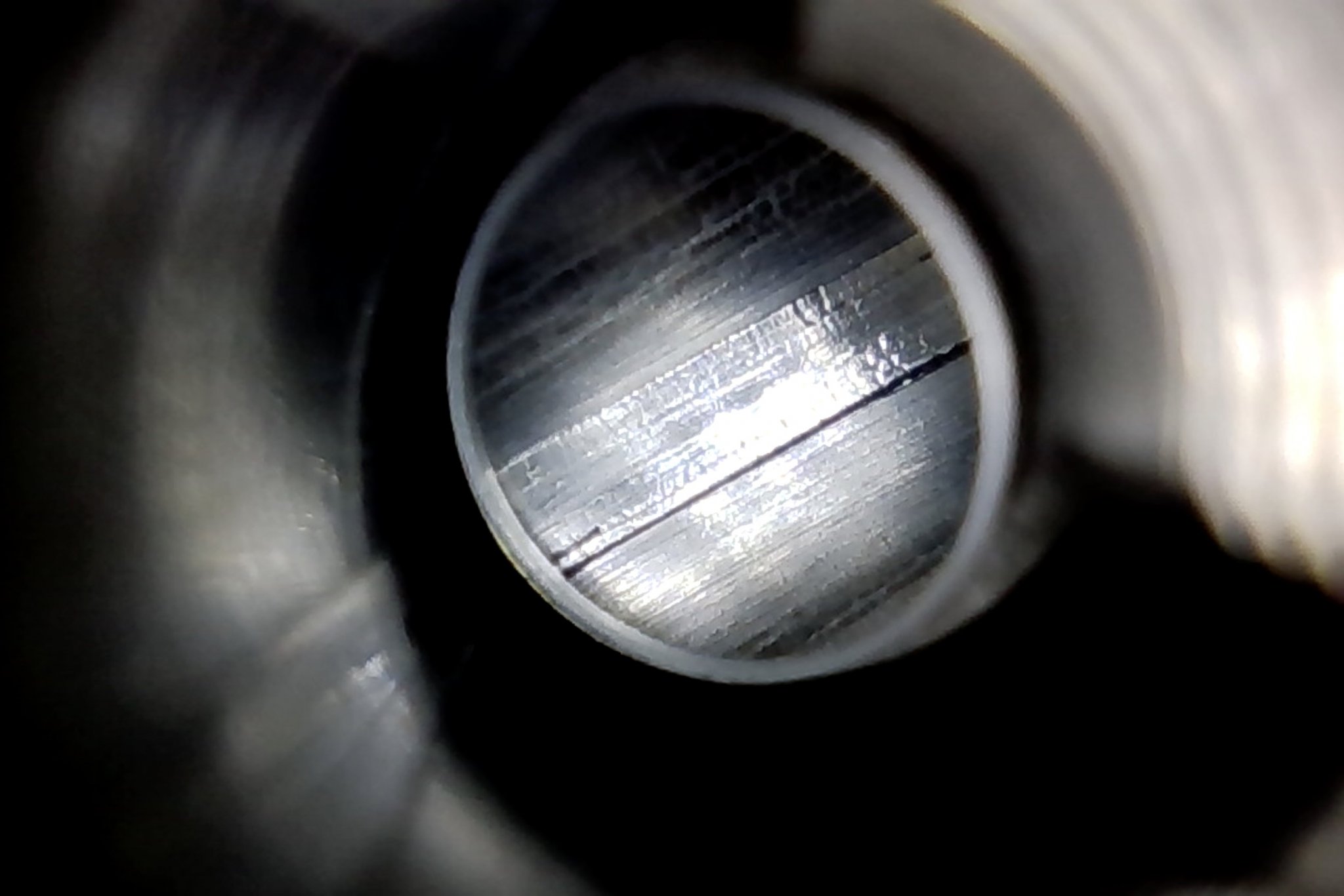

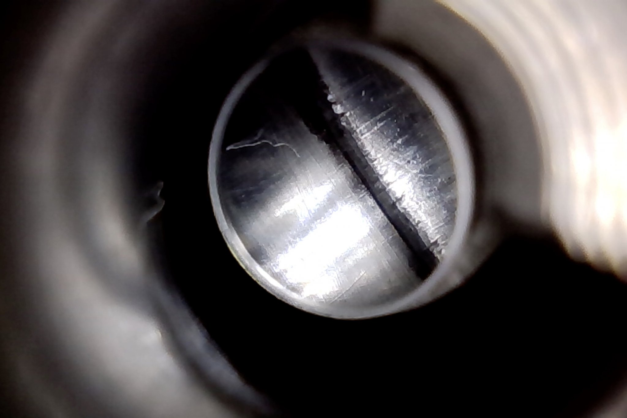

After:
Photo on 3-19-23 at 4.39 PM.jpgPhoto on 3-19-23 at 4.39 PM #2.jpgPhoto on 3-19-23 at 4.40 PM.jpgPhoto on 3-19-23 at 4.41 PM.jpgPhoto on 3-19-23 at 4.41 PM #2.jpg
I'm going to spin the barrel back on and see how it shoots in the next week or two... but it looks like there might be more life in it yet.
If it shoots, it'll be good news because I've got another barrel with 2200rds on it that looks just like this one that maybe isn't a tomato stake just yet either... but I think if I end up hitting the next one I'm going to let it soak with the penetrating oil for a couple of days instead of the Eliminator because the penetrating oil seems to do most of the heavy lifting.
I was kind of amazed at how well, and how fast the penetrating oil worked while following along with the borescope, I think it's definitely worth giving a try if you find yourself dealing with heavy carbon. FWIW I used Liquid Wrench Penetrating Oil (yellow and white can), but went to the store looking for Free-All which I've heard is good too and I might try at some point.

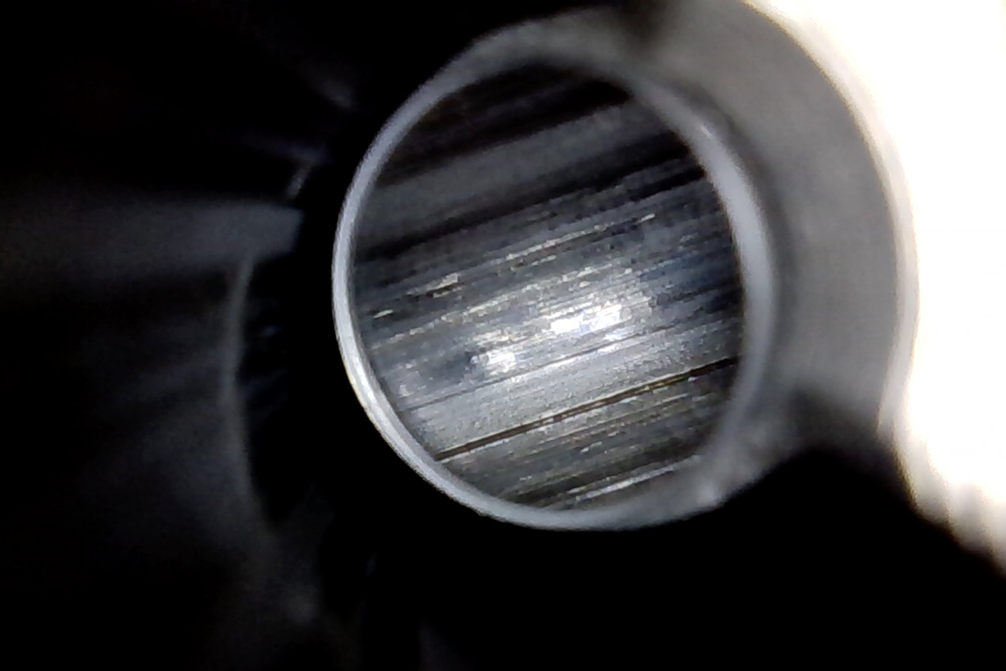

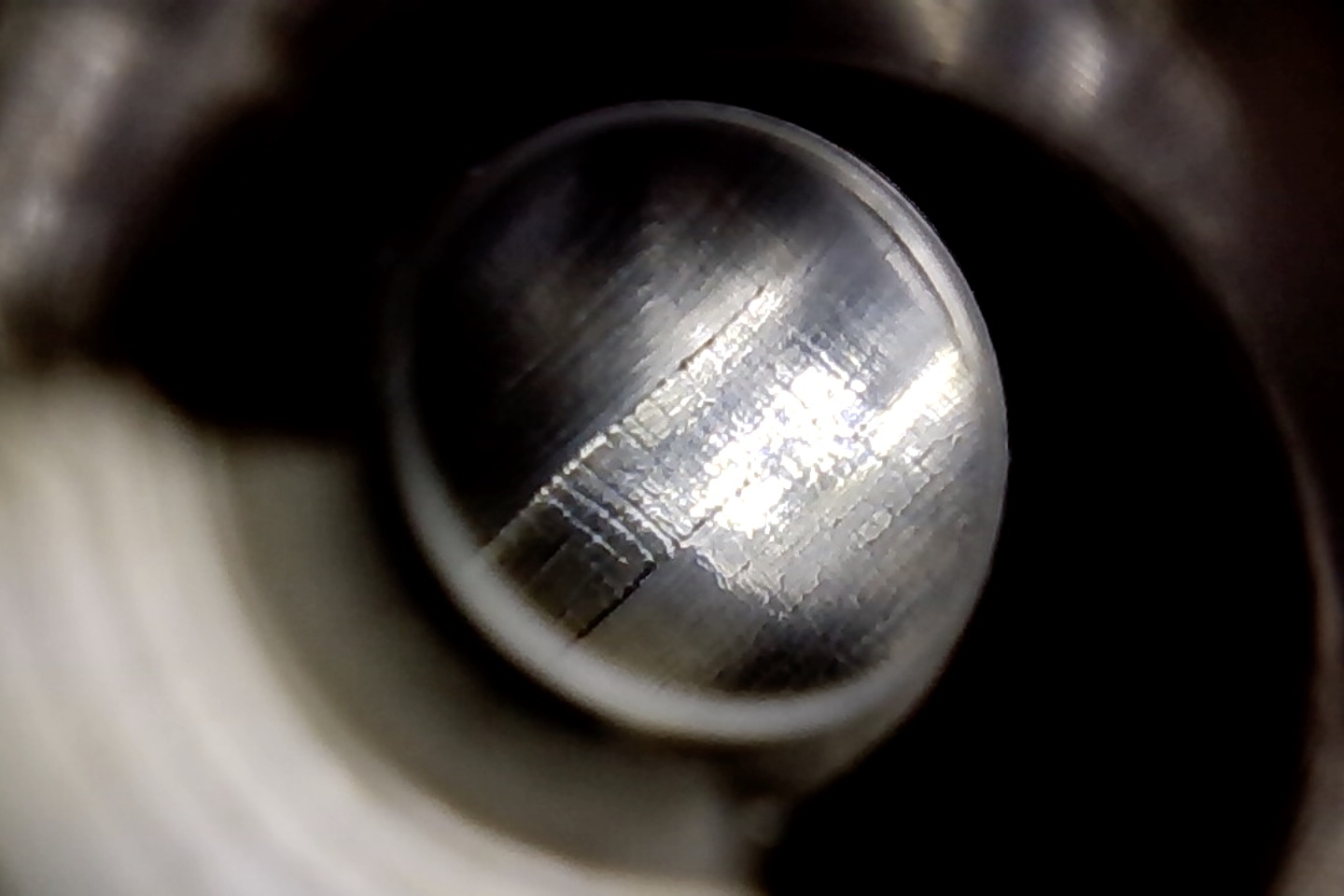

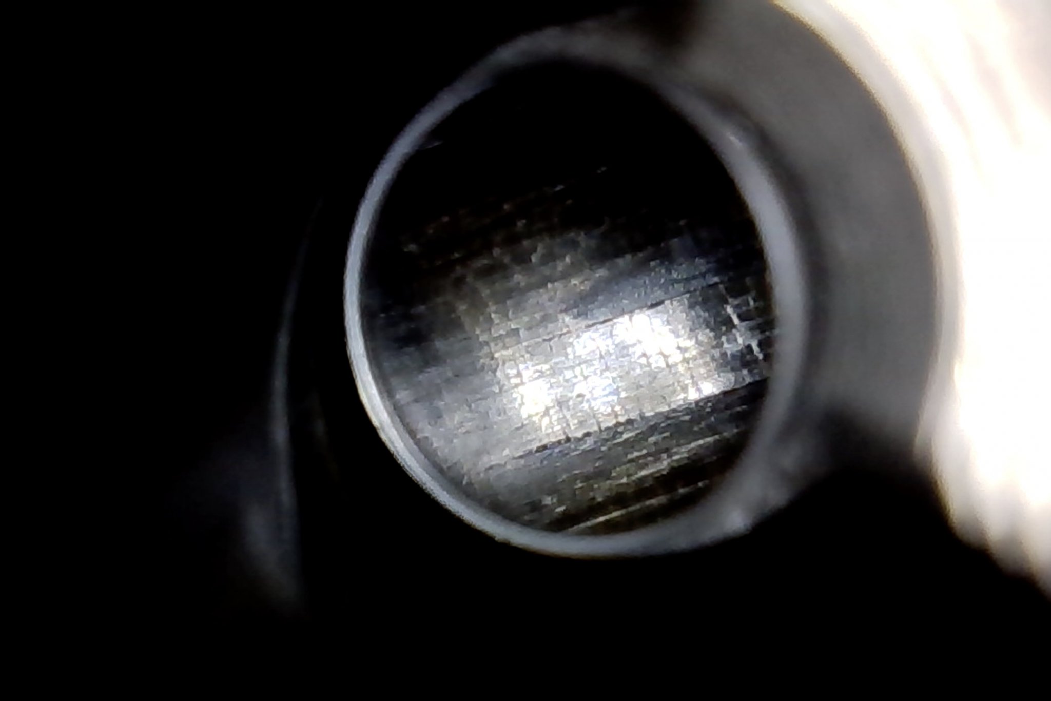

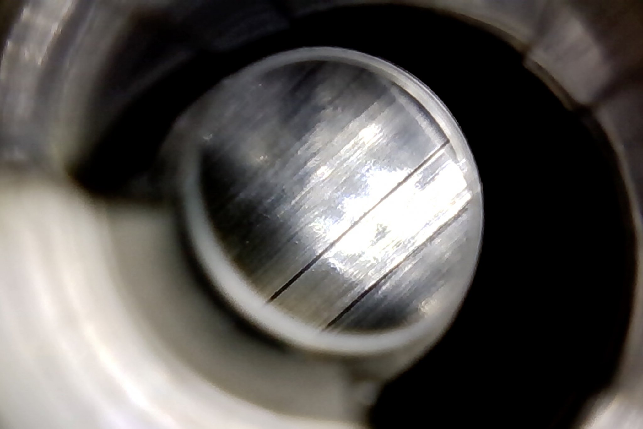

So here's the barrel I had already put ~30 minutes into, this time after a ~48 hour soak with the penetrating oil. I used a brand new bronze brush until it was worn some, then I wrapped a couple patches around it and used it with some Iosso. Finally, I pushed a couple of wet patches of Bore Tech Eliminator through and then dry patches.
I put ~10+ dry patches through and it was still showing a little black/carbon coming out, so I'm guessing the penetrating oil is still working a bit...
Anyways, I think it looks damn good and think it's worth giving a try, maybe there's life in it yet.
I have an unexpected off-day today so looks like I might start in on the other "dead" barrel I have soaking too.
Post-soak pics ->
freebore:
start of lands:
~1 inch from chamber:
~2 inches from chamber:
~4 inches from chamber:
~halfway between chamber/crown:
~1 inch from crown:

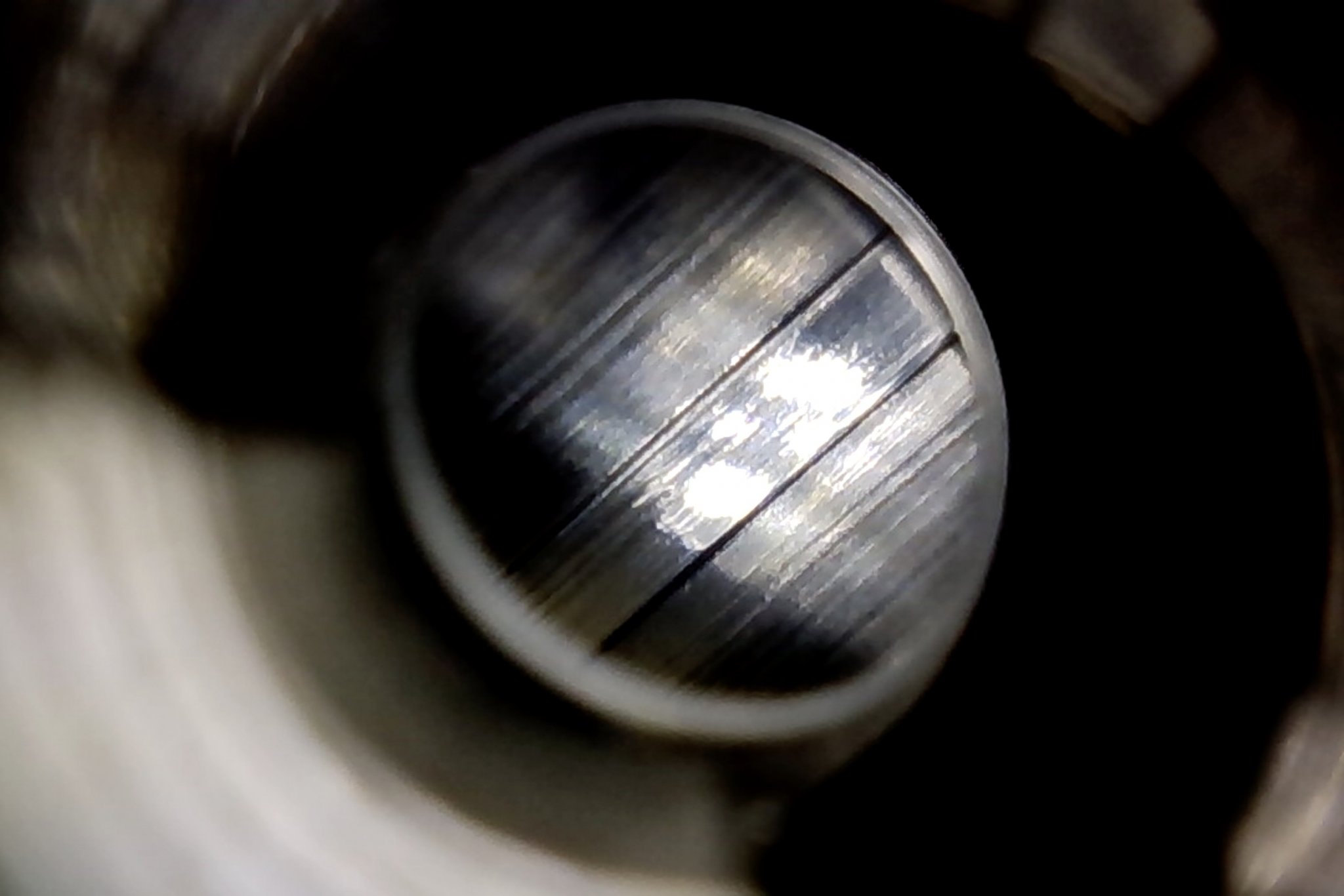

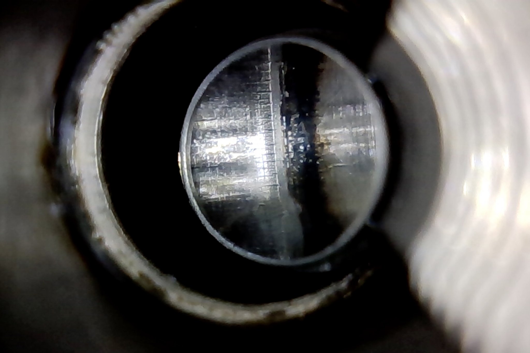

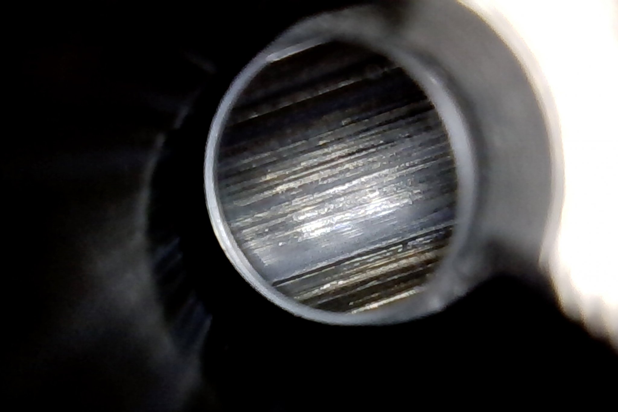

I decided to swap the barrels today, rather than start cleaning on the other old barrel I have, seeing as though I don't really know if the first one I've cleaned up is actually back from the dead or not.
I took off a newish 6GT that has just over 600rds on it, and holy shit, it looks like crap (half of the reason I decided to give the old one a try).
This is after some Eliminator and nylon brush, a new bronze brush with penetrating oil, then a couple of patches with Iosso wrapped around the worn bronze brush... I didn't spend very long on it but I thought it'd look better than this, here are some pics from the chamber to the crown:
Photo on 3-22-23 at 2.03 PM.jpgPhoto on 3-22-23 at 2.03 PM #2.jpgPhoto on 3-22-23 at 2.03 PM #3.jpgPhoto on 3-22-23 at 2.04 PM.jpgPhoto on 3-22-23 at 2.05 PM.jpg
I have the 6GT barrel soaking/filled with penetrating oil and will check on it in a couple of days or so, but from what I've seen so far, it seems as though the penetrating oil softens up and/or lifts the carbon and then the Iosso wipes it out... I'm not exactly sure what the Eliminator does anymore besides wipe out shit that anything else would wipe out and make some patches blue for a little while lol.

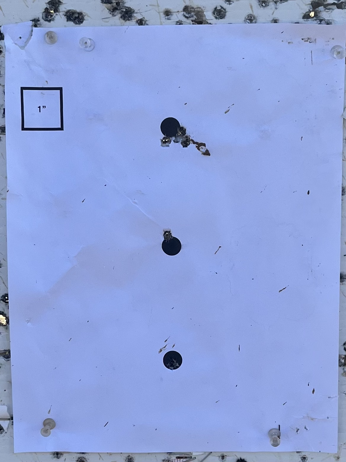

It's alive.
~5-10mph winds and was hammering a 33% IPSC at 750 yards off of a tank-trap/Shmedium.
I shot a quick 5-shot group off the bench/bag/bipod without trying too hard while the wind was still gusting (top circle). I thought it sucked at first, but after closer inspection, it was just random mud from someone else's splash. Then, my last 2 rounds before I left to see if my zero was legit (middle and bottom). The circles are 1/4":
What's crazy is, I still have no real idea what exactly is happening here with this barrel?
The rounds I shot today were BTO 2.180", 100 thou off where the lands start now. Looks good, I'm not going to mess with it further.

It's alive.
View attachment 8104480View attachment 8104479
Bullet holes are 1/4", circles are 1/2". Square in the corner is 1 inch, twice the size of circles.
Small correction… A 1/2” diameter circle is 1/4 the size (area) of a 1” diameter circle. And, a 1” diameter circle is smaller than a 1” square by a factor of pi/4.
A 1” square has the area of 1 sq inch. A 1/2” circle has the area of pi/16 sq inch (just a bit shy of 1/4 sq in).
Reactions: CK1.0
