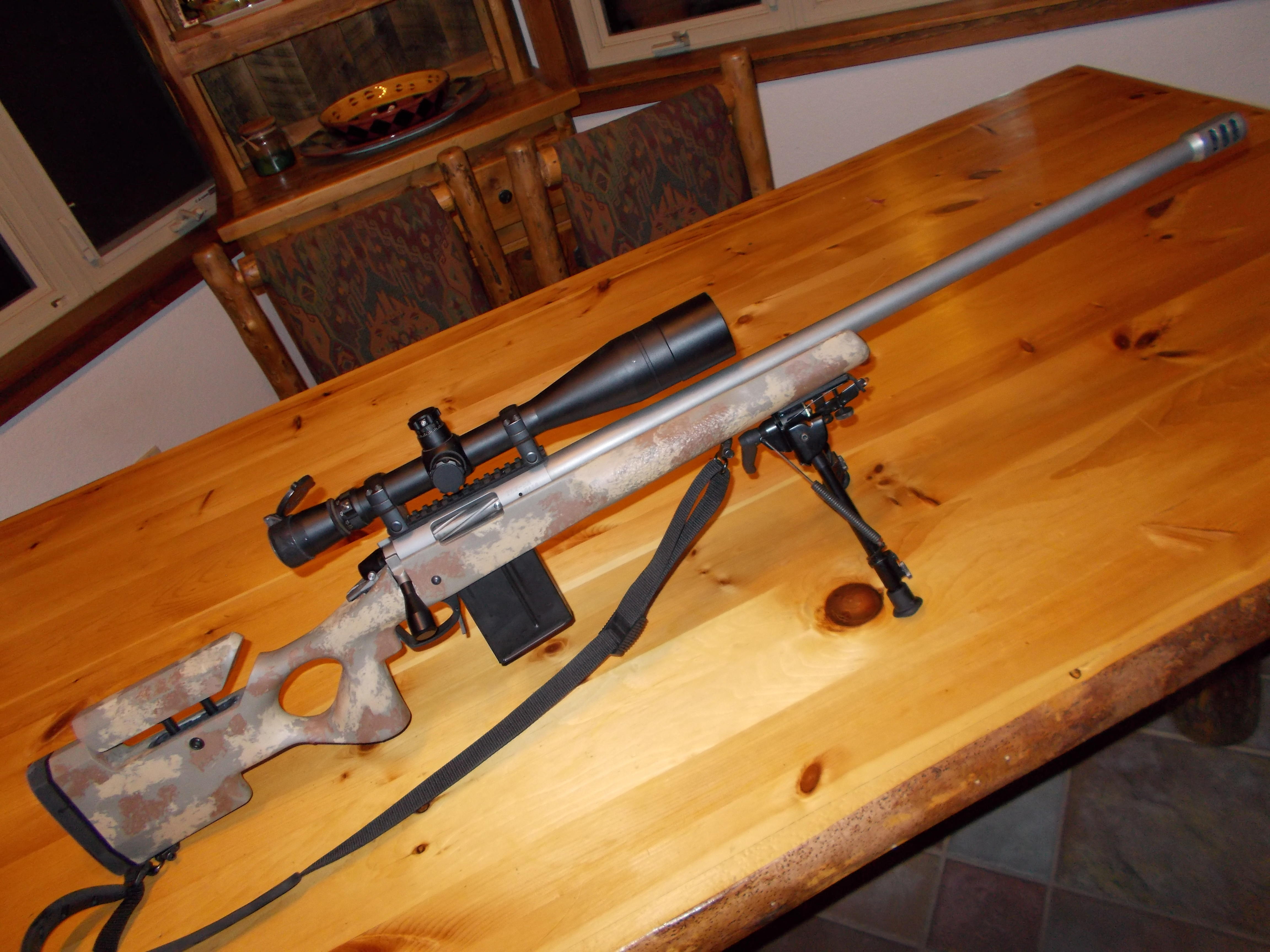

.260 rem, BigHorn Action, Mark Chanlynn Palma barrel, muscle brake, Jewell trigger, Manners T5-A with 10 round DBM, Harris rocking bipod, Leupold Mark IV TMR 8.5-25 50mm scope (soon to be replaced with same FFP version), 20 MOA bases.

But here is my set up
Savage 12 LRP 6.5 Creedmoor
Rifle is 100% factory
Weaver Rail
Blackhawk rings
SWFA SS 5-20x50
Darkeagle Custom Inc, 10 round mag
Harris bipod
Strap on cheek rest
