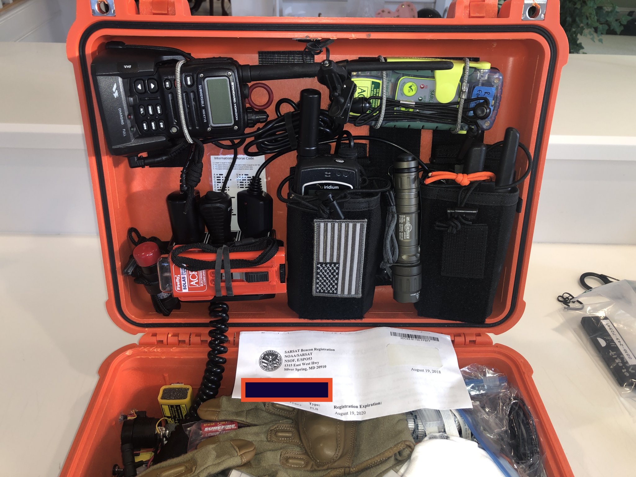

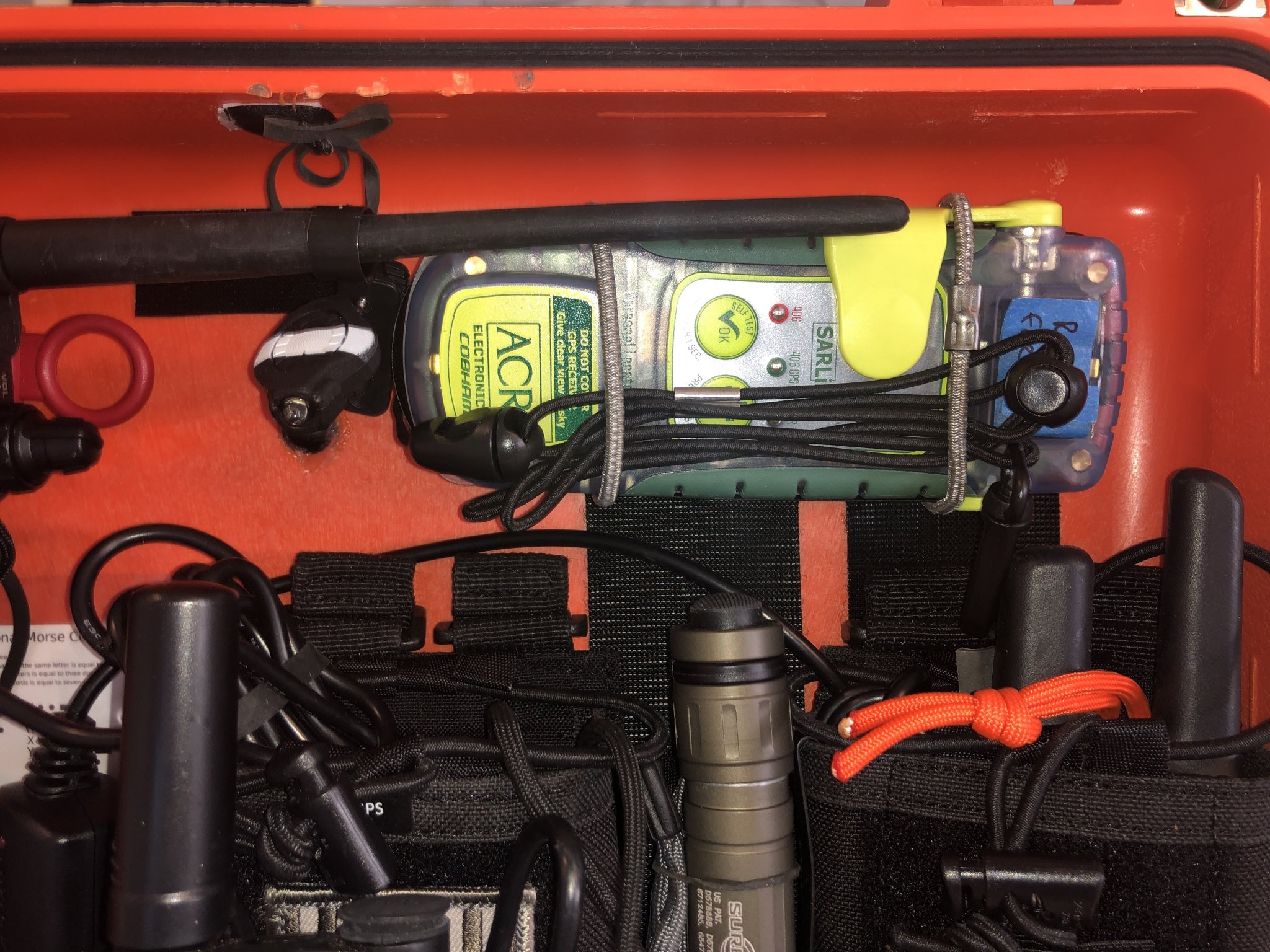

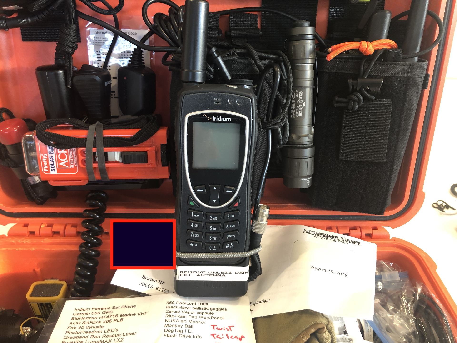

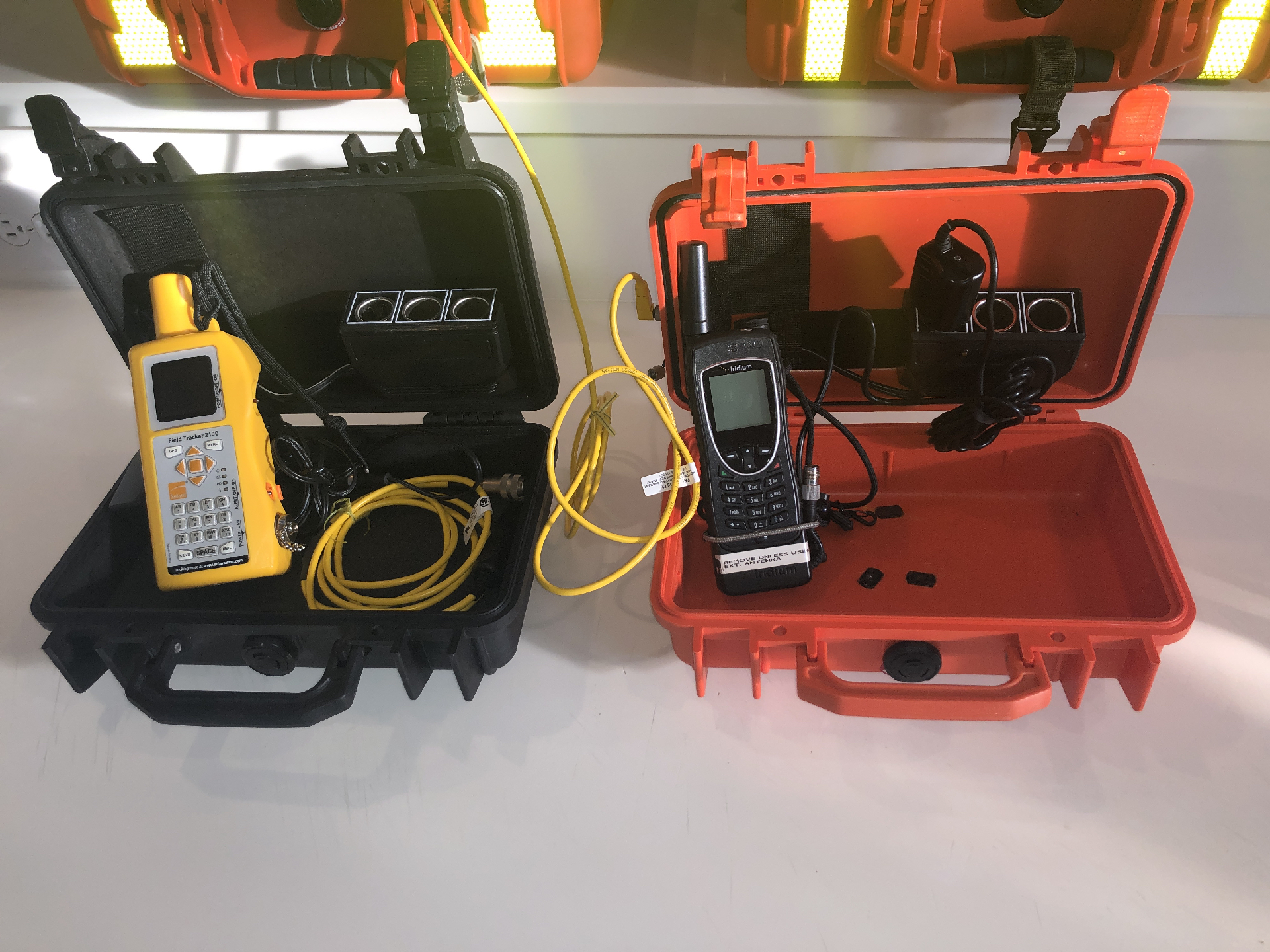

I use a combination of location devices with overlapping capabilities based on different satellite constellations, in a variety of pelican case configurations. The ACR SAR Link (which provides GPS Long/Lat information that can also be conveyed via sat phone; the ACR needs to be registered with NOAA/SARSAT for free. Also, an Iridium Extreme Sat Phone (waterproof, with GPS map location sent with text messages, SOS emergency button to contact pre-selected contacts, 911 contact to Phoenix, AZ center). Protect them within a small pelican case. You can RENT sat phone services from Iridium on weekly / monthly basis. You can't spend enough to protect your children and provide you with peace of mind, less expensive than our shooting hobby !

That is a very, very impressive kit. You can cover any comm issue with that gear. My daughter is a young wildlife biologist. Has to balance available funds with performance on the PLB's. The wife and I will get her the ACR ResQlink+ (I understand it does have GPS tracking capability now). Iridium would be great, but ....
